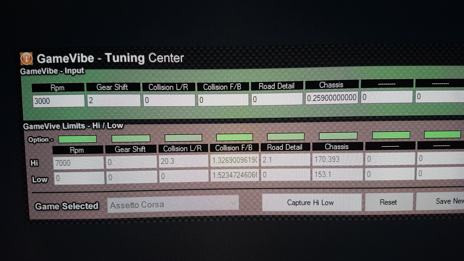

    Same here, tuning center show RPM but nothing to my shackers ..

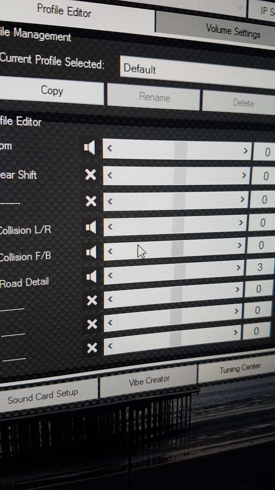

    @Nick Moxley just a quick thought i had one game that loaded all the vibes X ed out on launch and i had to click it to turn it to the speaker icon on each vibe see picture hope this helps :)

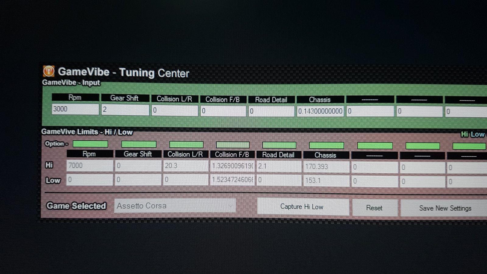

    After a good hour plus on Skype with the Powers that Be. its nothing basic and Very obvious. But thanks for trying. There's obviously something blocking AC's plugin from sending the data out to the Actual Sound card as we can see the Data in the Tuning center just fine, Dirt Rally Works outta the box and Sends vibes, so were still working on it.

    Star the game, Get on track with everything up and running, Game vibe wont work. Now while in game, Close Gamevibe and re open it, it might crash on the first time, Open it again and you should hear a small Thud as the app latches on to the game data.
    this is the only way it works for me currently is to start it all up, exit vibe, then re start it.
