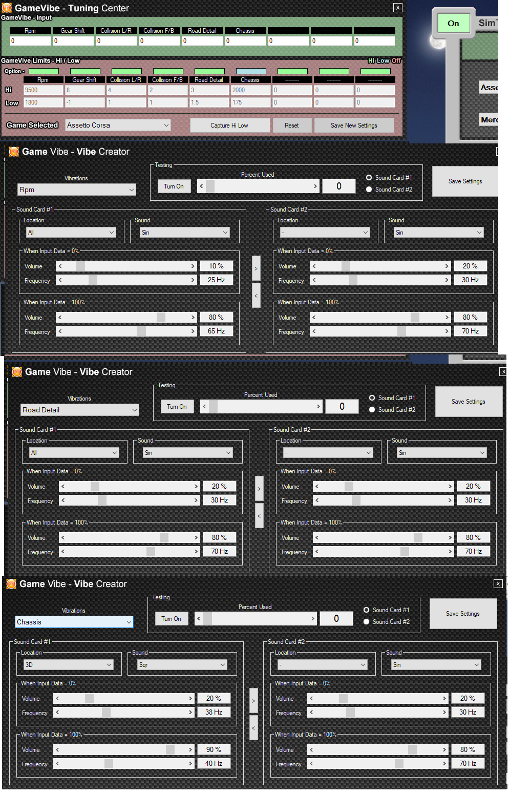

    Hey @Nick Moxley, want to share your vibe settings for AC? Have you tuned any of the inputs (vibe creator), sound level settings, etc.
  6. Nick Moxley
    17,057Coins
    +2,507 / 30 / -2
    ah yes, ive gone and tweaked a bunch of stuff, from levels to frequency's Saving profiles as i go as it saves the "profile sliders, and the volume of said profile" So you can tun in and out the low rpm idle if you sit in the pits often and dont want it rumbling away, or in general just needing custom volume sliders per a certain car..the profile sliders and the volume sliders allow you to control it quite nicely. I think were gonna get an even shorter Shift bump detection, maybe 25ms vs the 50ms now.
    Ill post them up this evening when im on.
  7. Nick Moxley
    17,057Coins
    +2,507 / 30 / -2
    RPM and Chassis are unique, Road Detail, Gear shifts and Collisions are all the same for now, Still playing around but this is a decent ball part for my 4x Mod Gamer 2's Using the Volume setting and the Profile editor, you should be able to tune around most anything.
    • Informative Informative x 3

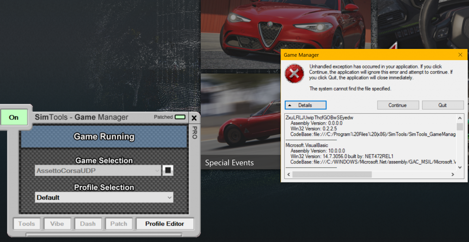

    Okay guys can you help me as I only seem to be able on the PC Windows 10 64-bit to be able to get the game running in the UDP mode but then I get this error message and no movement. I thought the UDP mode was the PlayStation 4?
