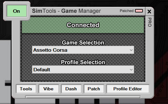

    I play AC on PC patched the latest pluging but it not connecting it stays green.
    do i need to install anything else. F1 series - RF2 - Dirt2 all working.
  7. nornesnaj
    nornesnaj New Member
    Jan 3, 2020
    28
    Netherlands, Zelhem
    125Coins
    Motion platform, 4DOF
    Solved its working now did not change anything. It just toke some time (drive more rounds) before it worked.

    Hi @nornesnaj,
    It looks like the game was not patched in the pic above, that why it did not startup.
    (See the little red bar next to the word "patched" in the upper right?)
    Just something to check for future reference.
    Glad its working now thou, take care!

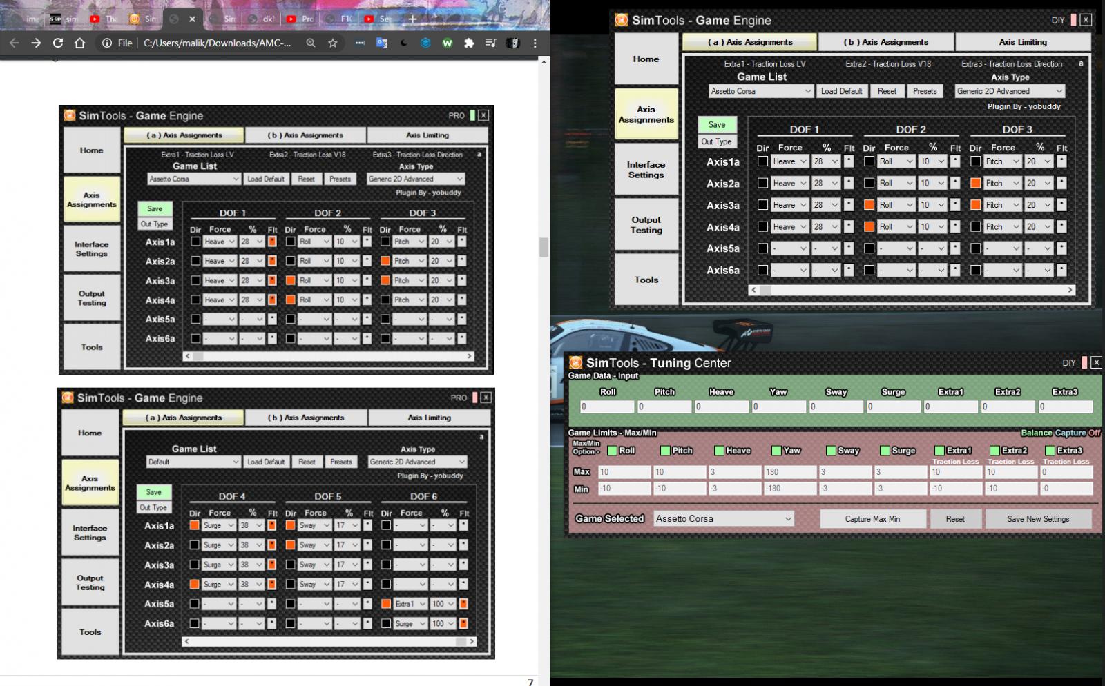

    I've installed the plugin, how do I setup the Axis for 4 DOF? I've followed the settings from the AMC-AASD15A Manual, but some of the settings have the filter enabled, and those filter settings aren't listed.
  12. noorbeast
    22,220
    154,789Coins
    +11,219 / 57 / -2
    See the FAQ motion profile tips for a summary of how to expose functionality such as filters: https://www.xsimulator.net/community/faq/steps-to-create-a-motion-profile.228/

    Can you please post pictures of all of your settings, including the Tuning Center while in an AC race.
  16. RENZOREY18
    RENZOREY18 Member
    Nov 7, 2018
    60
    46Coins
    +12 / 1 / -0
    2DOF, 3DOF, Arduino
    in the end if it worked but it is because of my lack of experience, this game unlike others only communicates when you are already in the race but well thank you very much for your quick response Greetings!
