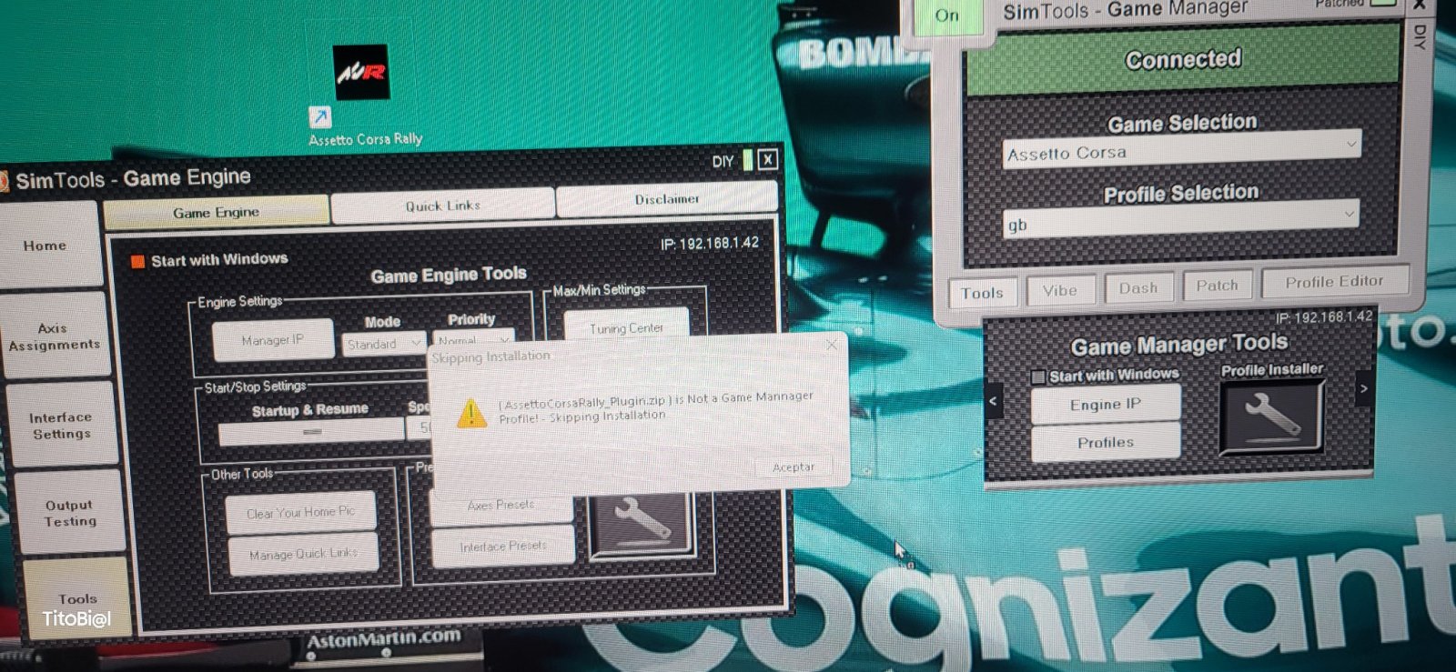

    Well, I can't get the ACR plugin installed. Am I on the correct version? Thank you! 17633809932736731436732060963874.jpg

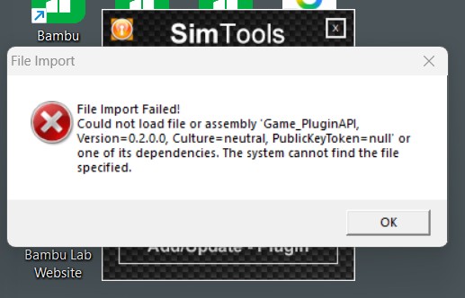

    I removed the first version then uploaded new version and get this message. Wonder what I did wrong

    Now!! Brilliant! It already works! Thank you very much!!

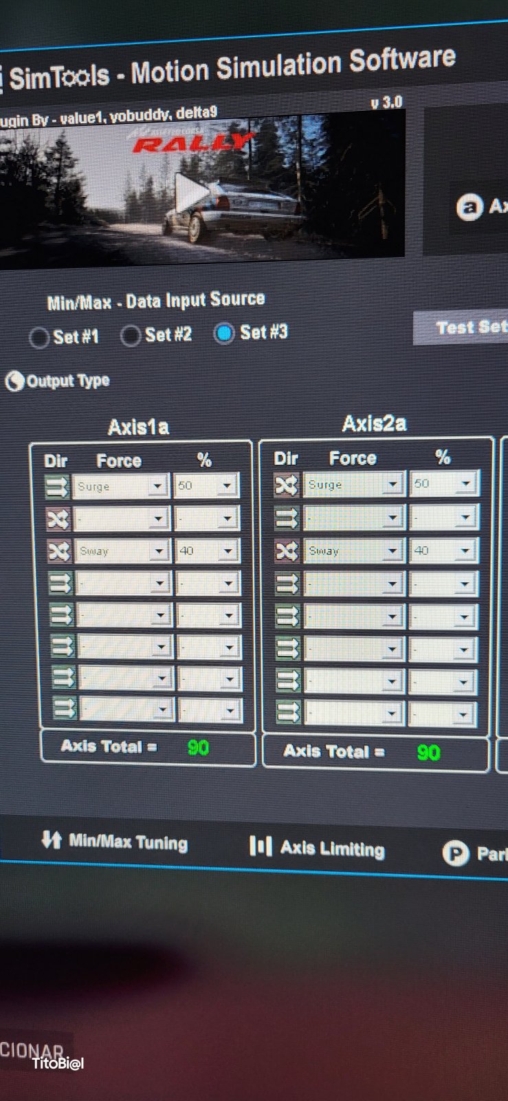

    Hello. This is my basic setup for my 2dof. After many tests, it is the only way to feel the acceleration and braking and the roll of the curves. (If I use other forces, since the terrain is inclined, the roll will be canceled if the inclination coincides with the inertia of the relevant curve) I don't know, let's see if someone has the same problem or maybe uses something similar to mine...

    On the other hand, in Tunin center, I have to have very low values to notice the forces to my liking. I don't quite understand capturing values while driving to do checks...

    Tuning center (min/max values)
    Right way if i remember correctly would be to
    Reset, then click capture.
    Drive safely, full acceleration and braking but stay on the road, DO NOT overdo it and crash you car. I just drove for about 5 corners worth.
    Then i hit ESC to pause the game.
    ALT+TAB to see simtools.
    Click SAVE
    There you have normal driving values for the movement and you can the adjust from there.
    If in doubt. Try to match pitch and roll degrees to your rig.
    If you dont know, start with something like 20 and -20 for the pitch/roll values.
    I have set sway+surge min/max to 5/-5 .. that makes it react fast to small movements.
    Still tuning though.
    i use 20% for each action: pitch, roll, surge, sway, +pitch rate(filtered)
    I also use a 10k pot to dial down the movements.

    Thanks for your support! The issue is that, when I capture values in Tunin center, it shows some "rare" and very high figures in real time, which, I don't know what the approximate value corresponds to so that I can set it in my value. I always got involved with this and in the end I end up playing it on demand. But investigating this topic, they emphasize that taking values is important... P.S: I also use 10k potentiomeyros. Greetings and thanks again!

    I think I understand how it works: It is understood that by taking that turn with the tunin center, it captures the maximum values of your way of driving and plotting, as if we were saying the physical forces, centripetal and inertia that you generate while driving... And then those values are the ones that adjust within the range without going overboard. Is that so?! Thank you
