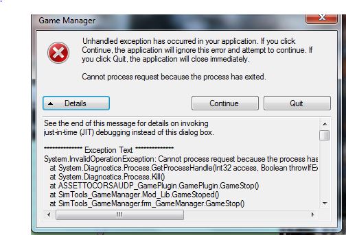

    Click the details button when you get the error so we can see what is happening buddy.

    These are the steps that I make to start the software:
    start ps4
    start router
    start pc
    start account ps4
    start game engine and game manager
    start Assetto Corsa
    start game practice or race, without change car or truck
    download game
    start plugin in Simtools
    I Drive but the playseat don't move
    The messages are in the attachment, the details too.

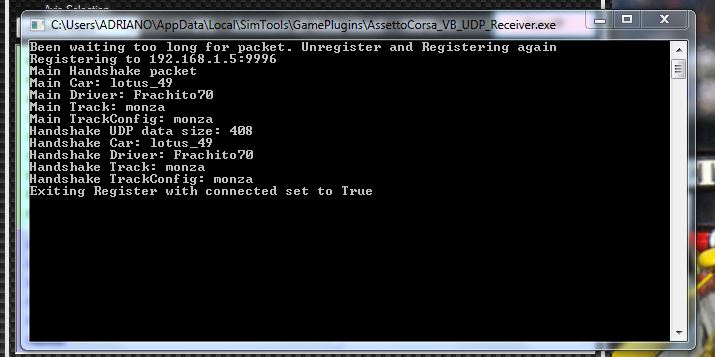

    Hola. Me pasa exactamente lo mismo, ¿sabes si se puede resolver? Abro el exe con la dirección IP correcta de ps4 y el circuito, mi nombre y el auto aparecen, pero el simulador no se mueve.
    Hi. The exact same thing happens to me, do you know if it can be solved? I open the exe with the correct ip address of ps4 and the circuit, my name and the car appear, but the simulator does not move.

    does the simulator move with another game?

    the simulator works perfectly in both project cars 1 and 2, f1 2016 on ps4, they are the games that I was able to configure. I also have the Dirt Rally 1 and 2.0, Gran turismo sport but I think there is no possibility of udp yet.

    My assetto corsa game is the ultimate edition, is not the competition. The ultimate edition is the basic game but with dlcs into the disc. I think it should work like normal game

    Dear, I had the same problem, when windows did an update a couple of days ago, I solved it, forcing the file : AssettoCorsa_VB_UDP_Receiver.ex to run like windows 8, ever, and it was fixed !!
