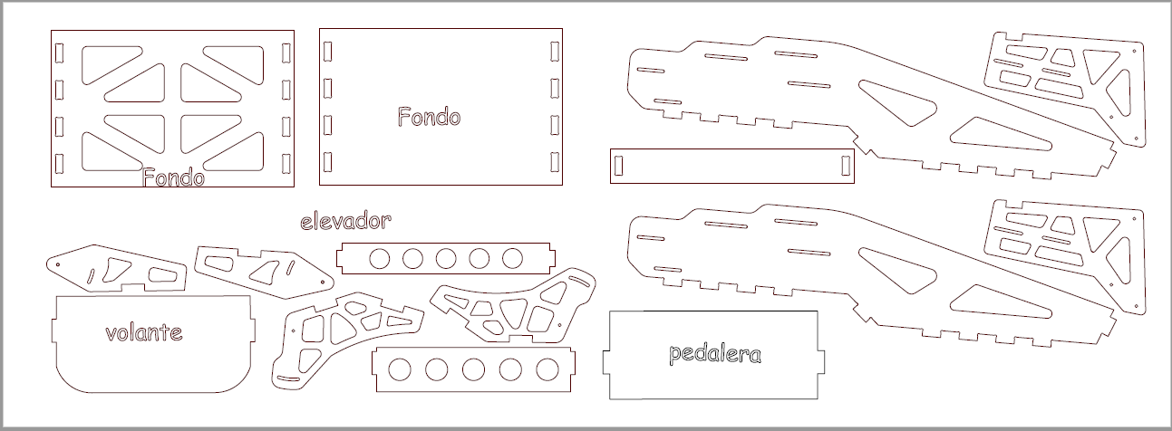

    Hello everyone and Happy Holidays.
    I will take advantage of these days to advance a little more in the project, mainly in the area of electronics and drives.
    I think the mechanical part is already quite advanced and now that I have verified it, I would like to share the cut files with the forum.
    This forum has saved me a lot of research time and I think maybe it could help someone.
    I upload the DXF format with the actual measurements in mm and the file in PDF so that the person who does not have a CNC router can print it on paper and use it as a template to cut with a hand saw.
    Material poplar plywood, 15 mm thickness
    Merry Christmas everyone and thanks for the support.

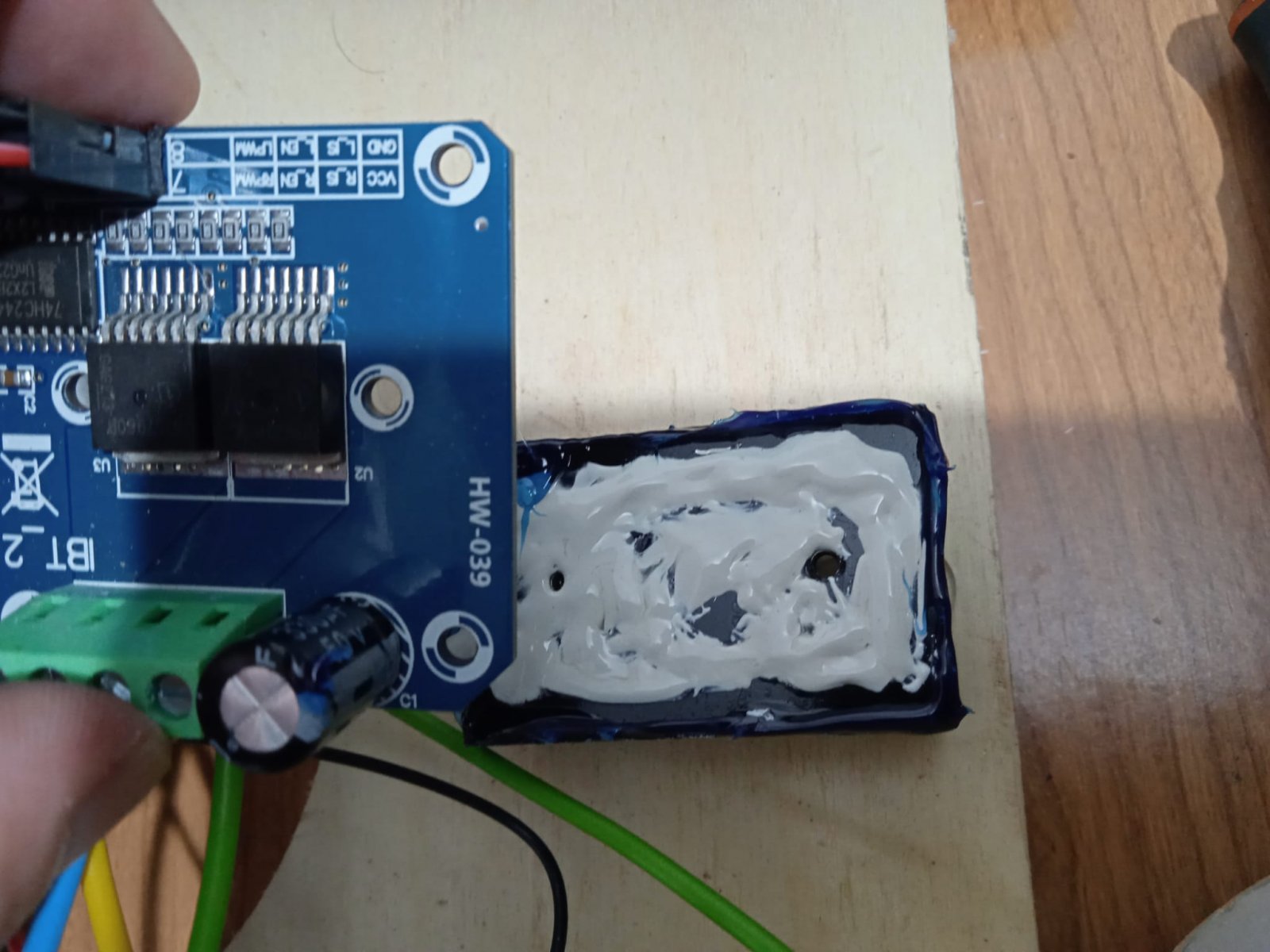

    Hi all¡
    Now going on with electronics.
    A bit of thermal paste to improve cooling of H-Bridge modules.
    As this paste is a bit fluid, I made a small joint arround to advoid leaks
