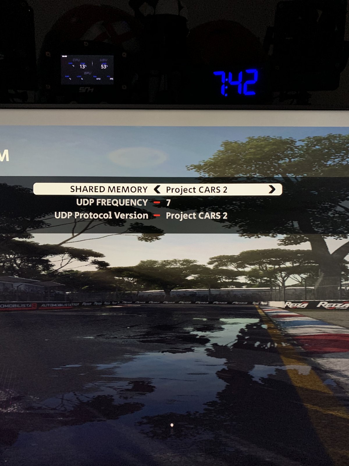

    hello mate download your plugin .i am 60 years old 'lol'i can't get it to work ,shared memory is on udp is on ,i tried lots of numbers 1-9 but nothing help as far as i can see it is not receiving data. any help greatly appreciated.Dave

    Make sure it's on Project Cars 2 in game under the UDP Memory settings.
    Also, did you make sure you patched the plugin?

    hello yes its on project cars 2,udp is on I've tried 1-9,
    in tuning centre theirs no data to capture
    ive tried restarting the game after every change.
    game engine and manager is connected and game is patched.
    im properly doing something stupid every time i pause the game theirs nothing captured in tuning centre
    thanks Dave

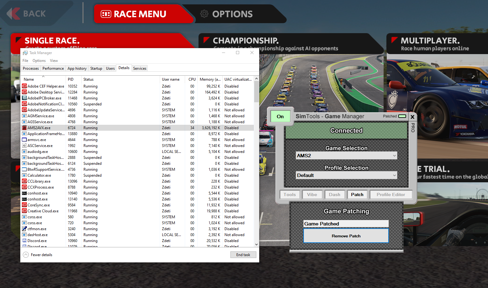

    IMG_1881.JPG IMG_1881.JPG IMG_1881.JPG IMG_1881.JPG hello ive turned off simhub,fanalab,the only things running is the game and game engine,game manager.
    task manager see the game as AMS2AVX.exe
    all ive done is tuned on shared memory set pc2 and patched th games do at least 2 laps before checking tuning centre it has captured nothing ,thanks for your help Dave

    @value1 Do you know what could be wrong with his? I didnt even change the frequency, and mine caught the motion right away
    By the way Dave, check that you dont have firewall on or antivirus. There are apps that sometimes block UDP shared memory telemetry. I had a similar issue before.
