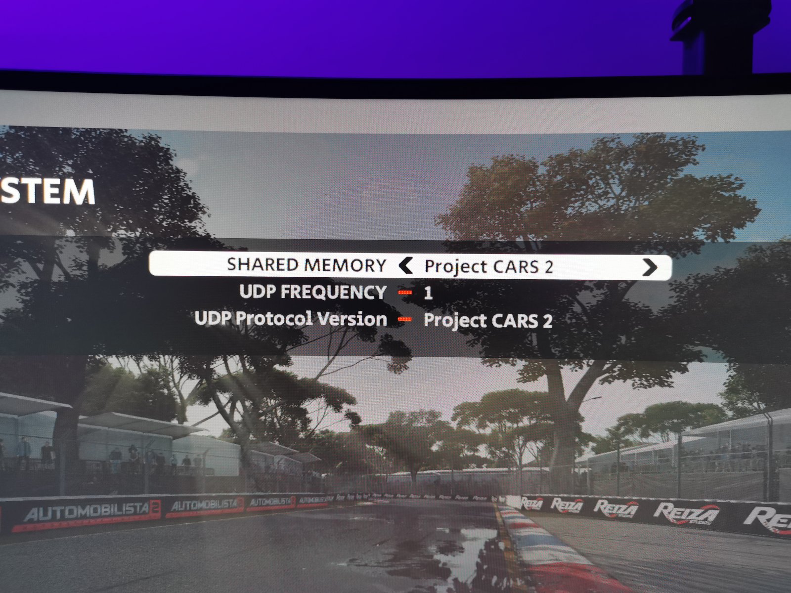

    Hi
    Have you turned on shared memory in the system menu of the game ?
    Post some pictures of all you settings maybe we can help

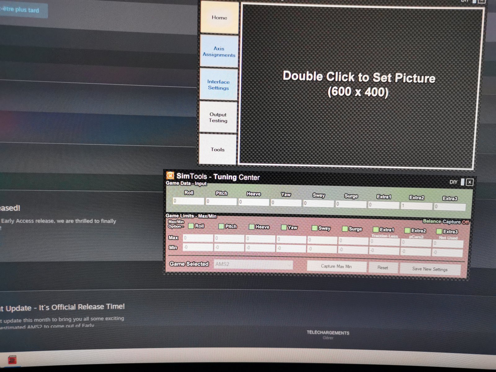

  16. GWiz
    GWiz Active Member
    May 12, 2019
    191
    Dentist
    Aberdeenshire, Scotland
    1,510Coins
    +124 / 0 / -0
    It could be that you have zero values in Tuning Centre. Check Tuning Centre to see if you have some values saved. There are posts on this forum with instructions on how to set up a motion profile.

  18. Grand Strate
    Grand Strate New Member
    Feb 13, 2020
    16
    - 45Coins
    +3 / 1 / -0
    Hello
    It still does not work.
    I am attaching screenshots if anyone can help me.
