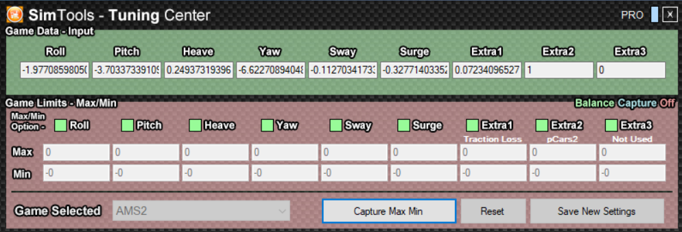

    Guys,
    I need some help on this one since I have never seem this before.
    I got game telemetry data on the Tuning Center (pic below), but no motion.
    What could that be?
    My in game settings are:
    Shared memory: Project cars 2
    UDP Frequency: 9
    UDP Protocol Version: Project cars 2
    Thanks for any help.
  11. GWiz
    GWiz Active Member
    May 12, 2019
    191
    Dentist
    Aberdeenshire, Scotland
    1,510Coins
    +124 / 0 / -0
    You just need to have some max and min values. I'm assuming you are using the DOFReality files as these don't have max/min for AMS2 for some reason. Either copy across the values from Project Cars 2 or capture Max/min values yourself after running a lap without crashing. Save new settings and then you'll be sorted.
  12. MasterYoda
    MasterYoda Active Member Gold Contributor
    Jul 20, 2008
    338
    Portland/USA
    322Coins
    +40 / 0 / -0
    2DOF, SCN5
    Not sure what dofreality is, but the max/min capture did the trick. Thanks a lot.
