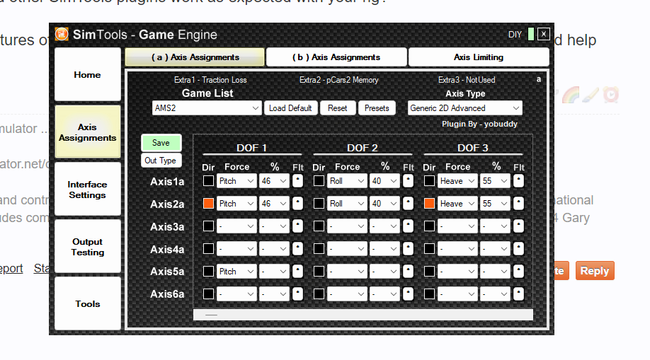

    Hi Have you ran the tune on it if not reset and capture race without hitting the wall then save make sure you complete one lap.

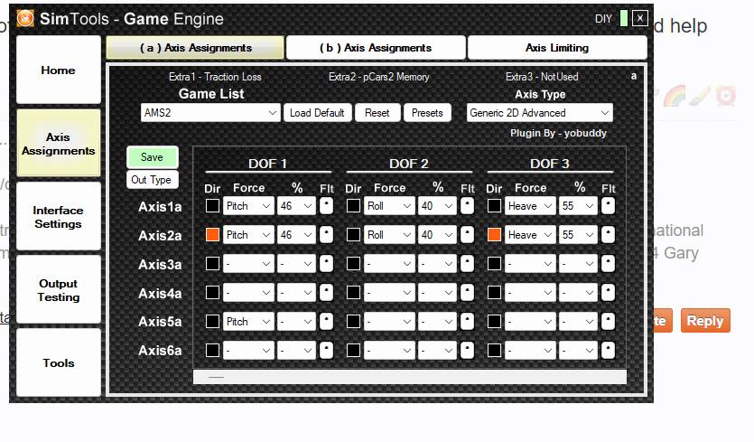

    these are my settings but its dependent on the type of rig you have setup

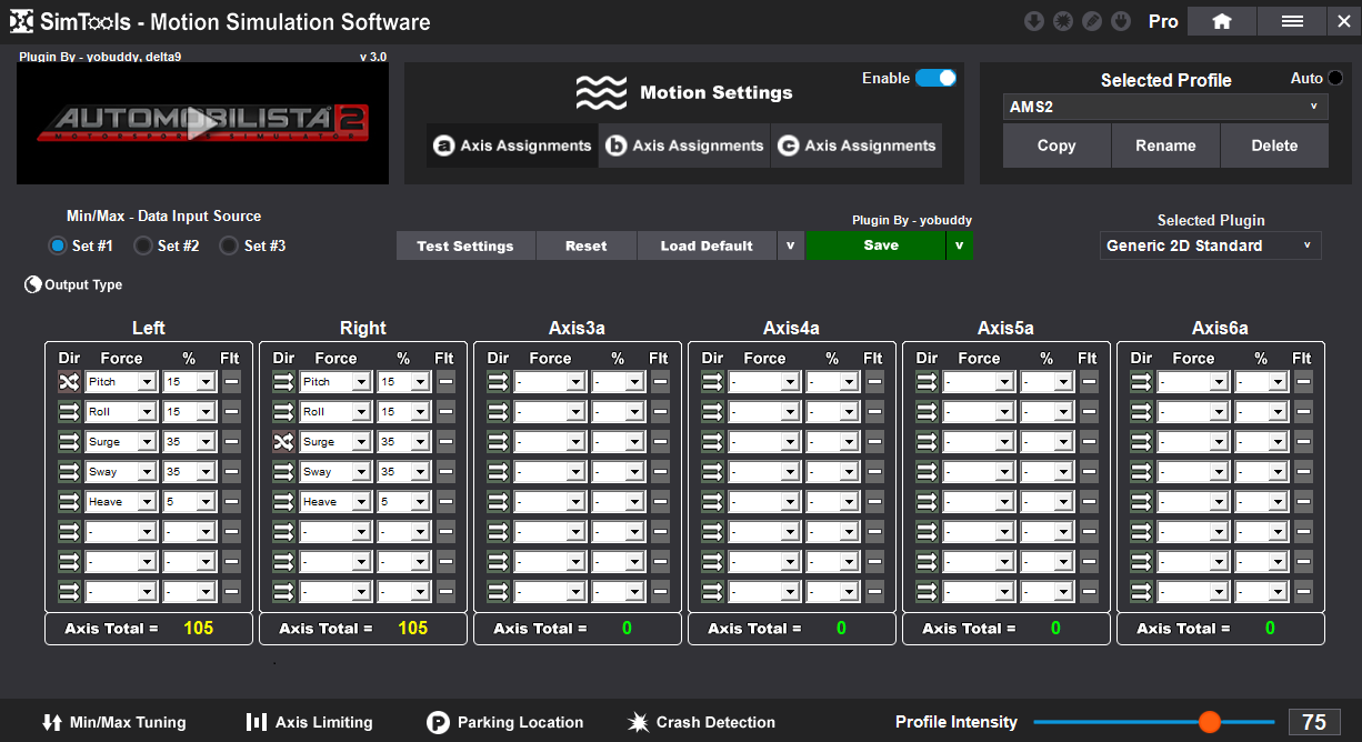

    Hi Bro and thx for helping, got it working now. I set the game like my other Games in SimTools, but with that game and my other games it feels like there iss a lil bit too much motion going on. Even when I use the remote of my njMotion Seatmover (there are 3 diometers, one for the short motions, one for long motions, and one for the overall motion) and set the overall motion to some low settings, it feels like I feel to much street/ground effects. For example, when I drive a normal straight road without any holes or rocks on the ground, it feels like there is always a lil bit motion. Is that normal or did I set something wrong? I attached my settings for you maybe you can help, thanks and have a nice Day :D

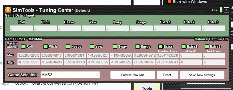

    Have you captured then refined the Tuning Center values?

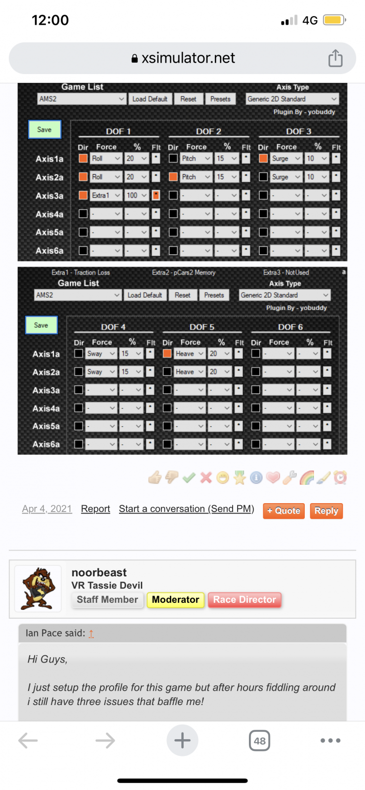

    Hi Bud try these settings
    https://www.xsimulator.net/community/threads/automobilista-2-plugin.14505/page-4
    See how you go

    Hi Bro, does I have to capture and then refine the Tuning Center values for every Game I play with my njMotion? (I mean only adding the % entries in every game as shown in my screenie above isnt enough)
  15. noorbeast
    22,202
    154,675Coins
    +11,209 / 57 / -2
    Yes, each game requires setting up and refining a motion profile that is tailored to your rig, unless a manufacturer provides them. Though in practice once you have a good Default profile for your rig you can clone it for a new game, capture the Tuning Center Max/Mins and tweak settings from there.

    thats the settings profile for my seatMover. Or do you think that what I have setUp in my simt00ls is a good Default profile? (pitch15/roll15/surge35/sway35/heave5)
  17. noorbeast
    22,202
    154,675Coins
    +11,209 / 57 / -2
    Manufactures can provide settings for their rigs, given known hardware and characteristics.
    Defaults are specific to a rig and I can only guess, but would think something like: pitch25/roll25/surge20/sway35/heave10 = in total 115%, a little over but it is unlikely all axis are at their max except in a crash, and the fidelity of motion in a crash is not really important. It is important to capture and tweak the Tuning Center values for each game.
