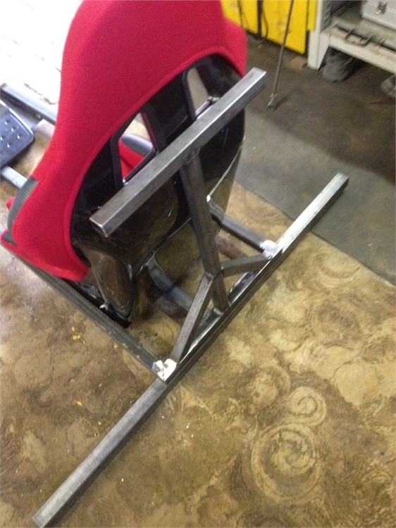

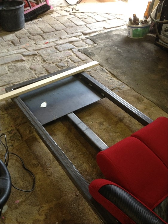

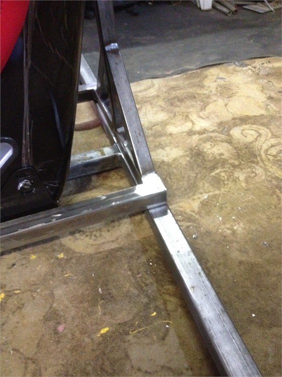

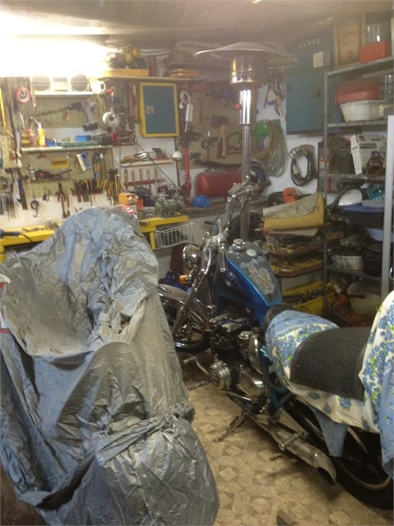

    Our first pics - I´ll do that project with my girlfriends father, cuz he got more room and stuff for that and is good in welding.

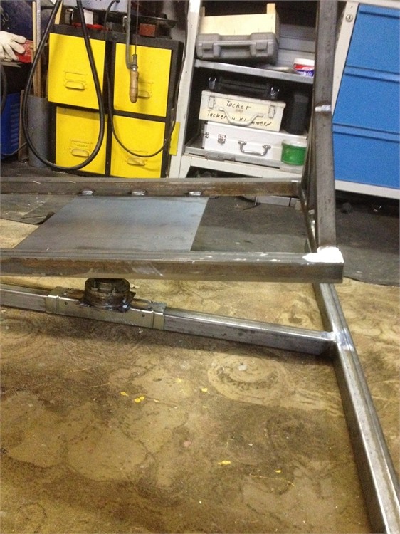

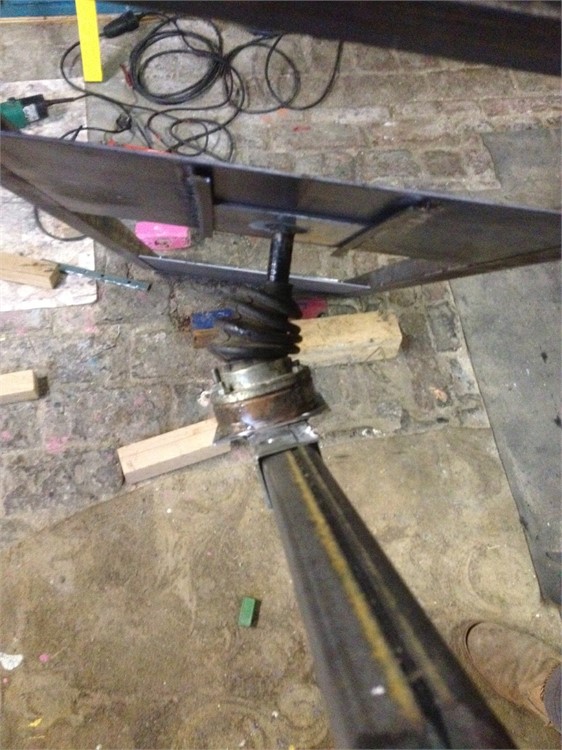

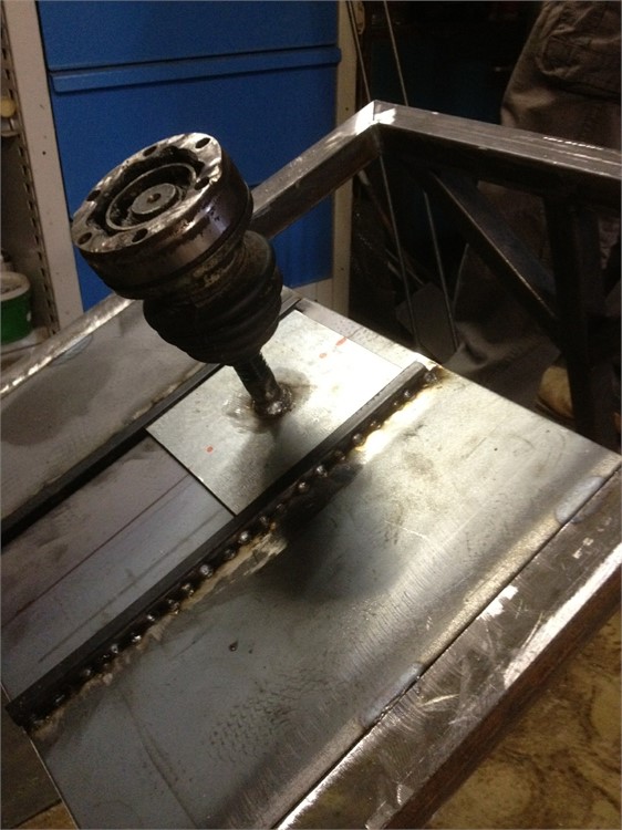

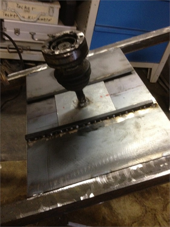

    The universal joint - We want to make it flexibel so we can adjust the "pivotpoint" when the other stuff is mounted. Maybe later we`ll do a "weight-display-sticker" on the rack to adjust the position for driversweight ! :

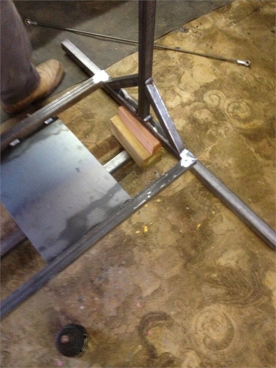

    We can adjust the upperside and the bottomside.
    ...the bottommounting is prototype.... :

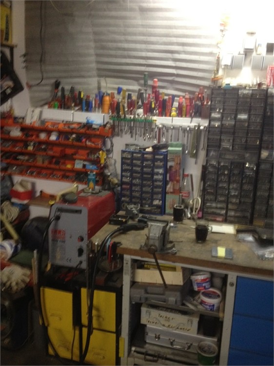

    Our Workingplace :)
    That was the first pictures...

  11. Historiker
    2,162
    9,208Coins
    +2,170 / 19 / -1
    Hi Mario, Sounds like you have everything on track! :)
    You can also look for non-buttkicker bass shakers, I use Aura 50 ohm units. They are massively cheaper than Buttkicker brand transducers.

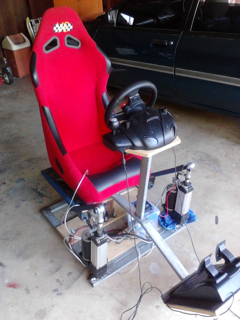

  16. shanothegreat
    shanothegreat Member Gold Contributor
    Dec 12, 2011
    43
    Technician
    Melbourne, Australia
    496Coins
    +25 / 0 / -0
    2DOF, DC motor, JRK, SimforceGT
    If you make the top and bottom mounts adjustable you will also have to make the motor mounts adjustable to keep the geometry of the wiper motors consistent.
    Keep up the work its always good to see inovative ideas, we all learn.
    I would be interested in seeing your bass transducer set up.
  17. Mario Reinecke
    Mario Reinecke New Member
    Sep 17, 2013
    27
    Kassel Germany
    587Coins
    +16 / 0 / -0
    Thank you all :)
    Yes, making the motormounts adjustable might be the hardest thing.
    I have an idea.
    Will see if it works next weekend..

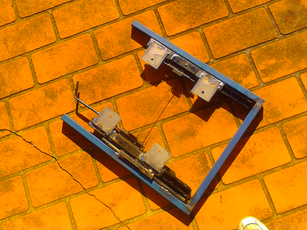

  18. bsft
    Heres what I did ages ago with a set of seat rails, the pivot is mounted on a sheet of mdf and the motors connect to the outside. The actual seat frame with full frame connects to the inside of the seat rails allowing adjustable pivot and weight balance
  19. Mario Reinecke
    Sep 17, 2013
    27
    Kassel Germany
    587Coins
    +16 / 0 / -0
    wow, thats a really good solution !!! maybe i can use something of that.. Thank you bsft !
