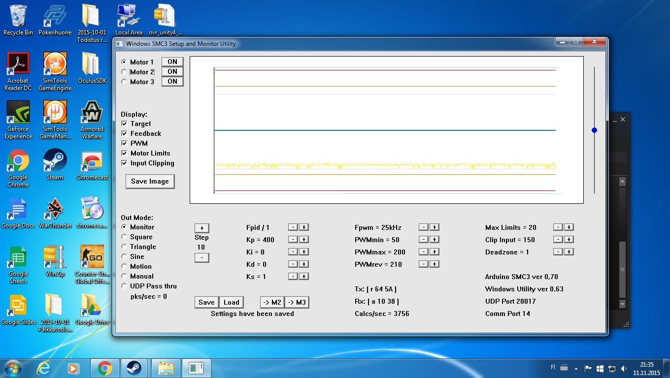

    When i sit in chair it feels balanced because if i put SMC3 setup and monitor utility on and set the deadzone to 1 motors start make some noise and if i move hands to back it stops. So i think it so close to pivot what it could be. The Kp is set to 700 so maybe this is the reason? I think i tested those settings and forget to change it back to 400

    Motor was still hot if i don't use fan. But i found maybe other solution. my PWMmin was 50 and as you can see there is some weird PWM signal so i put PWMmin to 20 and next i test if that solved the problem. Can you tell me is there some other problem what you maybe see because i get blind to my own errors :blush

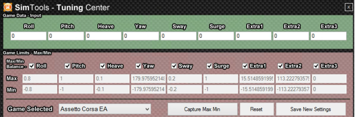

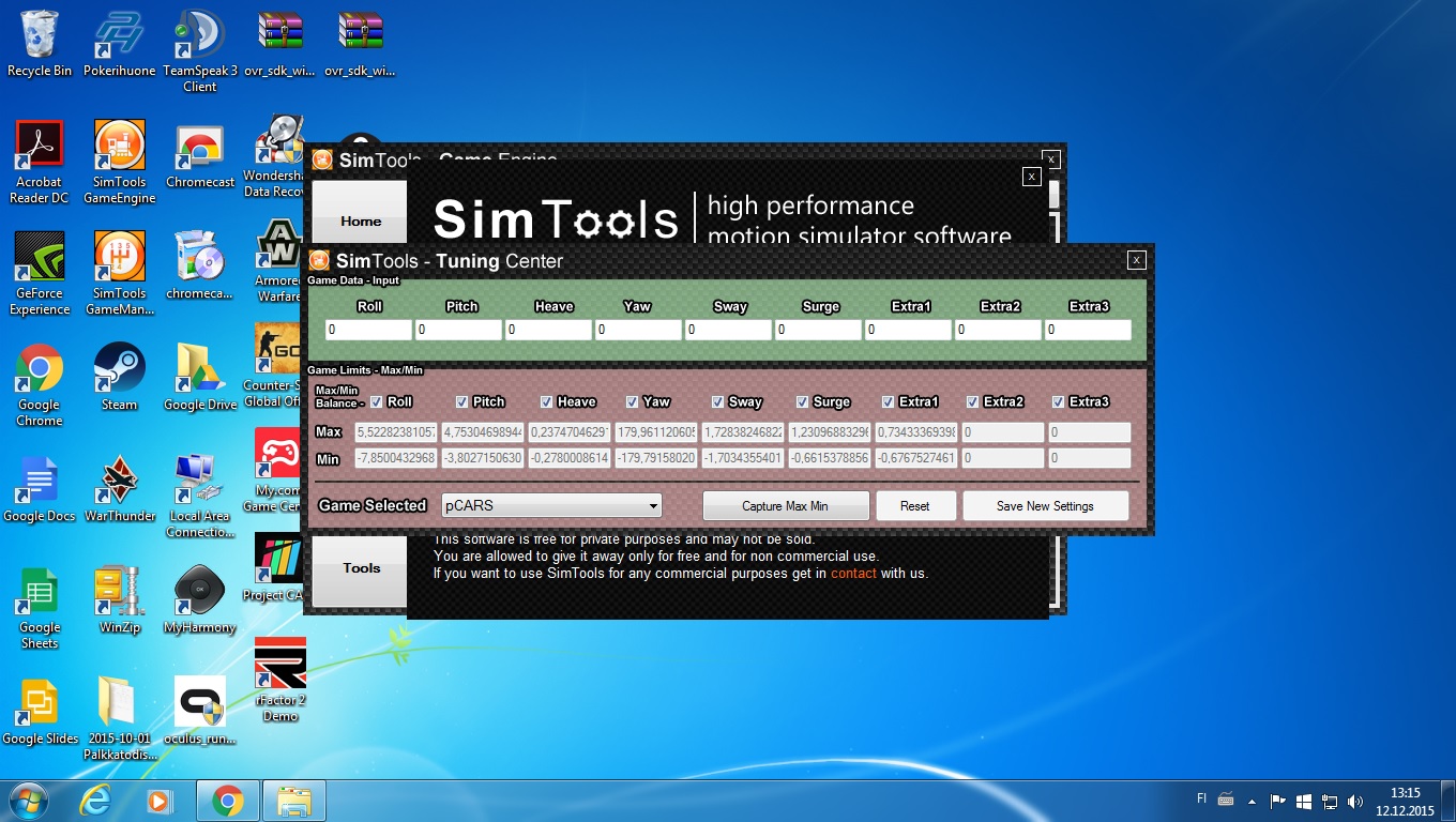

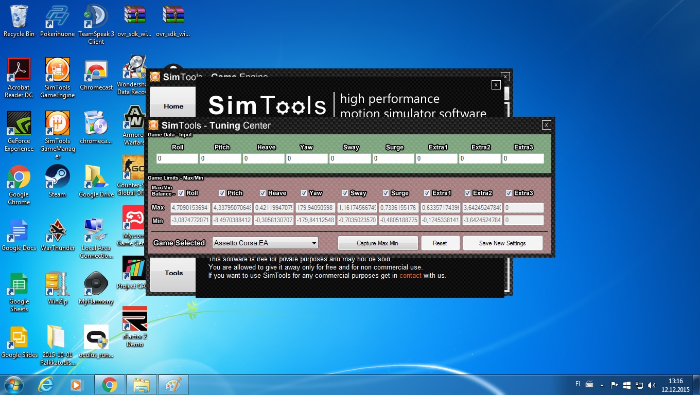

    What kind of tuning center profiles you have? I try to get some road vibration movement and in pcars i get some but ac feels like i drive some superdampered car without any bumps. I'm so totally lost because sometime when i put different settings in tuning center it feels better but then i try pcars and find that it have better immersion.
    I put my AC and Pcars profiles here if someone could tell whats the main problem because i don't see it.
    22,185
    154,750Coins
    +11,196 / 57 / -2
    Unfortunately it is impossible to get a sense of tuning center values without at least a comparative video to go with it. To complicate matter AC and PCars handle physics differently, particularly with respect to gravity, so differ significantly in the motion profiles you develop for them.
    Generally getting heave sorted will help with road vibration. Like any other setting you should first turn every other force off, tweak the Axis Allocation % in SimTools and then refine the Tuning Center values. The lower the number in the Tuning Center the sharper the response. The lowest setting possible is 0.001.
    Once you have heave pretty good in AC for a medium range car like the Corvette you can tun every thing else back on and see if it needs any additional tweaking. Then you can set up individual car/track tweaked profiles in Game Manager. So things like the Cobra will likely need heave increased in the custom Game Manager profiles, while others like the Lotus 125 would likely need heave decreased from the default in the custom profile

    After several settings i get improved feeling in AC. I found out that it have so different bump feel that it was hard to set same kind like Pcars. I'm not sure but it feel like AC bumps are all the same kind, maybe it's my settings what cause that but i'm not sure. example if i ride Spa long straight there are several bumps what feels same kind and with Pcars there are different bump heights if you understand what i mean.

    Maybe you need to tune your values in Tuning Center. What effects are you using ?

    Here is what I have set...very different from yours

    Oh... You are using very low values in axis assigments too I guess o_O

    Yeah, and I use 50:1 gear motors and JRK's. I get really good motion.
  10. Nick Moxley
    17,057Coins
    +2,507 / 30 / -2
    Holy POOP is that Heave low. are you serious you need to go .1 for heave to get the detail shannon ? I rock 1.8 with some filter's in the backround.....im kinda baffled how your's needs to be so low.
