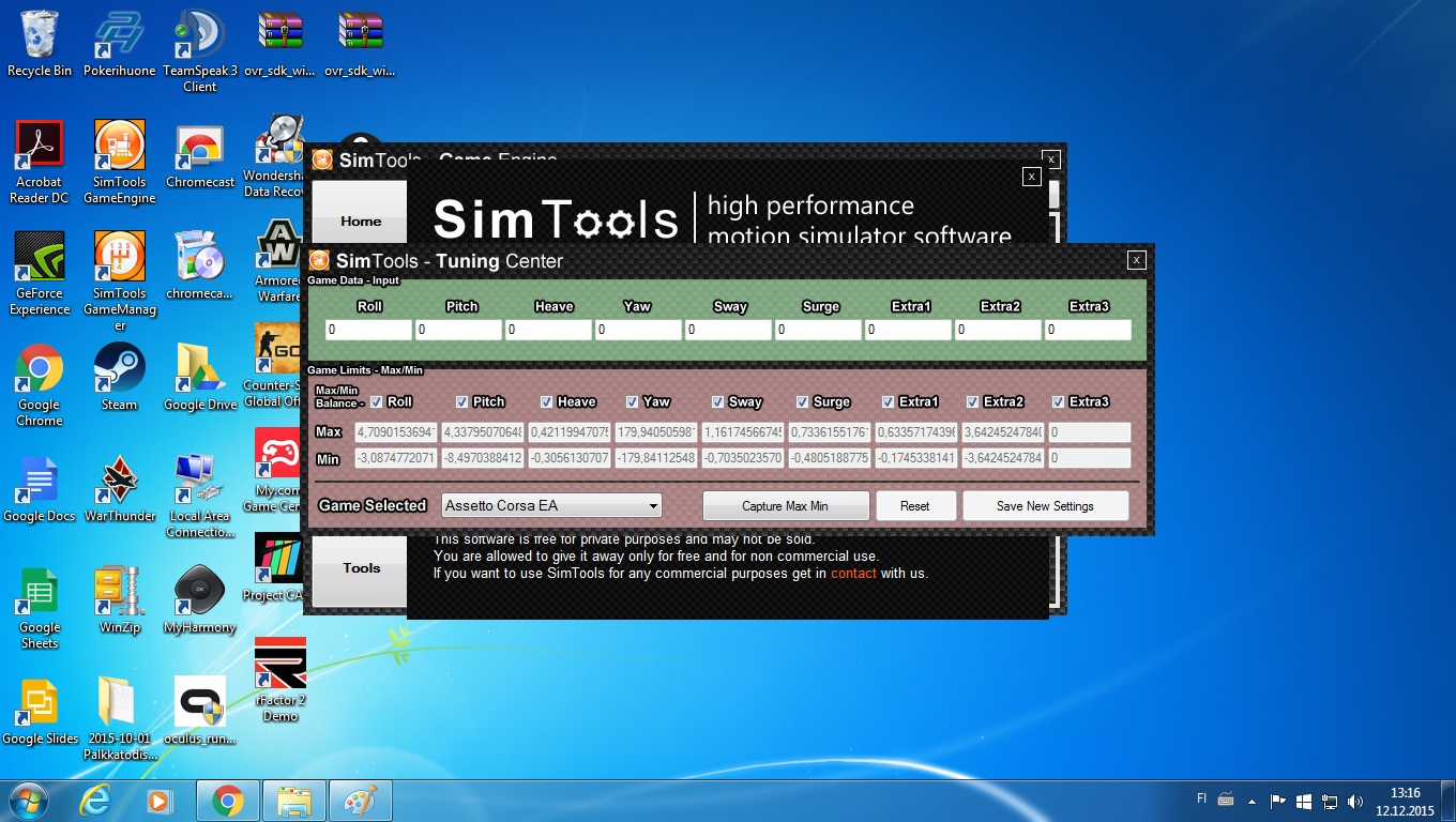

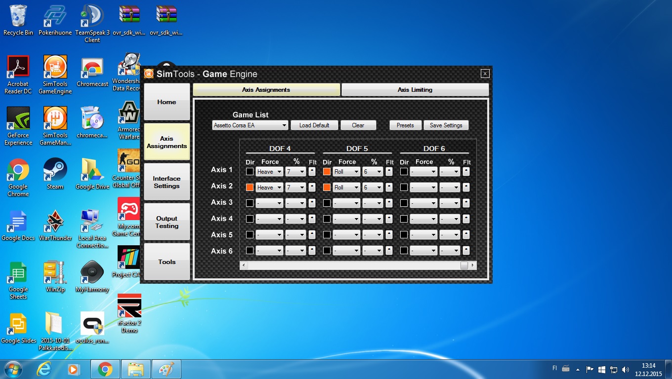

    :nerd. There are so much what you can learn in this project.
    21,635
    151,467Coins
    +11,039 / 56 / -2
    You seem to have very low axis allocations for the likes of sway, mine is something like 40, and some of the Min/Max Tuning Center values like for sway seem equally odd, as I would not expect to have a variation there.
    I would suggest stepping though the steps for creating a motion profile, starting with 20% Axis allocation and tweak from there: http://www.xsimulator.net/community/faq/steps-to-create-a-motion-profile.228/
  3. mrbeginner
    mrbeginner Active Member Gold Contributor
    Apr 8, 2012
    153
    What ever come in my way
    Finland Niinisalo
    - 10Coins
    +55 / 2 / -0
    I been setting all step by step when i first time try different forces and i'm satisfied with these. Maybe it's still time to reset all and go again.. Just save my previous settings and try if all come back same kind when starting in zero.
  4. Nick Moxley
    17,056Coins
    +2,506 / 30 / -2
    Wipe clean and start fresh
    Dont use the "capture min max" value's....Input your own as Whole #'s like .1 or .2 or 1.5 ect ect....easier to remember whole #'s.
    Also As Noor said Certain forces NEEEEEED to be the same, Roll, Sway and in particular. having those offset will cause a serious issue.
    Next CRANK up those Axis %'s you can be a total of 150% and be safe with a standard 40cm up 40cm Down on your 65mm lever setup....Especially in AC, you'll never see any values in game to max out that 40up 40down.
    And as usual, ASK question's if you dont understand something, were here for ya bud.:cheers

    When you watch too close you don't understand what is your problem.. I haven't see those sway and roll differences because i just try to set heave and surge on right feel. I start to beginning in AC and first i get car motion in right when driving norshleife. I like to do this first because this track has so much roll, pitch and heave movement that you can feel like you are in real car. After that, those surge and sway are much easier to put good level because you can adjust those with and without car movements. By the way i change those tuning center values in 0,1 precision. I don't know what i was thinking before... Thank you for your help! Now i get little tune up and after that i put values here so maybe someone get little more help for settings.

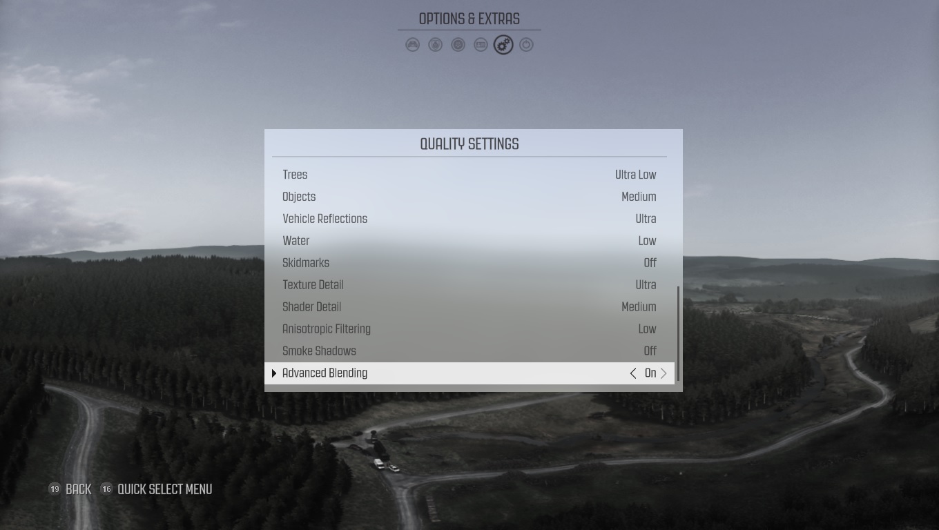

  19. mrbeginner
    Apr 8, 2012
    153
    Finland Niinisalo
    - 10Coins
    +55 / 2 / -0
    Now i found out what was problem with Dirt rally. If i put advanced blending in settings of then sway amd surge won't work. Have anyone get the same problem? advanced blending.jpg
  20. shannonb1
    shannonb1 Well-Known Member
    Mar 12, 2008
    1,107
    Sales Intelligence
    Virginia
    8,909Coins
    +598 / 5 / -0
    I have no clue how a GFX setting would affect direct data...you got me....
