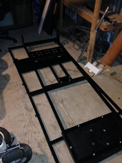

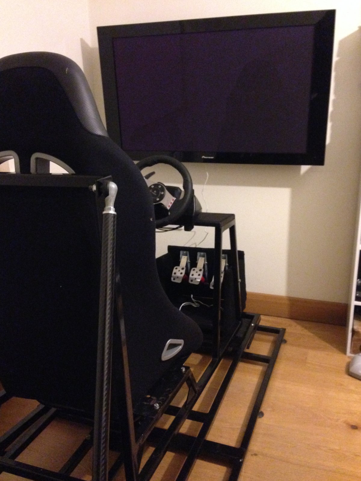

    Well I just ordered some bolt on adjustable feet for the base of the sim. Have to try and get it ready for powdercoating now. At least if I have the frame finished I can potter around with the electronics.

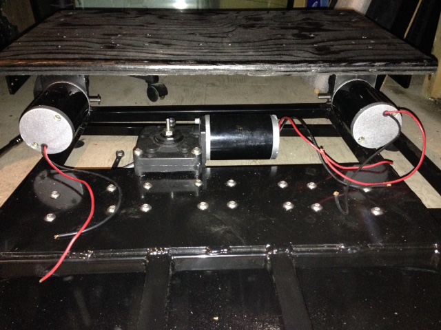

    Base frame is now drilled and captive nuts are ready to be installed for the feet.
    The frame is going off to get blasted and powder coated next week. I'm finally getting there with this build. I'm looking forward to getting it all put together when it comes back.

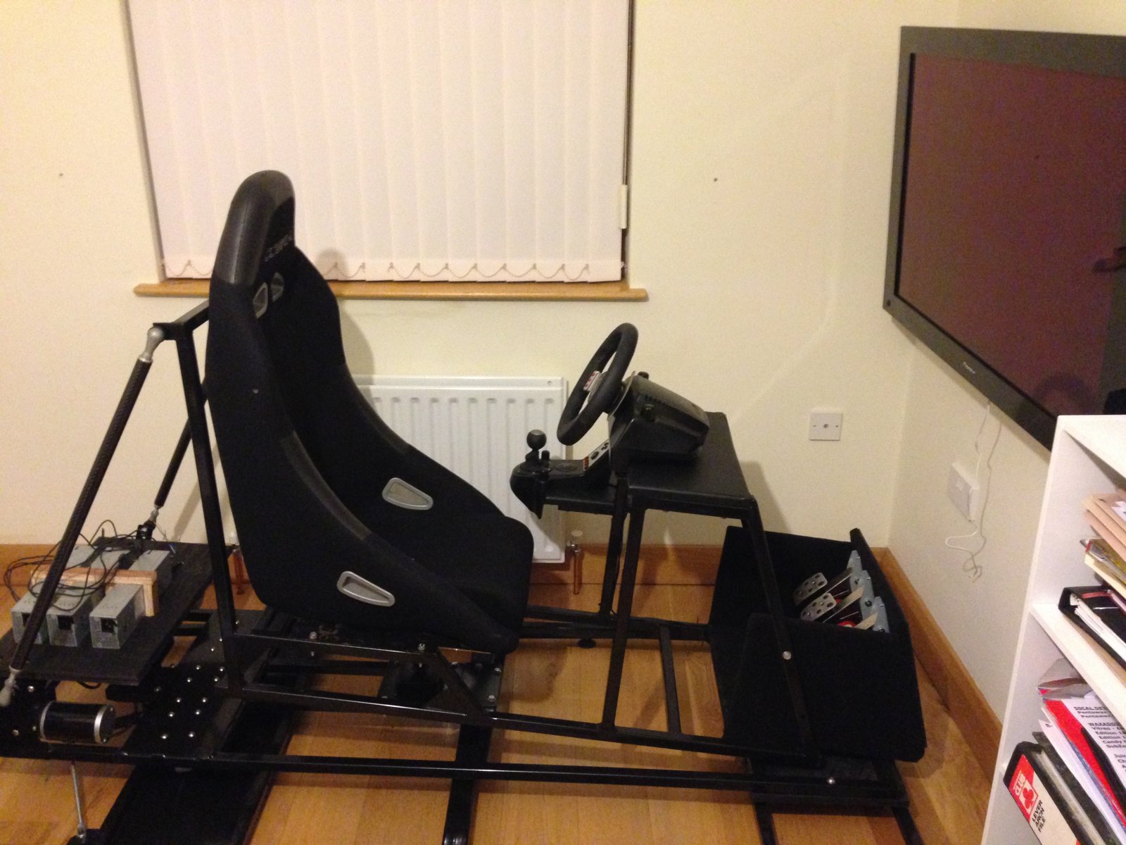

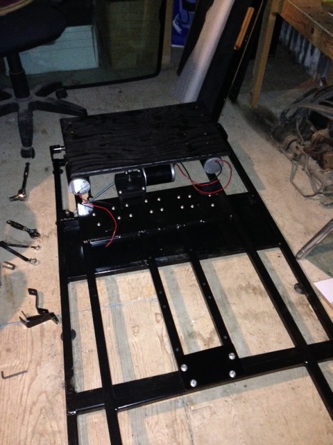

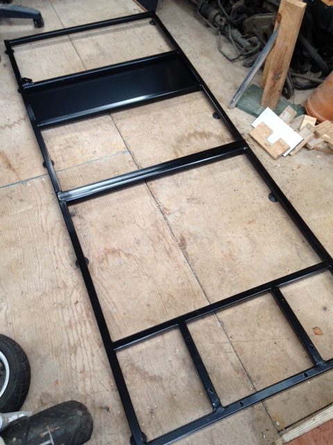

    It's been a while but my frame finally got powdercoated and looks amazing. Time to start reconstruction. I only have one change to make and that's to get a larger U joint for under the seat. I've been very busy with my business and I've also been working on my arcade machine too so I'll post some pics of that.

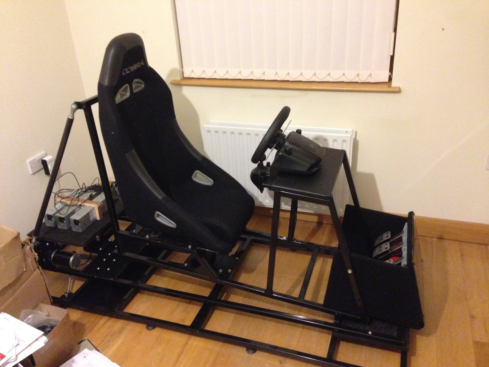

    This was a long time coming. Just a few wires to connect and it's time for testing.

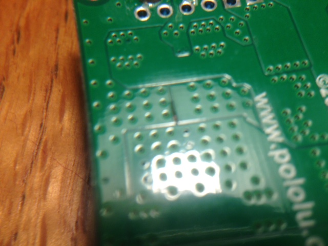

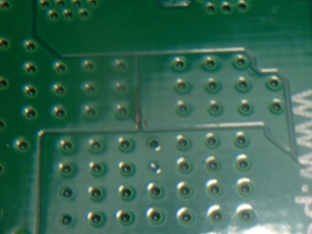

    Well, looks like I have a faulty JRK. NO power being sent to the traction loss motor. I've swapped a JRK and the motor is fine so it must be the controller. DAMN!!
    Always a hurdle, just need to figure it out and get it fixed.

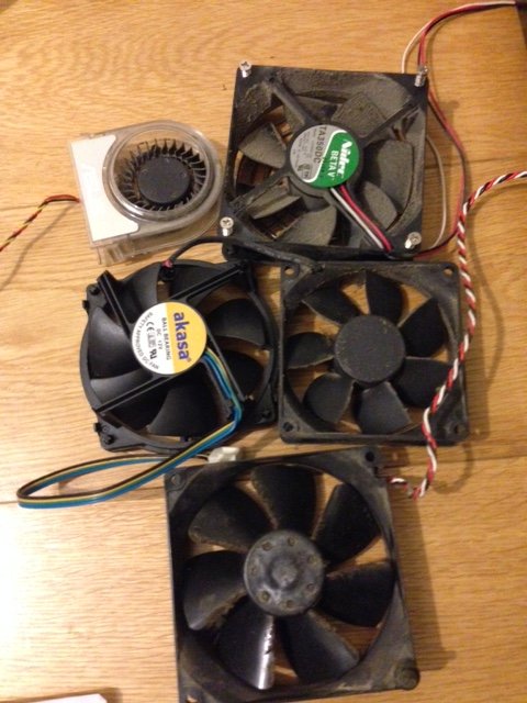

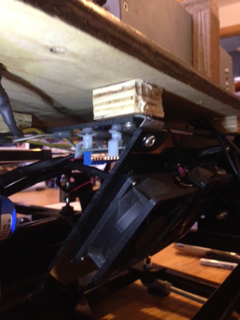

    Now... FANS. Would 2 x 80mm pc fans blowing air onto 3 jrks with small copper heatsinks be enough to keep them cool?
  10. Nick Moxley
    17,057Coins
    +2,507 / 30 / -2
    heatsinks dont need a Tonne of air flow per say....., as long as you have the air passing over the sinks, your good.

    Do most people wire their fans direct to the PSUs powering the motors?
    I just mounted 2 fans and realised one is way faster than the other. Lol
    Back to my pc graveyard to see if i have another good one....

    Looks like I need to rethink my fans. I think it'll mount them directly facing the JRKs. One of my controllers isn't getting enough airflow because of the way I mounted them in a staggered pattern. I didn't let them climb above 40 degrees before shutting them down. Last thing I need is another one failing. I also took out the busted JRK. I included a couple of pics. There's a bulge on the chip and some kind of de lamination on the bottom of the board. Some day soon I'll get this damn thing running. IMG_0332.JPG IMG_0342.JPG IMG_0336.JPG IMG_0339.JPG IMG_0341.JPG

    IT'S ALIVE!!!!!
    I mounted 3 x 50mm fans so one is facing each jrk about 2 inches away from the board.
    Reset all the settings, reinstalled simtools because I had an error that wouldn't go away from the project cars plugin. I fired it up with Dirt 3 and experienced the sim running fully for the first time. It feels very smooth. Very happy that it's all running although I'm still concerned about the JRKs running pretty hot. I understand that this is normal for them to run pretty warm but i'm not sure how far i can push it at the minute.
    I have a feeling I need better heatsinks and this might help with the issue.

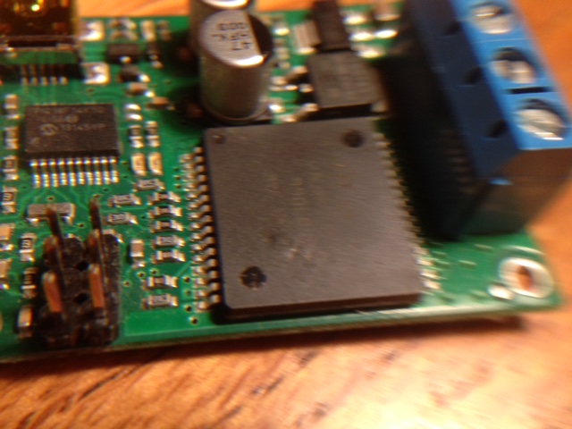

    I seem to have a JRK issue.... again, or maybe a settings issue.
    As the faulty JRK i had nearly broke my wrist the first time I set it up I was wary about doing it again but decided to give it a try today. I set up the normal settings to play project cars and dirt 3 and during play one of my JRKs started running very hot and flipped out so i had to hit the emergency shut off. This was after maybe only 5-10 minutes of the sim being on. I'm not sure if sim tools crashing caused the issue or one of the settings caused the JRK to go mental and then crashed simtools.
    Not even sure where to start to diagnose it but i have my fans running cooling the controllers at the minute and i need to try again to check i haven't damaged something. Is there a process I can run though to test. I have a feeling that if I start the JRK utility that it doesn't close down properly and may be responsible for the overheating.

    You cant run SimTools and the JRK utility at the same time, (at least with Simtools V2.5, 1.3 you used to be able to, but moot point)
    Dirt aka Codemasters data is rather sketchy at times and yes if your tuning center isn't very well polished and you have aggressive setting's, i can see it contributing to a Drop out, be it Power side (PSU's) or USB Side due to signal noise. When you say "running very Hot and flipped out" What do you mean exactly ?

    ok, so when I say flipped out:
    The motor lever dropped basically to a resting position (as if the motor power was cut off) out of it's normal range and basically just made a vibrating and clicking noise. I shut it down with the cut off switches within about 2 seconds. When I felt the heatsink on the related controller about 5 seconds later it was very hot.

    It sounds like the the motor is forced past its proper operating range and it creates a huge load on the JRK trying to recover.
    Is your sim properly balanced and do the motors get fairly warm under normal use?

    thats more than a few kg to one side and forward to overpower the motor's gear ratio (as weak as 25:1 are) when not powered. IMO you are Not balanced properly, Tho that technically shouldn't cause a motor to overheat per say.
    The Vibrating and twitching you felt was 100% the motor being pushed out of range and then you maintaining said pressure on the motor causing it to cycle the max duty and eventually If not stopped Via Kill switch will kill the Connection due to Motor driven errors. Or will manage to work itself back into range, if you lift the pressure on the motor and allow a duty cycle pulse to jump it back into the window.
