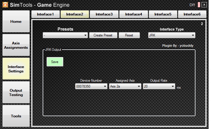

    ok, so I just tried project cars and i have all 3 motors firing up but for some reason on my traction loss motor it just sweeps back and forward a few times as if it's hunting for position, then stops, then simtools crashes in the background.
  3. Barry
    Barry Active Member
    Mar 20, 2014
    398
    Web Developer
    Northern Ireland
    3,877Coins
    +251 / 2 / -0
    ok, so back to the jrk utility. I inverted the feedback and hey presto, a motor that is now cooperating. I tried it on dirt 3 and although it was moving the opposite direction to the car it appears to be functioning with the game feedback. (Now corrected in the simtools game engine.)
    Next question. How do I tone down the traction loss motion. It's a little too sharp and probably snapping from one side to the other a little bit much. Would it be advisable to simply shorten my pivot point on my lever on that motor?
    My right hand motor controller is no doubt showing signs that it heats up slightly more than the others. I'll keep an eye on this for now. I'm confident that my fans and heatsinks will do their job as long as i don't push my limits.
    Might that have anything to do with reversing the gear in the gearbox? I don't assume so as i've seen so many others doing it.

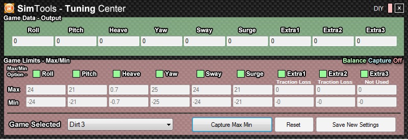

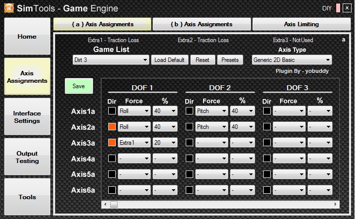

    JRK's can and will die over time if you push them. I suspect your right side is on the way out.
    To help further, Axis Settings and tuning center screen shots please. No you dont mechanically de tune the traction loss, you do that in tuning center.

    ok, here are some screen shots of what i have. I'm not totally clued up on all these settings yet, so i tried my best to stick with average or default settings.
    Let me know if you need anything else, even the jrk utility screen shots.

    Anyone got any suggestions about my settings shown above?
    The traction loss is very snappy and moves erratically and rumbles and bumps even when the car is stationary at the start of project cars. Do i need to have smoother settings somewhere or some kind of dead spot in the middle?
