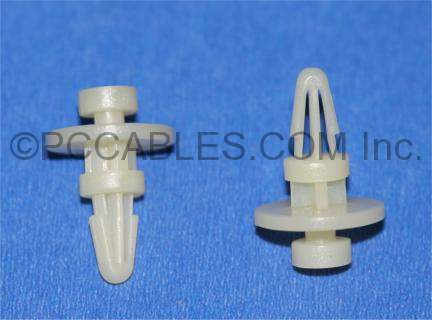

    Another small question I have is how people have attached the JRKs to their mountings. I'd love to have a nice professional looking finish and I've seen some great builds on here. I'm looking at motherboard standoffs and trying to decide what way is best to screw them down to hold them nice and steady in the rig. What's everyone's options on brass standoffs screwed into metal vs the plastic ones which click into place through the holes?

    I personally use little plastic posts and glue them in place and for screws, I have a bunch of small hardware from my Rc stuff i can use as seen here.

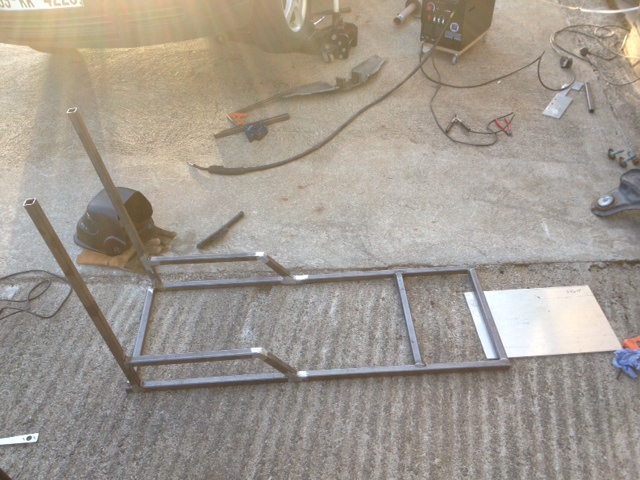

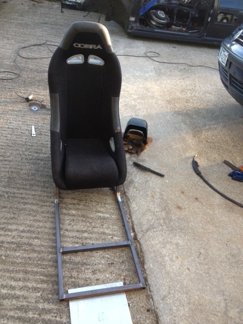

    Right. Here we go again. Bit of a slow build this one. But here's a small bit of progress. I got the mounts for the seat done yesterday. This will get a couple more bars across and a couple of fillets for strength but it's taking some shape now. Next up will be mounting the seat properly and getting the pivot point below the seat dialled in. I'll be cutting the frame for the steering wheel and pedals too.
  17. RacingMat
    2,233
    21,054Coins
    +2,092 / 21 / -2
    well done!
    it's becoming a simulator now :)
  18. Den Krutko
    Den Krutko Member
    Apr 10, 2015
    37
    Engineer
    Ukraine
    364Coins
    +34 / 1 / -0
    2DOF, AC motor

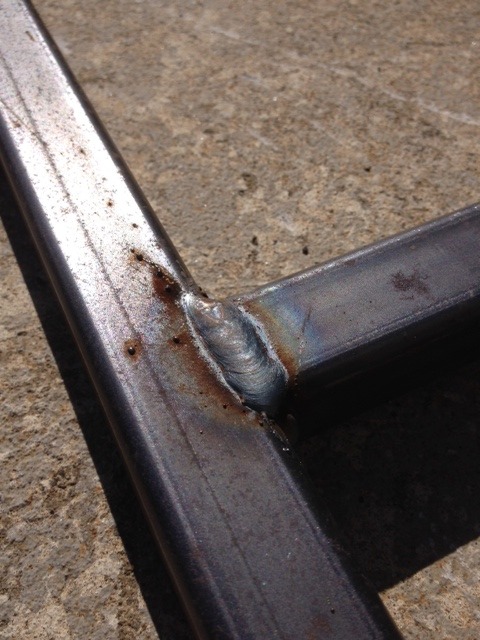

    Nice welding quality :thumbs

    +251 / 2 / -0
    Thanks. I'm more of a grinder than a welder though. My welder is a little fussy as well so it doesn't help.

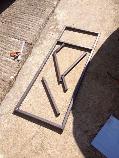

    I hope to have more of the frame welded this week and I need to make some more plans about the bottom section of the frame and the mounts for the traction loss part too.
