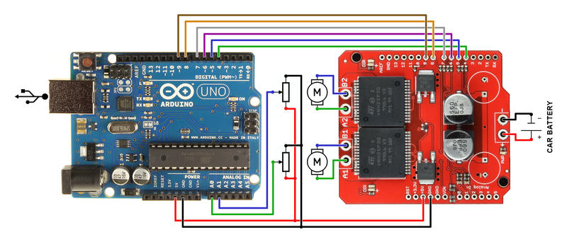

    I am might be a bit biased but SMC3 is the best code to run on arduinos especially with the utility you can change everything on the fly. I dont know if the wiring is different to what your using but if you do use it you wont be dissapointed :)

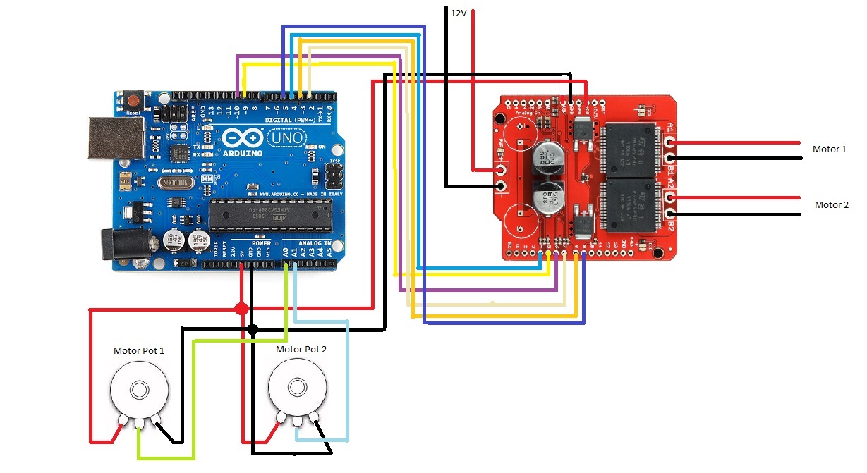

    This is my wirering. Can you tell me, is that ok for smc3?

    Yes, i need a rewireing. But i will do... :) I report here, if i have some news.

    That's the way SMC3 is wired up so if it's the same your good to go :)

    Oops I replied straight from email didn't see your other replies .
    Yes you will need to slightly alter the wiring

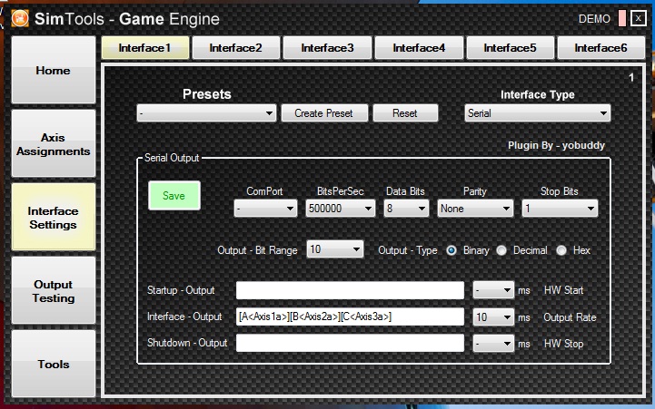

    Hey, i have rewired the needed pins and loaded up the new code for my arduino. If i turn my pods, all is working correctly. And it looks smoother, than my old code. The smc3 software connects perfect..i can change all values. But one problem is left! On output testing mode in simtools, nothing happens, if i move the slider. Should i change some things, in the interface settings? On post #22 here in this thread, you can see my current settings.
  8. stevemontuno
    stevemontuno Active Member
    Apr 24, 2015
    316
    UK
    1,461Coins
    +335 / 0 / -0
    Make sure you have both motors checked to ON and then close the smc3 utility down before you start simtools,,,.. it should work then.
  9. insanegr
    insanegr !N$@n€
    Jan 14, 2014
    503
    Athens
    16,726Coins
    +499 / 1 / -0
    you have to configure the default axis assignment profile in game engine to manually control your motors through simtools. also check if you have configured your interface settings right for SMC3

    It's already worked with the racing mat code. But my question was: have i to change, my settings for smc3... and in my search, a found a post from you, with this picture. I think, this are the right settings:

  12. insanegr
    insanegr !N$@n€
    Jan 14, 2014
    503
    Athens
    16,726Coins
    +499 / 1 / -0
    yes those are the settings. delete the third axis, you only need the first two for your 2dof sim

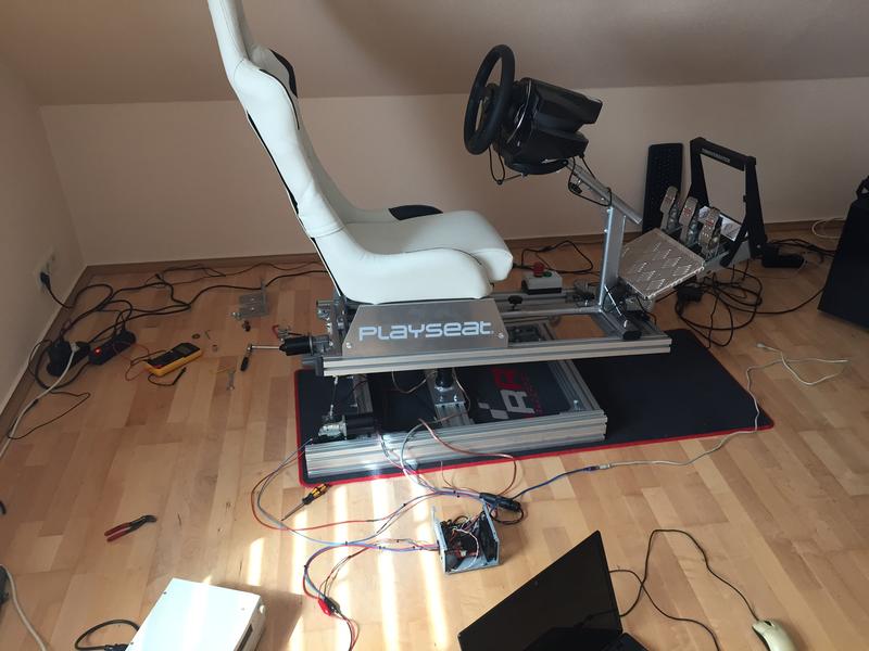

  19. Bastiuscha
    Bastiuscha Active Member
    Apr 1, 2017
    291
    750Coins
    +192 / 2 / -0
    My rig today... i'm a short step befor my first ride. YEEEAHH
