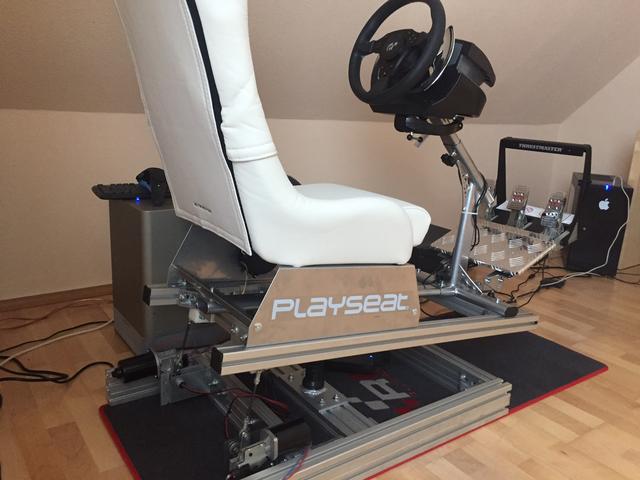

    great! neat and clean :thumbs
    did you center the center of gravity (plateform+ driver) above the Ujoint?

    Looks great, @Bastiuscha!
    You were concerned about using the smaller extrusion on the upper frame. How do you like it now that you have it all assembled? I'm curious because my setup will be pretty similar.
    But congrats! Looks really good!

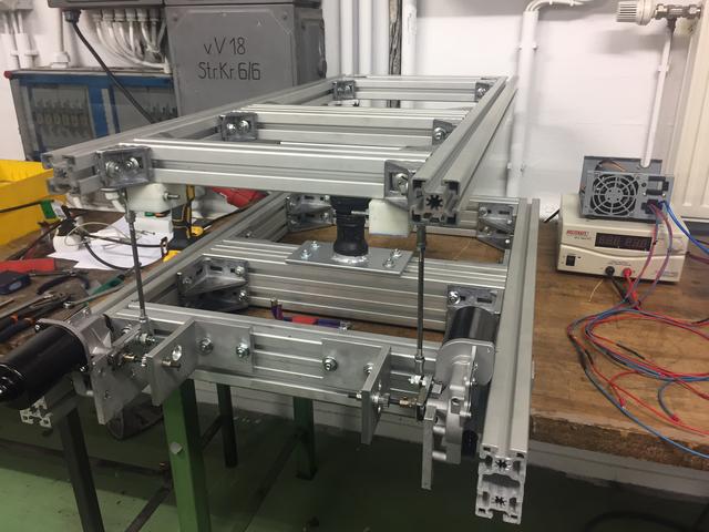

    @RacingMat
    thank you. If it's complete final, i will show photos again. And yes the pivot fits perfect for my body. But i can tell, my wife is much lighter than me, and the pivot is near the same. That is really cool.
    @Zed
    The upper frame was planed smaller, but "plans..." hehe. On this picture it's difficult to see, but here you can see, that only the lengh is shorter.
    But maybe i will strech the lower frame length. And your second question...can't tell exactly at the moment. Better i tell you, if i have some hours ride after me. At the moment, in my opinion, the upper frame could be a little bit lower. To high, brings the balance point senseless to high and simply make it difficulter, to getting into the rig. "boarding" ;D

    Those rods look quite slim so there is a possibility you might have a problem with them bending at some point ,,,,, adding stainless bolts is a nice cheap way to strengthen them,,

    Not sure what you mean. I can't see your picture. The bolts himself in my calulation are strong enough. But please explane me better, what you mean. A saver contsruction is always welcome. :)
    Edit: ahh maybe you mean the horizontal bolts...yes, here a good material could usefull. This is a part, i would make better, in my planings. I would use a two sided mount.

    Ahhh now i can see. Hm ok, my calculation of this material say's, thats strong enougth. But why not... :D thank you!

    Btw... my rods are only a half length, like this picture. :)

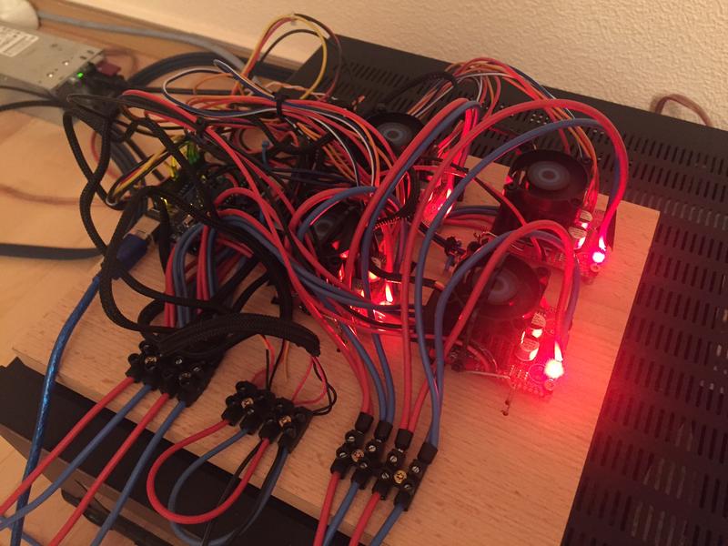

    Today i decided for the bigger motors (max 40A) and ordered them, plus 3 more motorshields, for a megatron configuration! :) :) In the last day's, i had a lot of driving fun. I'm excited, how the new motors will work. Now i plan my new controlbox (arduino + 4 moto shields). I have an old PC case...maybe that will the new house.....
    Here a current picture of my rig. Say good bye to this motors. :D

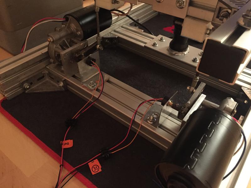

  13. Bastiuscha
    Bastiuscha Active Member
    Apr 1, 2017
    291
    750Coins
    +192 / 2 / -0
    Yehaaaw!!! My own Megatron is awake! :)
    For first... only on a wooden board. :) My motormount is near ready too. I have to fix some small things...and then i give you a photo of that too. Later if i get satisfaction, i will show you a video, of my racing skills. HAHA
    There are so many wires.... difficult, to get this neat and clean. I think i shoud take a bigger plate, with bigger spaces, between all compontens. But for the moment.... it's not important. I wanna ride. :D

    Huuuuhuuu! News from me. :)
    Now i have a pic of my new motors and my brand new Hall sensors, from mexico. :D (UPS sent it in 3 days to germany!!! woohoo)
    With that sensors, my motors are much smoother now. I'm happy with that. Sadly, my motorgears have a little "play" 2-3mm. Hope that don't will be bigger. I will see. But for now, i'm happy. Soon, i show you my promissed video.

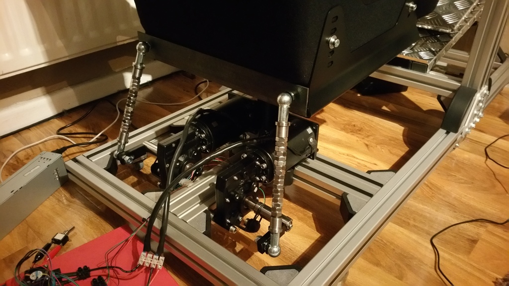

    Hey mates... sadly a long time, i had a mandatory break. But now i'm back! I still LOVE my rig, but i'm unhappy with my motors. Or better: with my gears and arms. The back lash of the gears, is not really good. The motors are strong and fast...and without difficulty, adjustable with SMC3, but the gears destroy that, sadly. And the next problem... i had no other choice, as welding the control arms, to the gear shaft. But for 3 times, it broke after several hours. My mechanical possibilitys are not really good, this is why i think, i will order new motors. And it's not a problem, to order in other country, as my homeland (germany). The main think is: it have to work! In ebay germany, i can't find good gear motors.
    So my question is: can somebody recommend me a good motor for my solution? I mean, a motor, that you really used...not good, because on paper, he sounds good. I need 12V and don't wanna really change, my electrical setup. I search for a motor without big back lash in the gears. And without (i don't know the english description of this) electrical ground on the motor case. And because my servoarm loose problem...a good possibility to assembly a steering arm.
    Much thanks mates...

    All worm gearboxes are going to have some backlash, for lubrication purposes, and the longer the lever CTC the more noticeable the free play is.
    A slight positive weight pre-load on the levers, rather than a perfectly balanced rig, will help make the backlash a little less noticeable.
    Linear actuators are an alternate and are more efficient and you can build your own: https://www.xsimulator.net/community/faq/diy-linear-actuators.248/
    This is about average wormdrive backlash and the greater the lever CTC the more noticeable it will be:

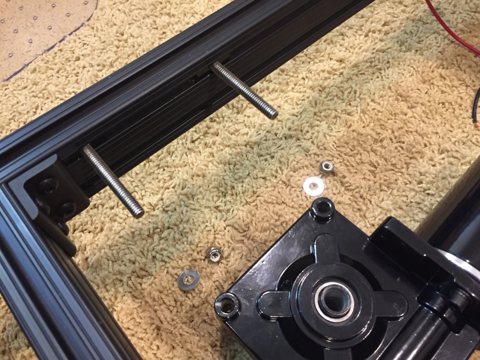

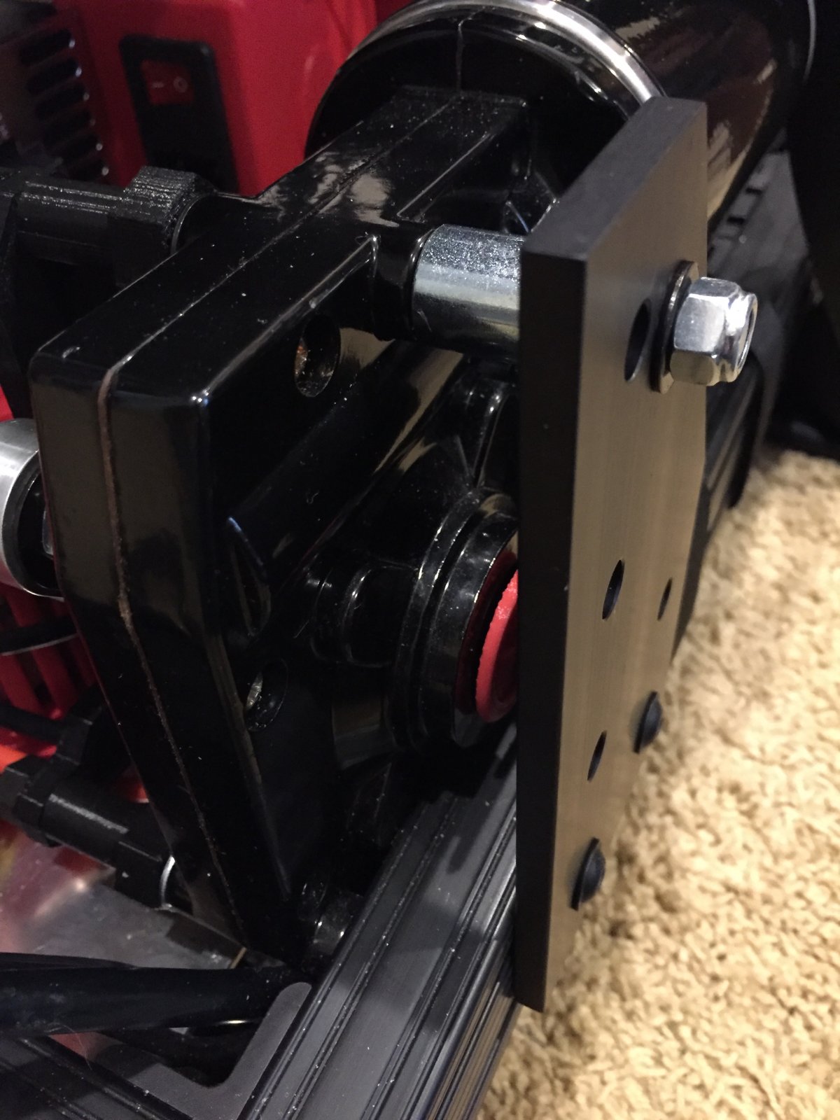

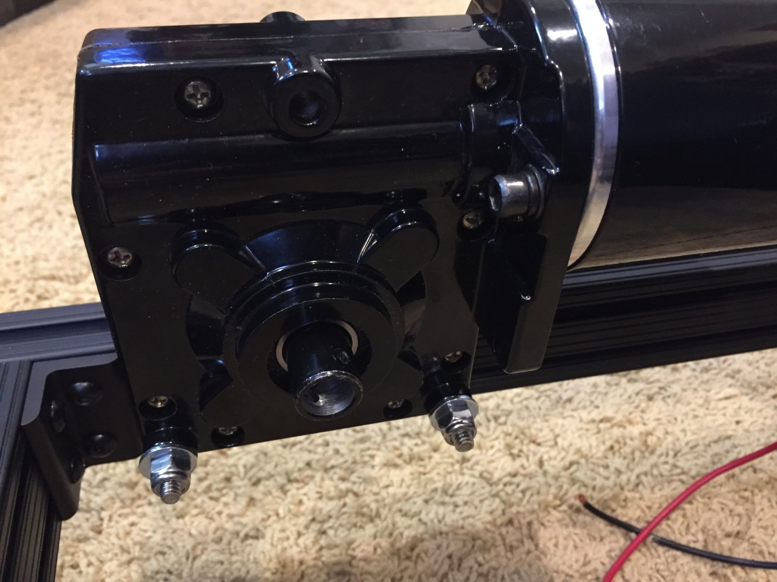

    I don’t have motor mounts per se. My rig is built from aluminum strut so two attachments are just 1/4-20 threaded rods that use the standard strut t-nuts in the strut for one end of the mounting, and washers and nylon lock nuts at the other end to hold onto the motor mount bosses. That was almost enough but I decided for strength to turn the mounting into a box by adding that outer plate and using some more 1/4-20 rod and a 1" spacer with nylon lock nuts and washers at either end to tie the top mount.
    3D4BC506-497F-4D34-8360-ADCADE4CCD46.jpeg E3ACD943-B1C5-4546-A205-8574D4C0C511.jpeg 52F9E797-C2F4-4EE9-AD41-0615D1EF377E.jpeg
    Those look like the same motors as what I got except mine are 50:1 for more torque since my sim is a full frame and needs it. The price is the same as I paid and probably most others that have bought recently from him. Not sure if they aren’t available for less somewhere else though.
