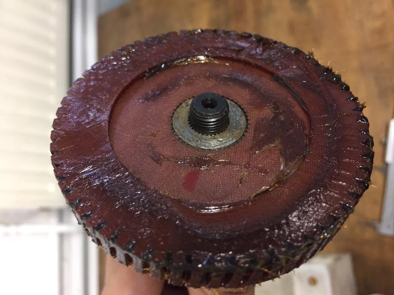

    Thanks a lot again! Yes the 25:1 ratio surpriced me. :grin I will ask the shop, for a 50:1 ratio. Then you can't order me a leverarm again, i will build by my self. Just with a rasp and a drillmashine. That will be a long day. Is that aluminium, or steel?
    For the first, i will change the gear shaft of my motors and i will craft a leverarm like you have. It will be shorter, than my levers...maybe then, i'm already happy. Because, the backlash is better and my lever don't break anymore. If it's not enough, i will buy the pgsaw motors. Apart from that backlash, my motors are really good. :rolleyes:

    Glad to help! I would recommend checking out getting the basic shape machined, though, if you go with this design. It would make sure the key parts are true.
    Here’s a photo that better shows how my friend did the clamping slot. It’s a best practices thing. Not sure that it’s absolutely necessary to do it like this though. The relief in the arm itself is so the arm thickness matches the length of the mounts for the heim/rose joints that I used where the nylon locking nuts would be able to lock. I wanted maximum meat on the output shaft but that was too thick for the heim/rose mounts. And you can see the roll pin in the arm already mounted (https://www.mcmaster.com/#roll-pins/=1ap1emu). I think I used 4mm x 35 mm pins.

    Hey,
    i have some bad news and some good...
    The bad: i can't rebuild a own shaft, because that riffle profile, i can't reconstruct. Because of this reason, i can't use the nicer leverarms. :( I have to buy new motors first.
    But for now, i give a last chance... i tryed a last "perfect" welding. And now, i use a shorter leverarm. Maybe the force is now small enough, that it's will be good for the next time.
    And this brings me to the good news: the shorter leverarm is so much better, for the backlash...it feels so much better now.
