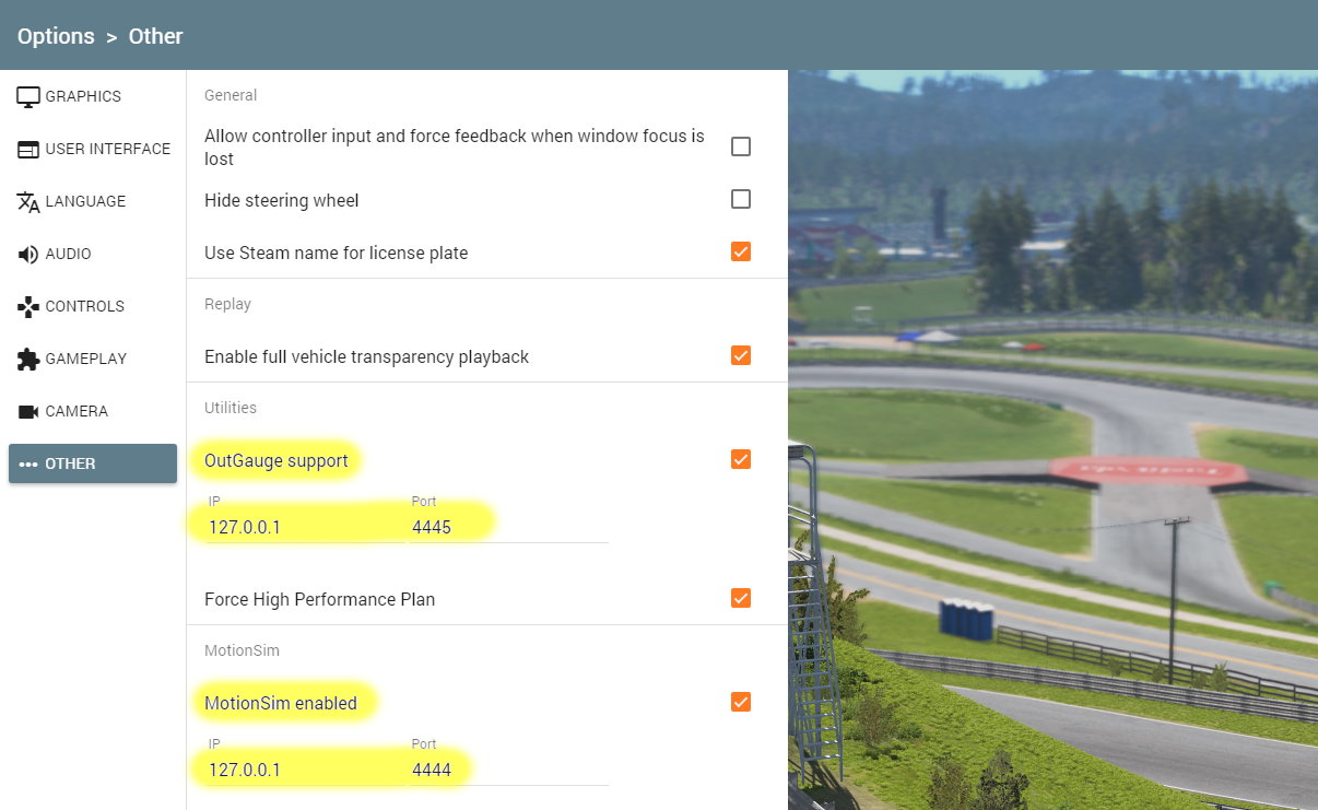

  15. Kranky Pantz
    Kranky Pantz Active Member
    Sep 9, 2018
    362
    Canada, Eh!
    1,288Coins
    +297 / 0 / -0
    Hi folks.
    Does anyone here know if motion is still currently working with the latest Steam build of BeamNG?
    I've just purchased the game, and for the life of me cannot get any motion out of it.
    Perhaps things have changed in recent builds with how this is supposed to work?
    I've patched the game in the "Steamapps/Common/BeamNG.drive" directory (there weren't any specific instructions as to the correct path or directory for patching, so this is what I've chosen).
    The "Game Manager" turns blue when I start the game, but there is zero motion.
    I've set the Steam game launch option to the previously mentioned "-luasocket", but still nothing.
    The game itself does have menu options for enabling motion simulation using the standard SimTools IP & Port addresses correctly filled in (127.0.0.1 & 4123).
    Does that now override the need for the old "-luasocket" launch option.
    I've tried multiple ways and cannot get the game to actually provide motion, but it does change the Game Manager to the blue activation mode, which seems to indicate that it wants to work, but simply doesn't.
    :sos
    Any ideas???? :!

    Hi @Kranky Pantz
    I think the plugin does not work currently due to several changes in the API (data interface) of BeamNG.
    Don't waste more time with the current plugin. It needs re-coding :(

    Hi @Kranky Pantz
    I wasn't aware that BeamNG finally supports motion data. We had to dive deep into the guts of the software previously.
    I'll give it a try when back at my PC.
    Thanks for the info!
