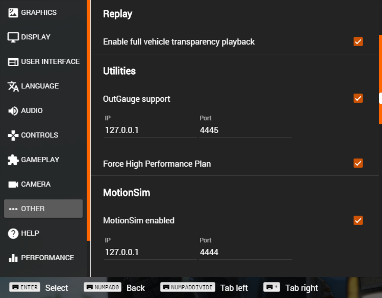

    Hi
    BeamNG.drive does not work plugin
    unhandled exception has occurred in your application
    what's the problem?
    thanks

  12. knaufinator
    knaufinator Active Member
    Nov 16, 2017
    226
    Simulation Engineer
    akron,ohio
    1,970Coins
    +260 / 1 / -0
    AC motor, 6DOF
    not sure, that is not an error I have seen before in context to this plugin.
    More information is needed in order to continue. hit the details button and copy the entire text details of what it is having an issue with. This may assist in leading to the correct culprit...
    The plugin modifies 1 BeamNG text/script file, and that modification should not cause this issue. (that I am aware of...)

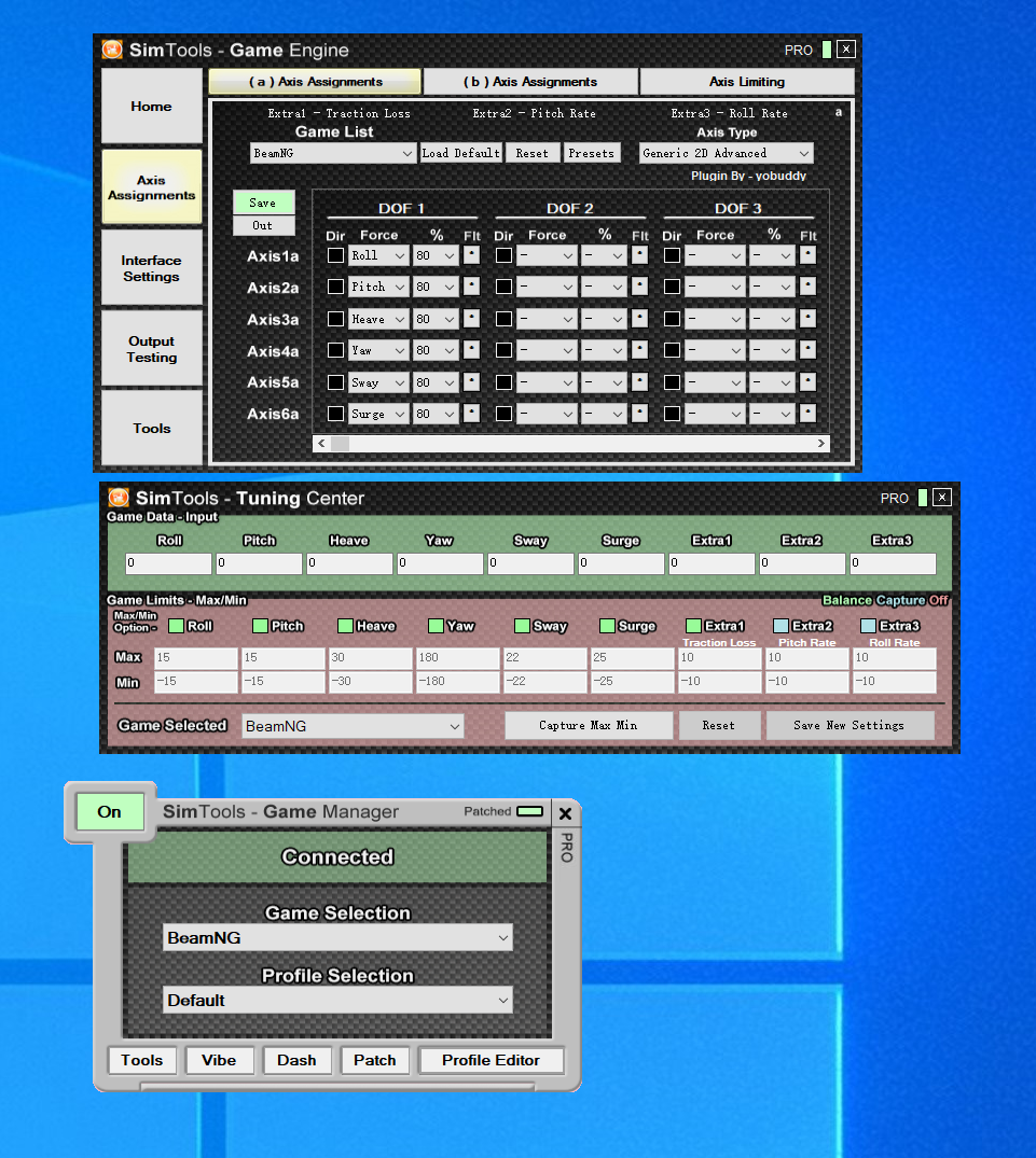

    Hi guys,
    My plugin could not work correctly.The beamng output data cannot be read properly.When I enter the game,my seat just shakes. Not working properly.Thanks in advance.
    22,228
    154,837Coins
    +11,227 / 57 / -2
    Please post pictures of all of your settings, including the Tuning Center while the game is running, as more context is needed for members to be able to offer advice.

    Here are some of my settings.Can you spot any problems with those?
  16. noorbeast
    22,228
    154,837Coins
    +11,227 / 57 / -2
    What are your Interface Settings and does Output Testing work as expected?
    Because from your Axis Assignment it does not look like SimTools is properly configured and that needs to be successfully done before messing with any plugin.

    That is a configuration preset for SimTools, but what code and hardware is being used for the rig control, is it an Arduino or something else? Best to start your own build thread and detail everything, as sorting this out does not belong in a plugin thread.
  20. SoftKitty
    SoftKitty Member
    Feb 8, 2019
    69
    Engine engineer
    Nantong, Jiangsu, China
    - 140Coins
    +61 / 1 / -0
    AC motor, 6DOF
    A little explaination for the rig:
    He is using my PLC hardware with 4 servo motors(a typical square 3 dof platform). The interface config is meant to send 6 dofs data seprately into the PLC(via serial RS485), and the PLC will assign the duty for each actuator.
    His platform can run Assetto Corsa perfectly so the settings are not likely be the reason for the problem.
    We also have changed the unicode lanuage to English(USA), but the shakes remains.
    PS: in most games such as Dirt Rally 2, changing the unicode lanuage could solve the ramdom shake.
    So I guess this plugin has some incompatible issues with system running in Chinese.
