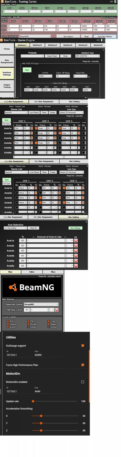

    Hey everyone, long time lurker first time posting. I'm wondering if anyone can shed some light on a BeamNG specific simtools GameEngine crash.
    I have an issue where GameEngine crashes (no error and no USB disconnect noise) when running BeamNG.drive with the latest plugin. Crash time varies from within 10 seconds, to several minutes before crashing. Re-starting GameEngine resolves motion, but it will contiue to crash over and over.
    I have iRacing, Assetto Corsa, Project Cars all working perfectly.
    I have a DIY Mega system with the AMC-AASD15A thanos controller. I have replaced the USB cable with several new ones, tried with and without an external powered hub. All cables are new and properly insulated. No crashes occur when testing the motion, or when using other software.
    I am running SimHub and have the outguage port configured to 63392 and the motion port to 4444.
    Issue occurs the same when all external software (including simhub) is not started.
    No change if I reduce the intensity slider in the game manager, and increase the numbers (significantly) in the GameEngine>Tools Tuning Centre. I have tried 100000 in each field to check that it's not spiking out of control and the issue still exists.
    I've tried reducing the poll time to the controller box all the way down to 10ms without any change.
    Today, I completely re-installed windows 10 fresh and re-installed BeamNG along with fresh install of Simtools and re-installed the plugin. Still exactly the same behaviour (frustratingly!)
    I have noticed that BeamNG does reset the motion port to 10001 each time I restart - the outgage port stays set. This behaviour occurs on both the original install of windows, as well as the fresh install of windows - so that's odd. I also find the motion works as long as I type port 4444 into the motion settings in BeamNG regardless of whether I tick the 'motion on' checkbox in the settings in BeamNG or not. Both installs do the same. also odd.
    So i've pretty much narrowed it down to a likely spike somewhere, software supplied, but i have no idea how to check it, or how to disable that spike. Unless I'm way off. Does anyone have any ideas other than everything I've tried? Is there a way to get a log or something from simtools to check what the cause of the crash is each time?
    Thanks heaps guys!
    Cheers, -Paul

    Thank you. Hope these help.
    22,228
    154,837Coins
    +11,227 / 57 / -2
    There is lots of Filtering in Axis Assignments, plus a heap of Axis Limiting, is there a reason for that?

    [QUOTE="Paul Jones, post: 228056, ... Is there a way to get a log or something from simtools to check what the cause of the crash is each time?
    [/QUOTE]
    I have had luck in the past looking at the windows Event Viewer -> windows logs ->
    "Application" section... there could be one or two that catch and describe the issue at a lower level. look for the red error icon

    Tried removing all the filters and enabling the full axis (unlimited) but no change in behaviour.
    I've also had a look in the windows event viewer but pretty hard to narrow it down there, at least nothing that I can undersatnd relating specifically to simtools.
    It's a shame that Simtools doesn't have an error log - that'd be supremely useful!

    Last night I spent some more time mucking around with BeamNG - after scouring the event viewer windows logs I have uncovered a few errors - does anyone know how I could further investigate these?

    Further to my testing, i noticed that Axis 5a DOF1 had an erroneous value (20) and have removed that (as per pictures posted earlier. This didn't seem to affect anything but it's good that i noticed as it will ensure results aren't contaminated.
    I've resolved my issue for now by installing plugin 2.0.1.0 - this seems to have reversed outputs but i've reversed the directions of the axis for now which makes everything work. No crashes, no problems in the single player game.
    However, i've noticed in the multiplayer mod BeamMP that all of the cars in each server have their motion mixed together and inserted into my telemetry. Previously, using 2.0.3.0 I don't recall this happening - except that it crashes Simtools Game Engine.
    So i'm really not too sure where to go from here. I'm fine with running the plugin I have since it's stable, but i'd like to remove the motion issues in BeamMP. Is there some way to identify and mod the plugin to adjust this?
    Thanks guys, -Paul

    Ok, so i've been able to install 2.0.2.0 over the top of the 2.0.1.0 plugin and not re-patching the motion has enabled me to achieve both goals. So at this point, i think the main issue is 2.0.3.0 but i'm not sure if it has anything to do with patching or not.
