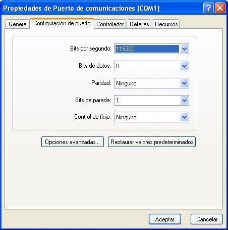

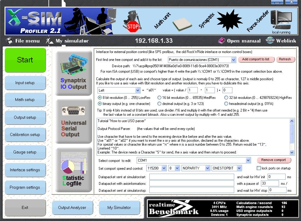

    But when I open the Force-Sender and the Force-Profiler, it doesn't detect the AMC 1.5:
    I configured the COM port with different speeds on the PC and the
    Force-Profiler and nothing seems to work... I'm using the COM port of the PC, not a USB adapter.
    Jumpers are as follows: 1 = ON 2 = OFF 3 = OFF 4 = OFF
    I'm using the beta version of X-2.1.0.13b Sim on Windows XP
