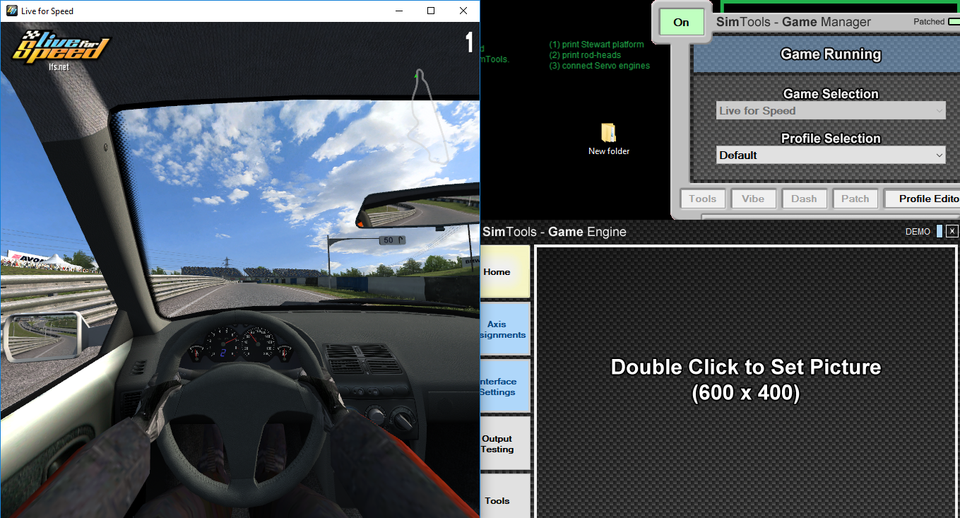

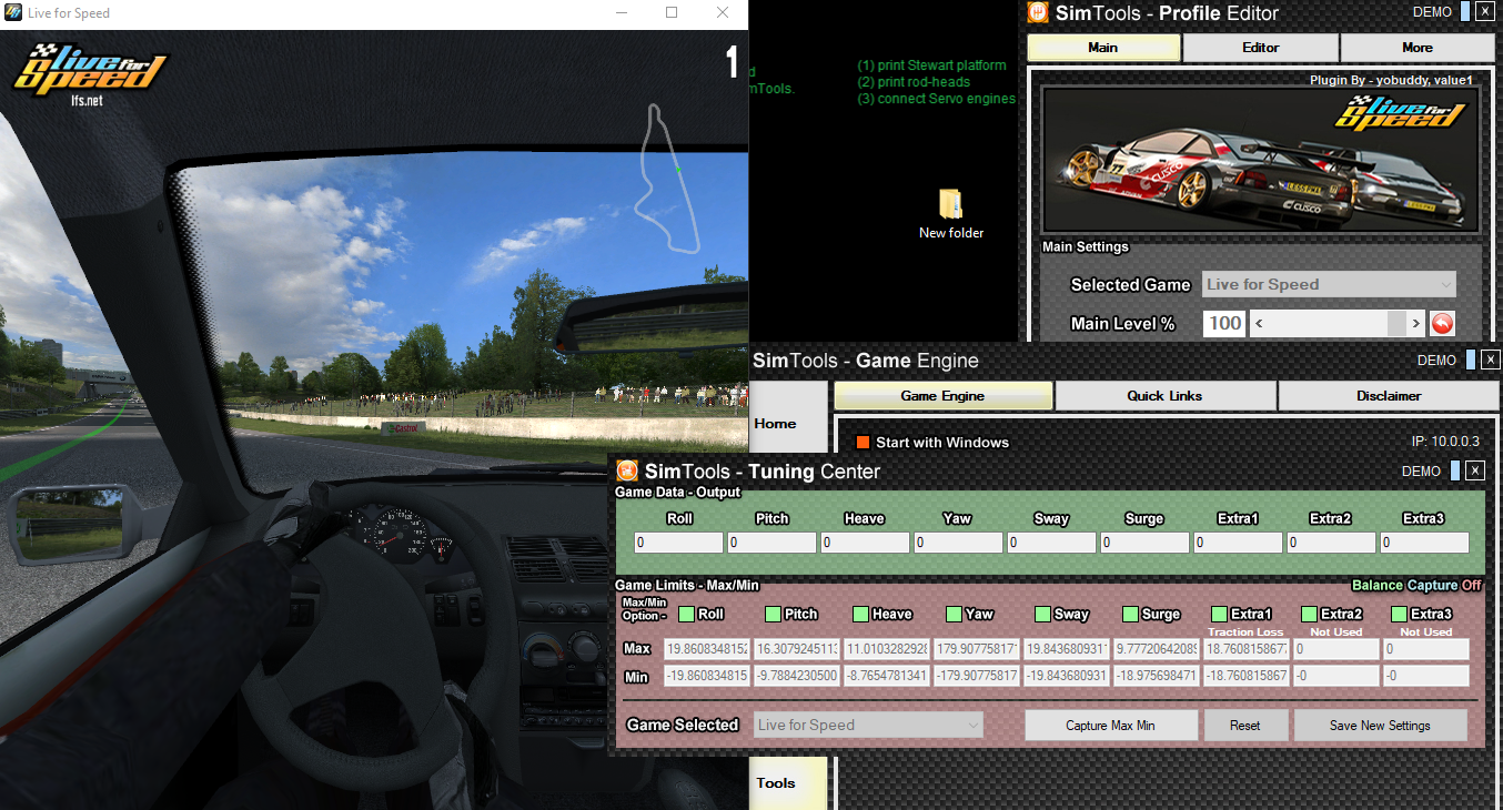

    And.. It doesn't work.
    All seems fine, all light are green, but something doesn't connect.
    Before posting: - I've checked my default language - set to English.
    I have no active firewall/anivirus, both game, engine, simulator and arduino are on the same pc,
    and it's a "Standalone".
    So.. why doesn't the game sends the output? :-(
    21,714
    151,991Coins
    +11,061 / 56 / -2
    Did you run a race in first person mode before patching for motion, as it generates some required files.
    If not Then un-patch, close down SimTools, run a race then re-patch.

    Typical. Went for the heavy lifting before doing the obvious.
    Yes. Thank you. It worked.
    Totally tore away half my servo arms, but that's just tuning.
    It's ALIVE !!! MU-Ha-ha-ah..

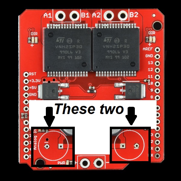

    by the way - what are these for? (Leds?) and why doen't anyone solder them? (if they are, indeed, leds)
    (couldn't find anything on google. o_O )

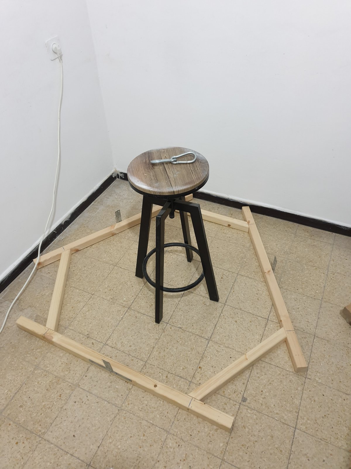

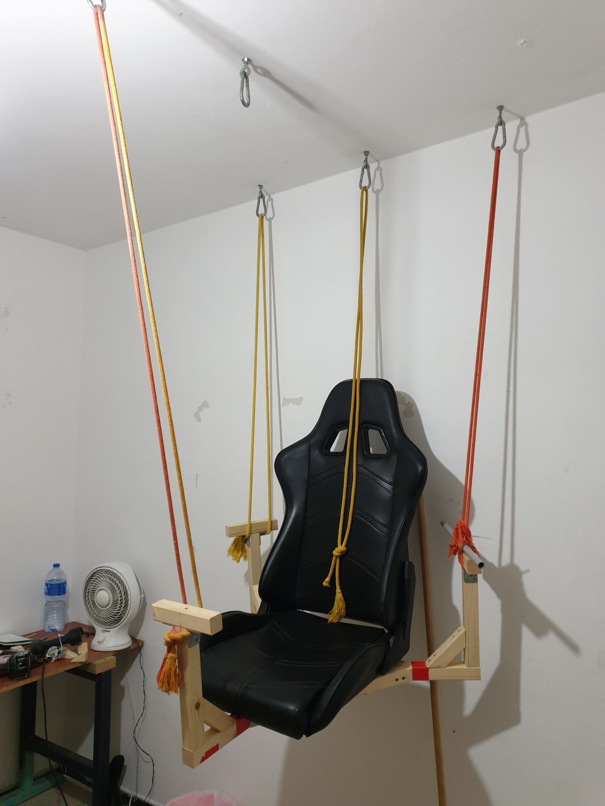

    So.. I've been off for a while.
    The work-room has went some modifications, so there will be room for the new platform,
    and I had some time and got some wood, so why the hack not. -built a mockup- :-D

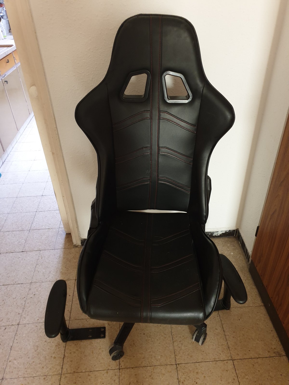

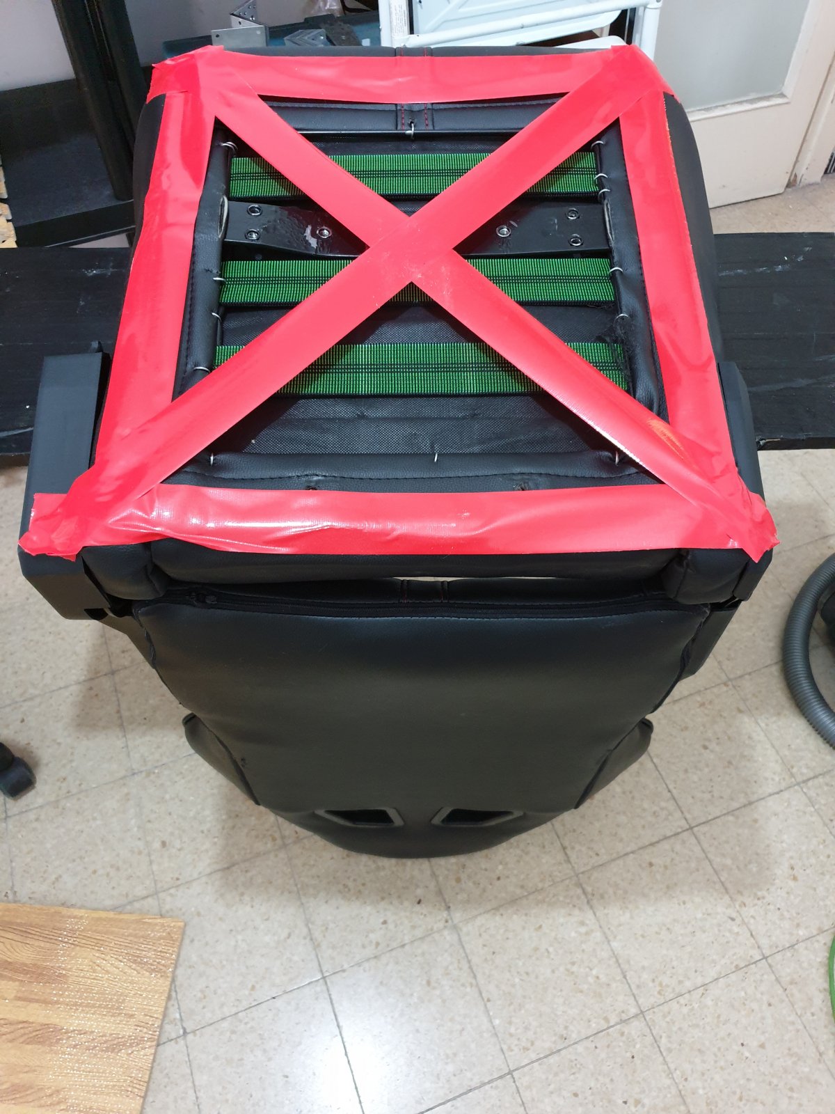

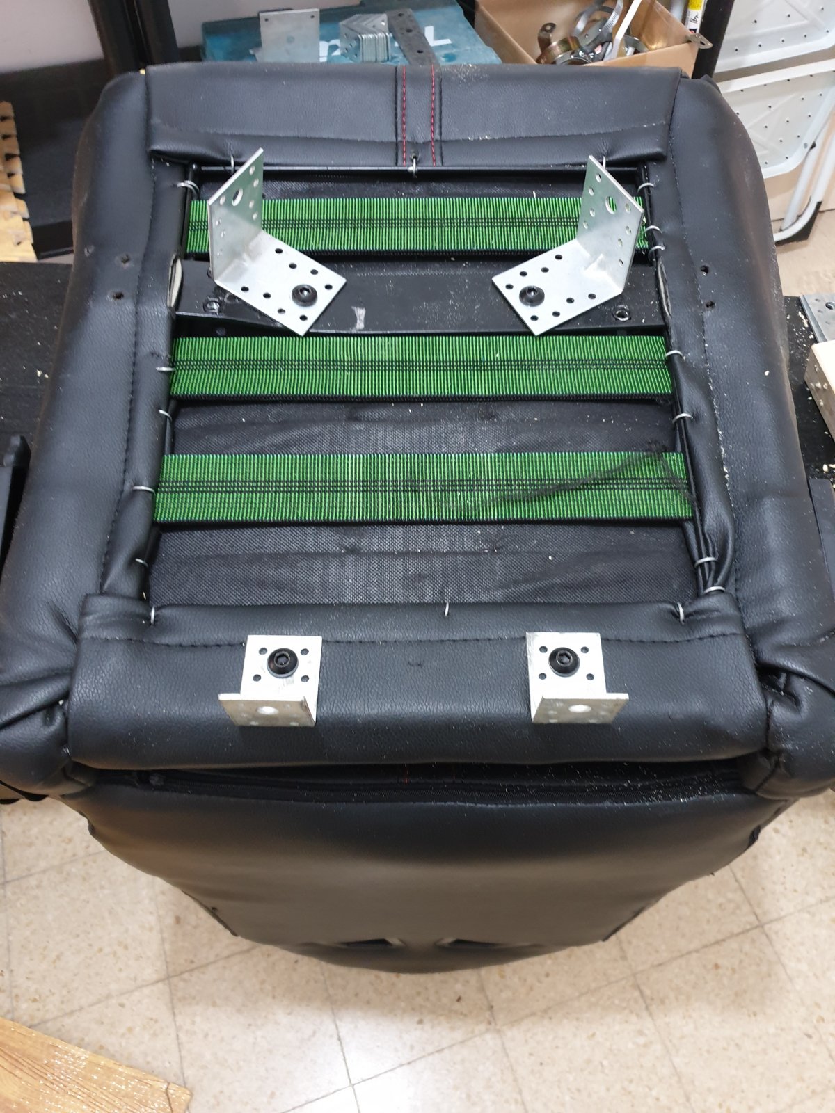

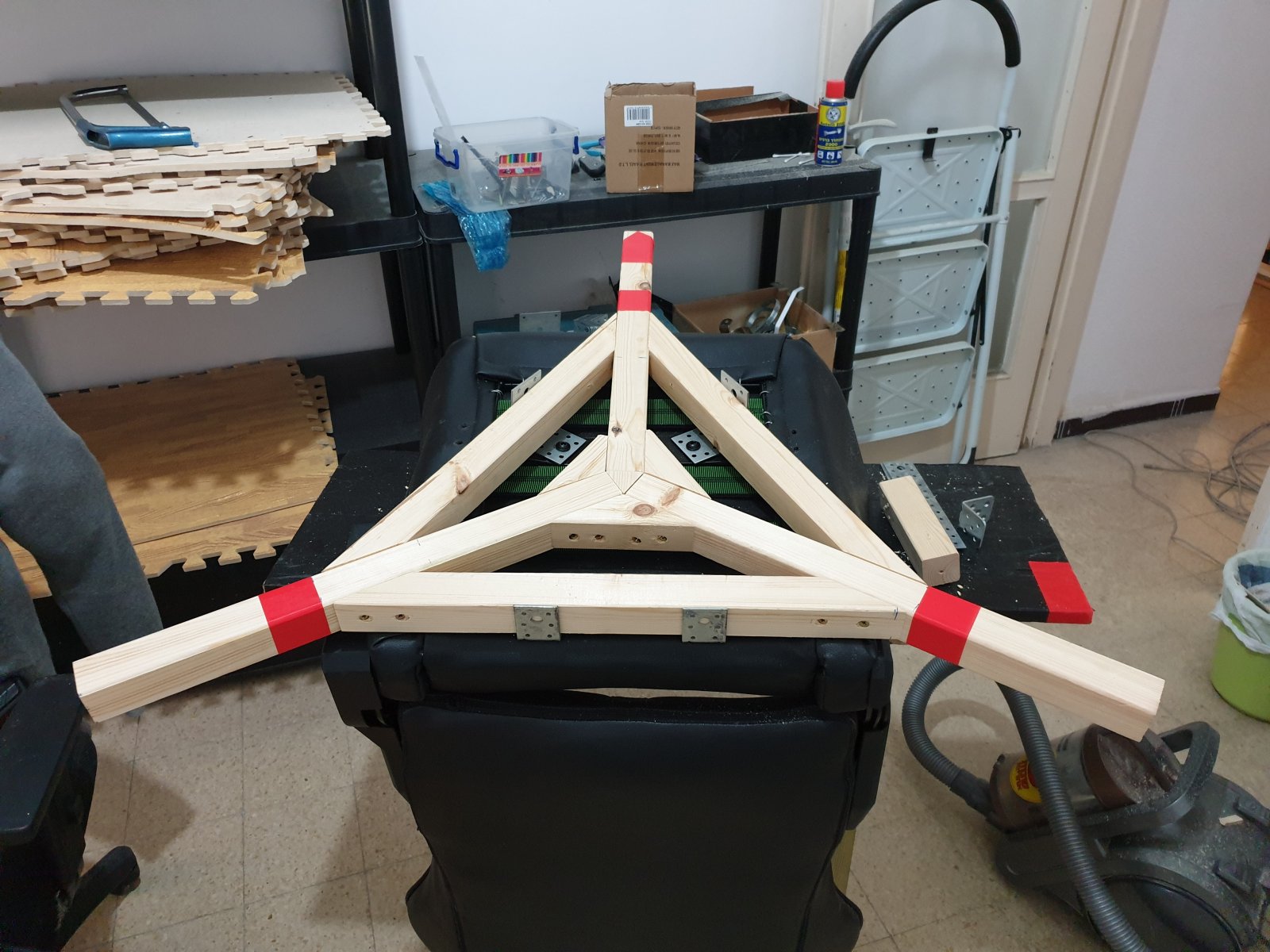

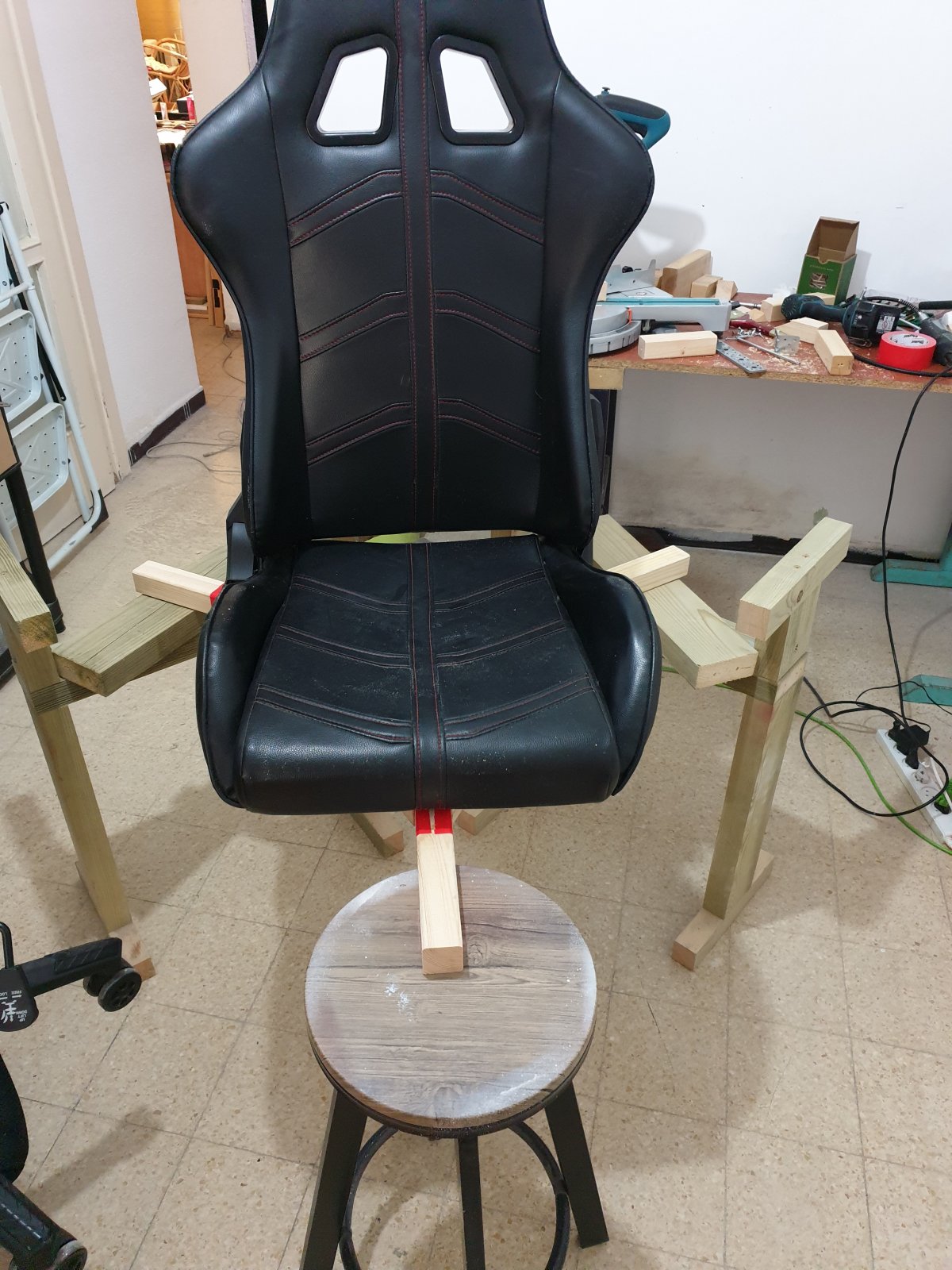

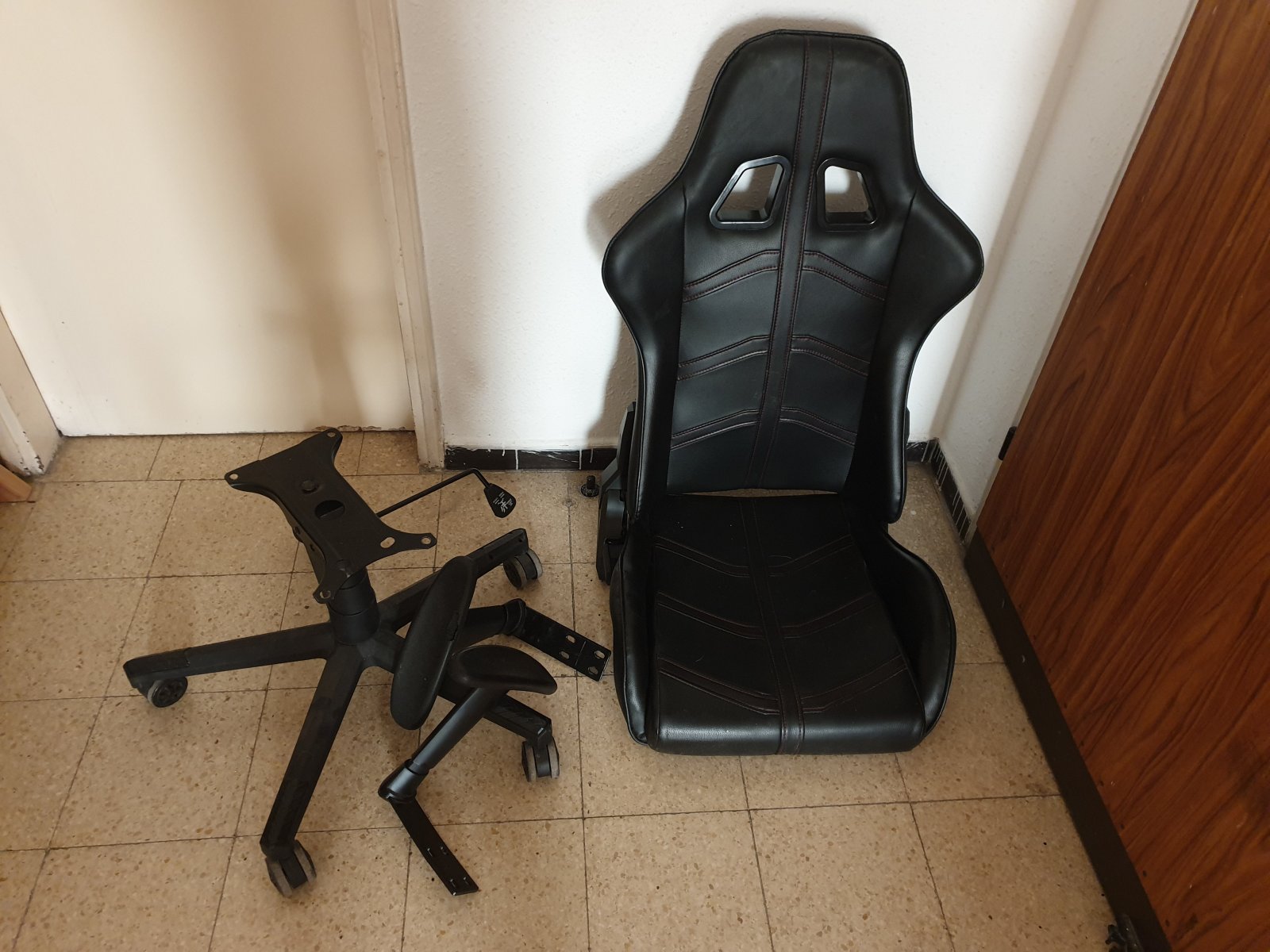

    progress pics -
    The chair (Karma, found on street, base is broken, needs welding when I'll have the time)
    took off the base, marked the center, shifted to COG, and placed some metal pieces,
    that will hold it on the frame. 20190701_101040.jpg 20190701_101132.jpg 20190710_104935.jpg 20190710_120407.jpg

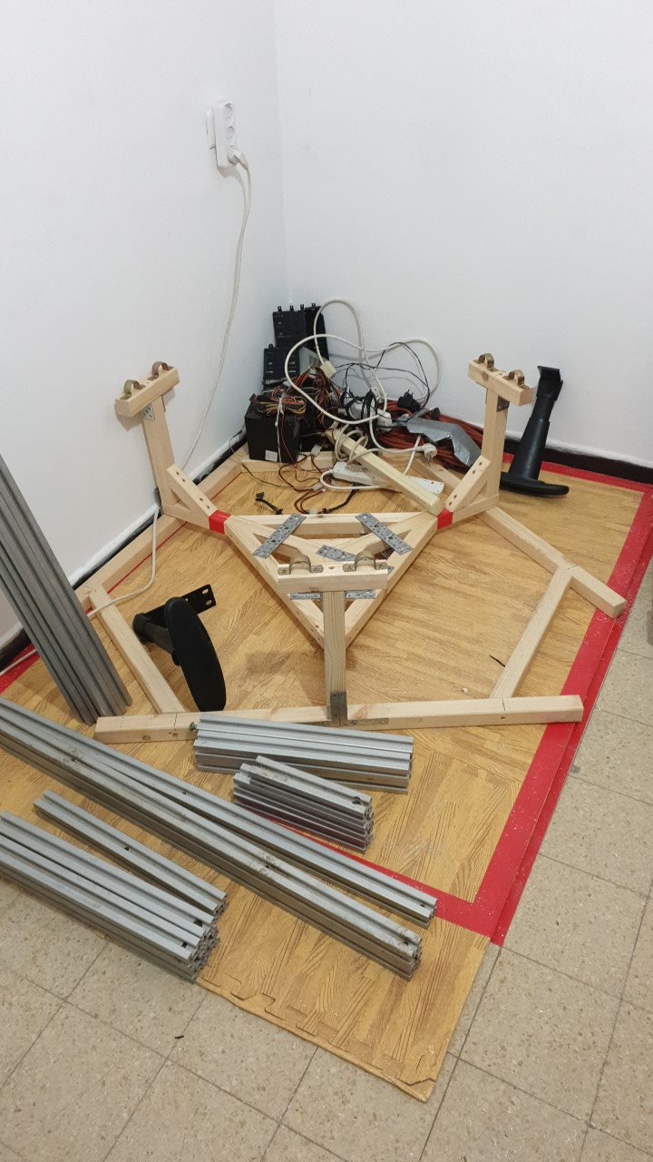

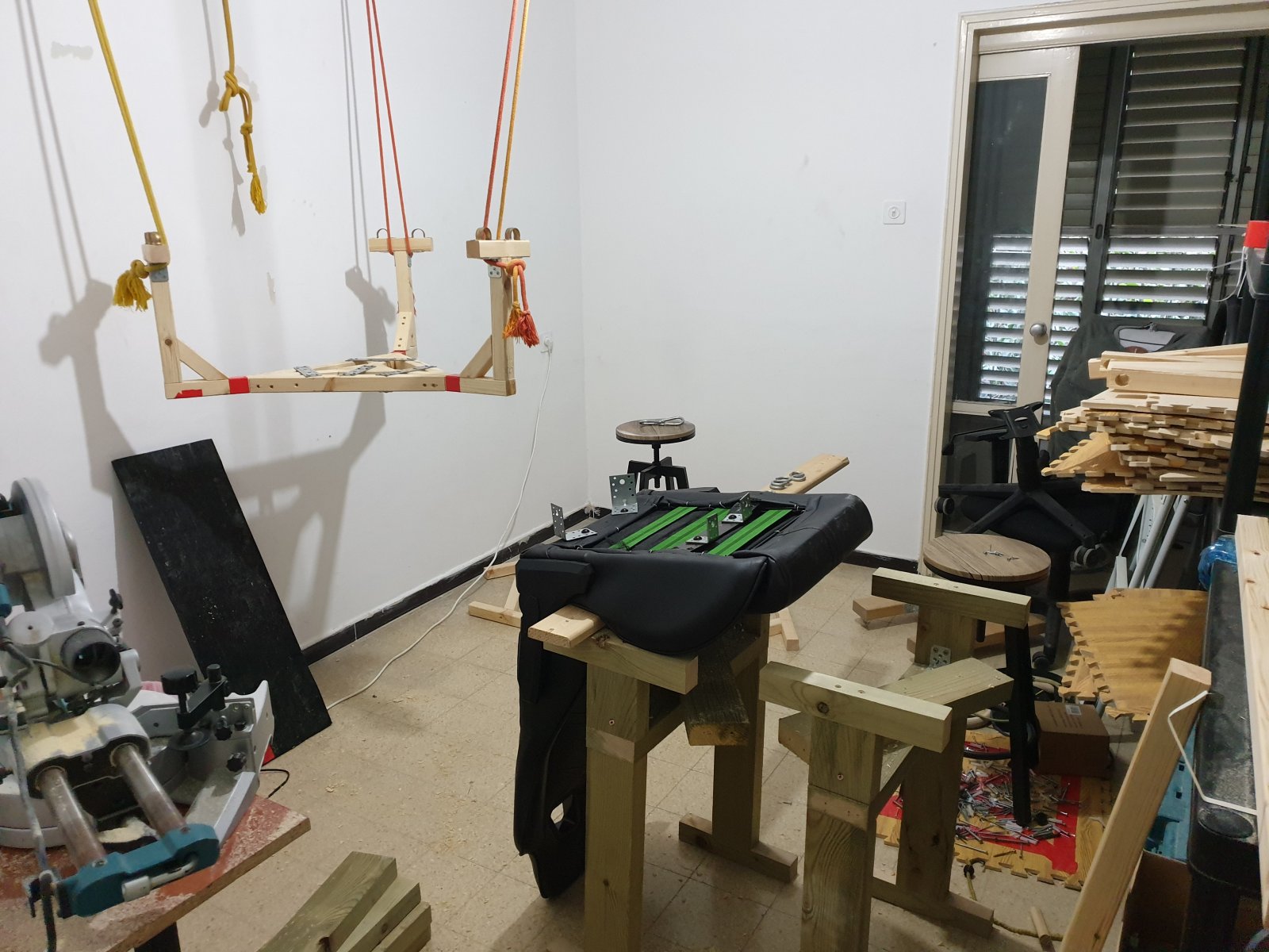

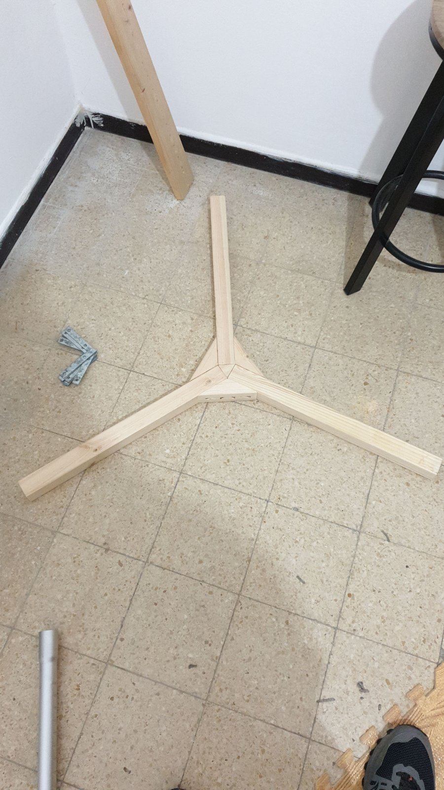

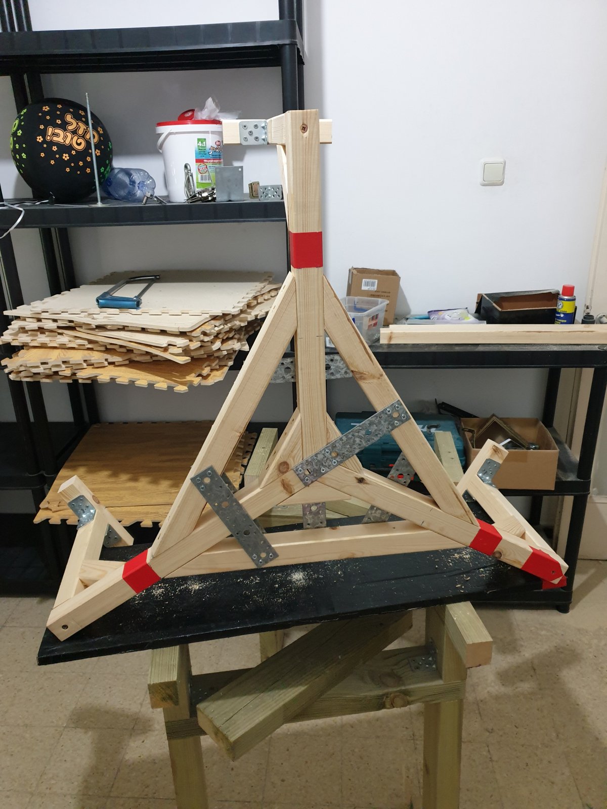

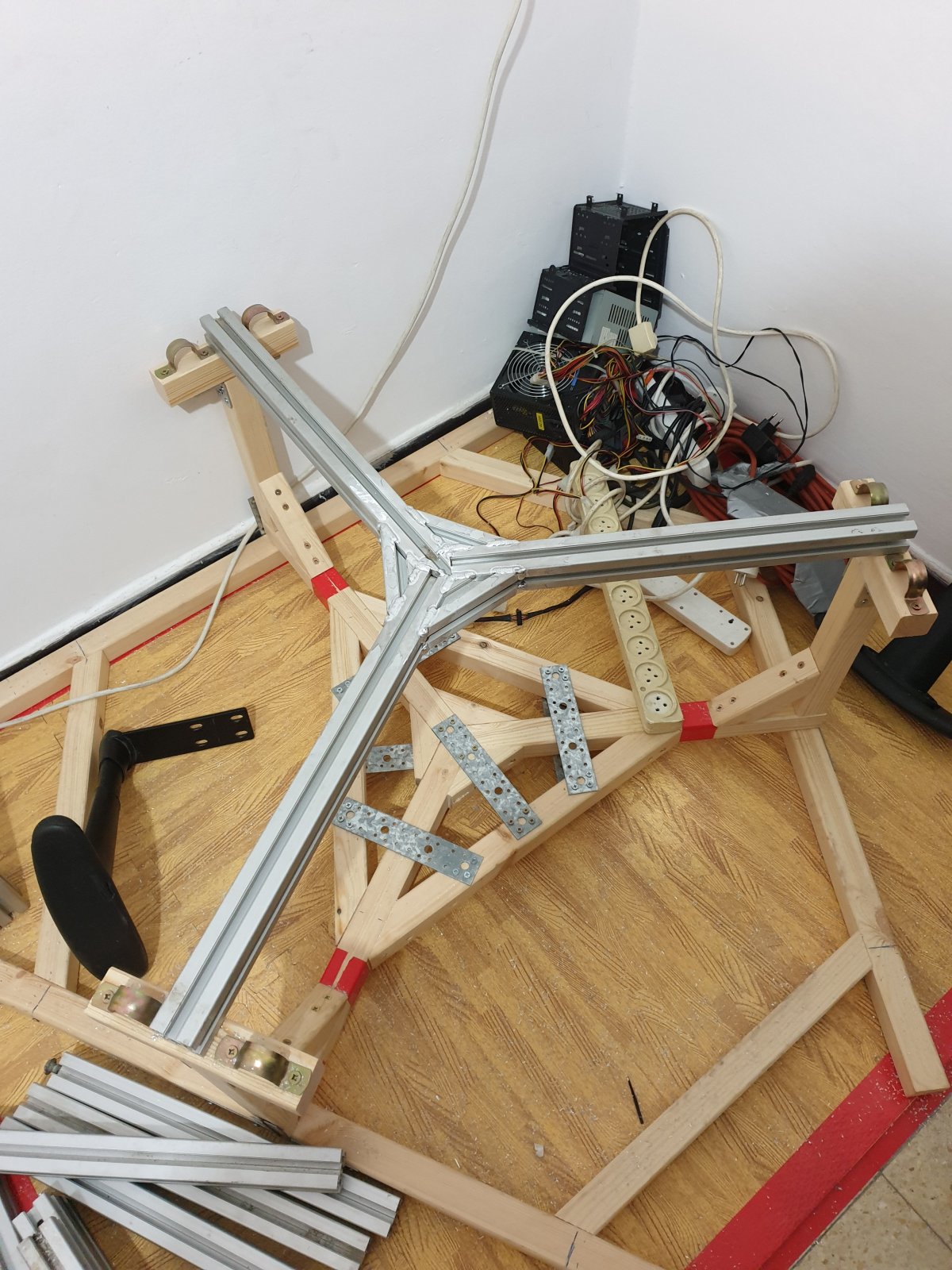

    next - Build the frame.
    I went for a low profile, minimalist frame, with a low COG.
    reinforced with some brackets, and than changed the (originally) vr cable management, to a "hang-weight test" to see that it holds etc. pic_1.jpg pic_2.jpg pic_3.jpg pic_4.jpg pic_5.jpg pic_6.jpg pic_7.jpg

    And that - place it, and make a general contour. pic_1.jpeg pic_2.jpg pic_3.jpg
  12. Razvan
    Razvan Member
    May 27, 2019
    32
    Programmer
    Israel
    311Coins
    +13 / 0 / -0
    Arduino, 6DOF

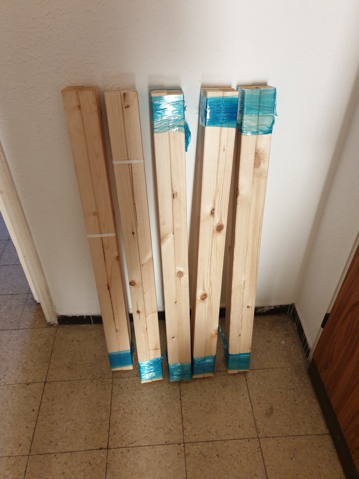

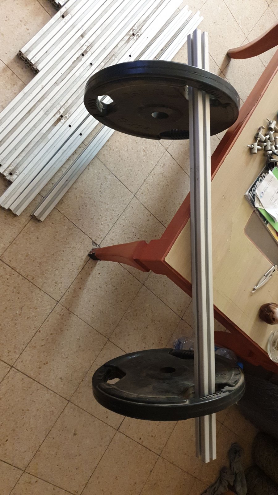

    next step is to reproduce it in aluminum, and awaiting reply from a company about the motors+worm gear..
    Need to catch-up on my reading regarding MM with 12V, 24V, and to read the testing post by silent.
    (aluminum weight test teaser pic added :) )

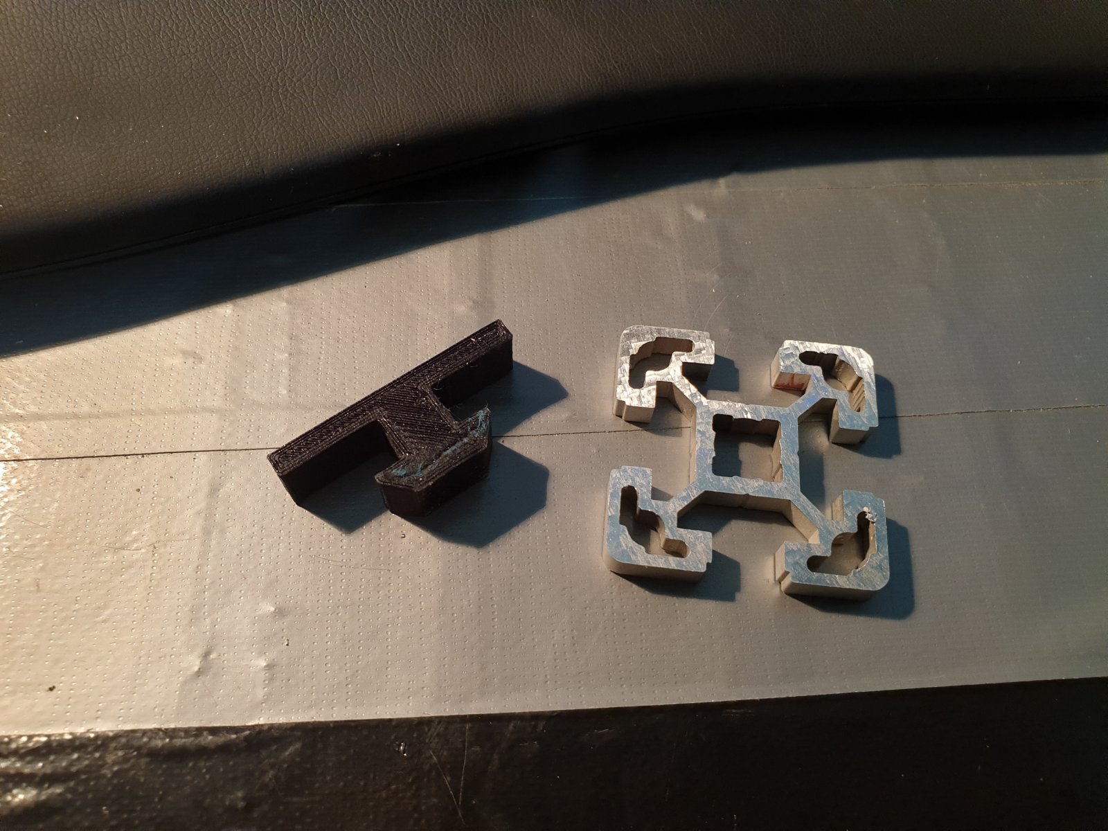

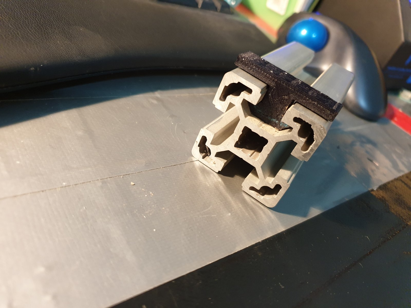

    meanwhile, the soldered aluminum base got back,
    and I've enlisted the help of a friend to create some 30-60-45-90 profile angles.
    first step - make a slice, print it, slide it to see that it works.
    (I do not expect the printed pieces to hold the actual rig,
    I do expect them to help spread the forces on the angles)
