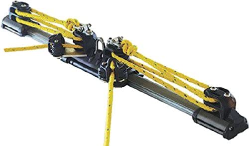

    For a 1kg mass connected to a 1:1 pulley system you can pull a rope for 1m with a force of 9.8N and the mass will move 1m. With a 2:1 pulley system you now only need to apply 4.9N to lift the mass but pulling 1m of rope will only raise the mass by 0.5m.
    The back and forth system I'm using is similar to one used on yachts for controlling the main sail. I forget exactly what it is called there but as you get more powerful sails you can no longer handle the main sheet directly so they have a rope version of my system for magnifying the force you can apply via winch.
    Edit: This is a main sheet traveler which functions the same as my design but with a 2:1 ratio traveller.jpg

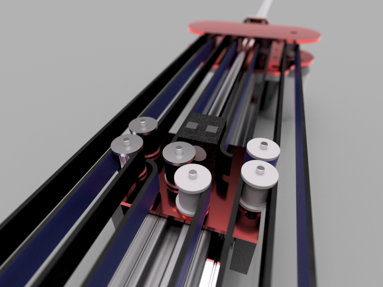

    I think I did reduce my pulley ratio by one when I rerouted the belt, being 3:1 would explain why the teethed pulley locations needed to flip from side to side. That will reduce the maximum actuator force and increase the speed everything else being equal. The blue side of the belt would have teeth but trying to do them accurately kills my computer.
    Edit: This was bugging me so I kept thinking about this and moving the split to the centre created two parallel pulley systems, effectively like putting two ropes instead of one through a single pulley.

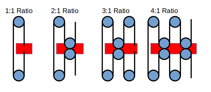

    Ah crap I have been miscalculating my pulley ratios from the first drawing and I have drawn it too high. Gadget, is that what you were referring to earlier when asking about all the belt?
    Good news in a way, I suppose, as far less belt will be required but I wish I'd not just worked out the visual cases for 1:1 & 1:2 systems and then extrapolated incorrectly. I'm going to give it a break for a while and come back to this.

    I do need fewer pulleys than I'd been drawing for the ratios I wanted. Looking at the sketches below a 3:1 ratio system with 5mm pitch belt would fit much better than I had originally assumed. The 5mm belt had much higher tension ratings so even at 3:1 ratio it will ultimately handle higher actuator loads. With this arrangement the motor could no longer be mounted directly to a pulley but connecting with a small belt gives you an opportunity to regain some gearing from the 3:1 ratio change and slightly larger diameter drive pulley; possibly 10-14 teeth at 5mm each.

    I was wondering whether some configurations ever could be redrawn to make things more symmetrical like I tried previously but now realize it impacts the motor gearing significantly. In the very simple sketches it's easy to visualize the pulleys will be spinning slowest near the fixed belt end and fastest on the left where the belt crosses between the lower and upper pulley systems. My previous model was complicated enough I'm struggling to visualize the relative speeds each pulley will be spinning as belt crosses back and forth in 3 locations.
