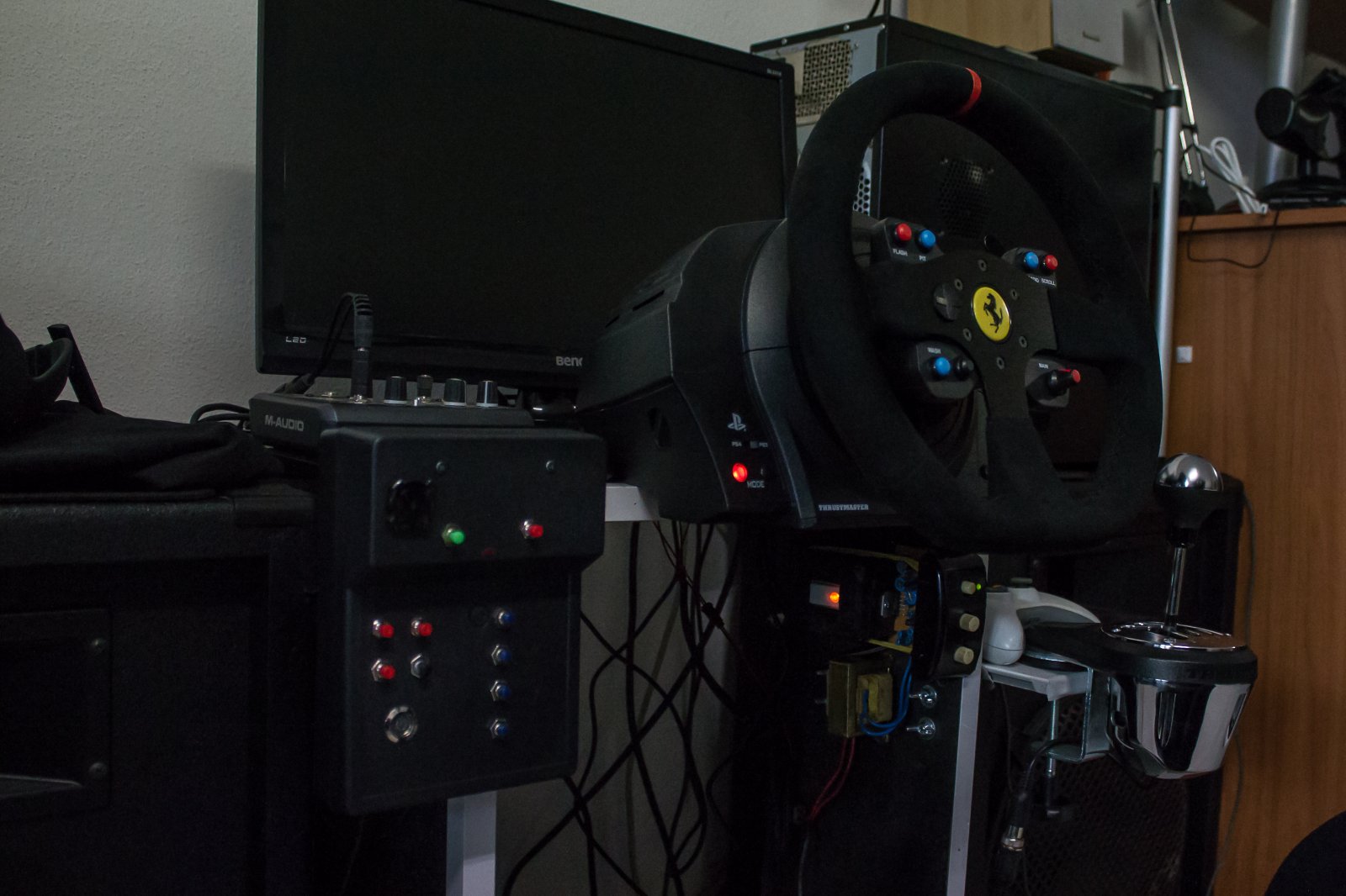

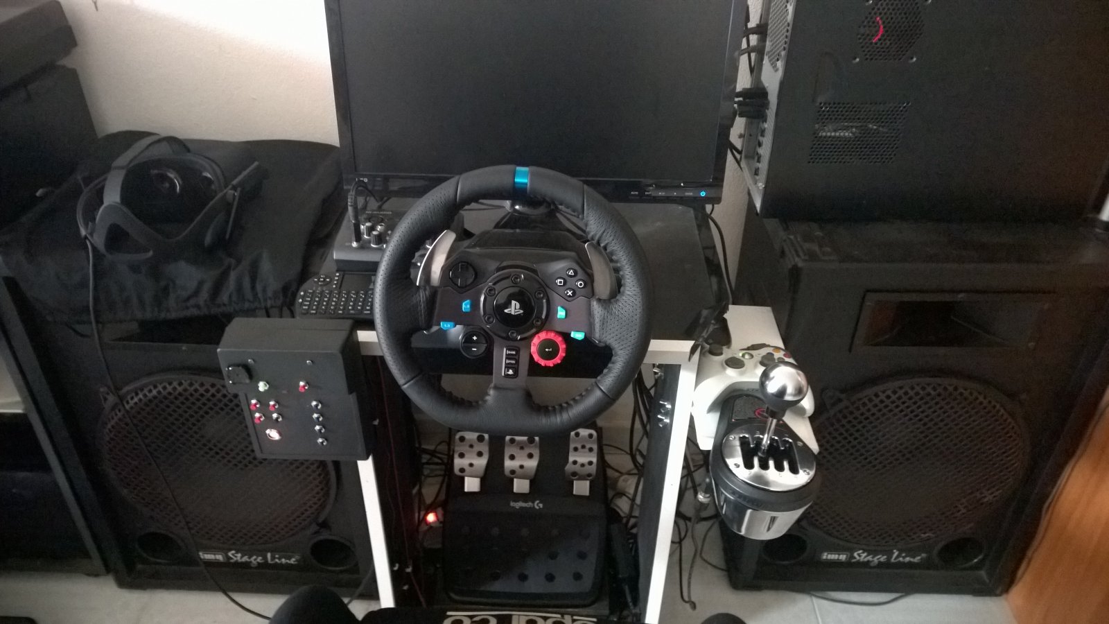

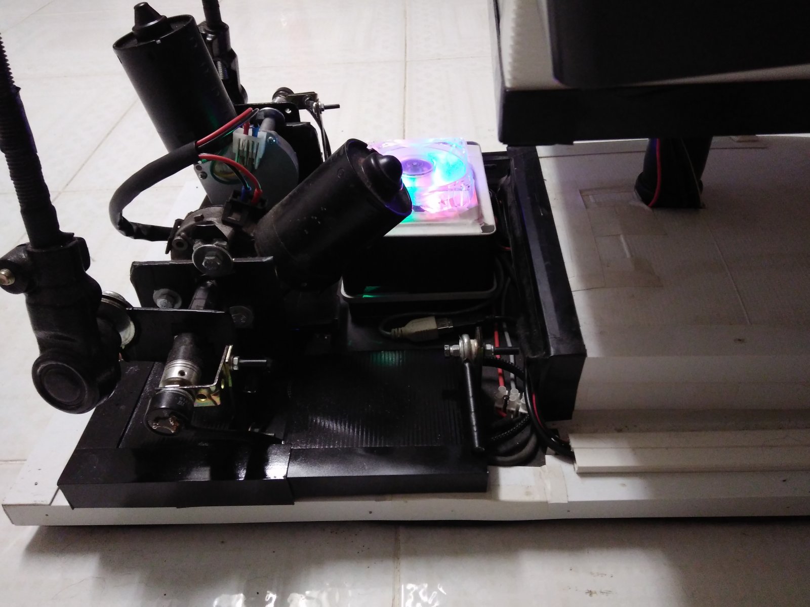

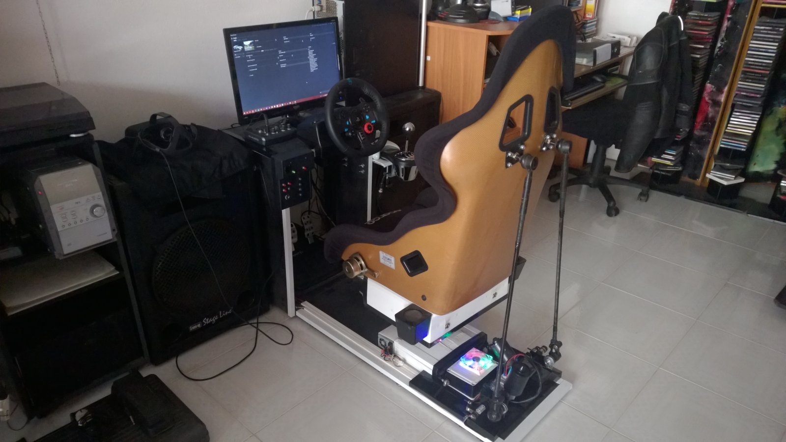

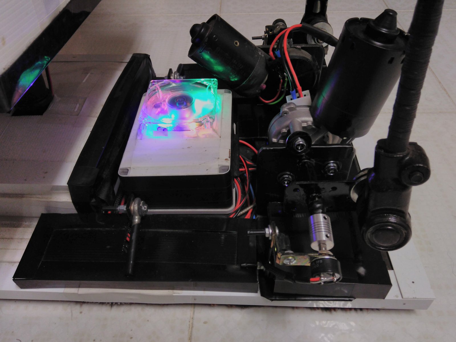

    Just to update with the latest changes I made:
    1 new motor, G29, wireless mini keyboard w/trackpad, color led fan, another stop button in the button box too, black paint

  4. obobo
    obobo Active Member
    Nov 8, 2016
    248
    1,323Coins
    +77 / 1 / -0
    nice
    it's a very compact simulator

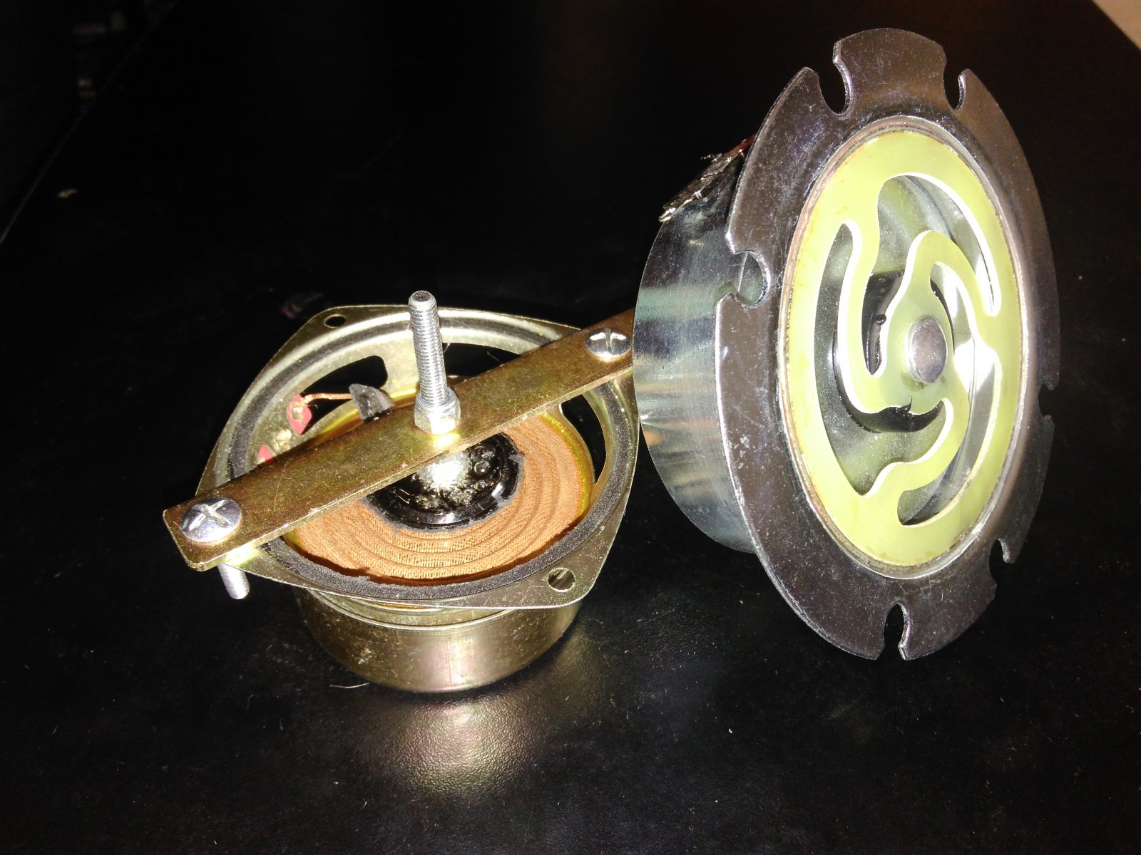

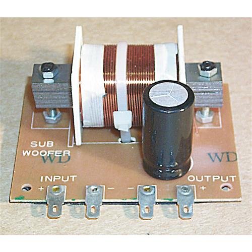

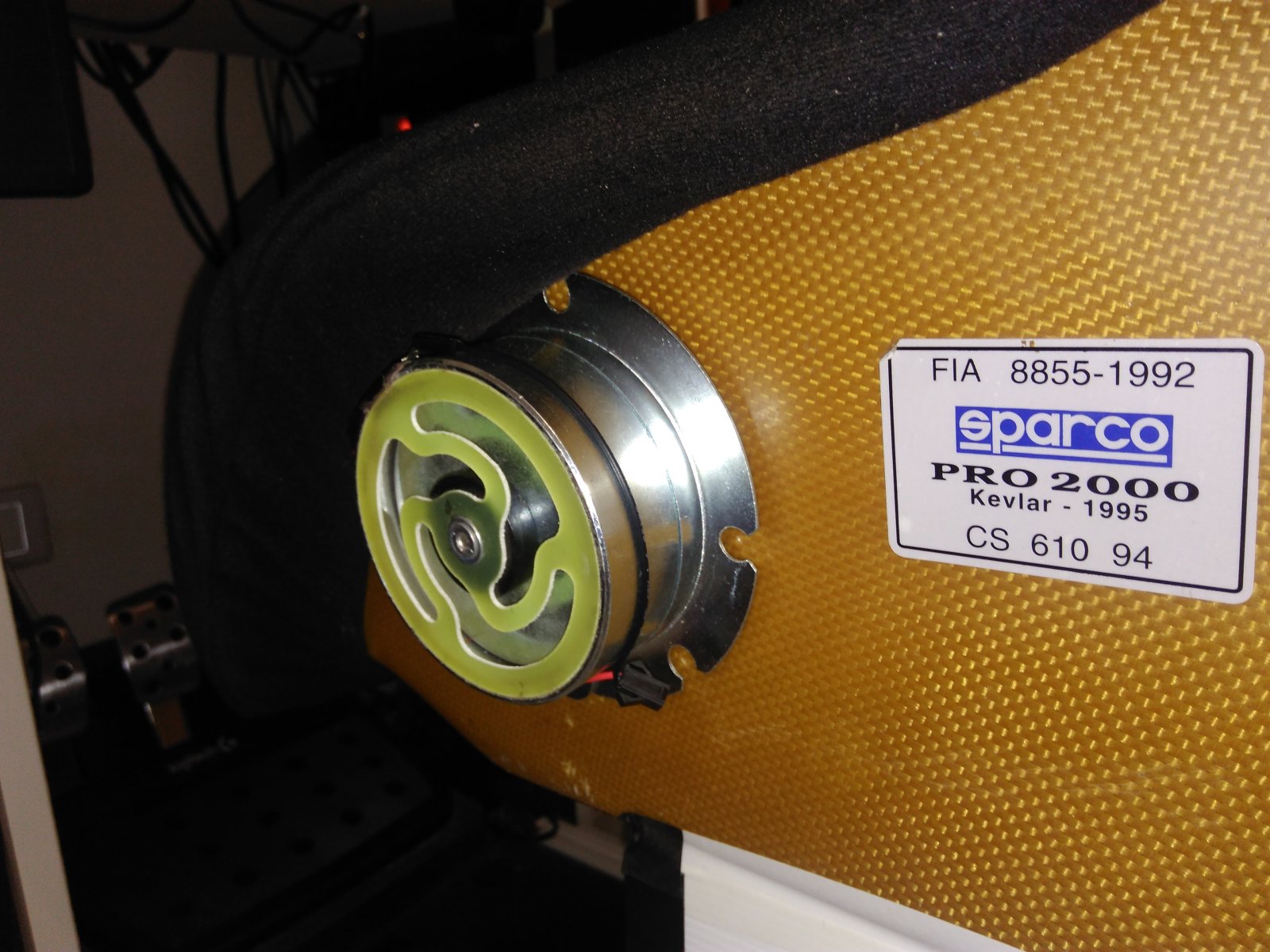

    As you know I built myself two bass-shakers as you can see here.
    The speakers I utilized wheren't good enough so I buoght two of these pre built bodyshakers for a very cheap price and I'm totally satisfied.
    They're 100W/4Ohm and you can see the difference with my previous DIY ones.
    Also got this subwoofer crossover to cut some other undesired frequencies out.
    This is one bodyshaker placed on the seat

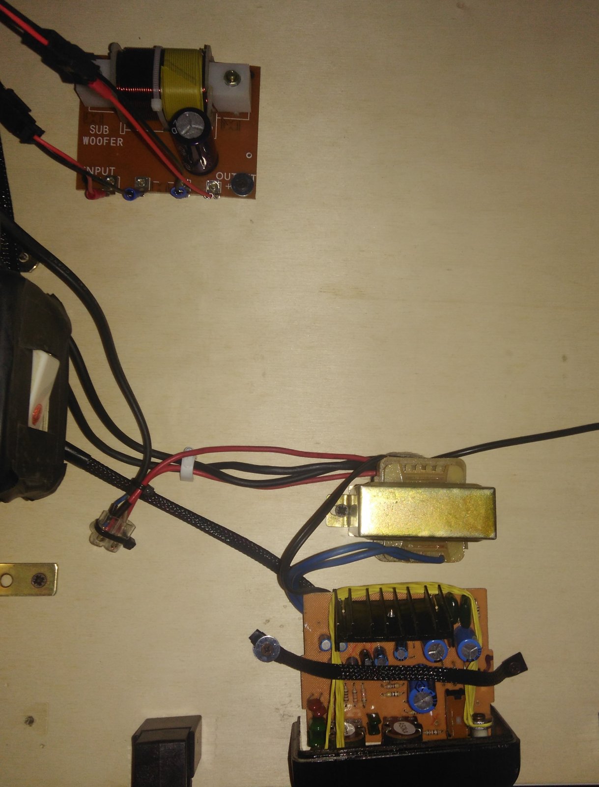

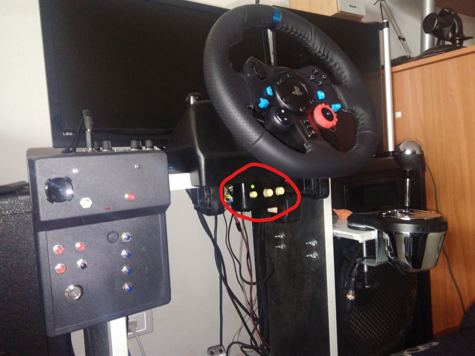

  6. Blame73
    Blame73 Well-Known Member
    Nov 6, 2014
    1,216
    8,315Coins
    +1,140 / 5 / -0
    Added, under the wheel, the on-off/volume/tune control and the subwoofer crossover for bodyshakers

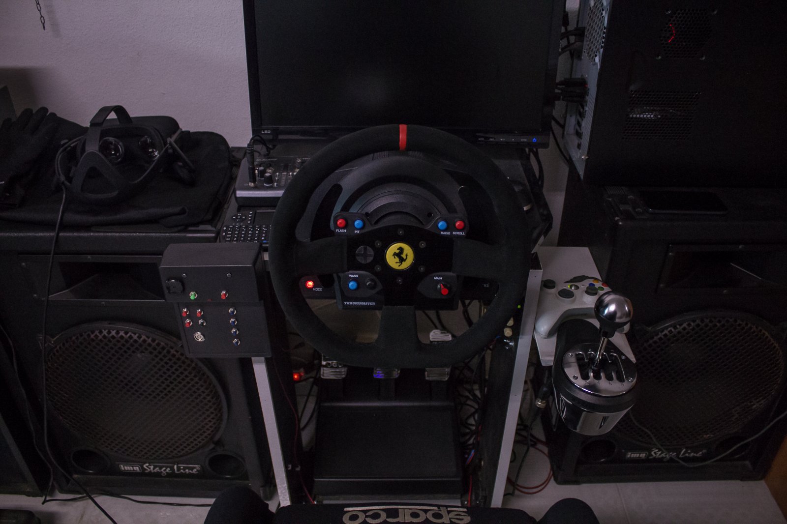

  10. Blame73
    Nov 6, 2014
    1,216
    8,315Coins
    +1,140 / 5 / -0

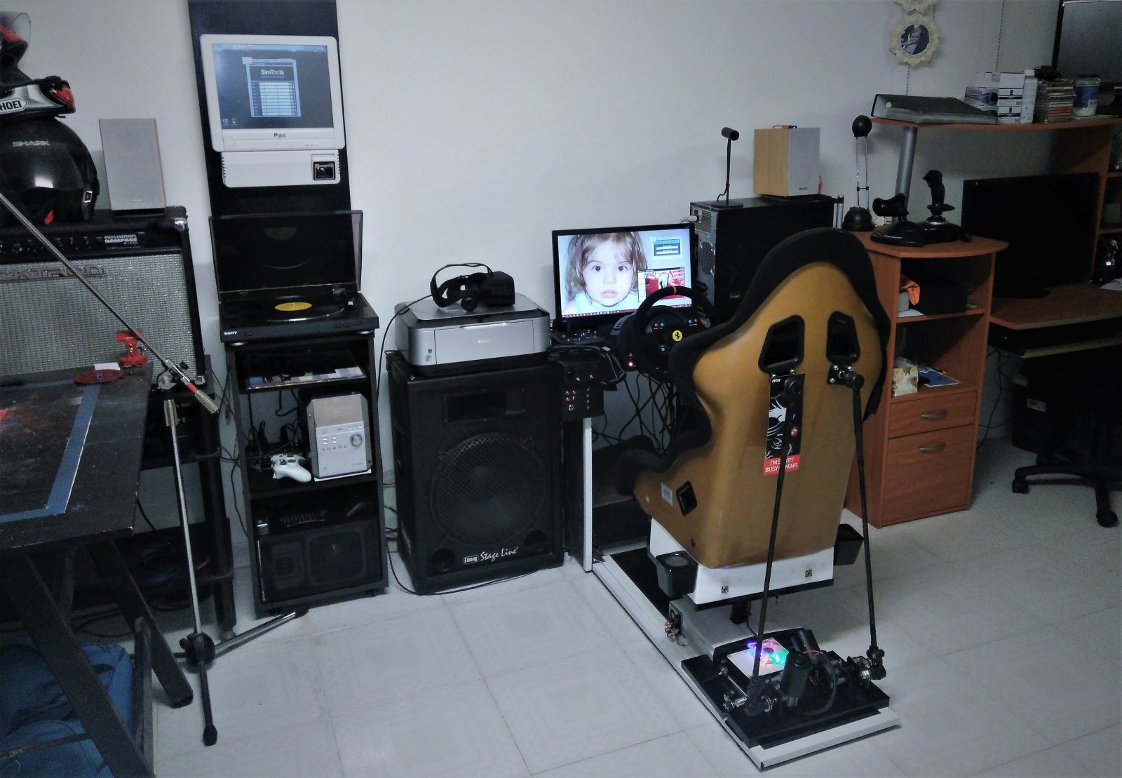

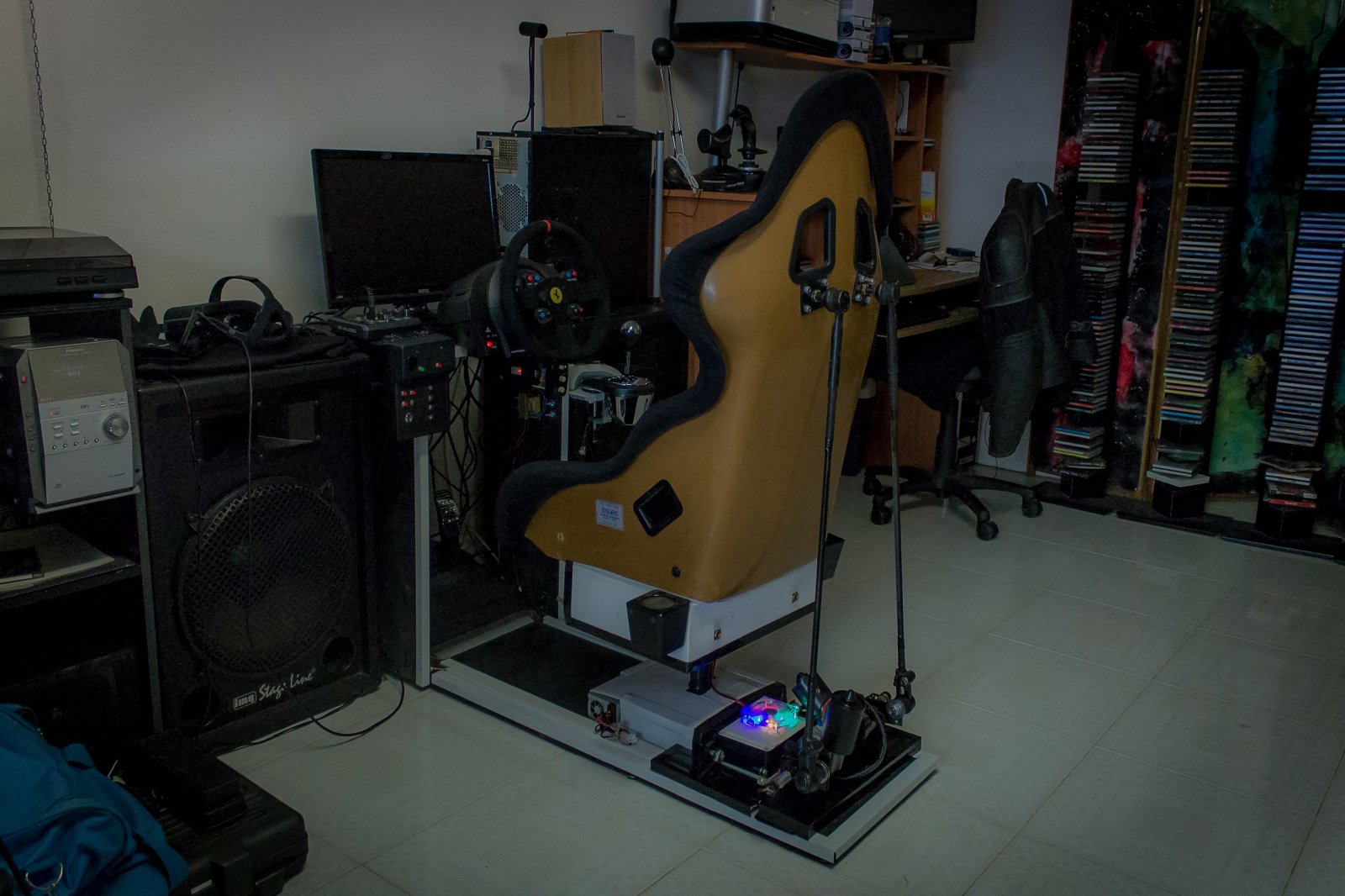

    As I wrote in another post, I had quite some problems with my steering wheels lately (broken G27>broken G29>broken G29>refurbished T300 sold as new) that brought me to buy a Thrustmaster T300RS Alcantara Edition (30cm. Ferrari 599xx Alcantara wheel + T3PA).
    I found some time to shoot a short video of the rig in action. Sorry for the audio, it's taken from the camera mic (don't have time to mix the replay and get the audio from there...)
    A tip: if you got helmet covers they work perfect for covering & protecting the wheel and the Rift!

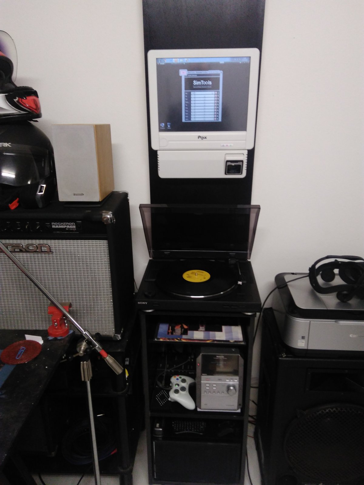

    Ok, Simtools 2 is here and with it the Remote Profiler.
    I had a kiosk around at home I used for demoing a few projects I made some years ago (framework and plugins for kiosks PCs), so I thought it would be somehow useful other than for my multimedia stuff.
    I modded my hifi rack to hold it
    Here it is:
    @yobuddy Did you sort what the problem with the Profiler not getting but just setting values could be?

  19. Blame73
    Nov 6, 2014
    1,216
    8,315Coins
    +1,140 / 5 / -0

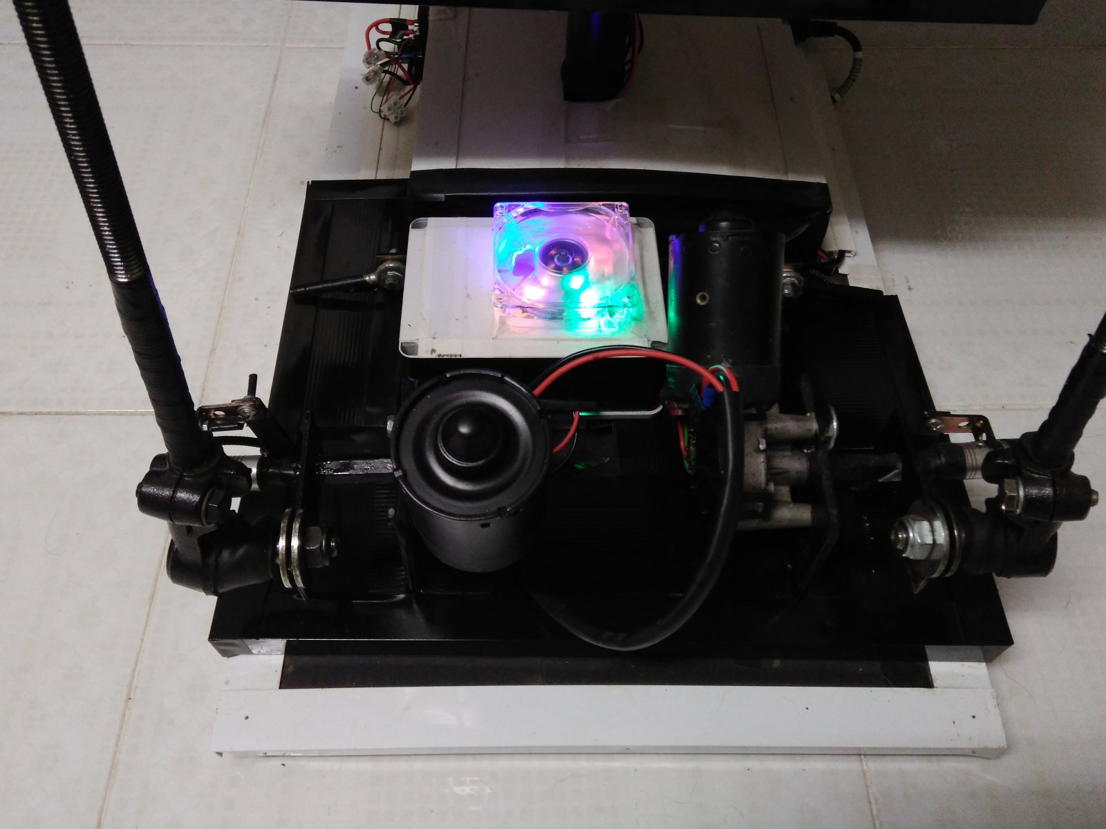

    Yesterday I bought these two new motors (thanks @Pit for the tip!) :D
    12V DC geared motors with 60:1 ratio worm/wheel gearbox
    Voltage: 12V
    Current: 23A
    Speed: 65RPM
    Torque: 15Nm
    Peak Torque: 30Nm
    Gear Wheel Material: Delrin
    This morning I got the hearness belt I ordered. :)
    And since things were going just fine... one JRK stopped working :(
    As it happened to the other one, the mini USB on the controller is giving me a lot of problems and I don't know if I can fix it this time as I did for the other.
    Back to Ard/MM? pffffffffff :(
