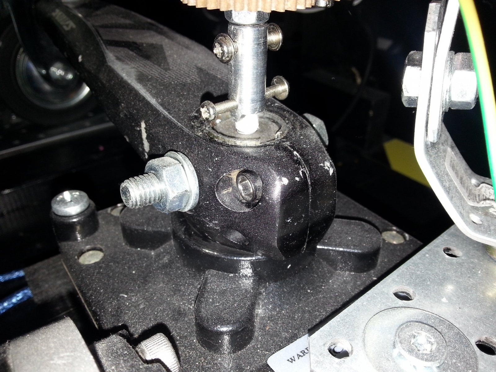

    Nice solution! It's an m8 the one you're using too?
    Did you buy the bike cranks online?
    PS. I see you're using it for the traction loss, a 17cm crank I suppose
  2. Pit
    3,007
    30,516Coins
    +3,098 / 31 / -0
    I'm a former downhiller so this crank was lying around...it's from a dh bike. The diameter of the axle is not the same, so I had to use spacer.
    PS: M8 screws

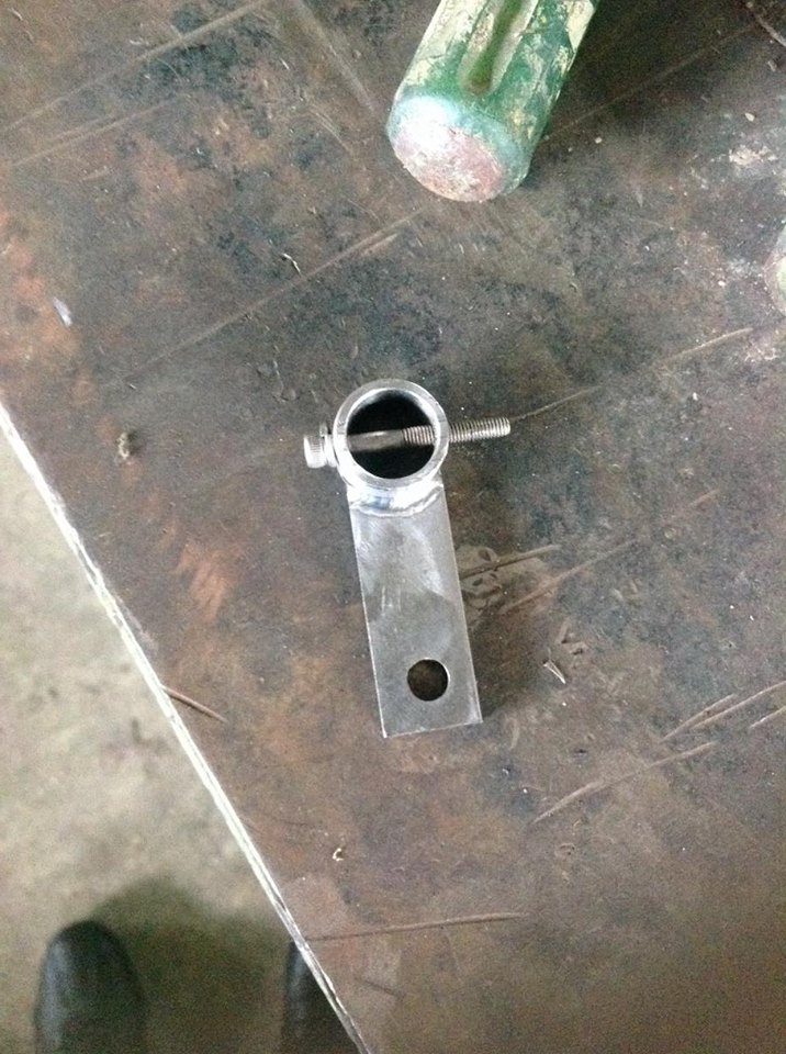

  4. shannonb1
    shannonb1 Well-Known Member
    Mar 12, 2008
    1,106
    Sales Intelligence
    Virginia
    8,909Coins
    +598 / 5 / -0
    I did that, sheared the bolts, it was a mess....you really need to have the cranks so they squeeze and not just rely on the pin
  5. Blame73
    Blame73 Well-Known Member
    Nov 6, 2014
    1,216
    8,315Coins
    +1,140 / 5 / -0
    And now what are you using? I fear common bolts could break, maybe a steel shaft...
  6. BlazinH
    BlazinH Well-Known Member
    Oct 19, 2013
    2,145
    Oklahoma City, USA
    16,701Coins
    +1,840 / 32 / -1
    Try using grade 8 bolts. Grade 5 bolts deform and then sheer. Grade 8 bolts will take on more stress before they sheer and don’t deform much.

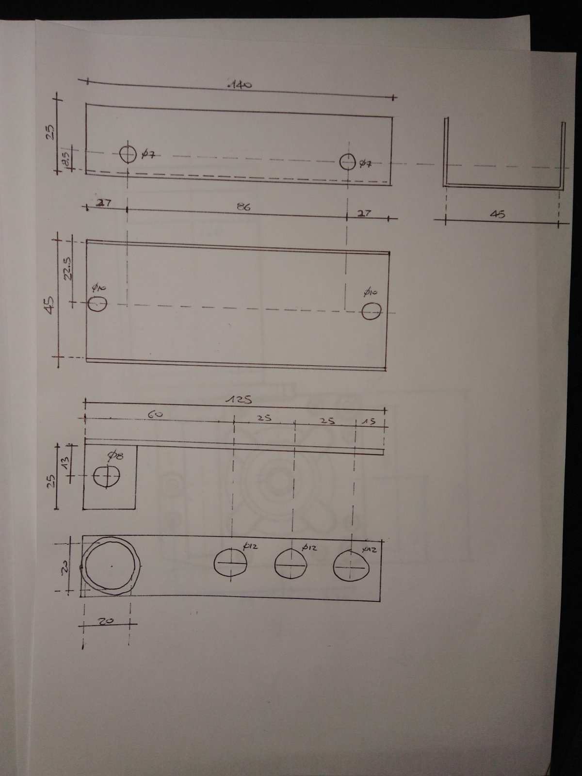

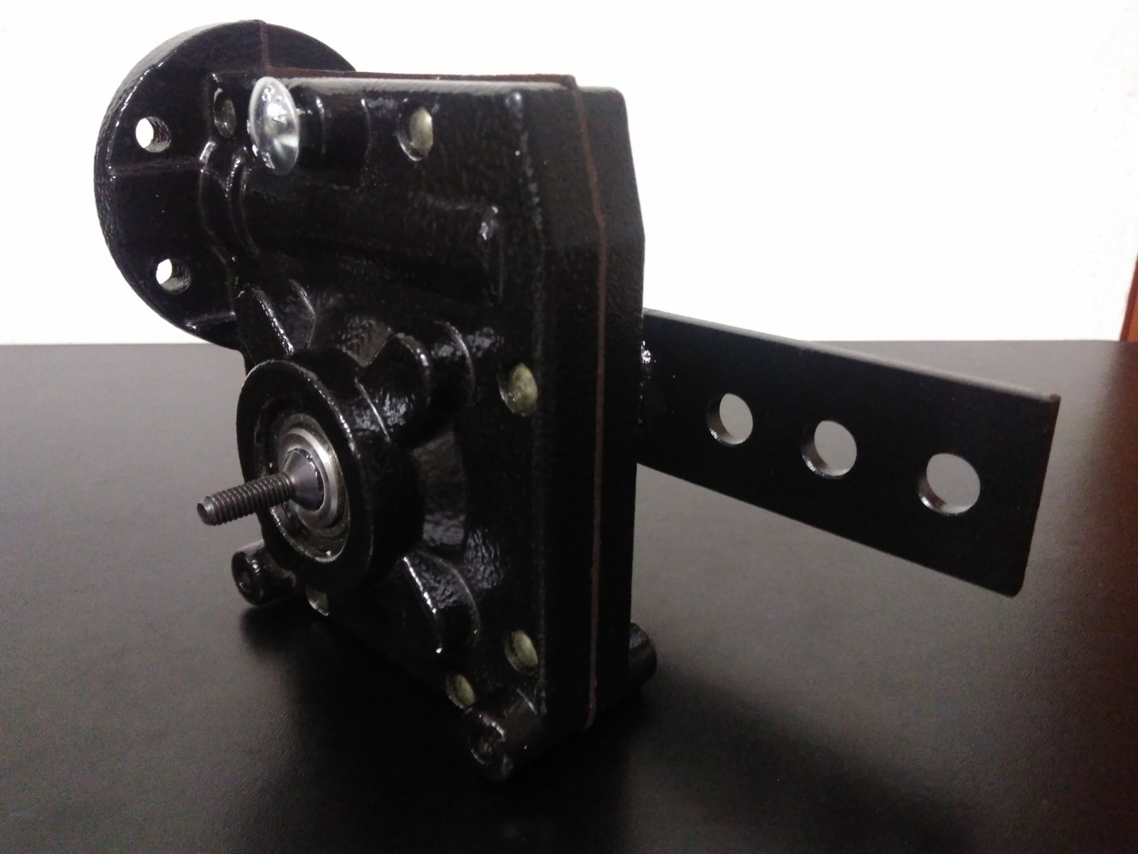

  7. Blame73
    Nov 6, 2014
    1,216
    8,315Coins
    +1,140 / 5 / -0

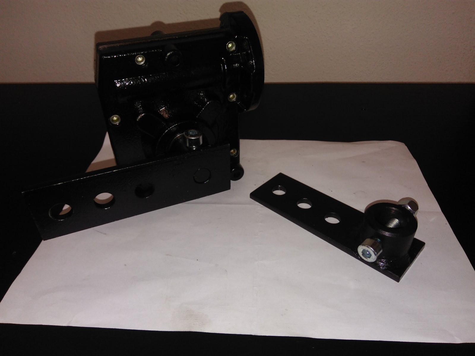

    sketches for motors holder and levers to wormdrive gearboxes
    worm drive scheme

  8. Blame73
    Nov 6, 2014
    1,216
    8,315Coins
    +1,140 / 5 / -0

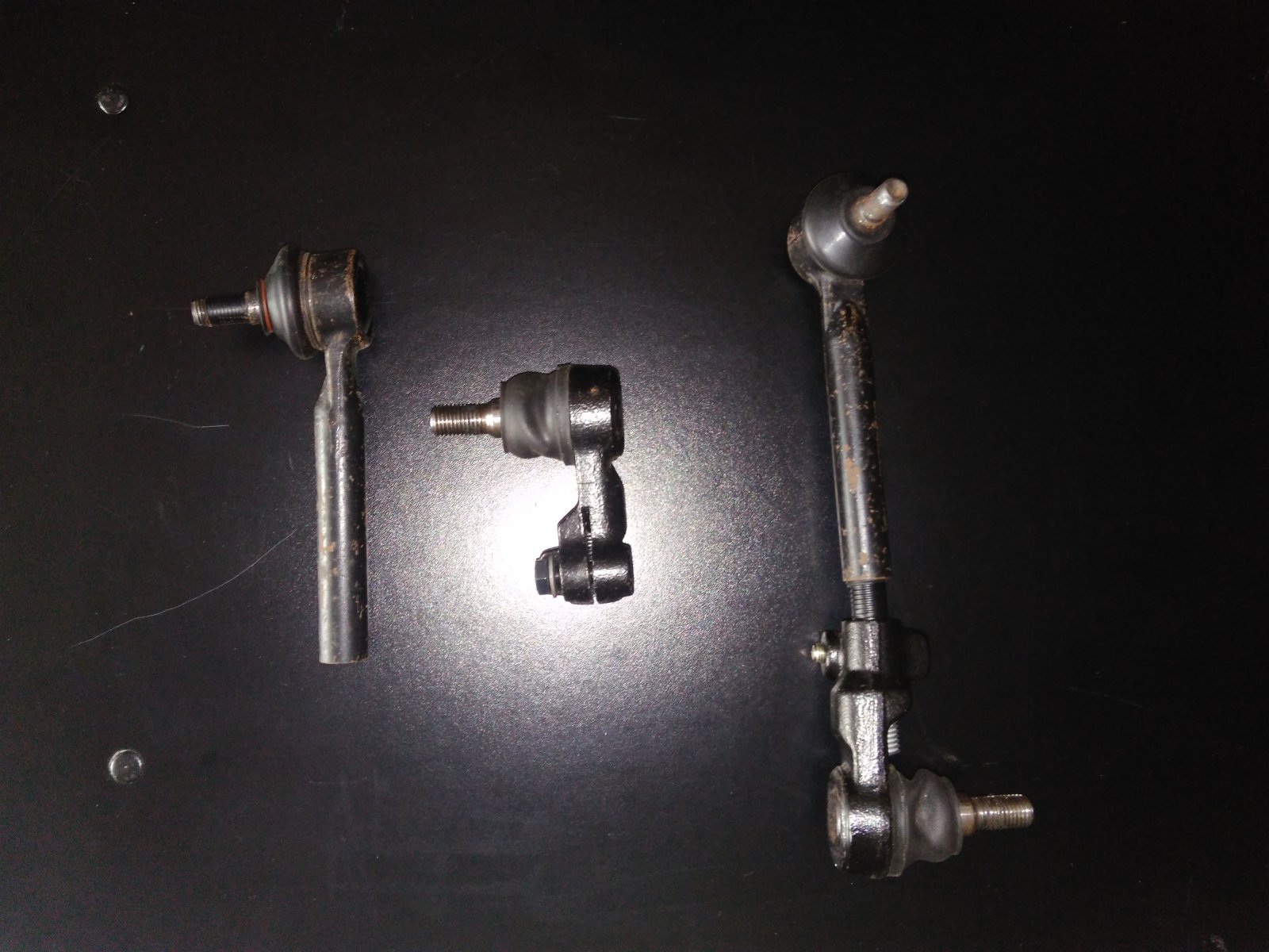

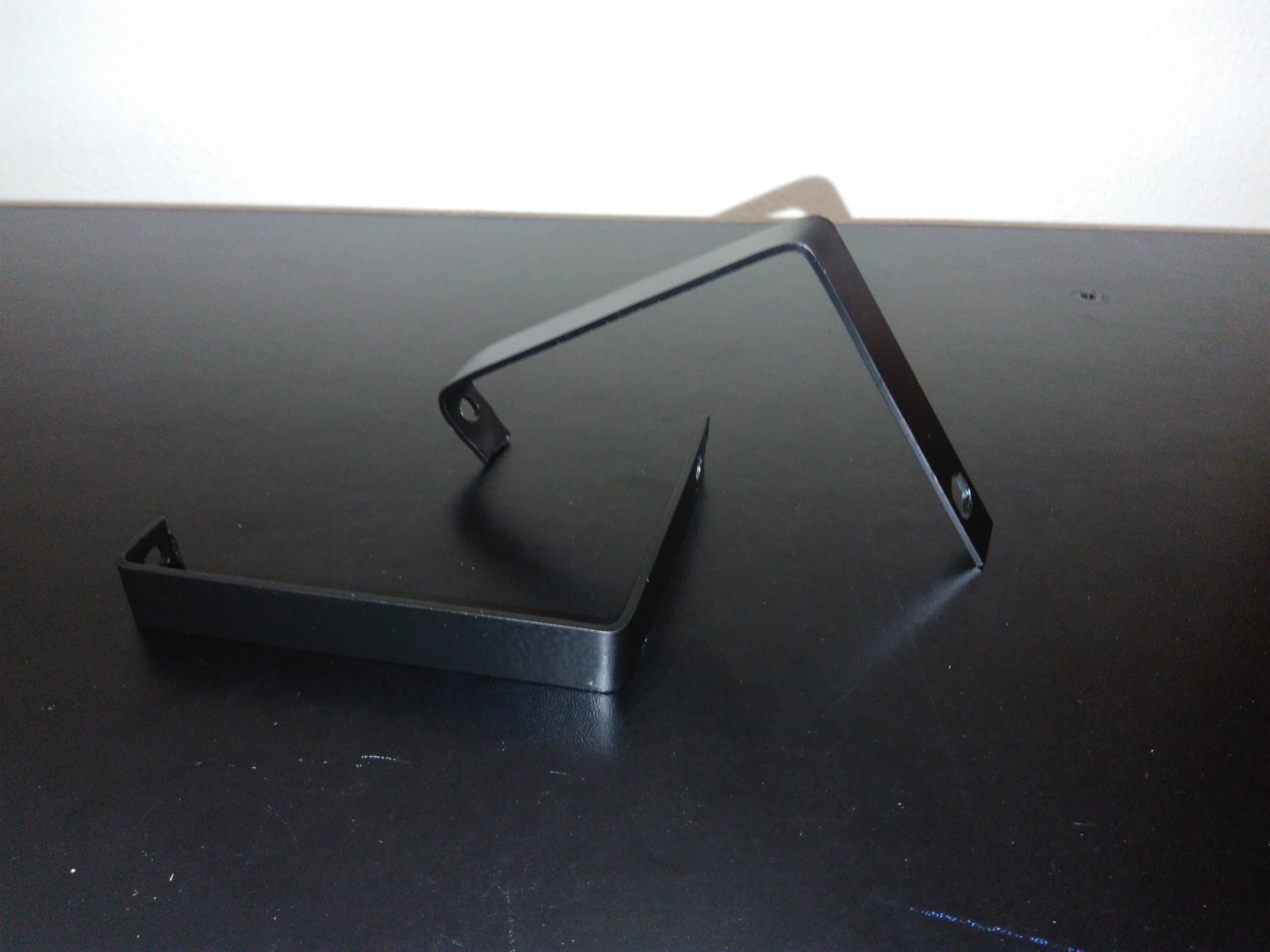

    Waiting for the levers to be done I built an Arcade box
    Now it's time to start all over again.
    Joined top and bottom tie rod ends
    New fuses
    The new levers! Beautiful!!

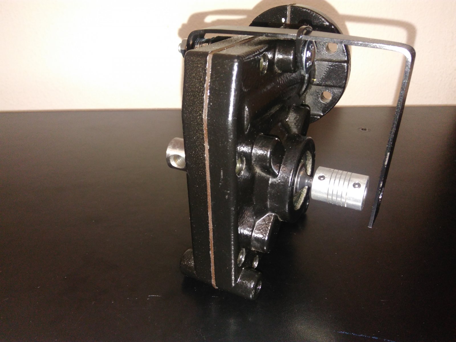

    Bended some aluminium (1.5 cm stripes) to hold the potentiometers
    A bolt for the coupler
    With the coupler
    To be continued...

  9. Shurup
    Shurup New Member
    Jan 29, 2017
    11
    Spain
    178Coins
    How did you fix that bolt to the motor shaft? Epoxy? Is it perfectly centred? If not, once start turning it will describe an eccentric movement and will be difficult for the pots handle it.
  10. Nick Moxley
    17,057Coins
    +2,507 / 30 / -2
    Drilling the shaft while the motor is turning is a Great way to ensure its 100% bang on. Also Some of the solid shafts have a start to a hole already there, so its just a matter of drilling out to the proper size....Tho it appears the motor's Blames got required Very precisely drilling of the shaft to get his feedback bolt in place. Its more than doable and There's a good reason we Run Flex Couplers. To help remove that wee bit of wobble to the shaft.
    I Threaded my Motor shaft and inserted a Cut down m6 bolt. It appears Blame might have used epoxy, but im Not sure if he threaded the shaft or not.
    LOL upon CLOSER inspection......Blame, did you glue the Flat of a Flat head screw to the shaft ?

    The shafts have a clear center (concentric circles), and flat screws also have it.
    Loctite for metals.
    Perfectly aligned, it doesn't make any ellictic movement (and there's a flexible coupler anyway). I tried this way before drilling the shaft and it works.
    You won't move it even with an hammer! I applied a lot of strenght trying to move it, but I haven't been able to, seems to be soldered

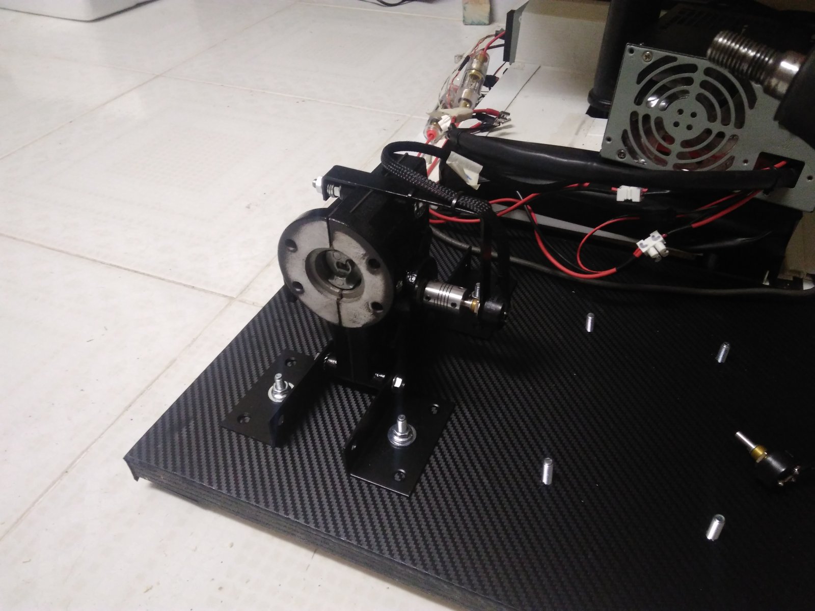

  14. Blame73
    Nov 6, 2014
    1,216

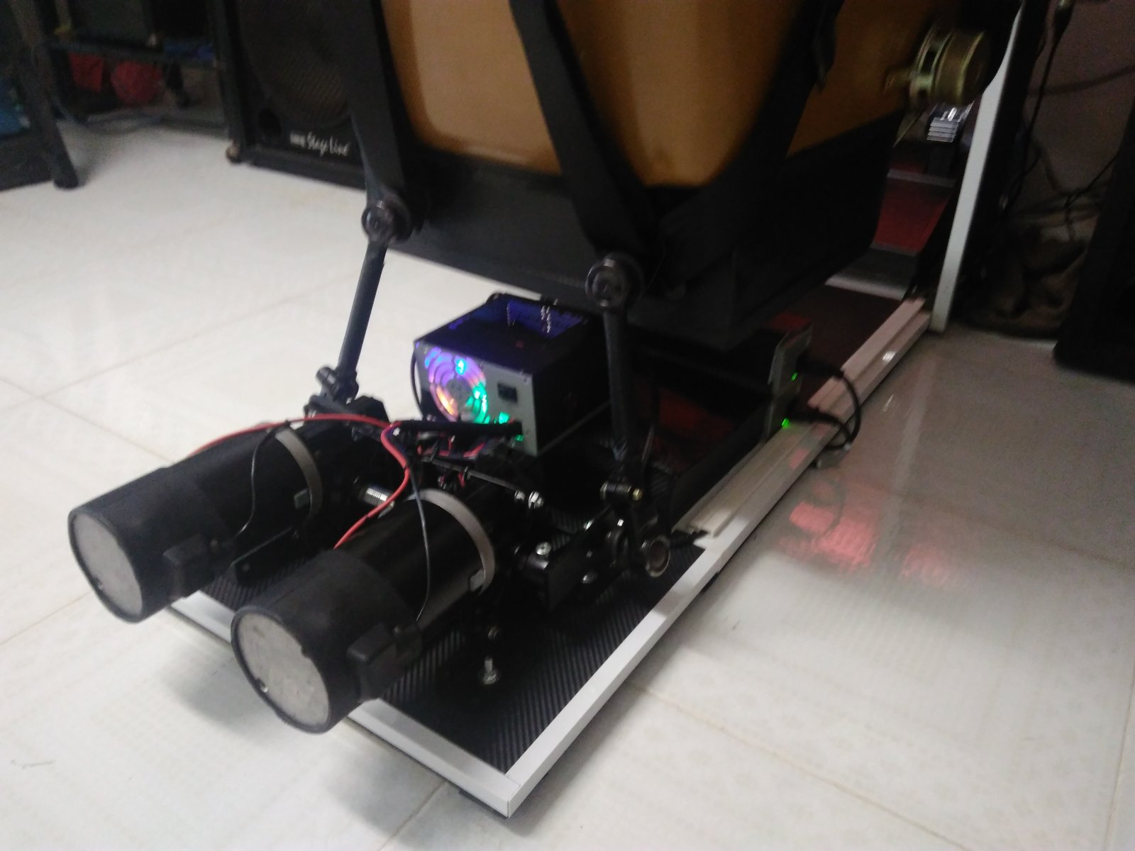

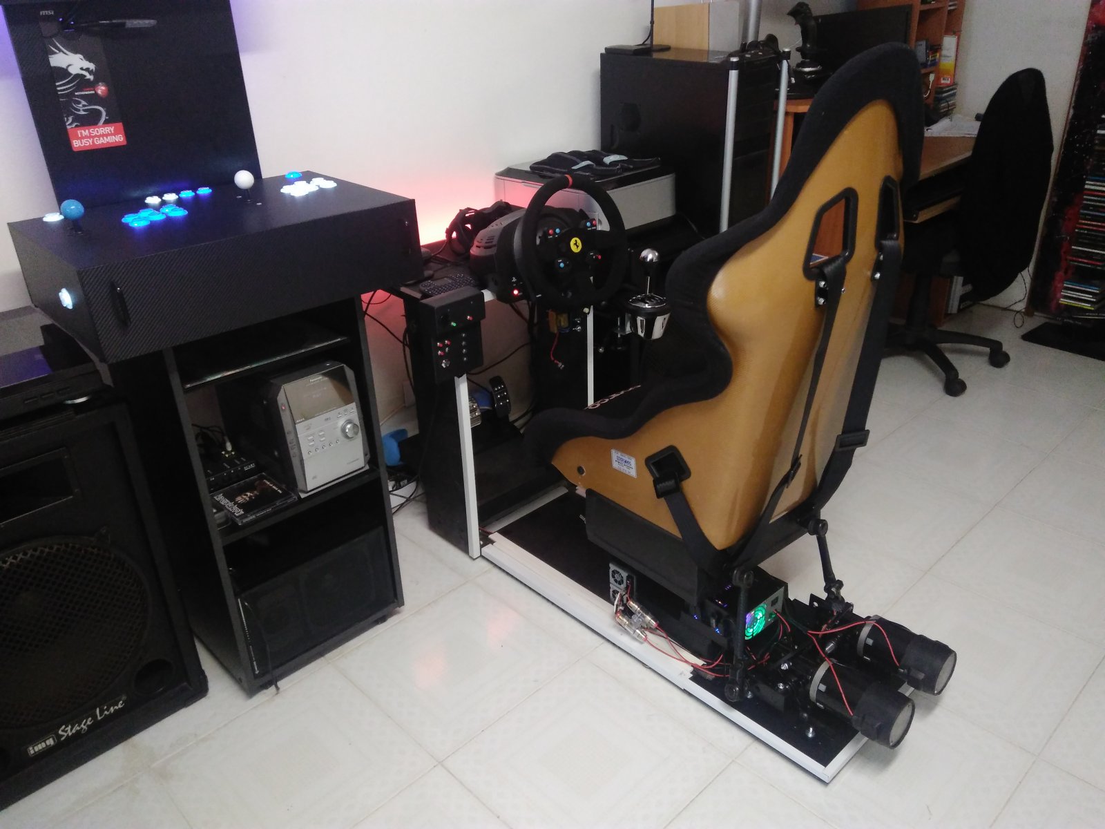

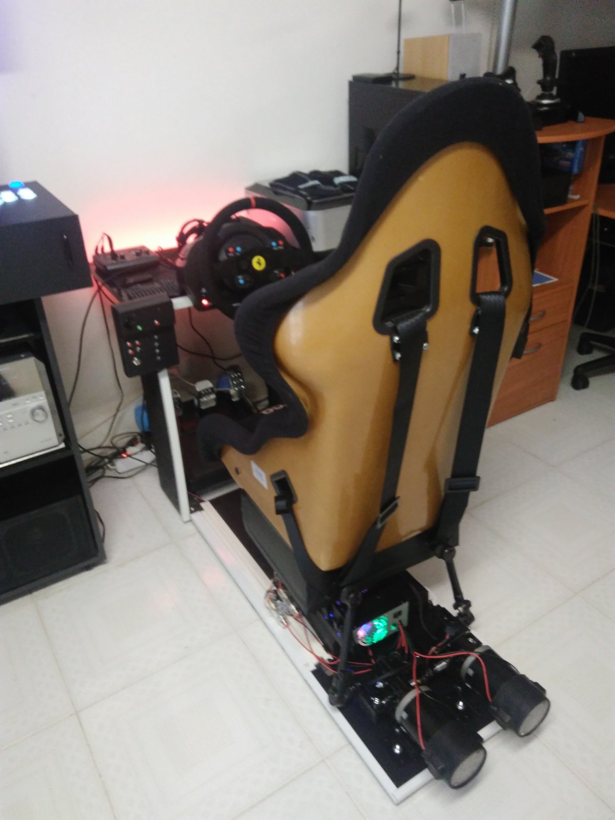

    8,315Coins
    +1,140 / 5 / -0

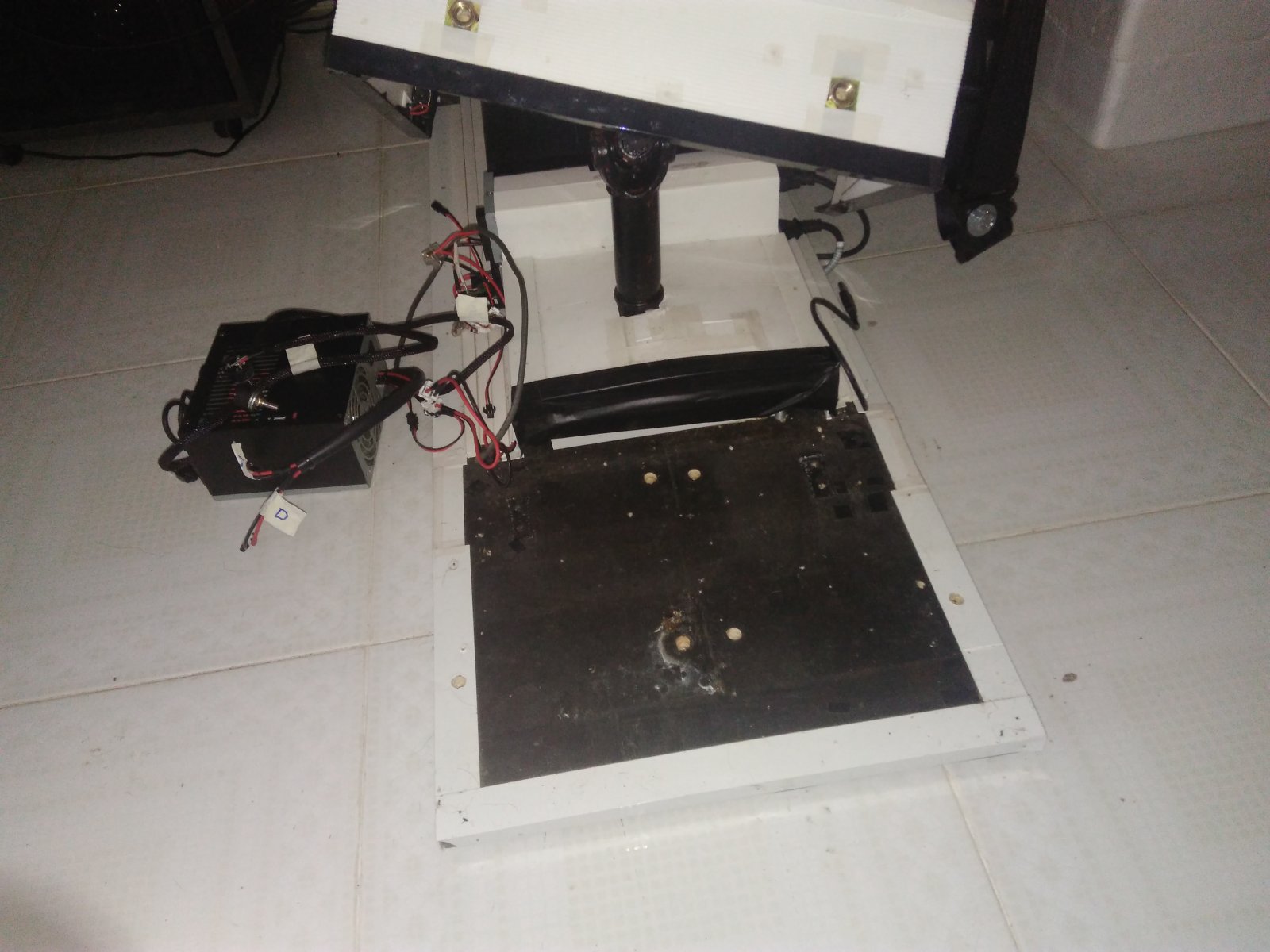

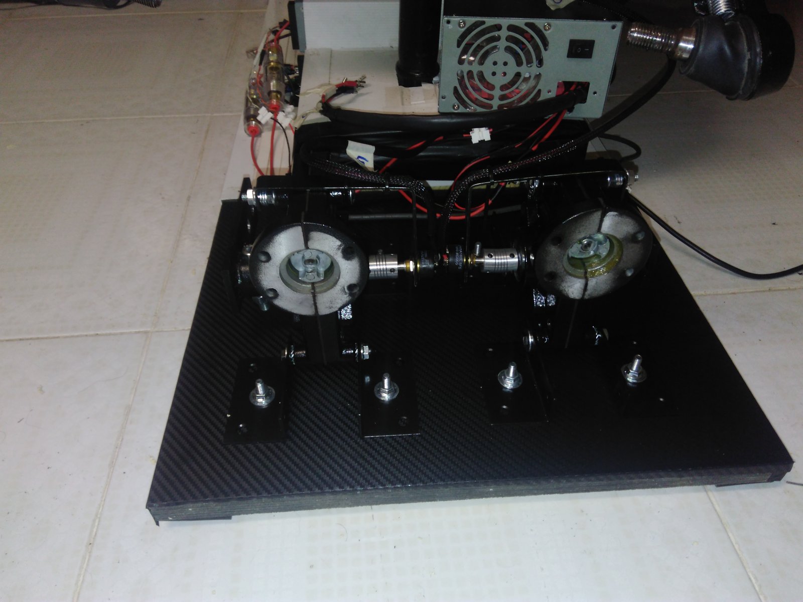

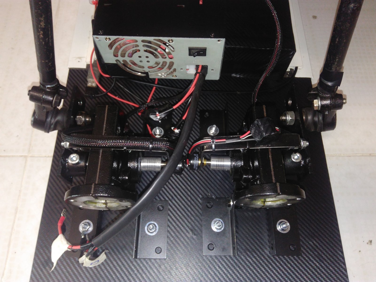

    part two
    found motors holder and placed in position. left motor
    and right

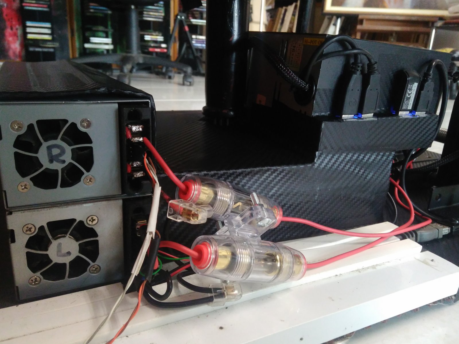

    PSUs, fuses, electronic box w/ USB hub
    Let me introduce you v. 2.0 of my Seat Mover!
    With Simtools 2.0 and the new motors it's nowhere near the previous version (simtools 1.3 and wiper motors)!!
    That little movements of little degrees you won't never feel with wipers are now there, making me discover new bumps in tracks I thought I already knew)
    Decent photos (not taken with a poor camera phone) and a video to follow

    What do you prefer, long bars to the seat shoulders as before with wipers or this new design with short arms under the seat? Why have you changed your design?
  16. Blame73
    Nov 6, 2014
    1,216
    8,315Coins
    +1,140 / 5 / -0
    I changed just because with the new 60:1 I don't need long bars anymore (and I avoid my 2yo daughter to hang there... she thought were there to be pushed and pulled).
    With high torque you don't HAVE TO, as with wipers where a longer lever is essential

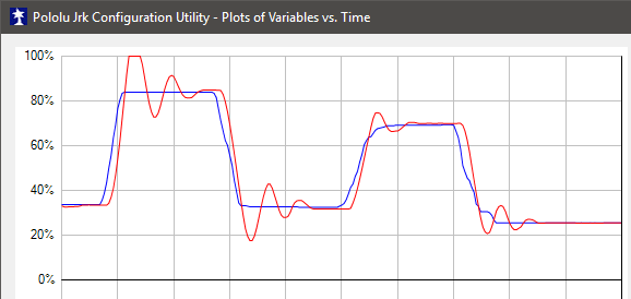

    @Avenga76 I've read on another thread that a graph like mine (below) is because of underdamped response, so I should add more D or lower the P.
    My PID now is 0.5 - 0 - 0.5 what do you suggest me doing?
    Thanks!
  20. Tim McGuire
    Jul 26, 2015
    261
    Canada
    2,229Coins
    +317 / 2 / -0
    3DOF, DC motor
    Less P, add a little bit of I,
    It looks like you've got way too much P, and too much D. I don't know if the JRK config is the same as other PID loops, but usually Kp and Kd shouldn't be even close to equal. Try lowering D by a lot, lowering P by a little bit, and adding a small amount of I. Also for best accuracy, are you sitting in the seat when you're tuning it?
