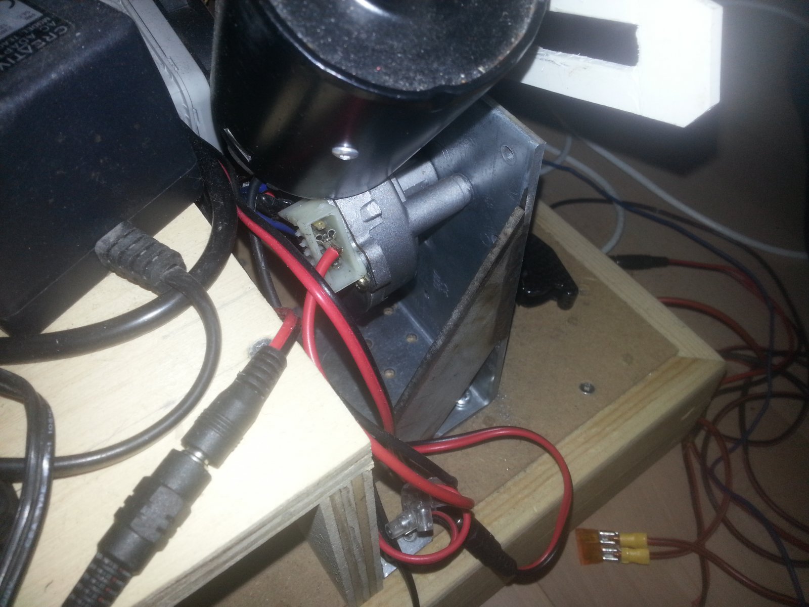

    Waiting for the Playseat seat to arrive, this is how I'll move my desk chair
  2. mugge66
    mugge66 Member
    Jun 11, 2014
    80
    Denmark near Copenhagen
    167Coins
    +26 / 1 / -0
    2DOF, JRK
    Hi the way you mounted the motors on brackets is not a good idea, the motors will break where the screws are mounted. please drill new holes so the motor is mounted at all points.
    Also i welded a bracket from top to buttom to stabilize the bracket. it help alot on motion. will post a picture later.

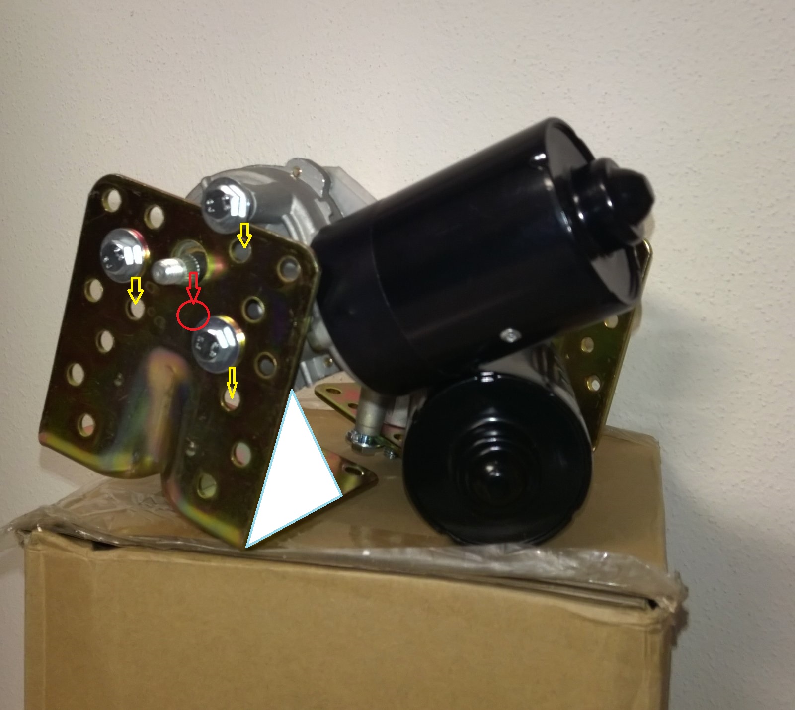

    Agree, that's what I'm gonna do:

    yes thats the way to go
  5. Nick Moxley
    17,057Coins
    +2,506 / 30 / -2
    Mugge66, your motor plate looks Far Beefier compared to blame's.
    Blame how thick is that plate
    For reference, These are what i mounted my motor's too and the Angle on the left twisted like a pretzel under LIGHT motion. So worst case you might need to super beef up that bracket or find something a little thicker gauge.
    also FWIW, my motor's are not mounted on All 3 Mounting holes.

    Mine is a full seater, as you can see on my thread, so i dont know if there is more weight on my motors. but i started with only mounting with 2 screws and on one of the motors the mounting hole cracked.

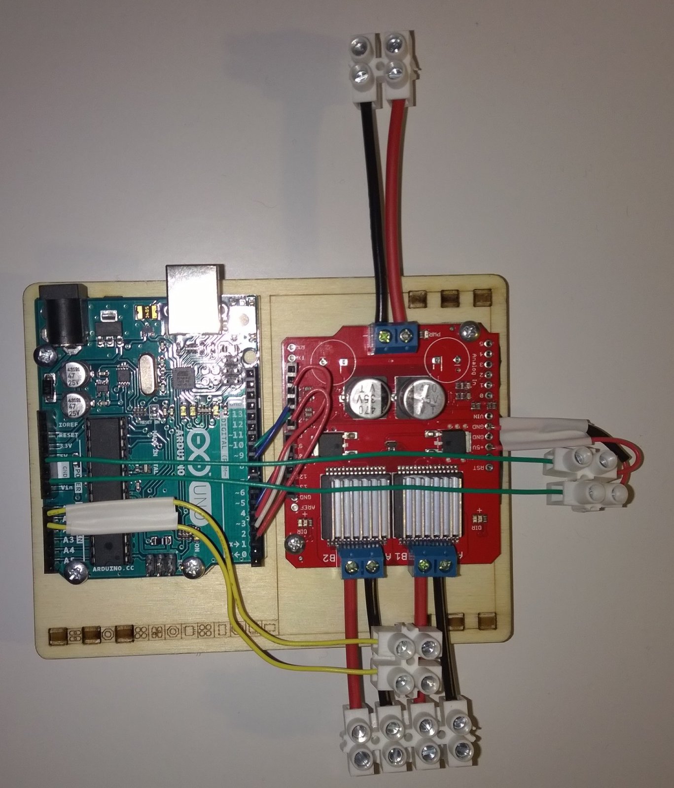

    Yesterday I went back home and found they delivered my new wheel (G27) and, finally, the Moto Monster!
    I now got all I need :thumbs
    I've seen someone stuck the MM on top of the Ard, but I prefer wire it also to avoid overheating.
    Have you guys got some pics or guide on how to bind Ard to MM and, especially, to pots? I got some doubts about the last connection. :sos
    Thanks, it's gonna be a long night tonight :cheers

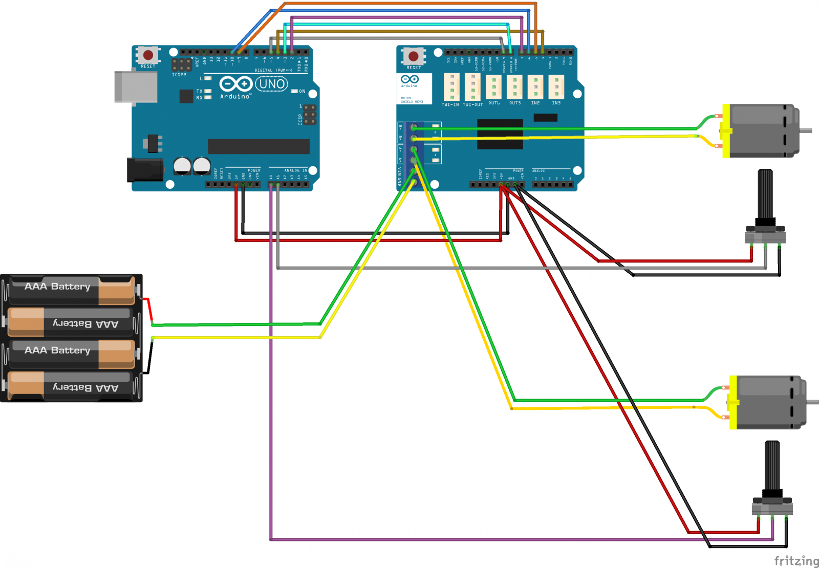

    @benj It's on how to connect the pots.
    What I'd do is soldering 5V and GND from Ard to MM to pots, A4 to Ard to MM to Pot1 and A5 to Art to MM to Pot2.
    Is that correct? Is it the right sequence?

    It's less complicated when you stack the Ard and MM - because the MM is a 'shield' - right? - so it's designed to stack on top of the Arduino.
    You could do it like you say though, just more soldering and wires.
    What you've written sounds right :) Make sure you figure out your Pot pins - I had to reverse the 5V and GND on one pot, which I wasn't aware of, and then also reverse the motor wires going to the MM on that side.

    it all depends on what code you are gonna use for your arduino so you can wire them up properly.
    here is some i found all are well explained
    http://www.xsimulator.net/2dof-motion-simulator-truck-wiper-motor-playseat/
    http://www.xsimulator.net/community...3dof-motor-driver-and-windows-utilities.4957/
    http://www.xsimulator.net/community/threads/arduino-uno-duemilanove-2dof-firmware.4564/
    i think there is no code here for stacking arduino and MM
    juts pick a code and wire it as the writer says
    EDIT: first code can be staked. sorry couldn't remember it, had to look it up.
    my opinion is to keep the separate so you can cool them better.

    Sad and tired I'm going to bed... It doesn't work
    Everything seems to be ok, even pots work and move the green line between the limits in Smc utils. I can feel some noise coming from the motors but they just don't move.
    psu works and I can turn it on and off through the switch. Damn!
    any suggestions?

    Did you get a multimeter and test the voltage output of the PSU?
    It looks like you are using wiper motors, right, so they don't have an electronic brake on them do they?
    I don't know the Arduino to Moto Monster wiring, but everything else looks good to me for the wiring.
    And hey, don't worry - problems are going to happen, and when you solve them it makes you stronger ;)

    @benj Thanks for your answer.
    I'm gonna test voltage when I get home.
    Yes, I got wiper motors but I wouldn't really know how to check if they have electronic brakes.
    It's not that I'm worried, is that I don't have enough electronic knowledge to solve problems I don't know.
    But I ain't hopeless, it's just that I thought I was near the end and now I'm stuck...
    I'm gonna also try the @RacingMat method, that could be faster to test temporally stacking the Arduino e the MM together.
