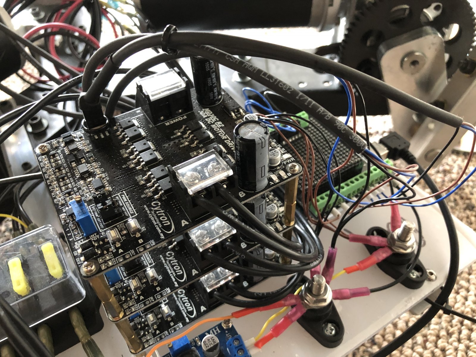

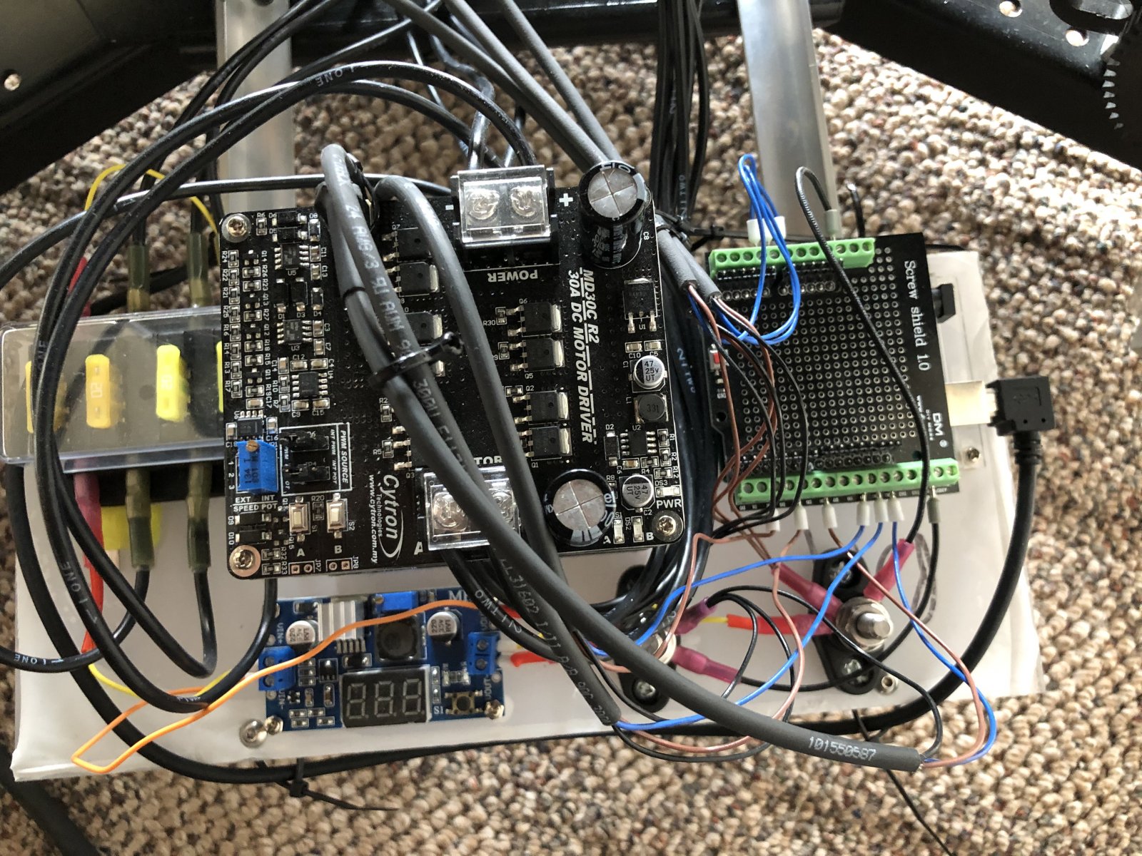

    weird... could you post a close picture of your Arduino/md30c?

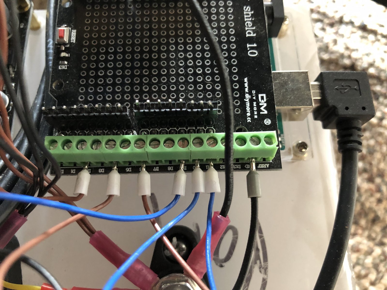

    Sure, Let me know if this is good enough. If needed I could draw up a schematic. I am using the screw terminal shield for the Arduino, but you should be able to see the input locations. The screw terminals supply 5v power to arduino, pots, etc.

    From what I see it's hard to say because you can't follow all the cables from Cytrons to Arduino. PINs seem to be ok.
    Have you tried connecting them (just for testing purposes) without the shield? A mere Arduino/Cytron connection to see if it works
    With the setting I posted and with that sketch I just finished an hour session and all went fine.
    I seem to remember I had the problem of motors rounding in one directions before I made the changes to the sketch, I don't remember if by the time the problem was the MODE 1 or the PINs settings (it needs MODE 2 with my modified sketch-but that's already set, so you should be good if you're using it)

    I'd try swapping the PWM an DIR pins, as it's the effect I'd expect if they were the wrong way round. Direction would always be in one direction as the PWM would always be positive & speed would always be the same as the Direction voltage would be a set value rather than proportional. & as Blame73 says, Mode2 on the Cytrons.
    Hope you get it working.

    Thank you for the help! Fingers crossed, but it looks like removing the screw terminal shield and connecting to the Arduino pins. I still don't know what exactly the problem was with the screw shield, but at least I have a way forward. Thank you for your time, expertise, code, and help.

    Ah yes, sometimes the smallest things make a huge difference. Removing all unnessacary hardware and leads have saved my projects on more than a few occasions. Anyways, hope you get it sorted.

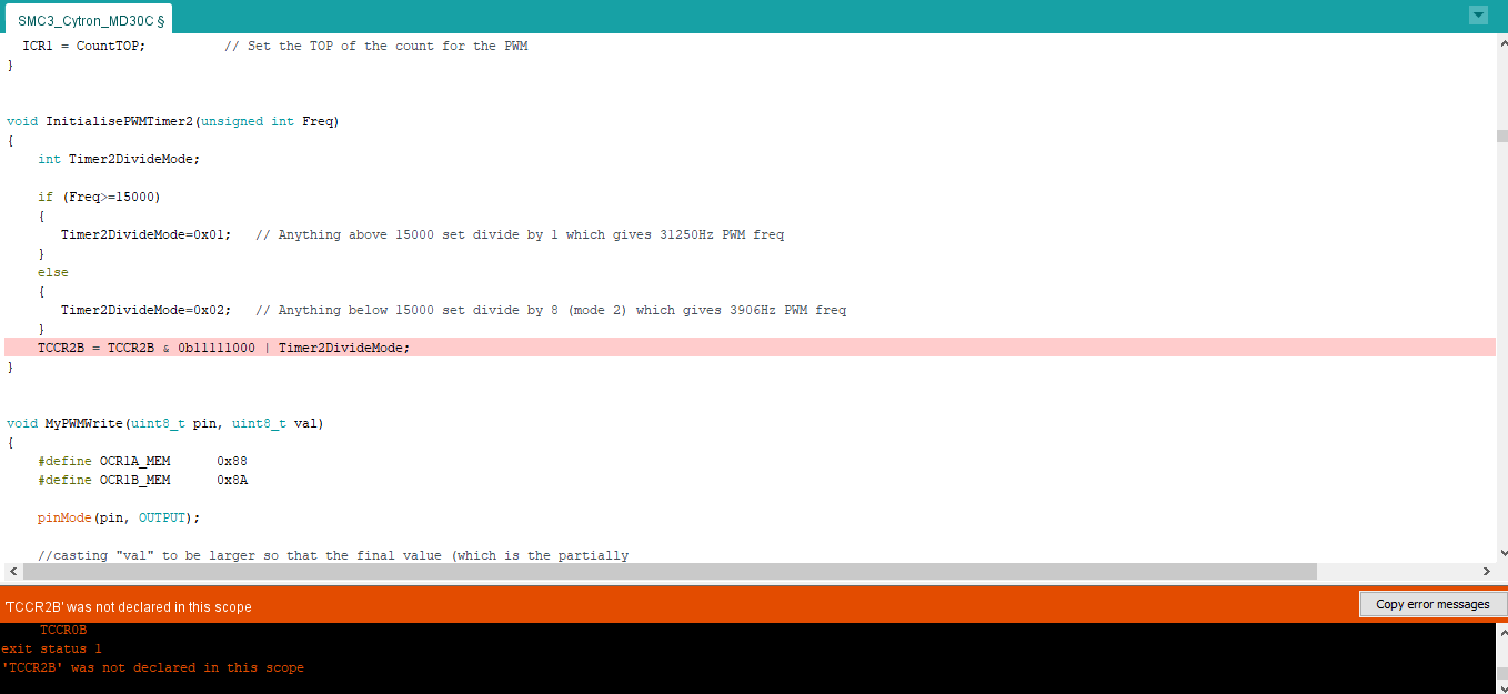

    Hi Guys
    Just received my md30cs for my build and was going to do a miniature setup for a test while i wait for more bits to arrive, i grabbed your code @Blame73 to have a go and was going to report back but its getting stuck verifying, I've attached a snip of it,
    Thank you for your efforts on the custom code mate should make life a lot easier for everyone!

    what Arduino version are you on?
    I'm using 1.0.6

    Hi there, I use Blames code so thought I'd check the verification with the latest version of Arduino IDE (1.8.1.3) & it compiled fine. The picture you poosted of the verification failure, showing TCCR2B is not the first reference of it in the code which makes me think your code is failing verification earlier, probably on a different part of the code. This can easily happen if you accidentally move, delete etc parts of the code while scrolling throught it.
    Can you copy the entire error message and post it. when getting a verification error it's normally best to scroll to the top of the issues and work your way through it, as a problem might have occurred earlier in the code which ends up with a trickle down effect, breaking later parts of the code.

    @Blame73 @p00ky
    Well..... dont i feel stupid :(
    simply closed the ide, opened it again and it flashed straight over :roll
    Thank you for your help, will try not to be so stupid moving forward lol
