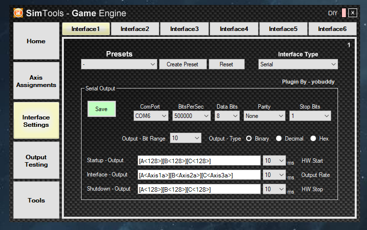

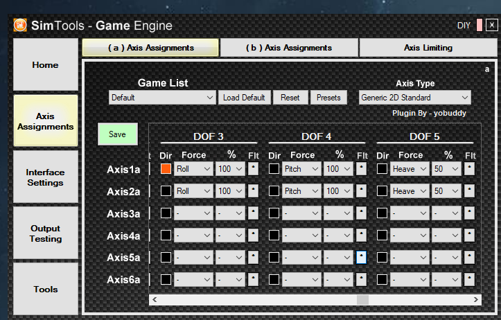

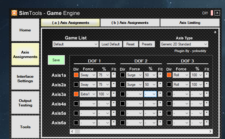

    So thought I might just show you my settings in simtools, maybe that will help you out.
    So the first and most important is the connection settings......
    I have 3 motors , 2dof and traction-loss but this wikll work if you only have 2 motors. The only thing you would need to change is the com port so it's the same as your arduino.
    Then theres the individual dofs and axis.
    This should only be used as a guide as you would want to tune your machine yourself. The only thing to note is the third axis which has been set to extra1 which is normally used for traction loss.
    I haven't included my axis limits settings as again that is something that would be particular to your machine.
    Hopefully that helps.
  3. Rav3n87
    Rav3n87 Active Member
    Sep 9, 2020
    131
    723Coins
    +45 / 0 / -0
    @p00ky
    another total noob mistake, didnt realise what smc3 utility was trying to do grrr it wasnt working properly....turns out i had the driver in pin 3 instead of pin2 ffs..... works like a charm, will start my thread tomorrow and pop a video or something up of hopefully all three tracking the target in smc3
    thank you both for putting up with me!
