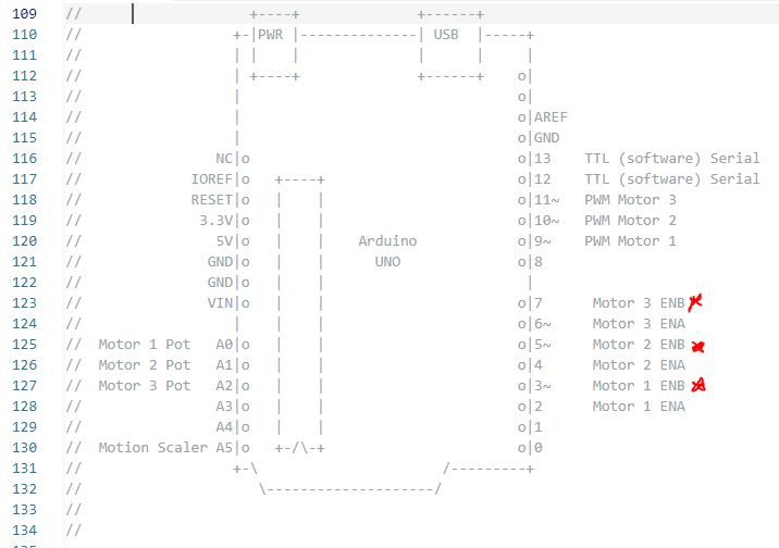

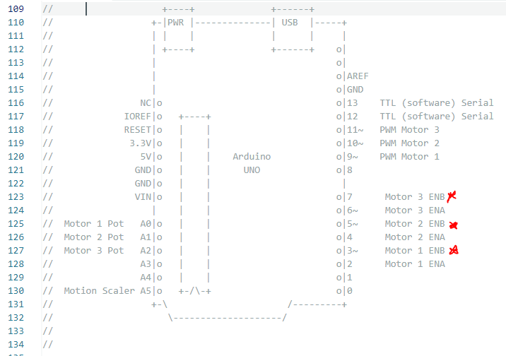

    Hi, I want to say this thread has been very useful as I'm also making a sim using cytron controllers, so thank you :)
    I have a question on the code, I'm new to coding arduinos and just want to check / confirm something.
    I am using MD20 controllers, which use the same 3 pins (PWM, DIR & GND) as your MD30. This means I only have connections to pins 2, 4, 6, 9, 10 & 11 on the arduino (for PWM & DIR). I want to configure pin 5, 7 and 8 as inputs / outputs to control an electronic brake on my motors, and status LED's.
    I'm a bit confused looking at the code, see below. But it appears you might have pins 3, 5 and 7 wired? Or is this not the case?
    Like I say, I'm new to coding arduinos and any help / clarification will be much apppreciated.
    TIA :)

    Hey,
    I haven't wrote the original code, I only adapted it to work with my Cytron MD30C (and somebody's also using it with his MDDS30), anyway PIN 3, 5, 7 are used as second output pins for Motor H-Bridge 1, 2 and 3 (ie PortD bit position); you could of course adapt the code gettig rid of those and using those pins for your needs
    (I'm not using those pins too)

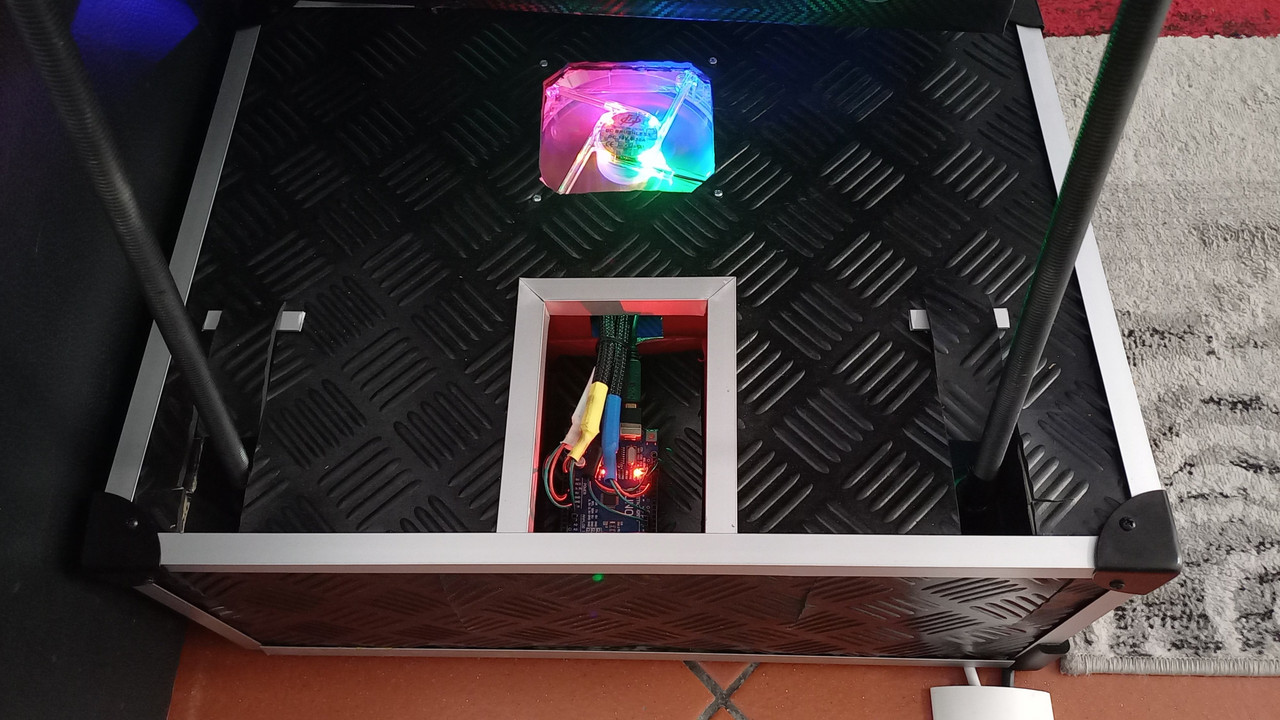

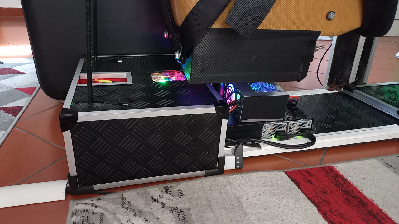

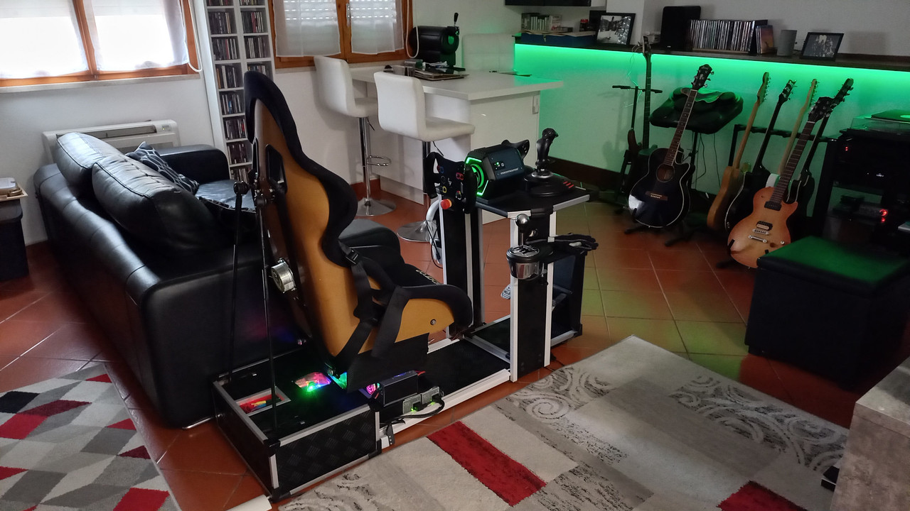

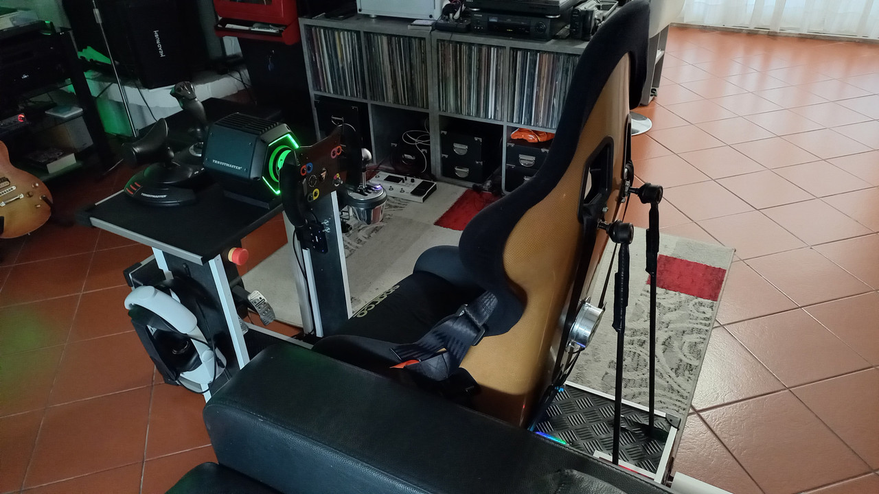

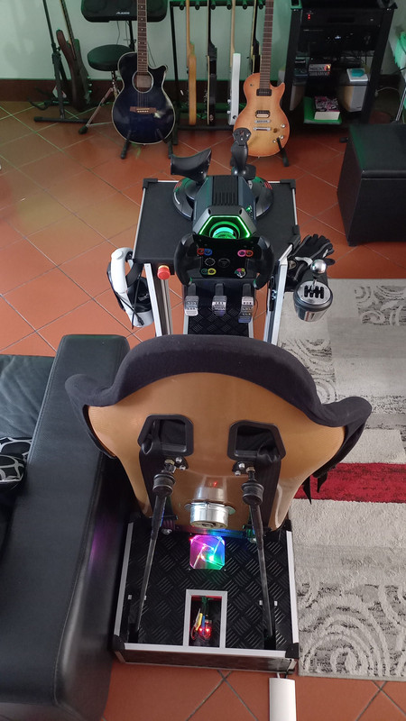

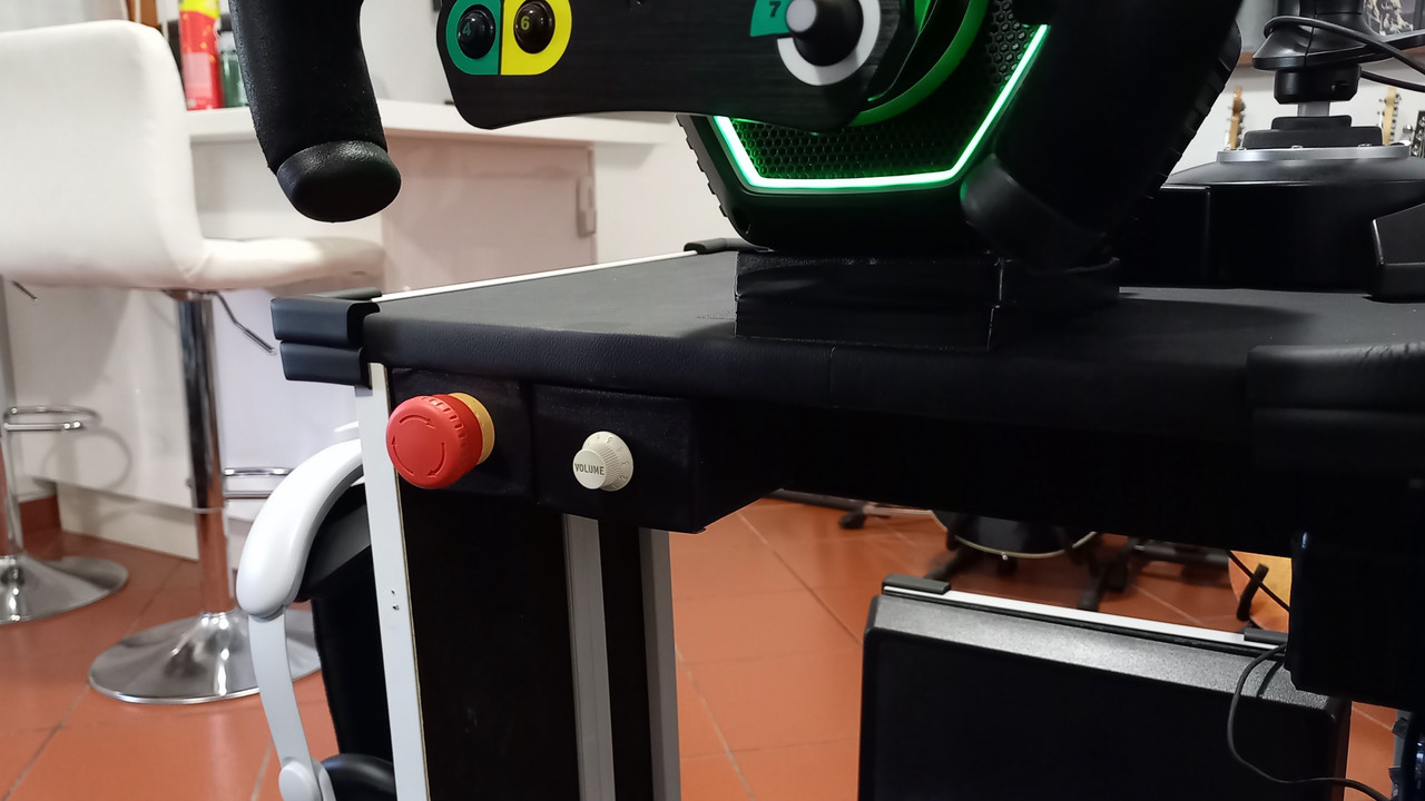

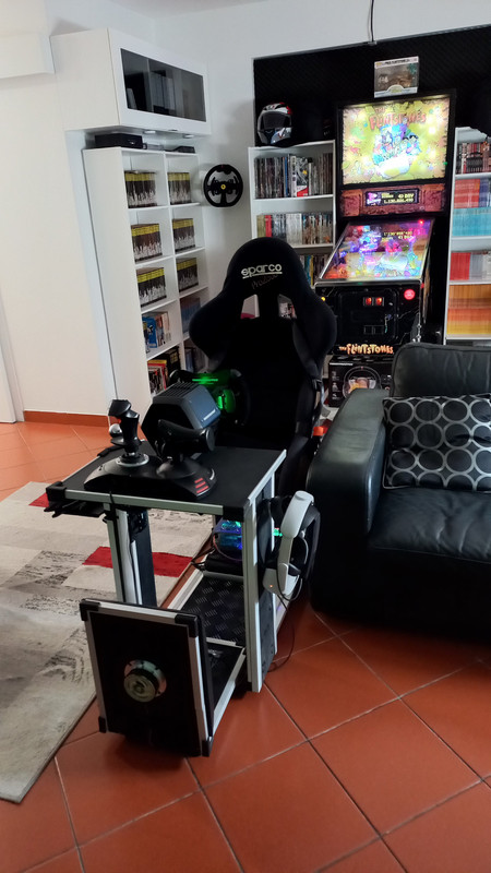

    Ok, here it is: v3 of my rig :)
    • Rewired and resoldered from scratch (I had too much signal noise)
    • Added pulleys (adding pulleys was one of the best upgrades ever for me, it stopped PSUs occasional tripping, being the position of the pots and the their range much more accurate)
    • Diodes (KBPC5010 1000 V 50 A)
    • Moved the two individual emergency stop buttons to one single button
    • Moved the rig to the center of the room because I have a projector that I use when I'm tired of using VR, for arcade games or when someone wants to try the rig and can't use VR
    • Because of the previous point I had to build a protection from the levers because I didn't want my daughter or anybody else got hurt by them
    • Since I was building the box I moved the Arduino UNO from one of the Cytron's boxes (that I had built out of PC PSUs) to the back of the new box where is easily accessible in case of need. It was a pain in the a$$ doing it previously
    • Moved butt shakers to the back of the seat and to the front of the pedals and added a dedicated switch
    • Updated the code of the SMC3 Mode2 for my Cytron MD30C (grab it here)
    • Last but not least... Thrustmaster T818. I wanted a direct drive steering wheel and since I already owns two Thrustmaters wheels for the T300 I opted for the T818; it delivers a constant 10 N⋅m of torque that's more than enough for me (I'm using it at 70% ingame gain)
    Next steps: already ordered some WS2812B led strips for RPM Dash
    A few more pics:

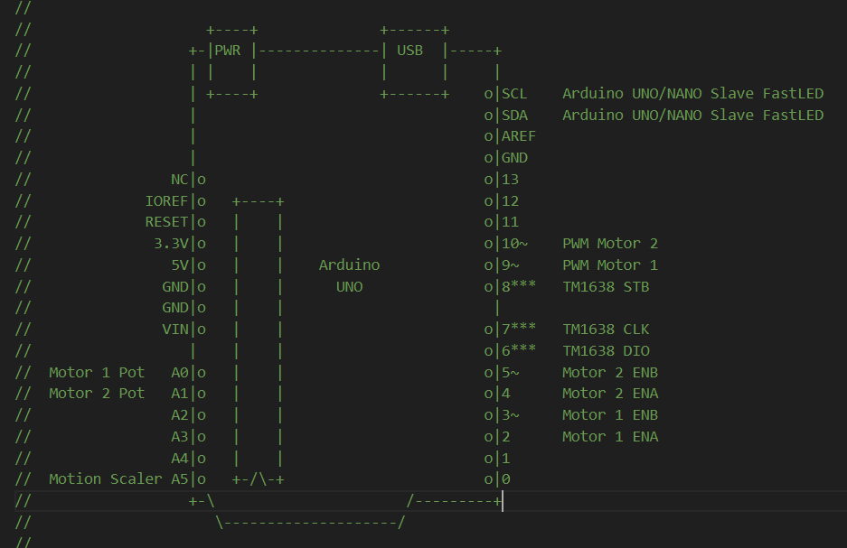

    Two versions
    The "flat" old one (SMC3_Cytron_MD30C 1.1.zip) that drives three motors (I think it has some bugfixes compared to the one I had previously posted). Someone is using it and it's working fine.
    And the new one (almost finished but not fully tested) that supports TWO motors and: analog motion scaler for Cytron, TM1638 Display+LED, FastLED RGB (WS2812B) LED strips (SMC3_Cytron_MD30C 1.6.zip)
    The LED strips let you see the position of the motors (or potentiometers, it's the same...) so you can f.i. check if you're often going in the clip zone. Controlling the strips with the main Arduino that runs the SMC3 code was heavy (on top of all the rest) so I moved the code to a slave Arduino UNO/Nano board. The Led strips have different visual styles and can also be used with random effects when not in use.
    RGB (WS2812B) LED strips connected to the Arduino Uno/Nano SLAVE (via I2C Mode) will show your current feedbacks position. The device will act as a listener (slave board) with I2C events raised by the Arduino master (the onewith the SMC3 code)
    If you want to use the LED strips you should also have a TM1638 module, so you can change functions using its buttons. The TM1638 module also stores and shows live values of your ride like max/min input values reached, how many times you enetered the clipping zone, how close you went to the clipping zone, etc.
    Many other things I don't remember... I'm getting old
    The three options are DISABLED by default, so if you want to use them uncomment the ones you need (define ENABLE_SCALING, define ENABLE_FASTLED, define ENABLE_TM1638)
    Wirings Ard UNO
    Wirings Ard NANO
    Master UNO board -> Slave Arduino Nano: SDA -> A4, SCL -> A5, GND -> GND
    DATA_LEDPIN1 12 //LED output pin1 (left feedback/motor)
    DATA_LEDPIN2 11 //LED output pin2 (right feedback/motor)
    dependencies:
    robtillaart/RunningAverage@^0.4.3
    fastled/FastLED@^3.6.0
    As I said, I'd like to - and if I can I will - but I can't assure I'll be able to provide a (quick) support. Sorry for that.
    @Ronan Design
    Cheers,
    Blame73
