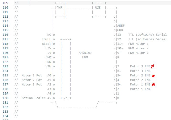

    Hey there, I've been a little out fo the loop for a while, so I'm a little rusty on the setup. Blame is always the goto guy in general but......
    mdds30s runing 2 motors with Blames Arduino code.
    So I did some digging & wrote some stuff that doesn't quite match becasue I think I remapped a pin here and there :D
    From what I can gather you need for
    MOTOR 1 (Left)
    IN1 to Arduino Pin 2
    AN1 to Arduino Pin 9
    Encoder pot to Arduino Pin A0
    Motor 2 (Right)
    IN2 to Arduino Pin 4
    AN2 to Arduino Pin10
    Encoder pot to Arduino Pin A01
    I know Blame had done a variant of his controller Arduino code for me & I know we did some later testing but I can't remember what the outcome was.
    Start with what I've said, see if it works & if it doesn't come back.

    Wiring:
    CYTRON MD30C >> ARDUINO UNO
    --------- DIR -------- >> ------- PIN 2 -------
    -------- PWM ------- >> ------- PIN 9 ------
    -------- GND ------- >> ------- GND -------
    -------- POT 1 ------ >> ------- A0 -------
    With the appropriate pin settings:

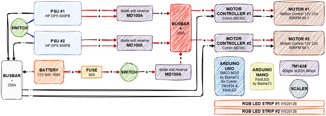

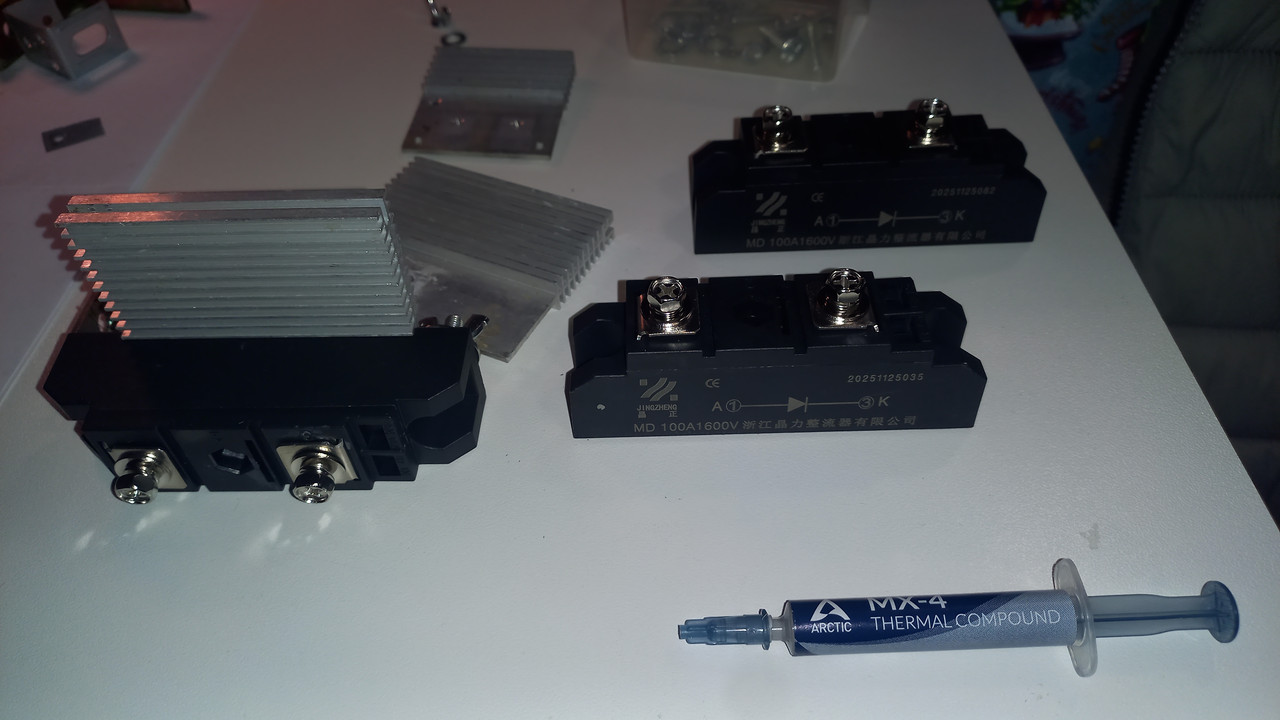

    I was getting some regenerative current flowing back to my PSUs, and the ground was causing interference with the Arduino Nano and the LED strips, so I made a few upgrades: new anti-reverse diodes (3× MD100A mounted inside an ATX case with thermal paste and aluminum heatsinks), new busbars (250A), and a new battery/fuse/kill switch setup.
    I finally had some time to also go through my modded SMC3 code and simplify it. It’s now lighter and handles the scaler, the TM1638, and the LED strips without any issues.
    My first test with “safe” settings (scaler set to minimum). Note: the LED strips show the rig position within the clip zone (and the TM1638 also keeps track of how many times the rig goes past the clip zone, if ever, and which motor it happened on and if it was on the upper or lower side).
    I think this might be the final stage of my rig and my mods. :)
