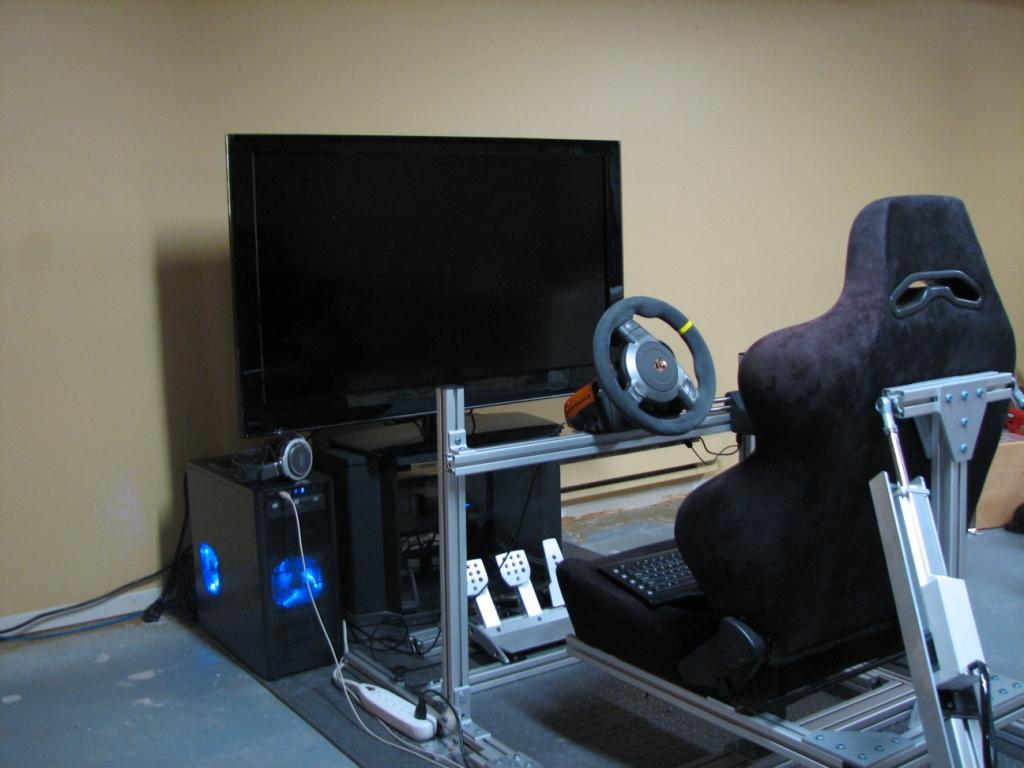

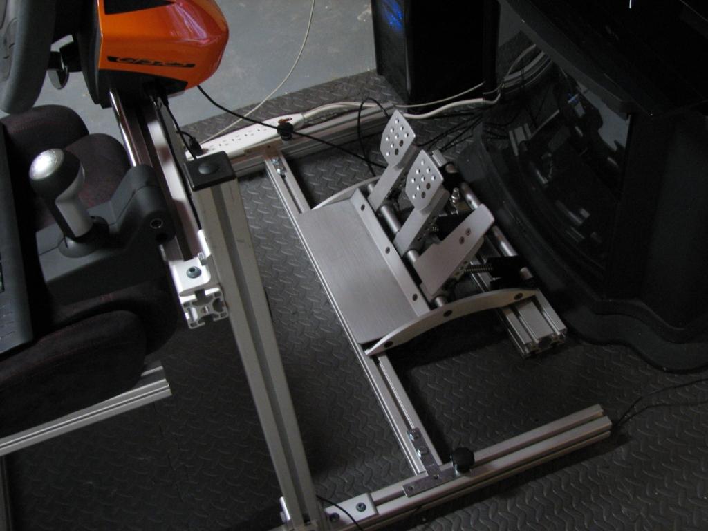

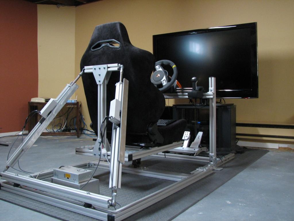

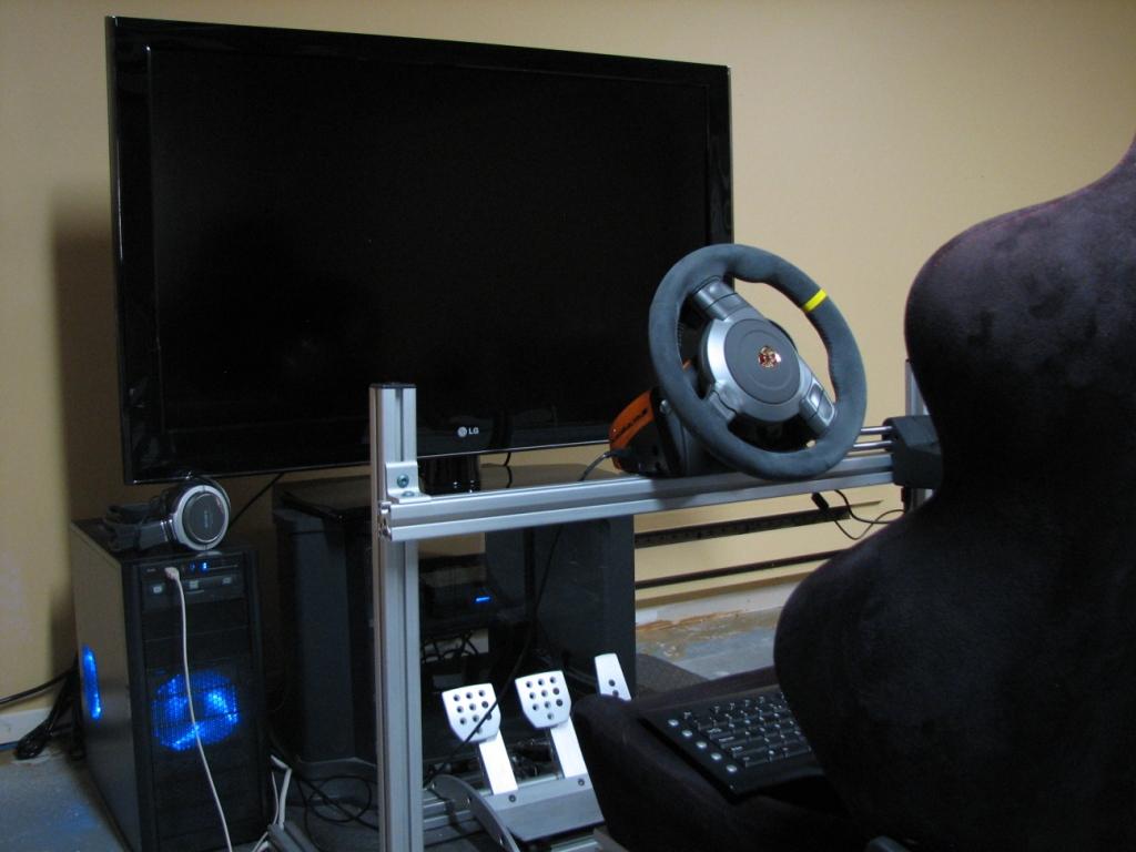

    Very long time since I updated this thread so here are some newer shots of my sim...
    - Replaced the 3x22'' Asus monitors for a single 47'' full HD 120hz LG LCD. (changed my mind about 3x screen setup :yes: )
    - Replaced the G25 for a Fanatec GT3 rs V2 with Clubsport pedals and shifters set
    - Replaced the Playseat for a G-Force racing seat
    - Rebuild front end of the simulator to install the wheel and integrate the pedals to the frame
    That's about it for now ... Feel free to comment

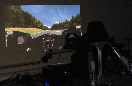

    I finally sold my 47'' lcd and bought the very cheap Vivitek H1080FD full HD projector. I am very impressed with the image quality for a 799$ PJ ...
    This is another big step toward realism ... Real size objects ... Wow!
    Here is a shot just to give you an idea (sorry very poor quality). The image is 76'' diagonal and projected directly on a yellow painted wall. I will receive my 100'' screen this week. I think 85 to 100'' would be just perfect with a higher FOV.
