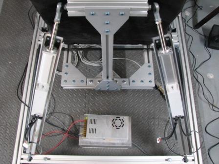

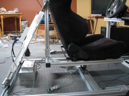

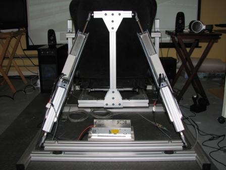

    I have rebuilt my simulator actuator geometry to make it more 'Simxperience style' or at least with the dimensions proposed by Bernard ;-) ... I am very happy with the results.
    Due to my very initial design were the seat position was much higher, actuator angles were way too aggressive after I lowered the seat ... I did not have time and the necessary tools to adjust it right after so I decided to test it like that anyway ... It was not that bad but actuators position was not efficient when creating profiles ... I needed much more aggressive values to create the same feeling over a 'Simxperience style' geometry... I understand now why my profiles effects may have not feel good on other members simulator especially longitural effect ... I will adjust all my profiles and share soon ... I have also solidify the seat's T bar, very quiet now...
    Here are some shots ... Sorry for the mess all around!

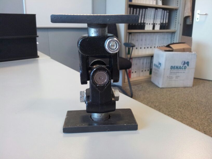

    Very very cool. I Love your Rig. I will also built it with the Aluminium profiles. My Problem is the Mount of the shaft under the seat. How do You die it. Person You have some pics for me ?
  17. Rinus janssens
    Rinus janssens Active Member
    Oct 11, 2012
    159
    environmental construction
    Holland
    2,153Coins
    +87 / 0 / -0
    SCN5
    Just two plates drill a hole in it or two on each side and then bolt it to the alu frame. Just as simple.
