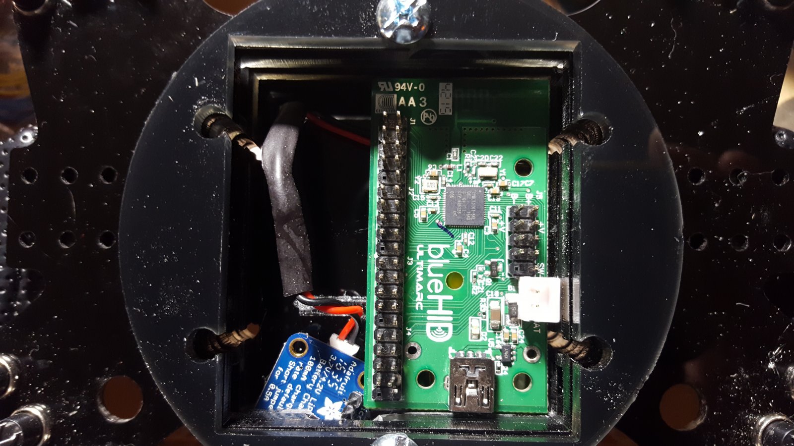

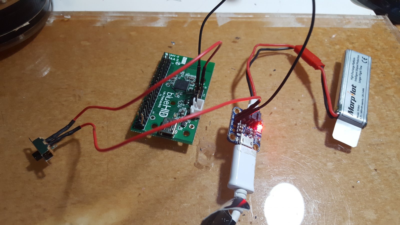

    I'll use it for the LEDs I have to use the switch anyway. Using the board gives me: charge status LEDs, remote usb connectivity, converts the BlueHID board to usb C connector. The LEDs only light when USB is plugged in.

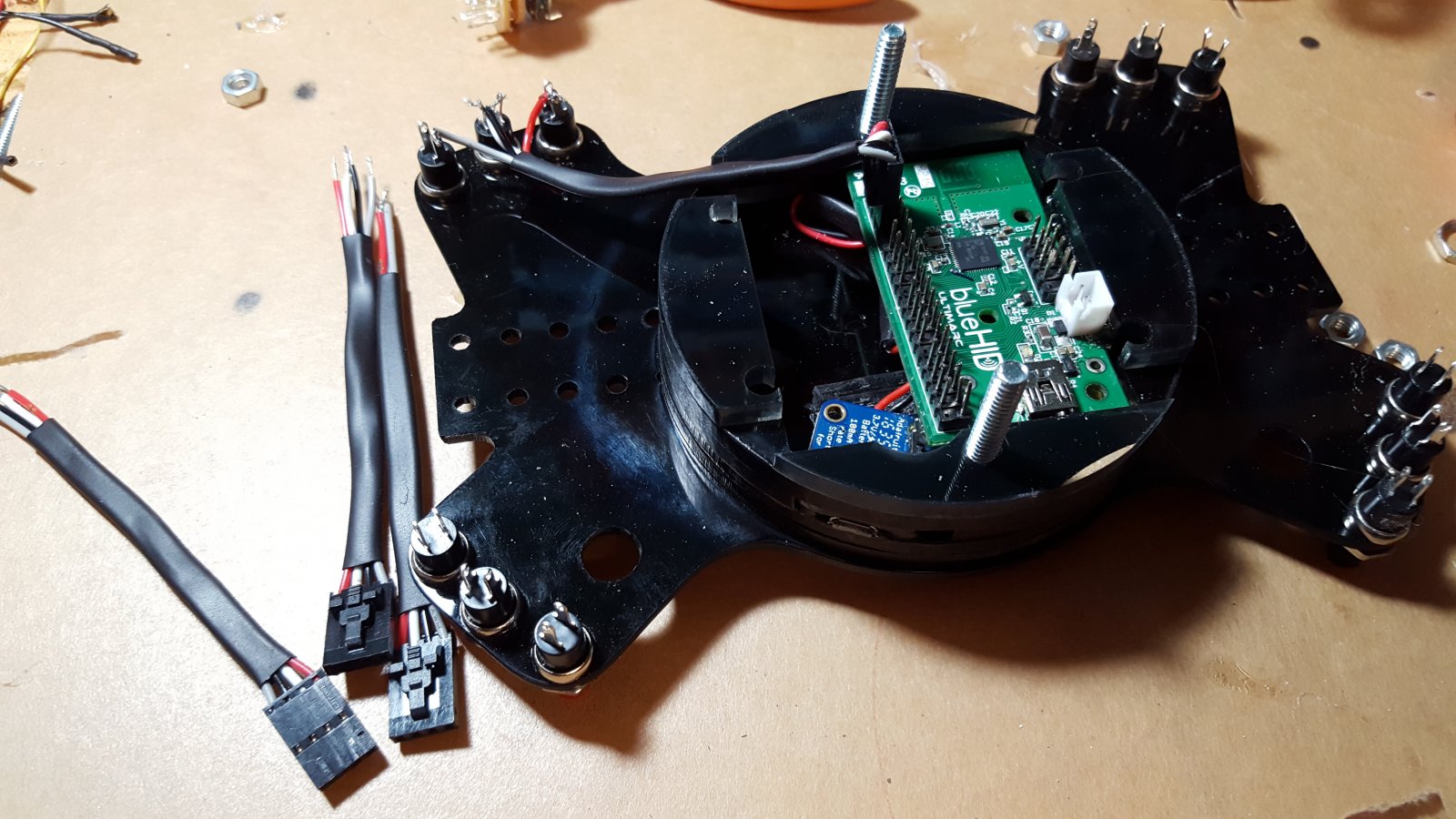

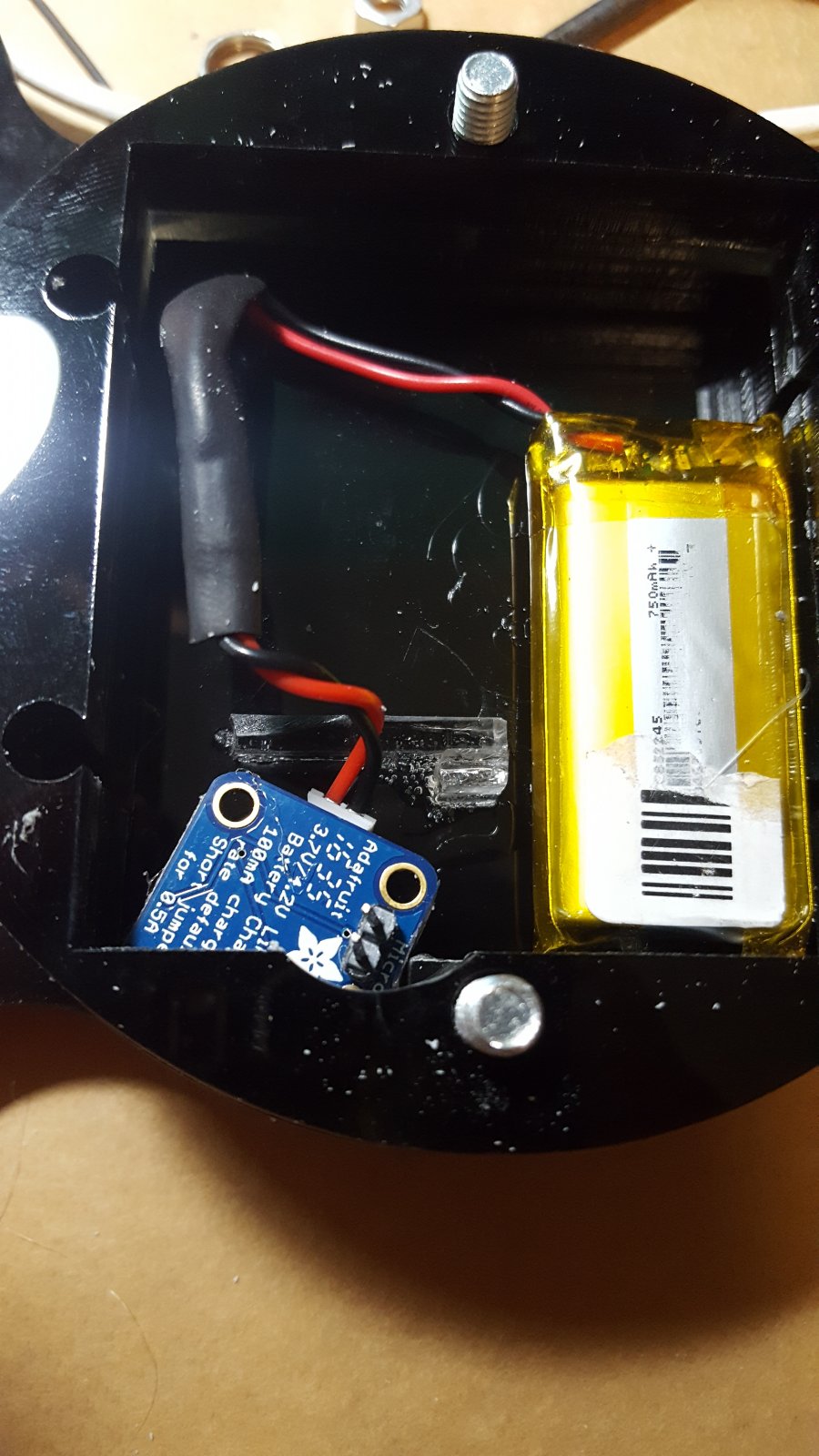

    i tore down my wheel to make an upgrade to the button. when i did the sticker came off the 1000mah battery I got with my bluehid only to find it is a 750mah with a 1000mah sticker on it. hmmmmm..........

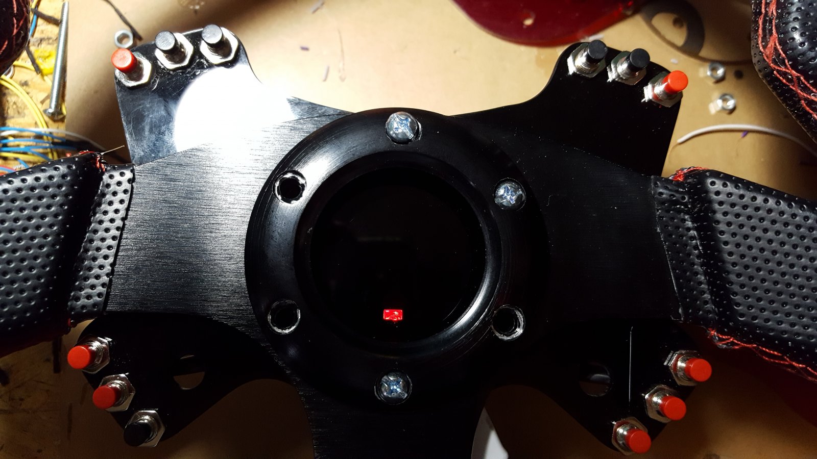

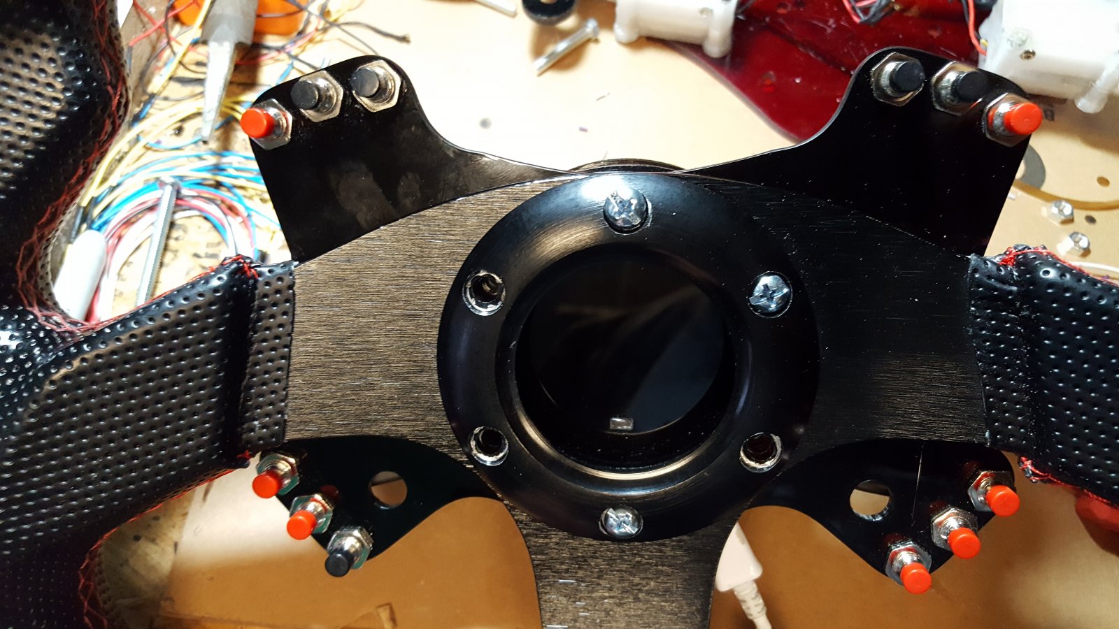

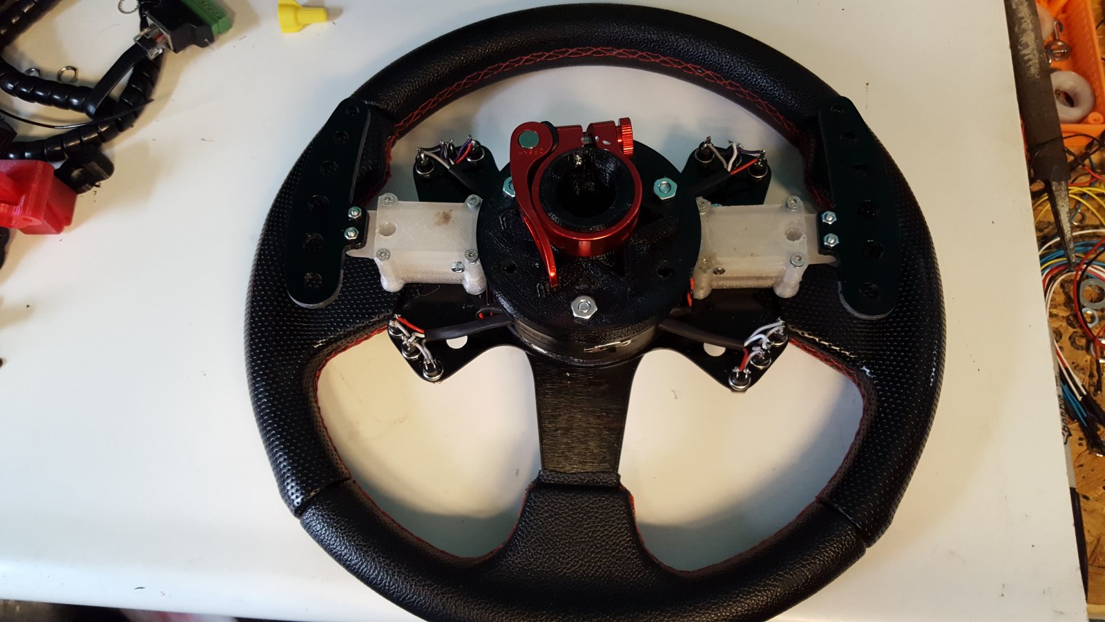

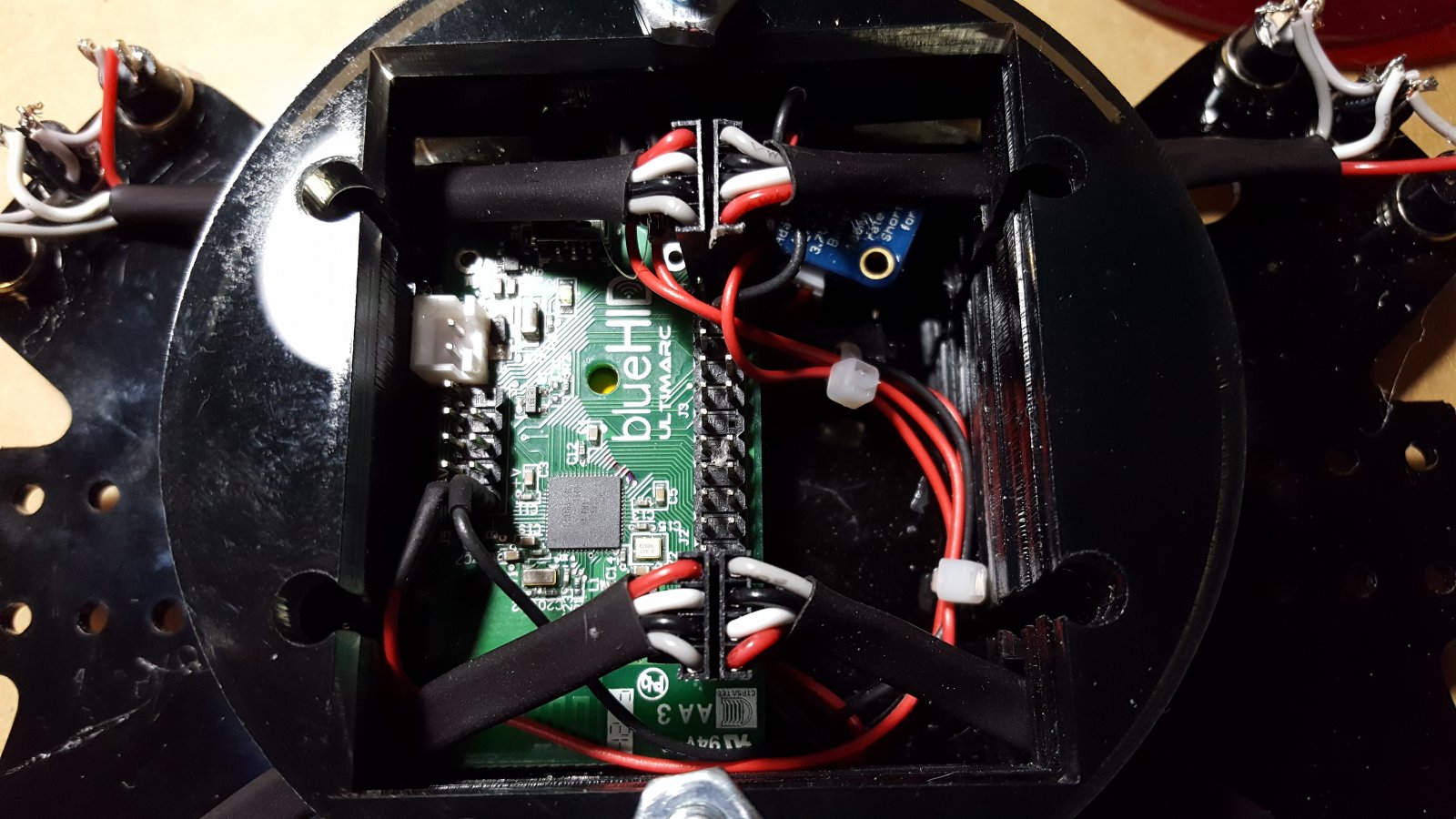

    Anyway on to the pics of the WIP bluetooth plate/wheel.
    20170123_015016.jpg 20170123_022240.jpg 20170123_104646.jpg 20170123_120947.jpg 20170123_121825.jpg 20170123_121952.jpg
    charge indicator;)
    still waiting on switches for new paddles and encoder.

    Diggin the Clear plexi LED status light.

    great work bruce......it's possible to have a little scheme\explanation how to connect the button ,because i did not understand anything : ths(
  9. SilentChill
    2,653
    20,661Coins
    +3,593 / 34 / -0
    Plugin the jumper wires set it in the utility and that's it
