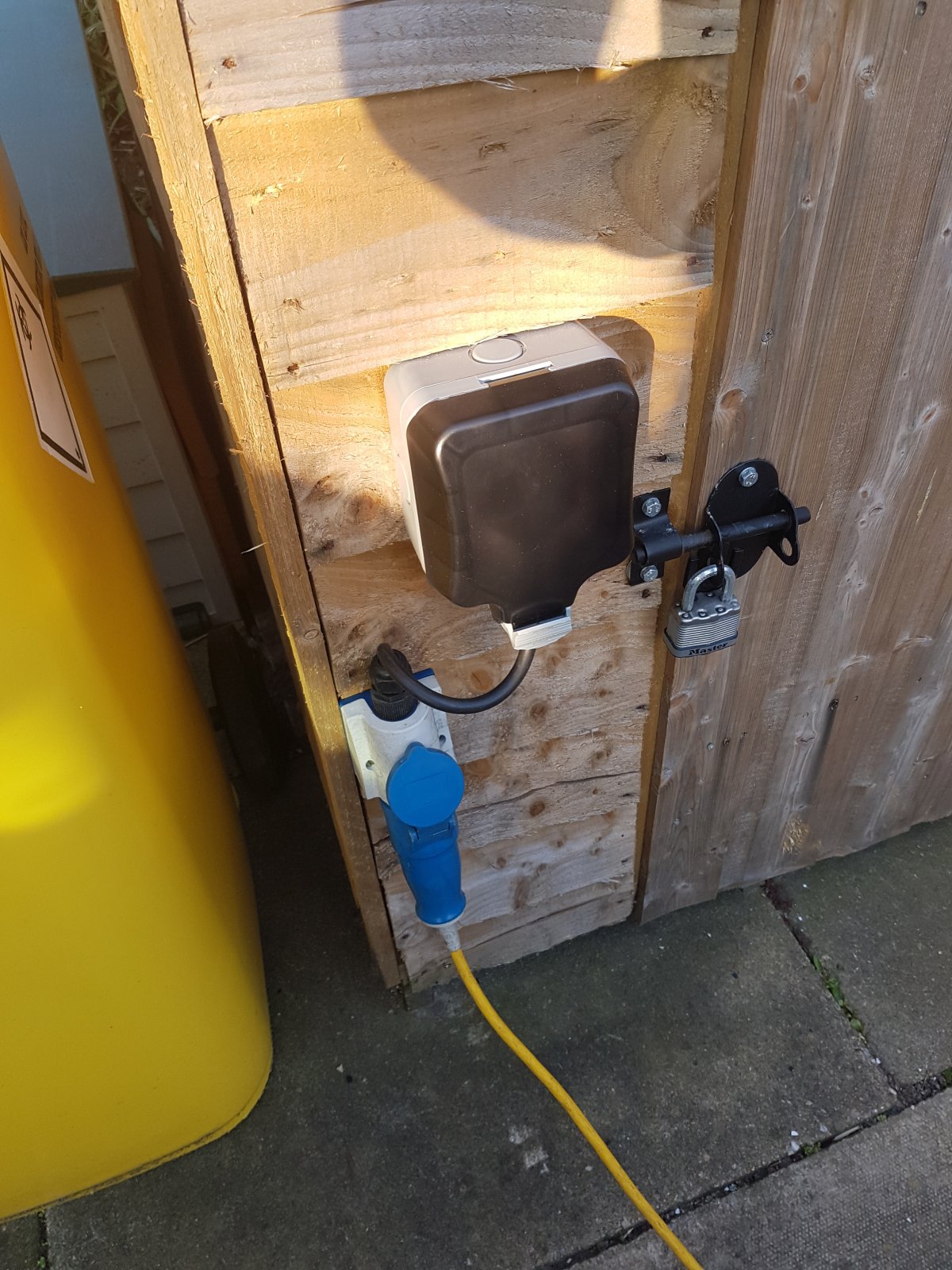

    hey yall..... i got updates....... (man there flying out now) #manonamission
    i got the small death hazard sorted with a caravan plug i "borrowed from the old tree house that no longer used, well mum likes to sit up there and read books so hopefully, she won't notice till i can get her a new one installed,

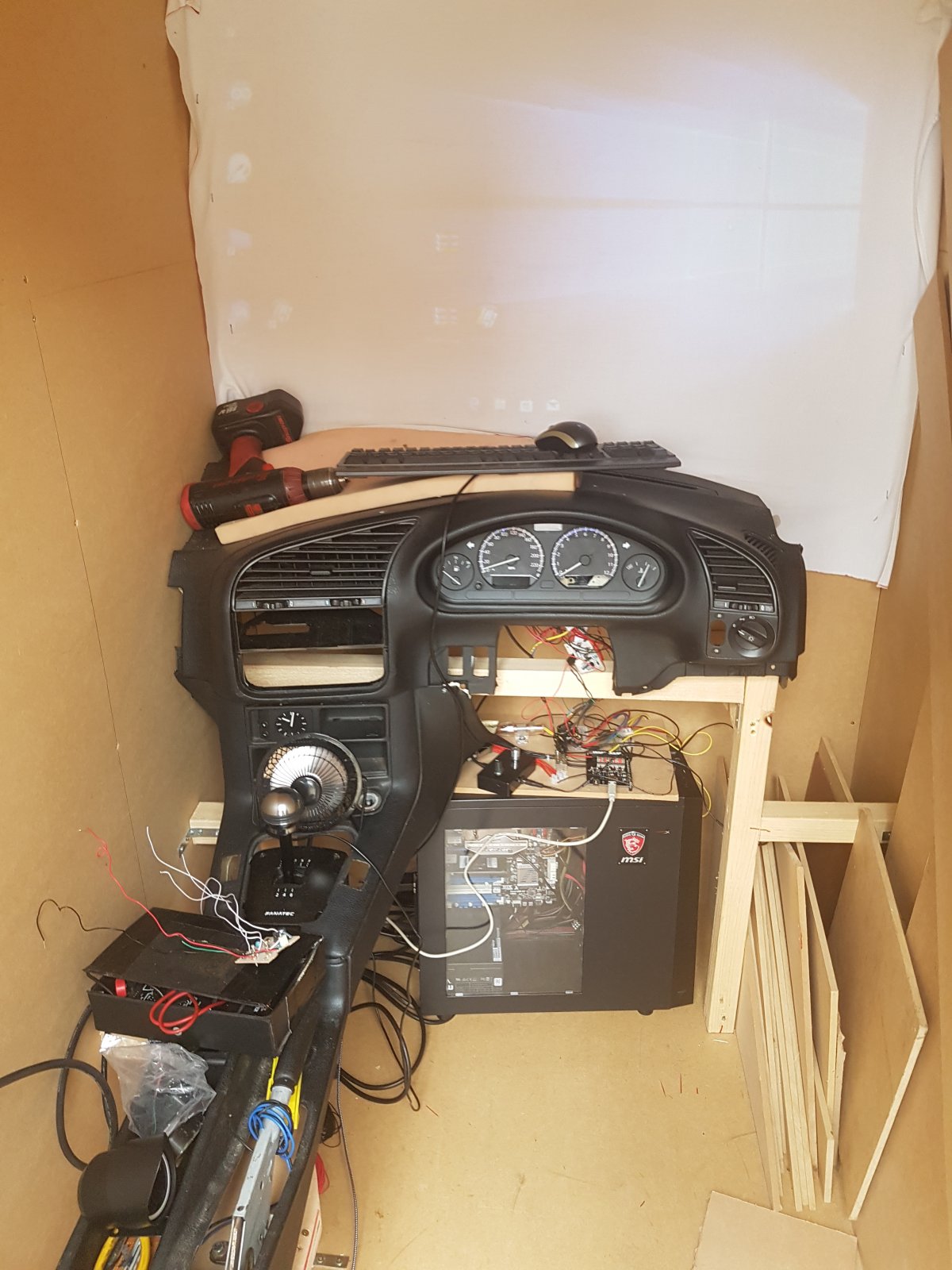

    I'm a bit worried about the 2 DOF motion side of things with the handbrake where it is and am asking if it is worth removing the stock handbrake or move it over with a custom center console, ( im very good a fiberglass work so i could make one)

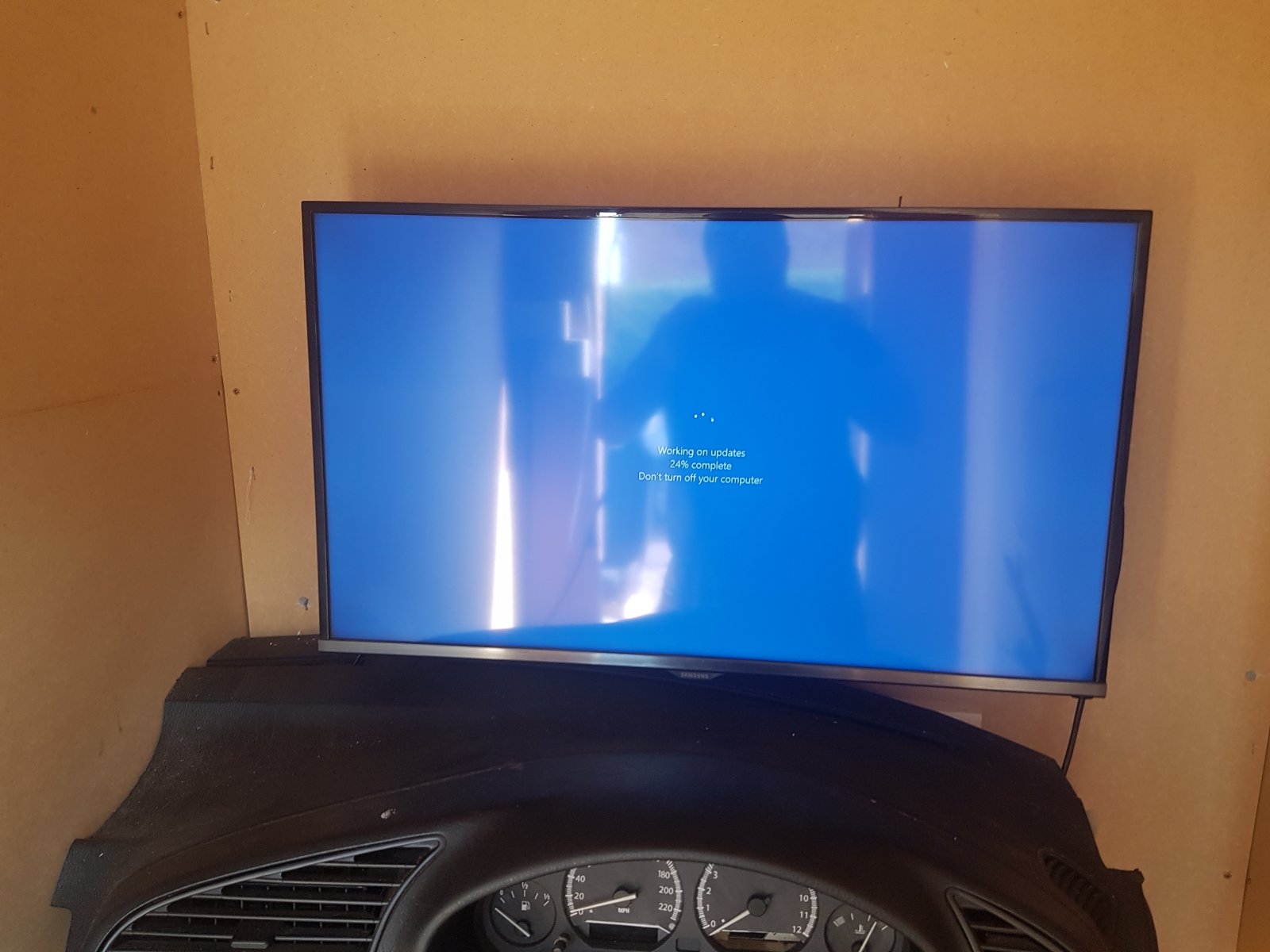

    anyway, i got this 32" tv lying around so i thought id wall mount it for the time being so i can see it, i will be getting a better projector or 2 more 32" screens I'm not sure, and all i can say is damn windows 10 updates......

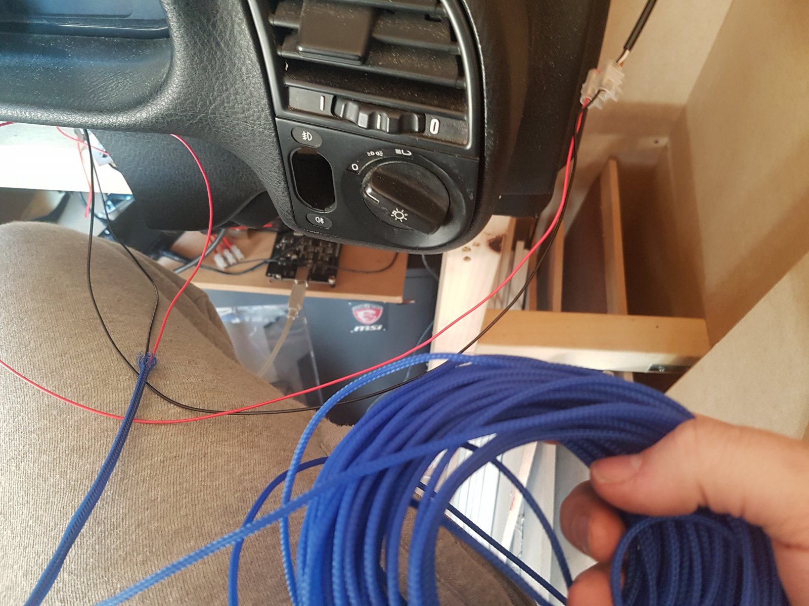

    here is me doing some cable sleeving..... man it took a long time, but it looks nice, its the power for the turbo gauge

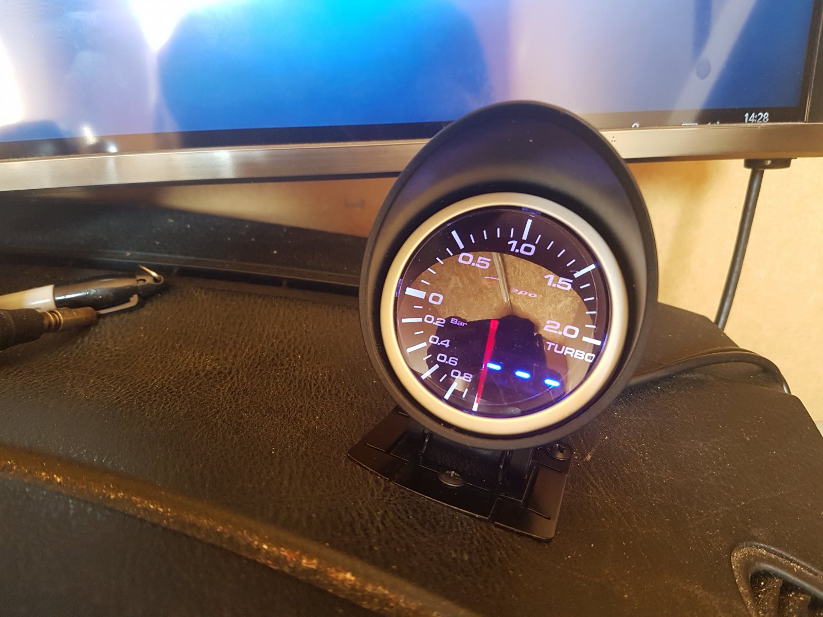

    and here is the turbo gauge powered on but having got a signal did not get that far started getting hot so il be working in about 20 mins from me typing this message so expect some more photos and question later on today

    the turbo gauge calibrated, "edit ish"
    you may notice I had to change the gauge face this is temporary till I get one designed and ordered from black cat customs automotive,

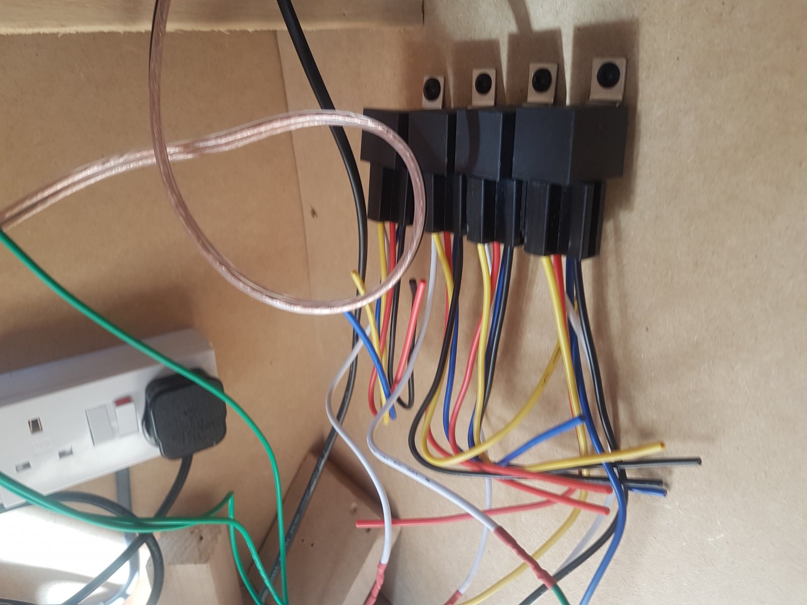

    here is a RATs nest for anyone who wants a trigger :p
    its triggering me and will be sorted soon i promise

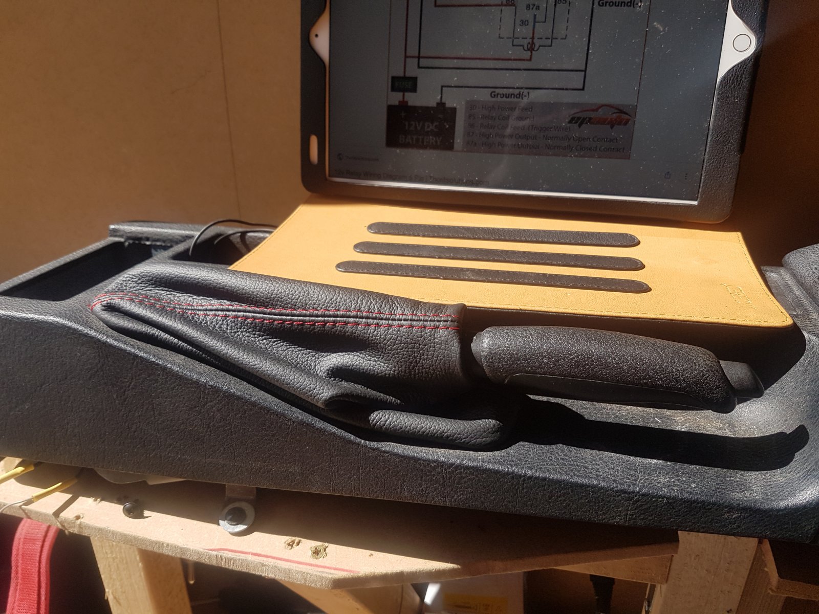

    hey guys, some updates from yesterday didn't have time to get them online last night,

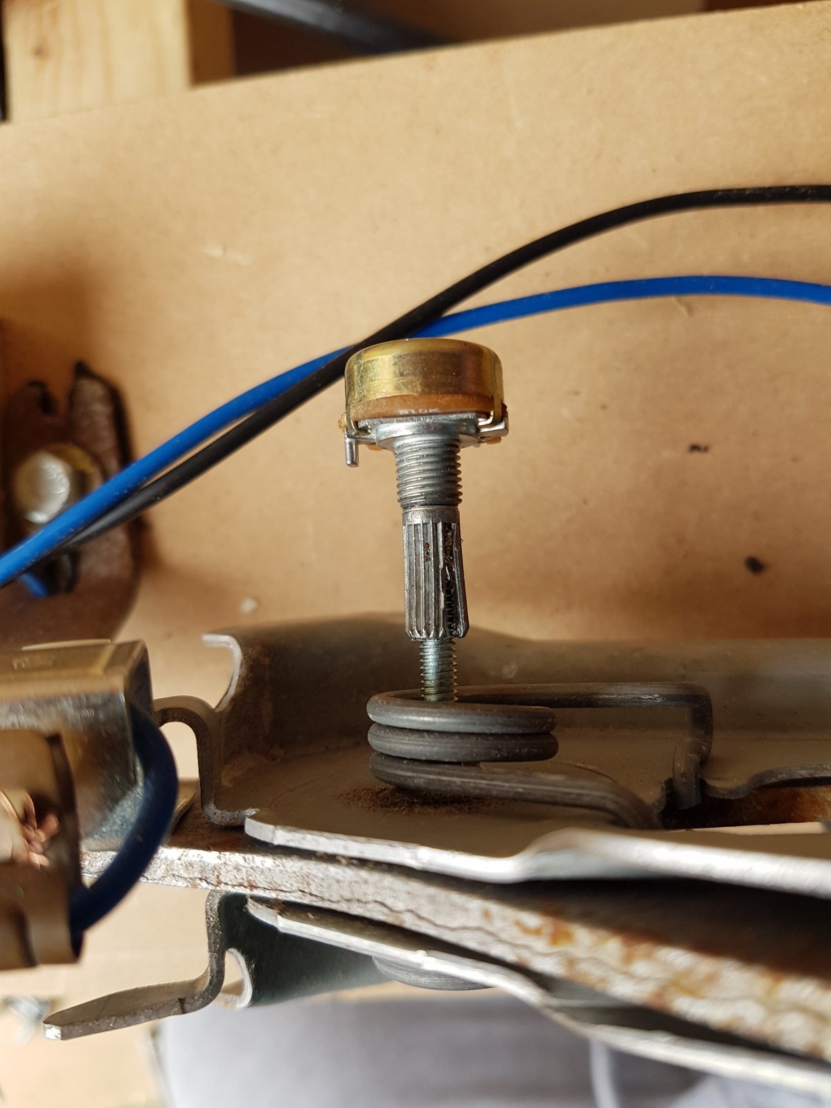

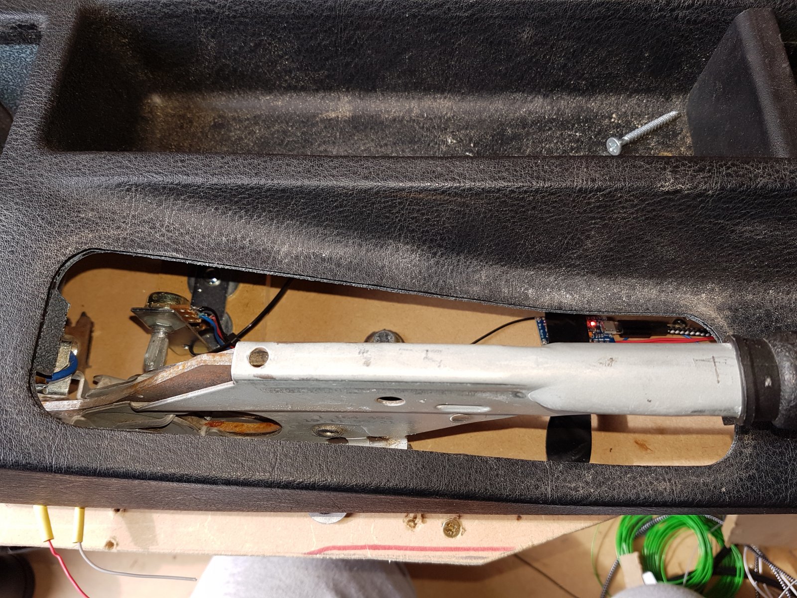

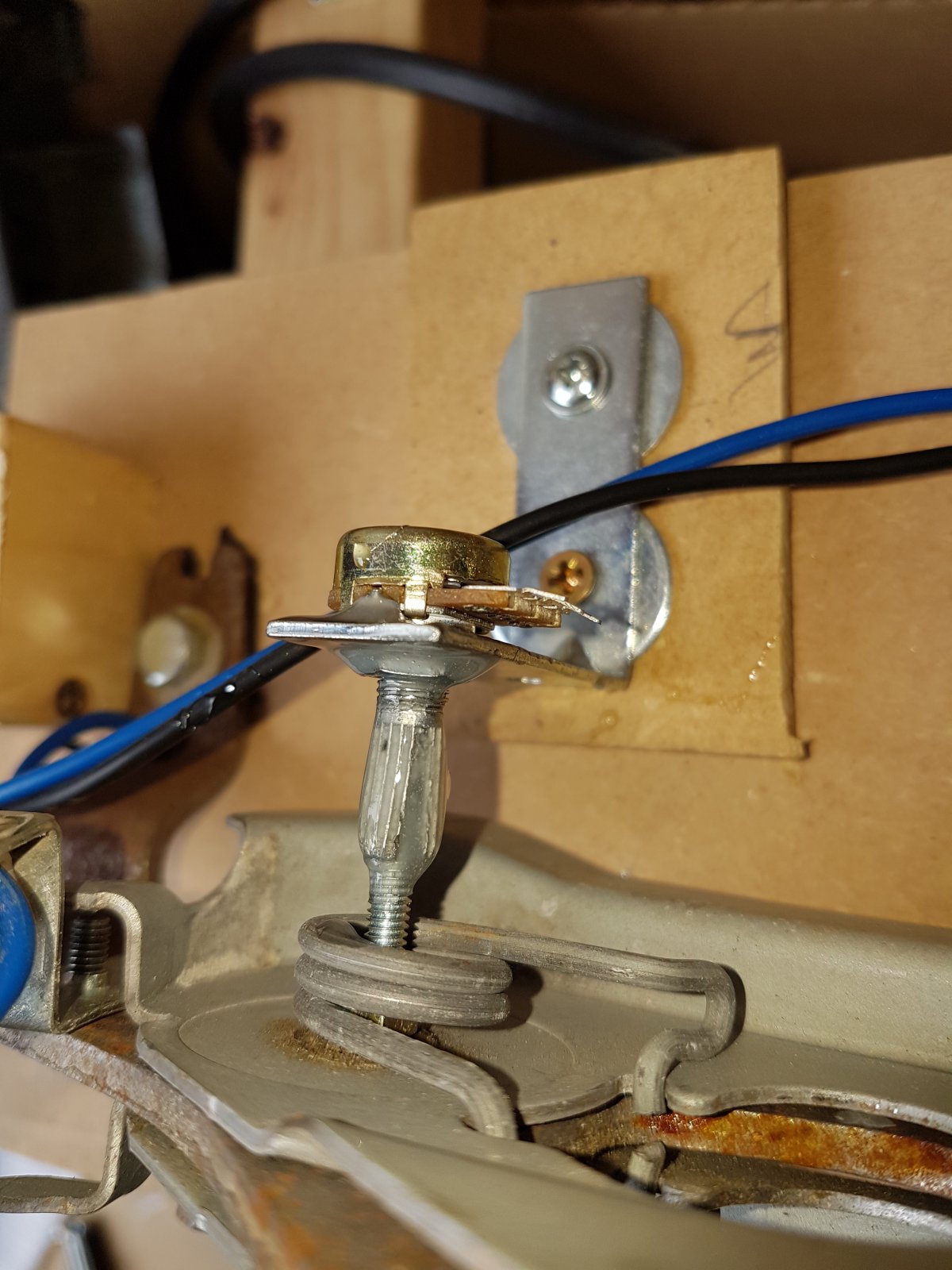

    so I've been thinking about the handbrake and not been able to put the center console on the right way so I decided to address this issue,
    below was the old method that you can see i did further up,

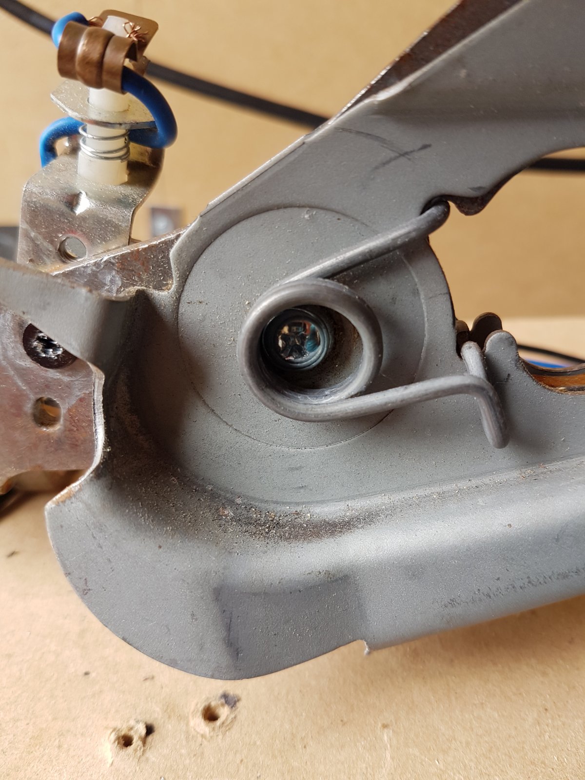

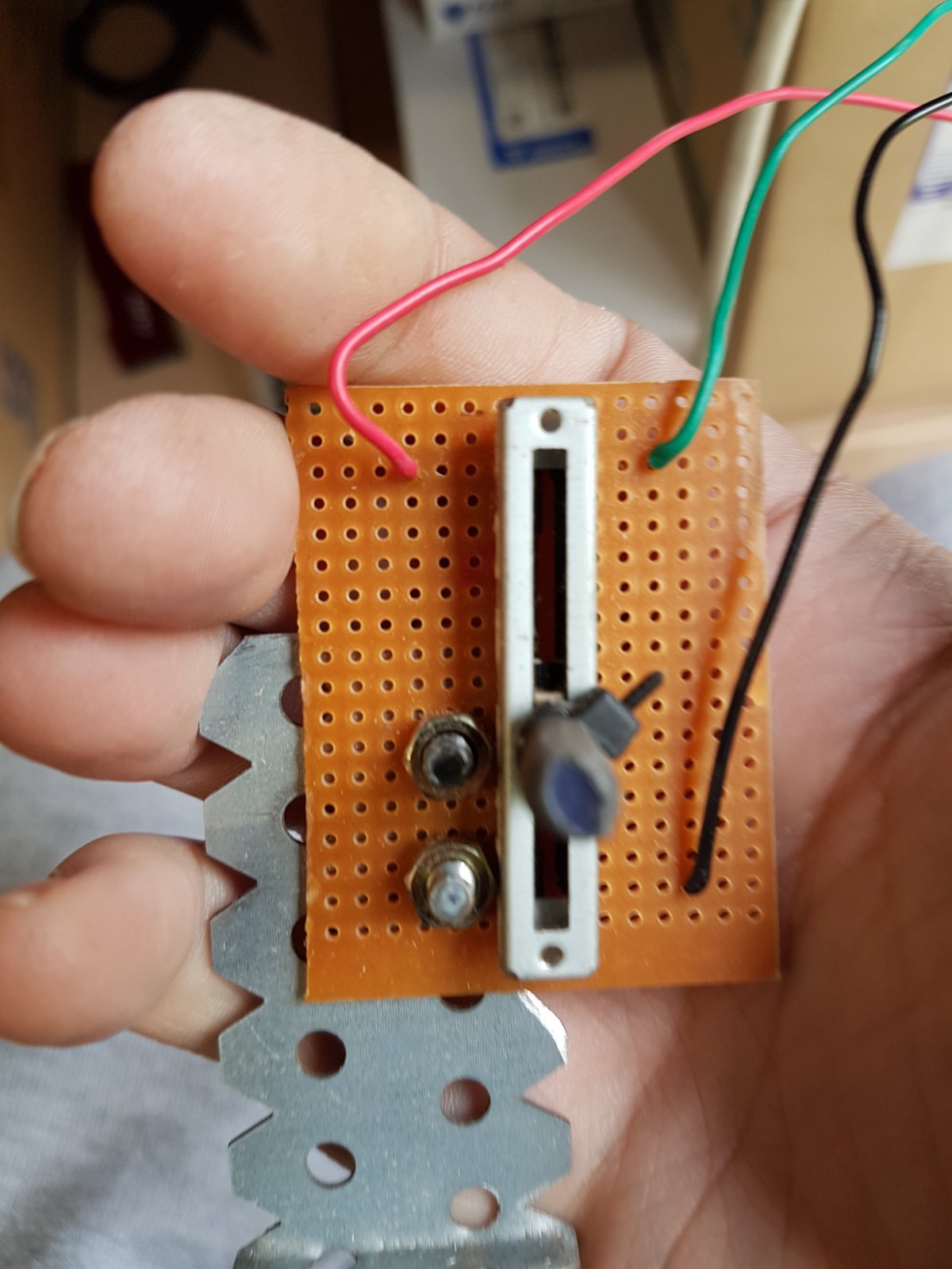

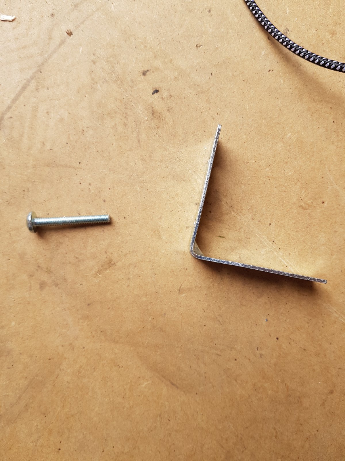

    so I decided to use a turn style pot and making use of the pivot point of the handbrake
    you can see I have put a bolt through it like this one
    and the idea was this

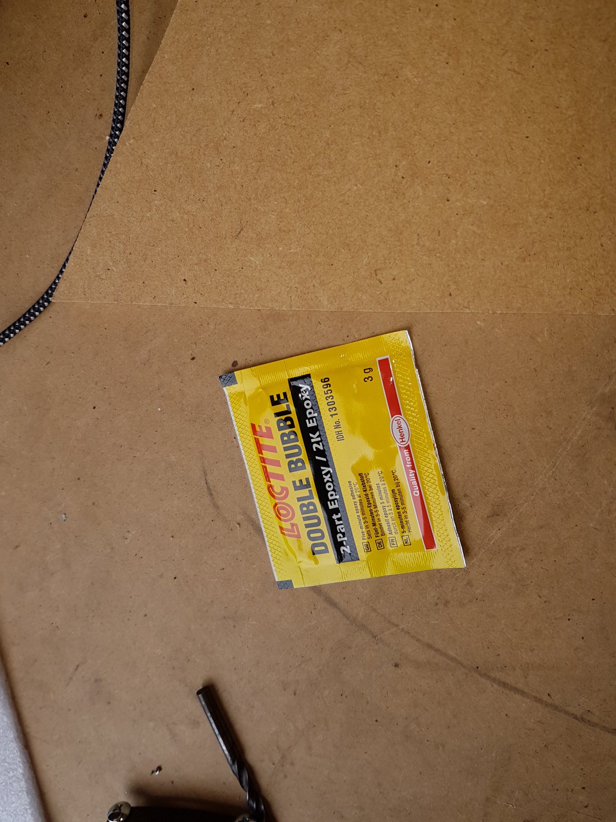

    I drilled a hole and threaded the pot on the bolt worked very well which I didn't think would work..... have faith they say :)
    so I use the l bracket above to mount the pot, had to fill out the already made hole
    so I get some epoxy
    and this is how it turned out, really happy with it

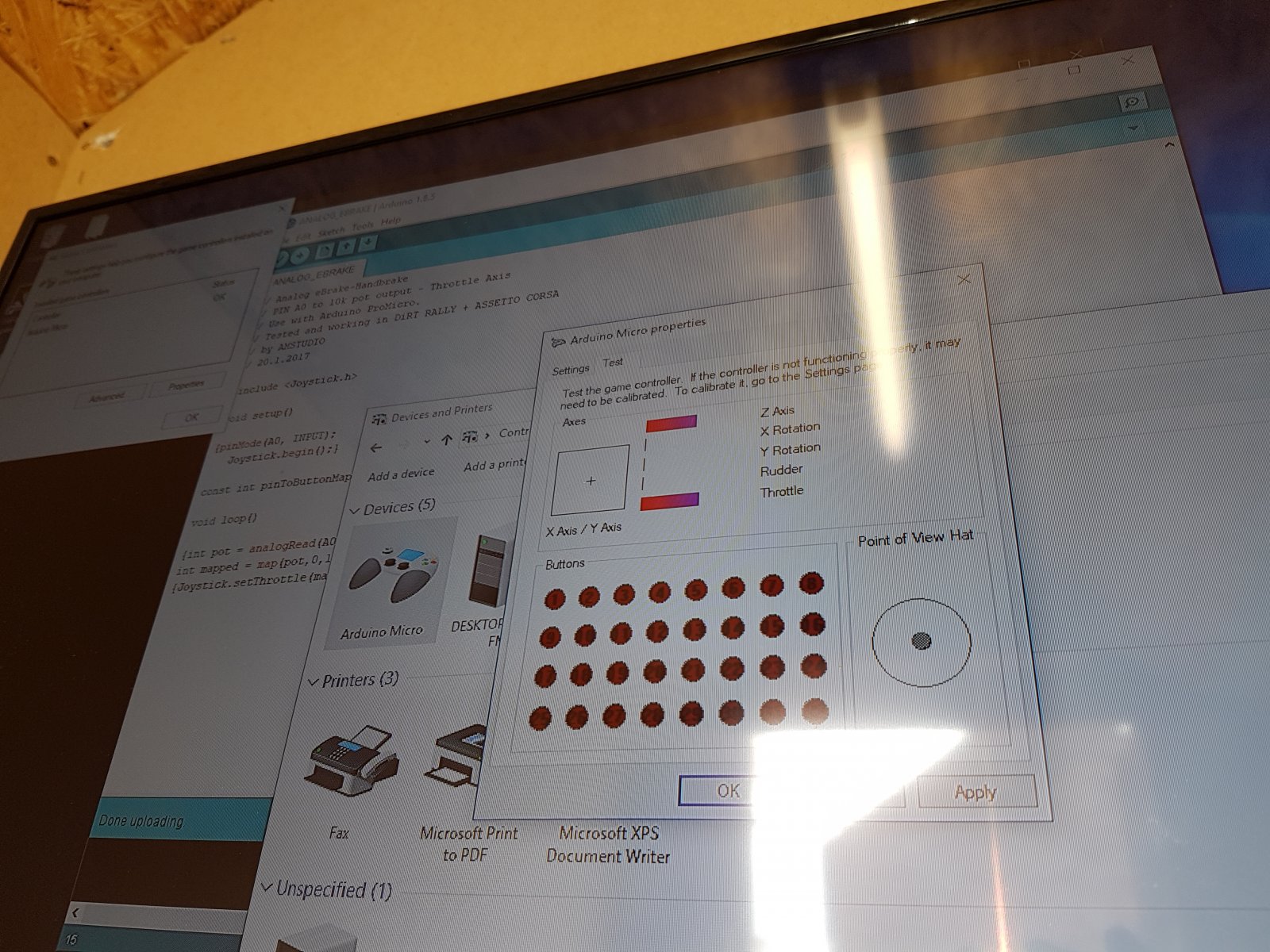

    here is a screenshot of it in the windows game controller settings
    I have used a code from AMstudio for now but I think I've got my own code that as analog and digital inputs with a switch to turn between them
    here it is with center console in place

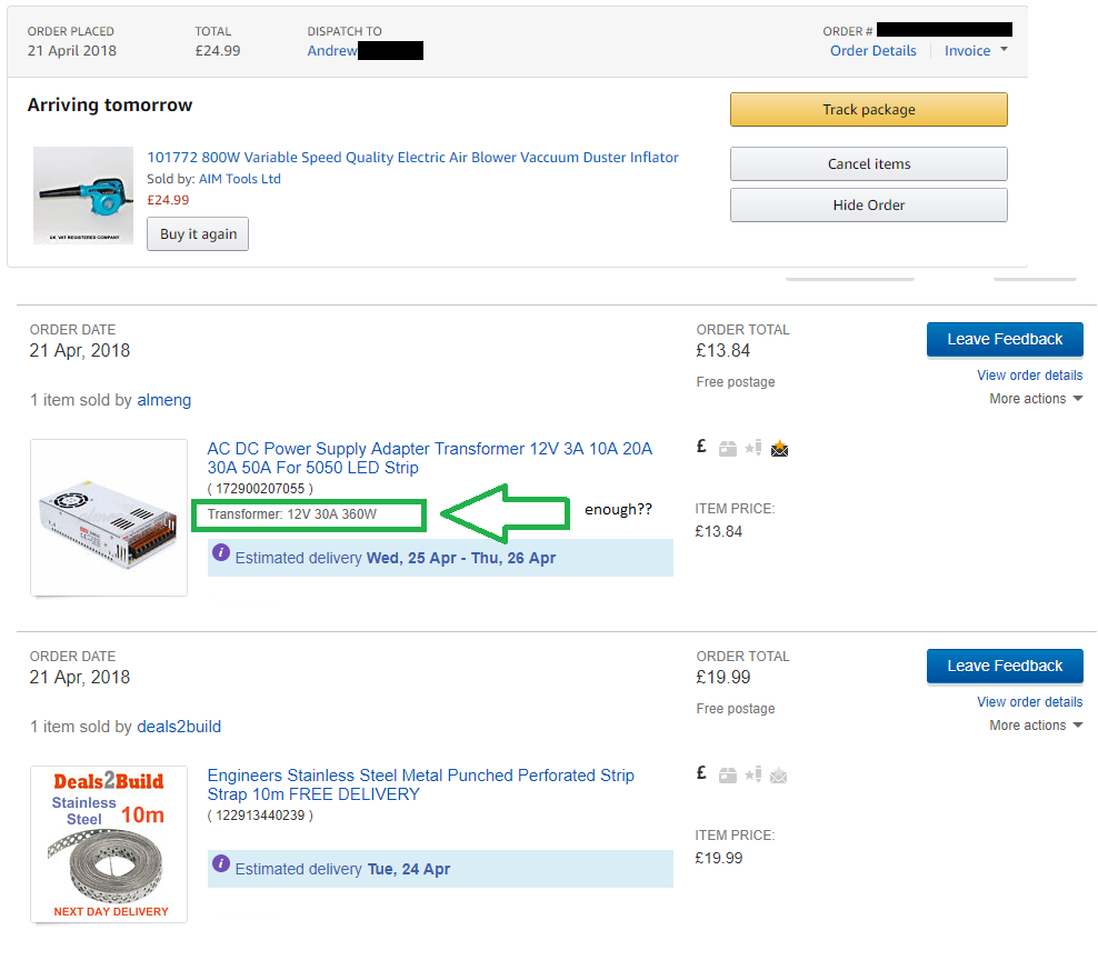

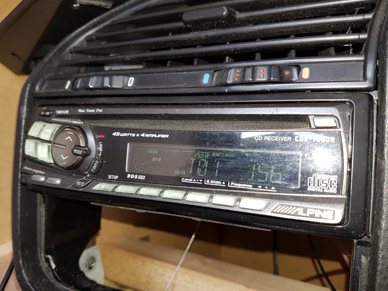

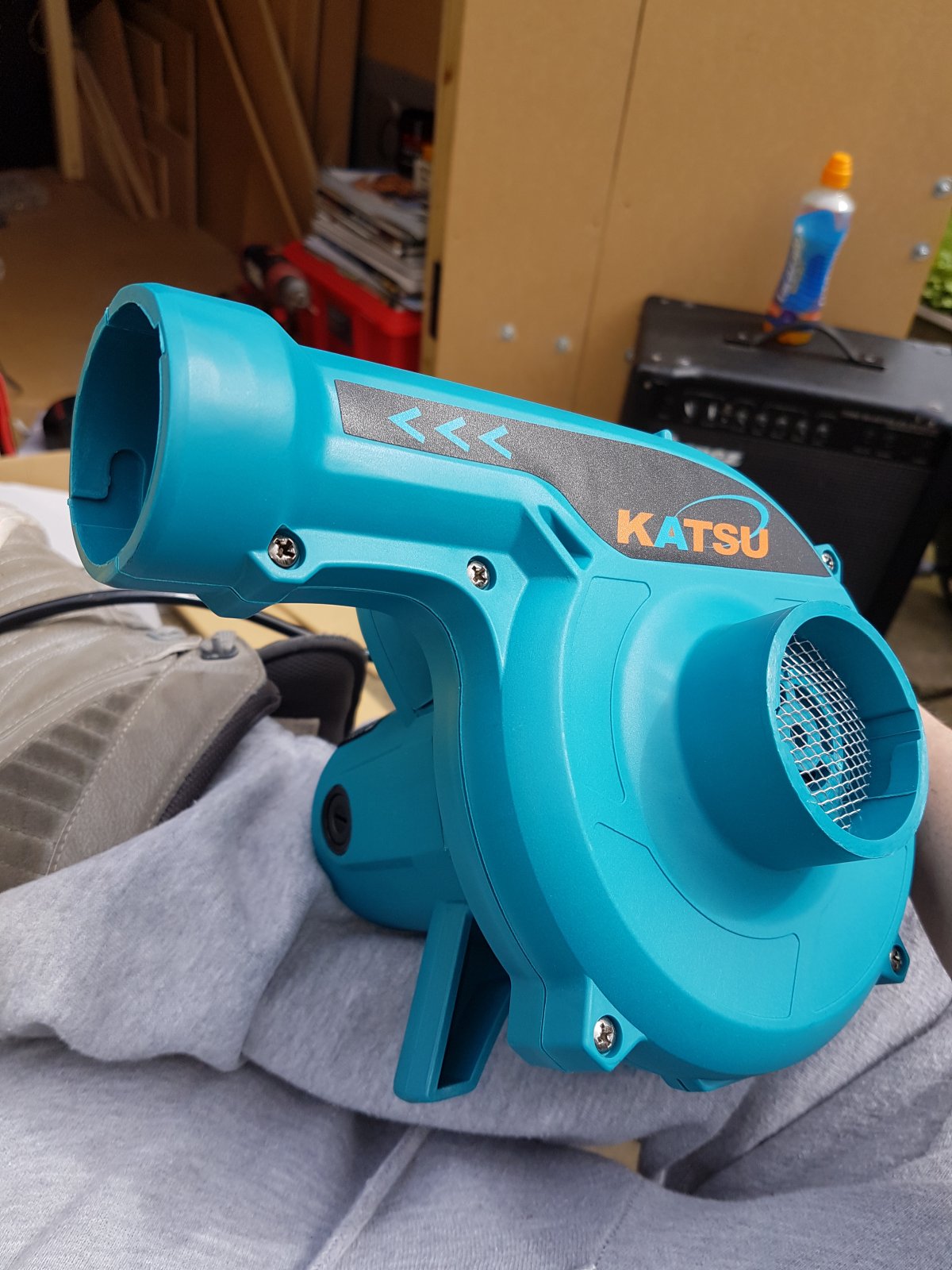

    then I wanted air con (OK blowers but air con sounds better :p)
    so I got this, now before you say anything yes I really did try this... didn't work......... was F**kin LOUD AS F.......
    800 watts of pure silly
    so im going to have to go to the scrap yard again...... yay i love the big boy playground
    and get the heater blower from the E36 so i can get it working properly
    the leaf blower was a great idea but it was tooo loud even as a low speed
    and i leave you with this last picture...... " a bangin stereo for me tunes" James may top gear)

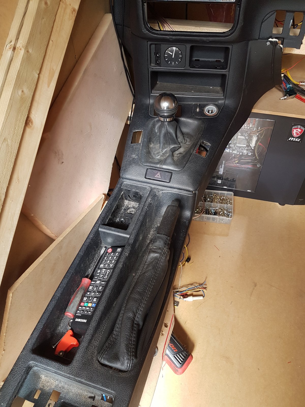

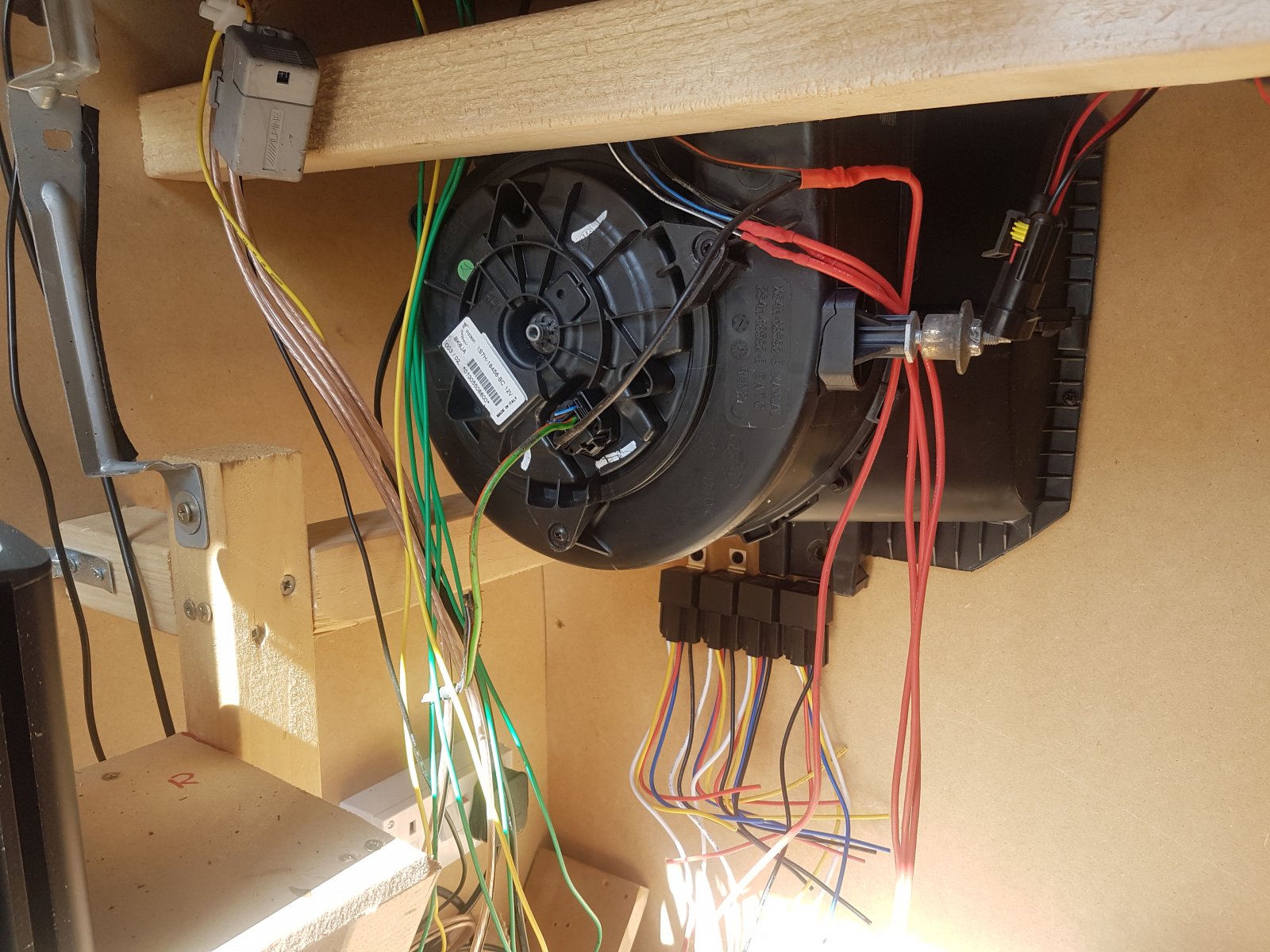

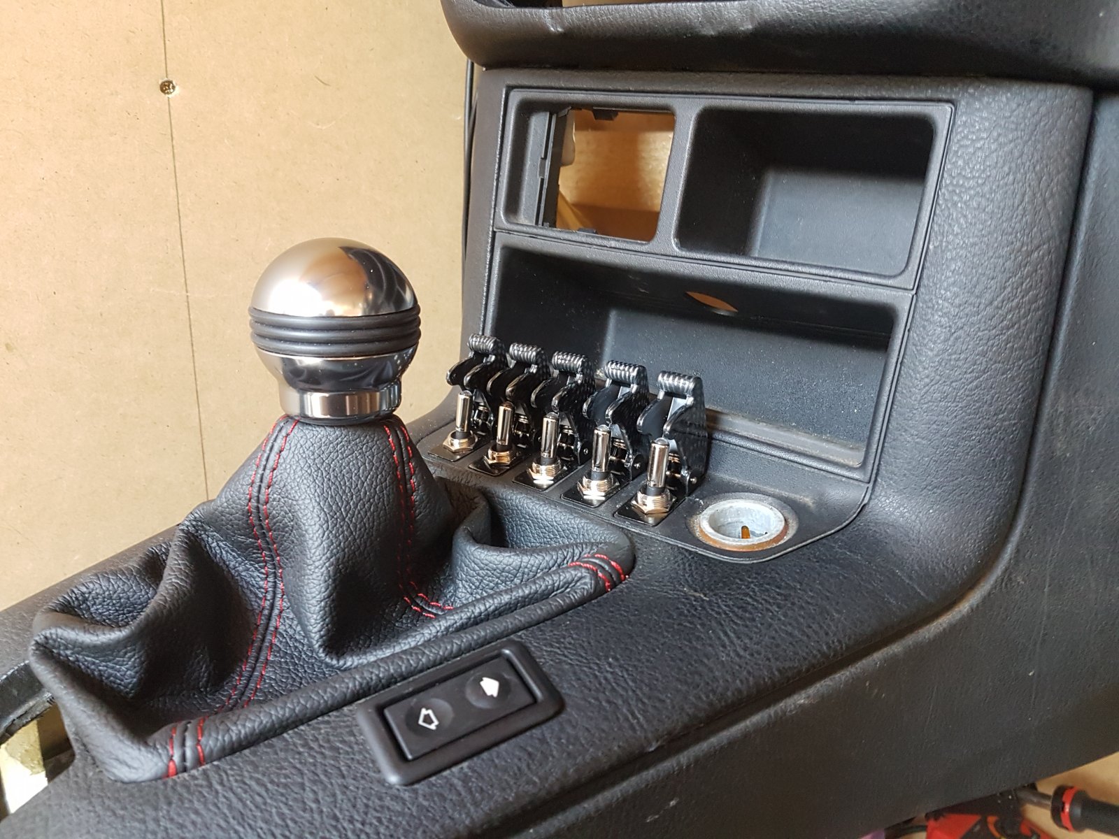

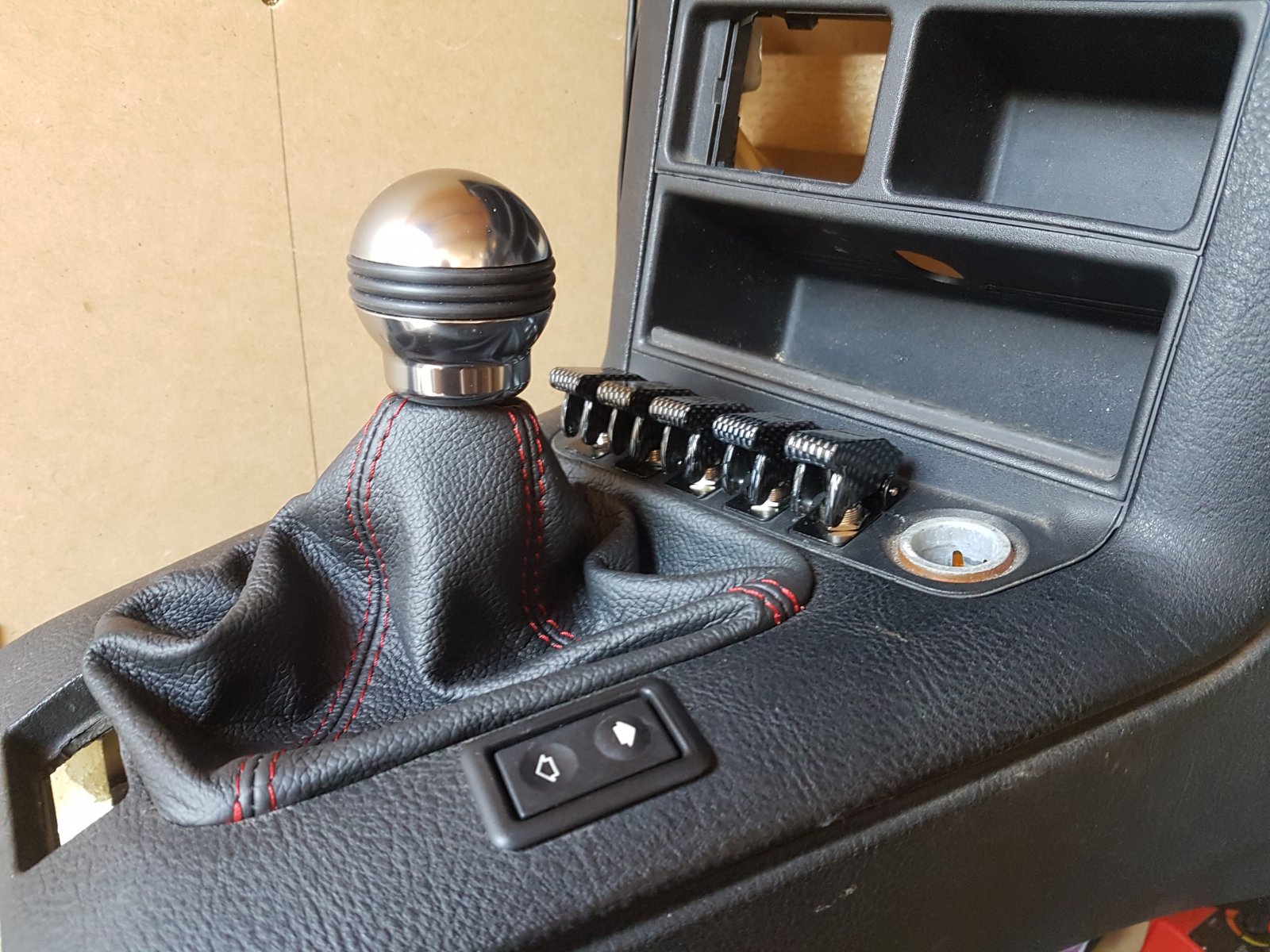

    First off I went to the scrap hard in to a blower motor and gear boot and handbrake boot
    They don’t look as good as I thought they would so I’ll come back to that in a bit

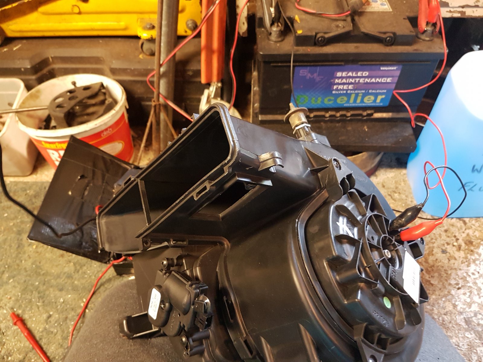

    I got the blower motor from a Ford Focus

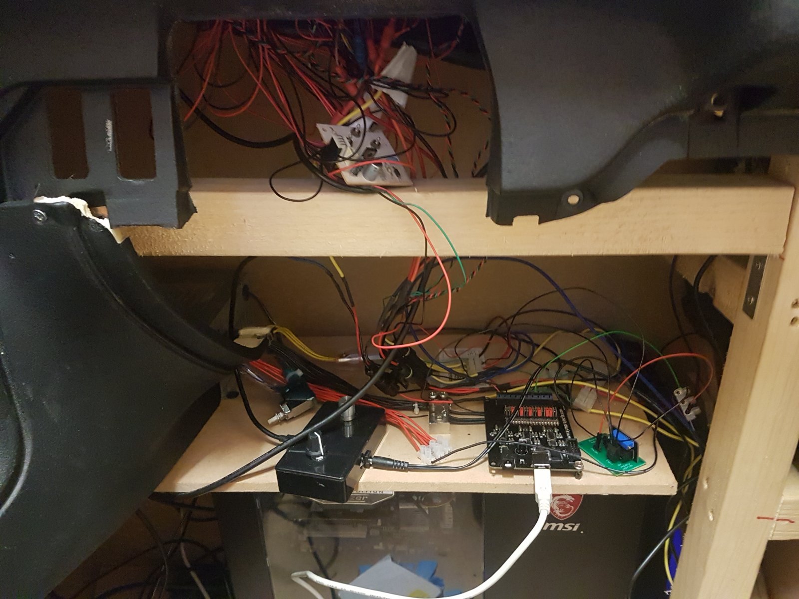

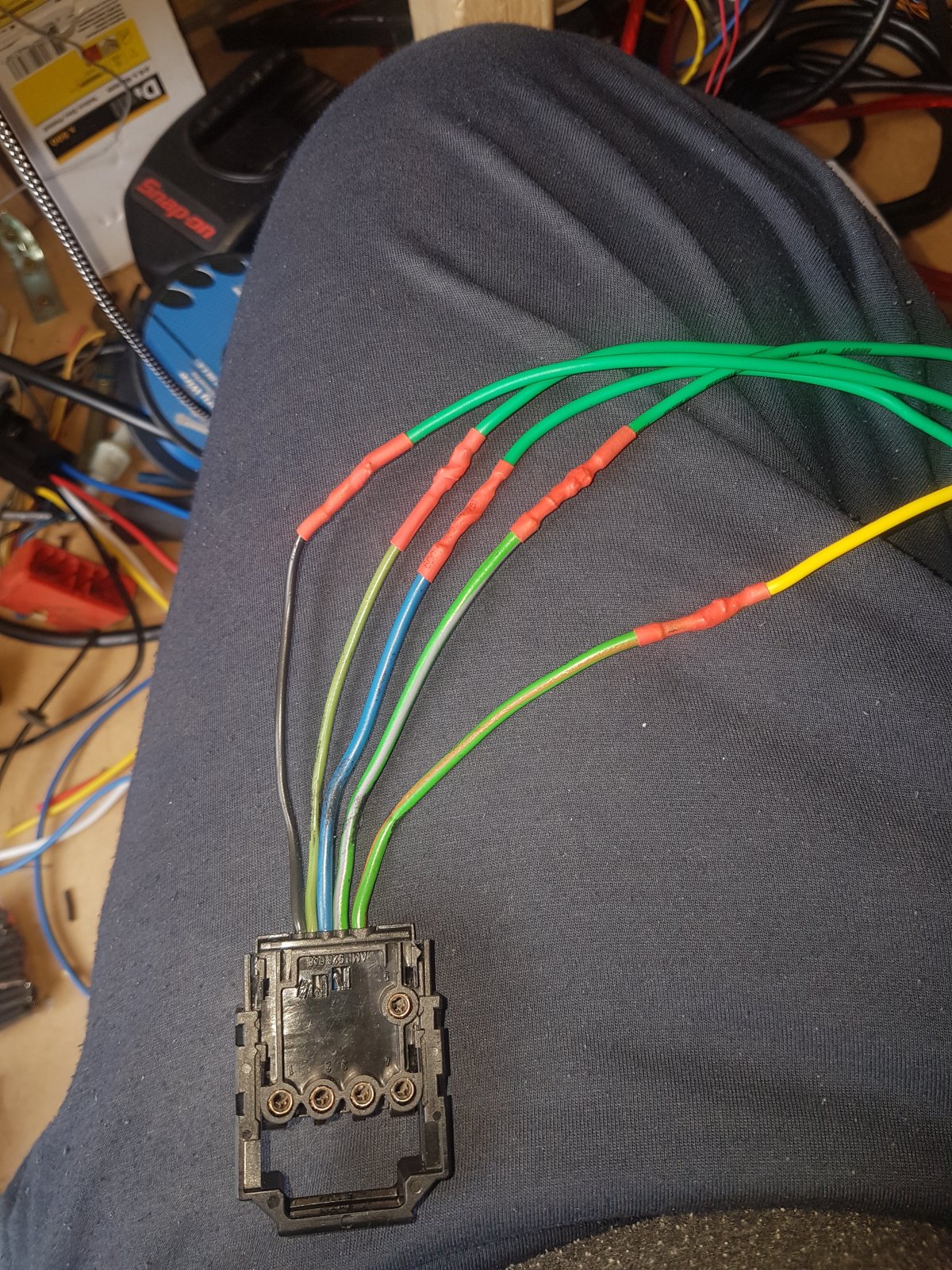

    The plan was to get the speed control working but
    1 fire risk
    2 I couldn’t figure out the wiring even with been a mechanic for 8 years I look on auto data but for what ever reason it wasn’t working
    So here below are some pics of me trying to get the speed controls working
    So conculsion is I didn’t bother having a speed controller,
    And as for the hand brake and gear boot I had to go on eBay and buy these pretty !!!
    Now after this I had brake for a couple weeks,
    But I soon got back at it

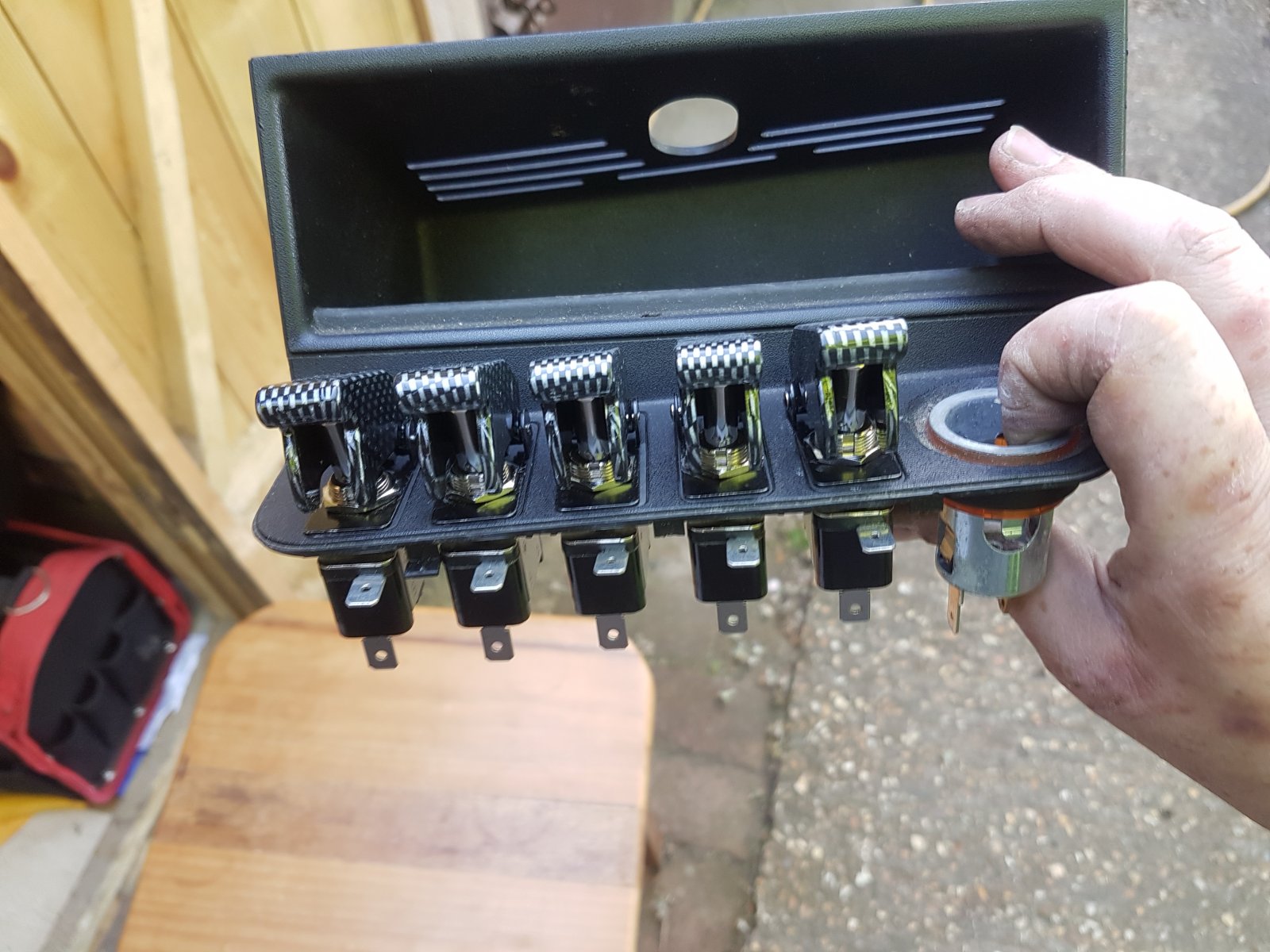

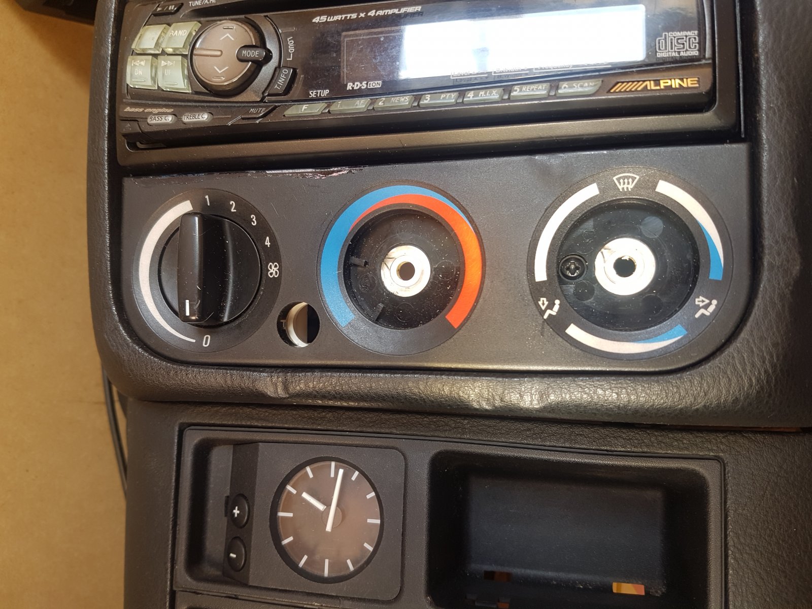

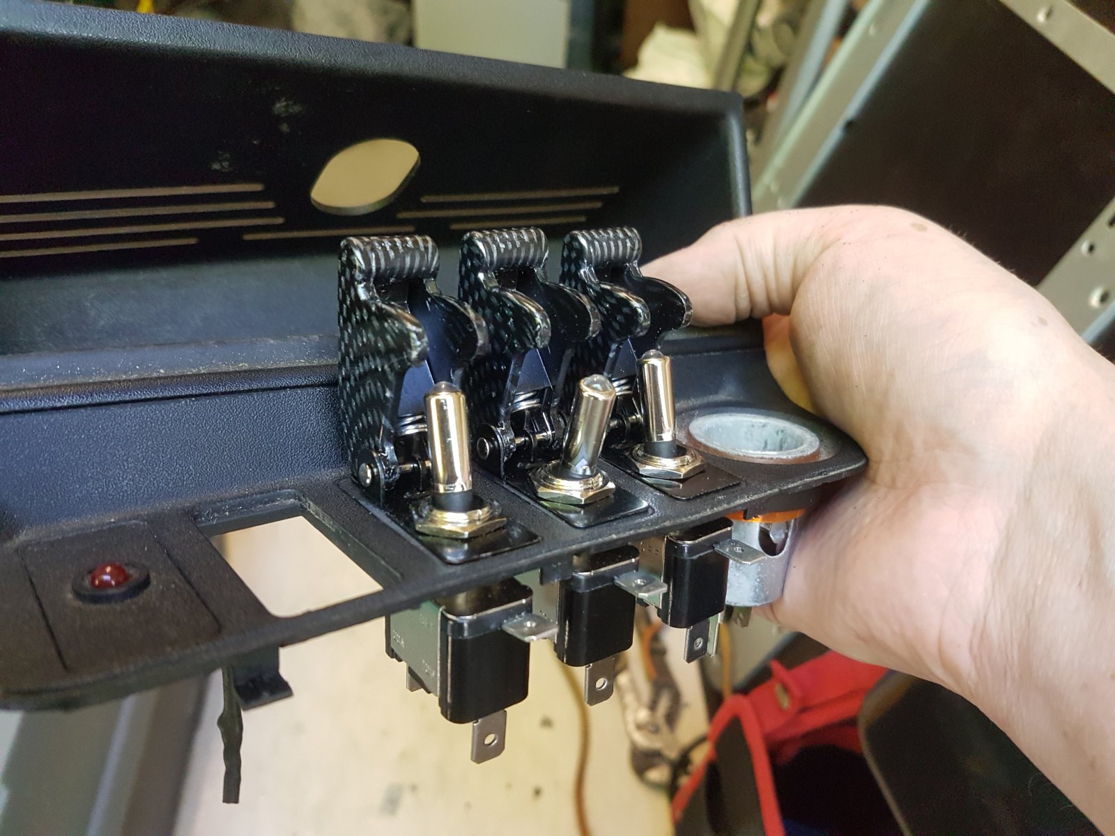

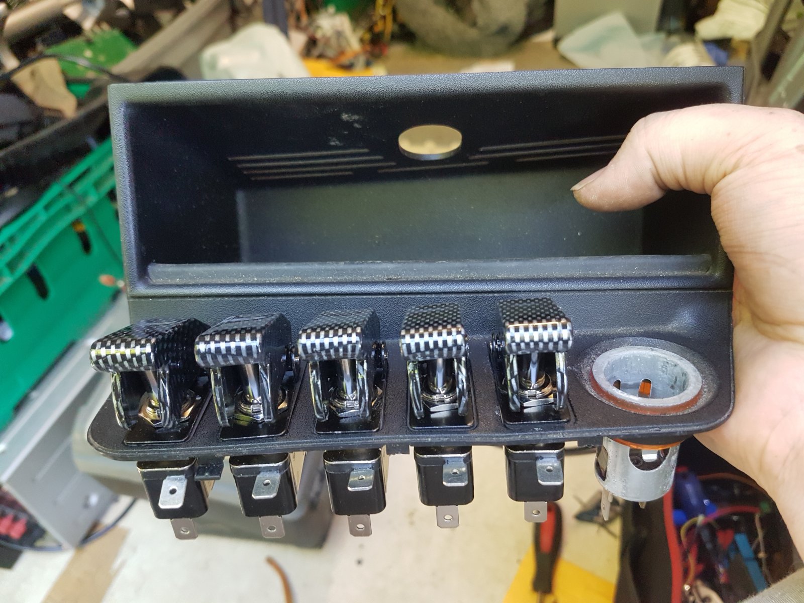

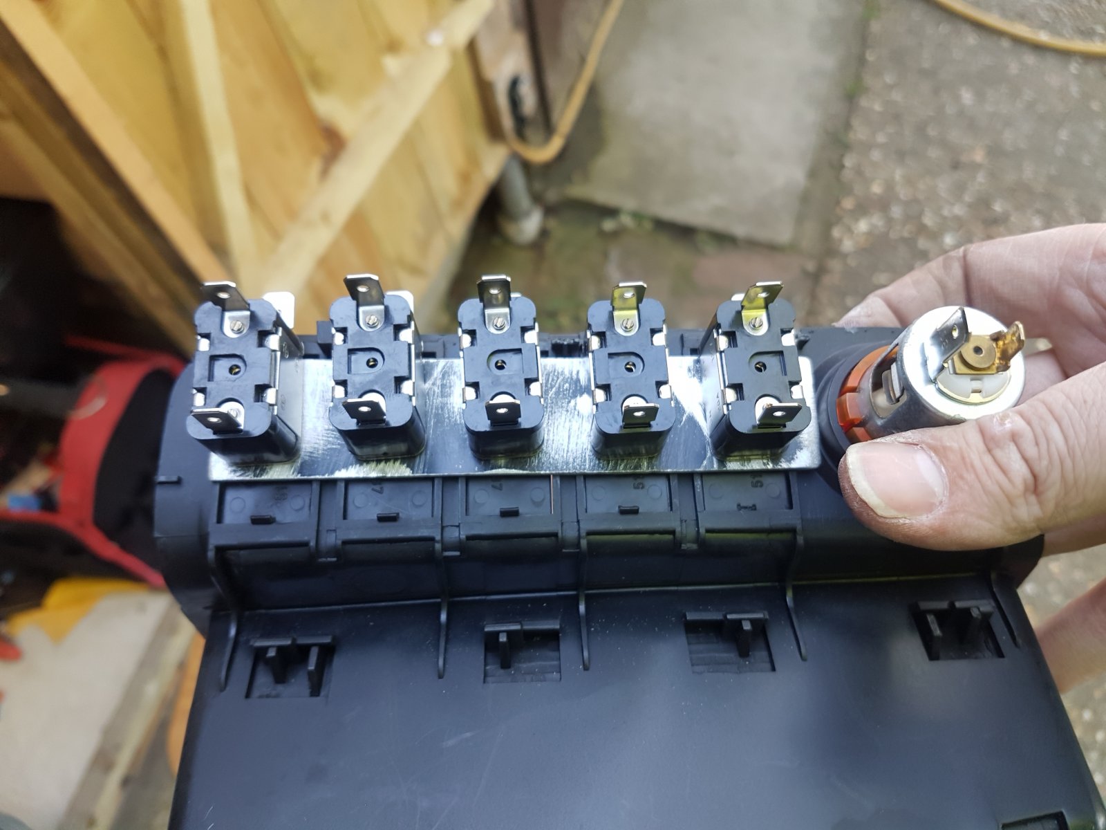

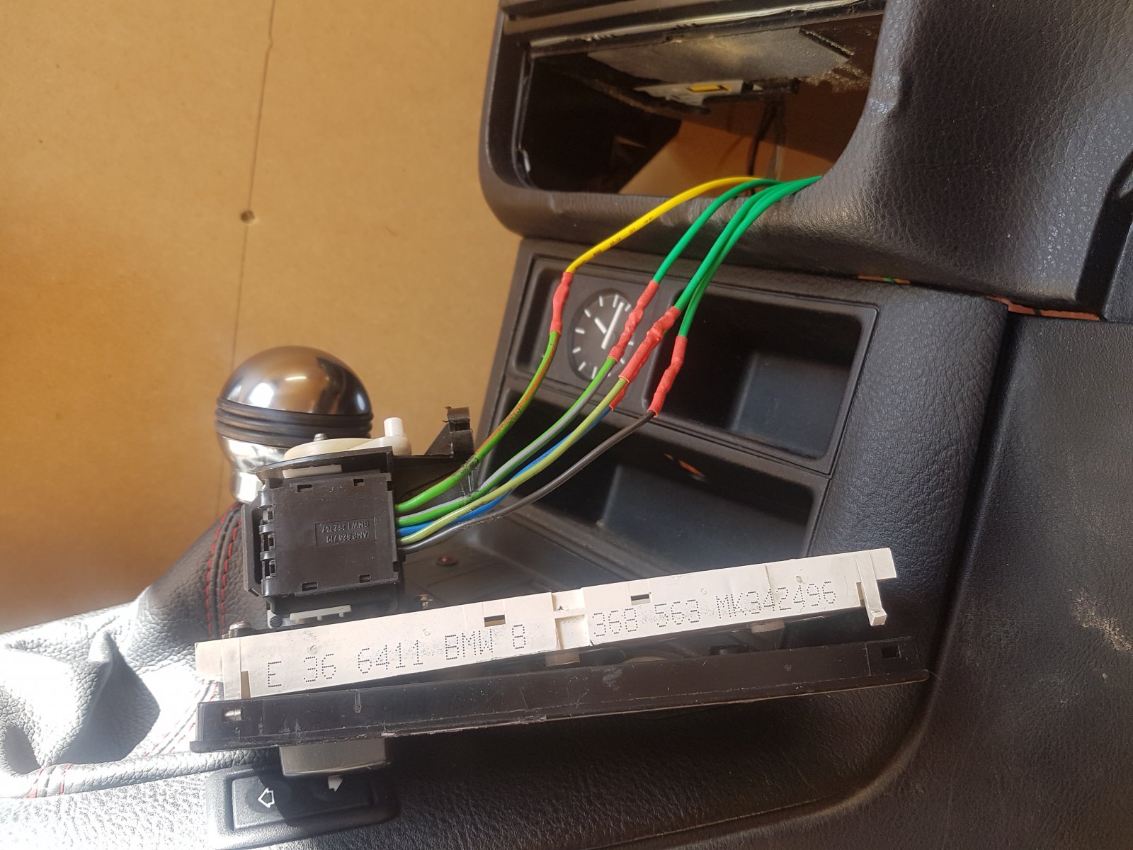

    And I starting installing these pretty switches

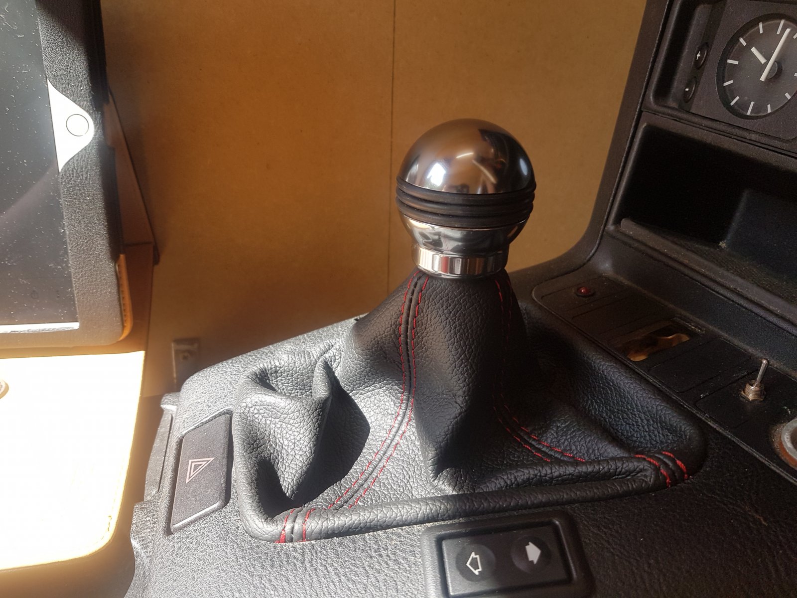

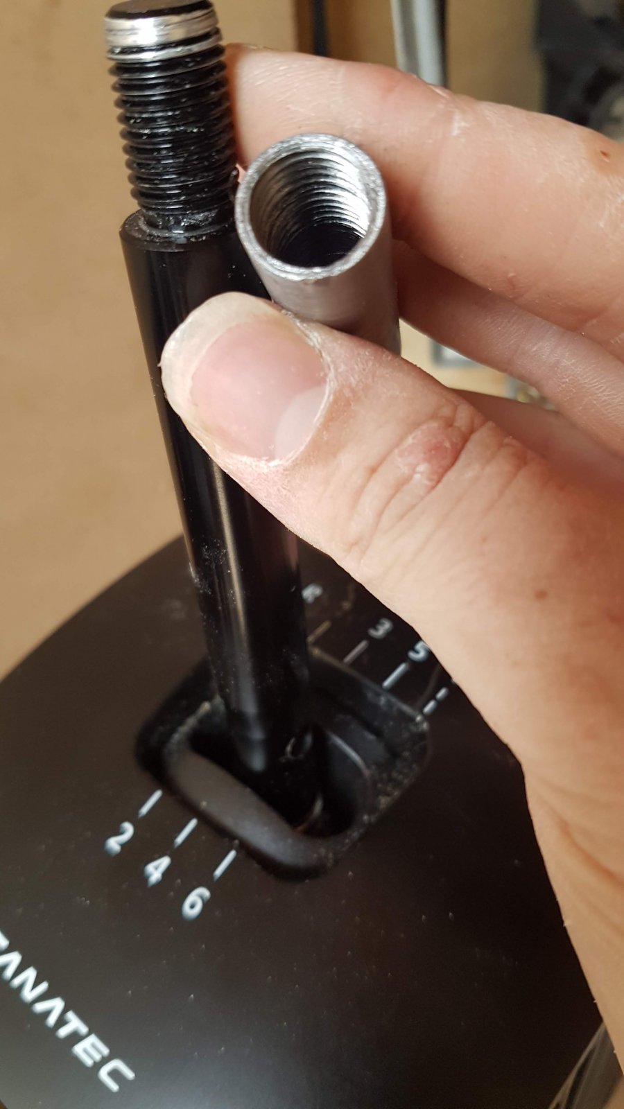

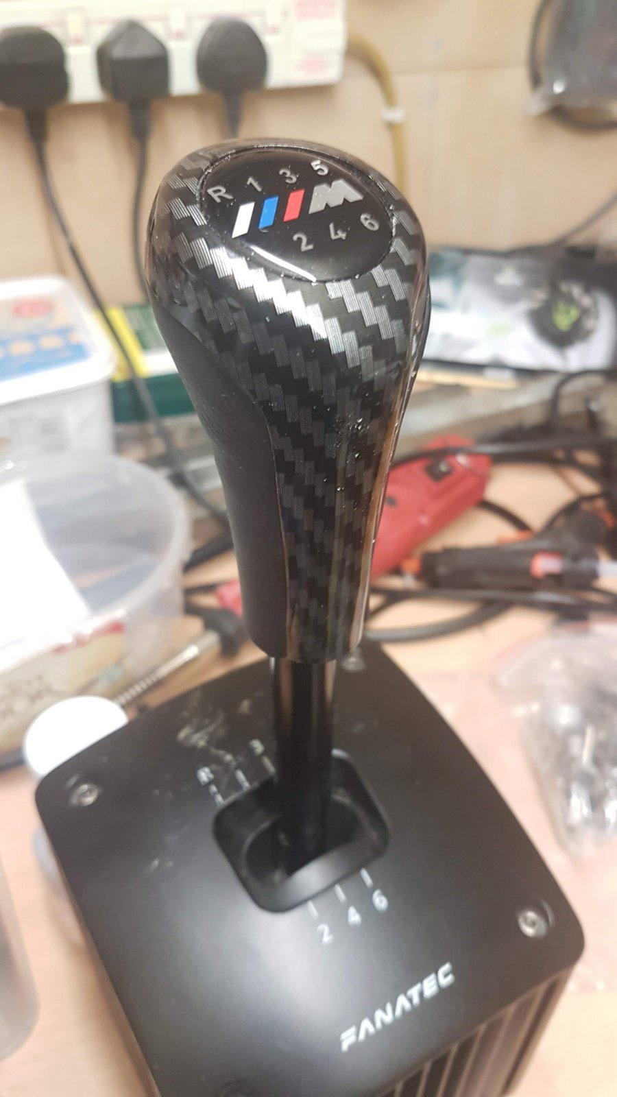

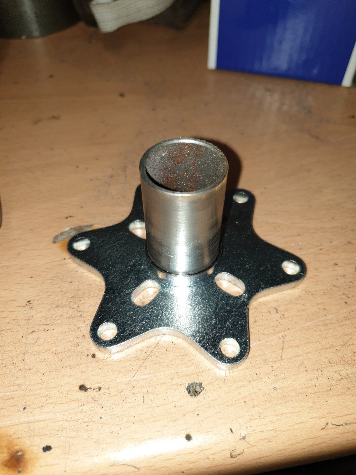

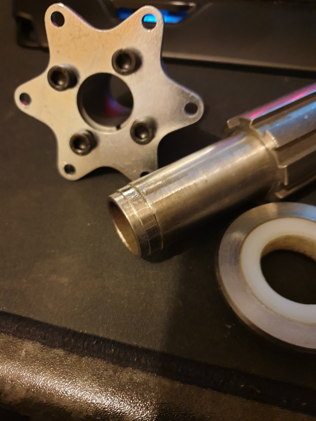

    well I thought I may as well find the pictures of the gear shift extension so here they are
    so first I brought the BMW M3 gear knob that comes with a cool key ring

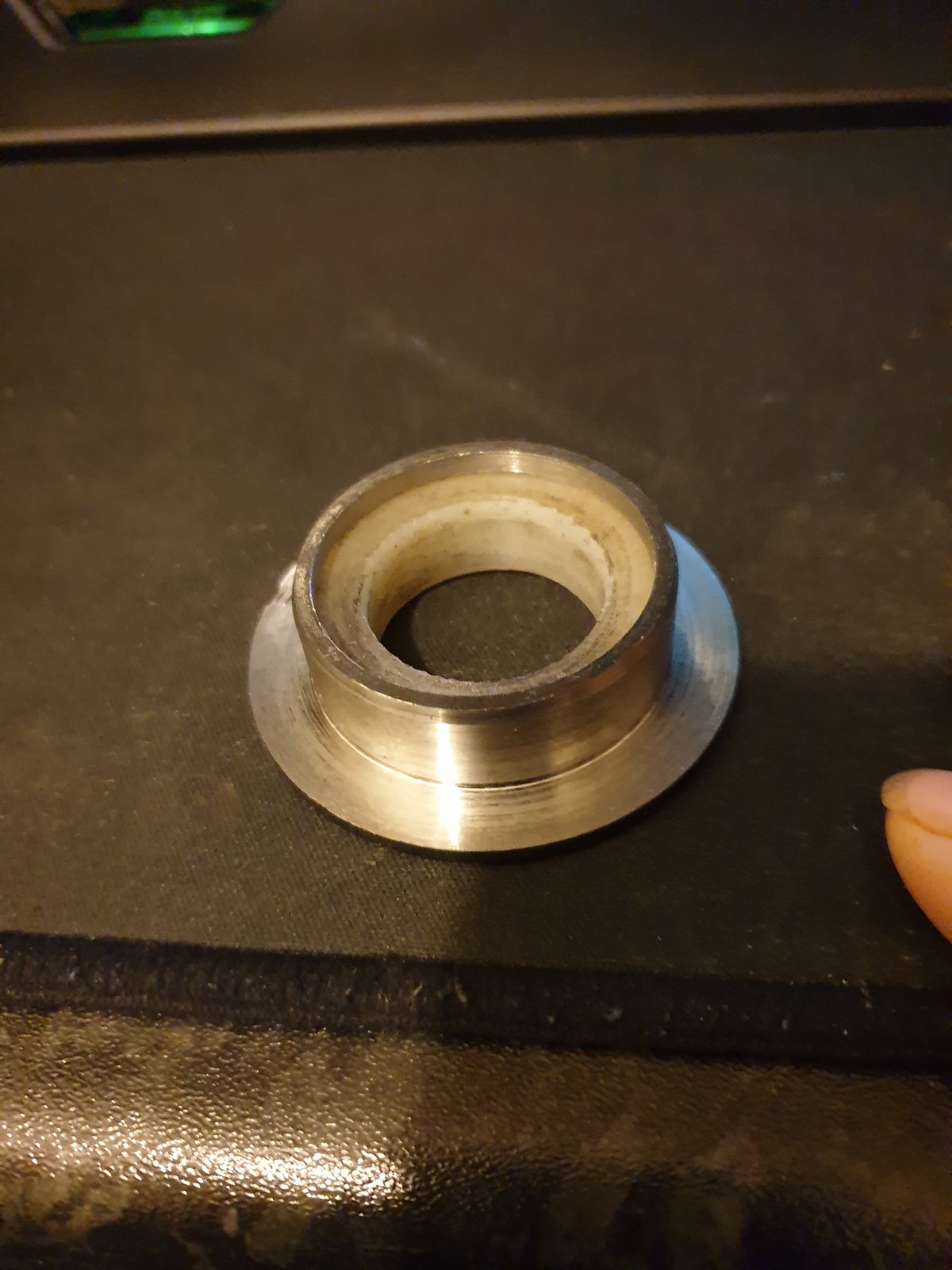

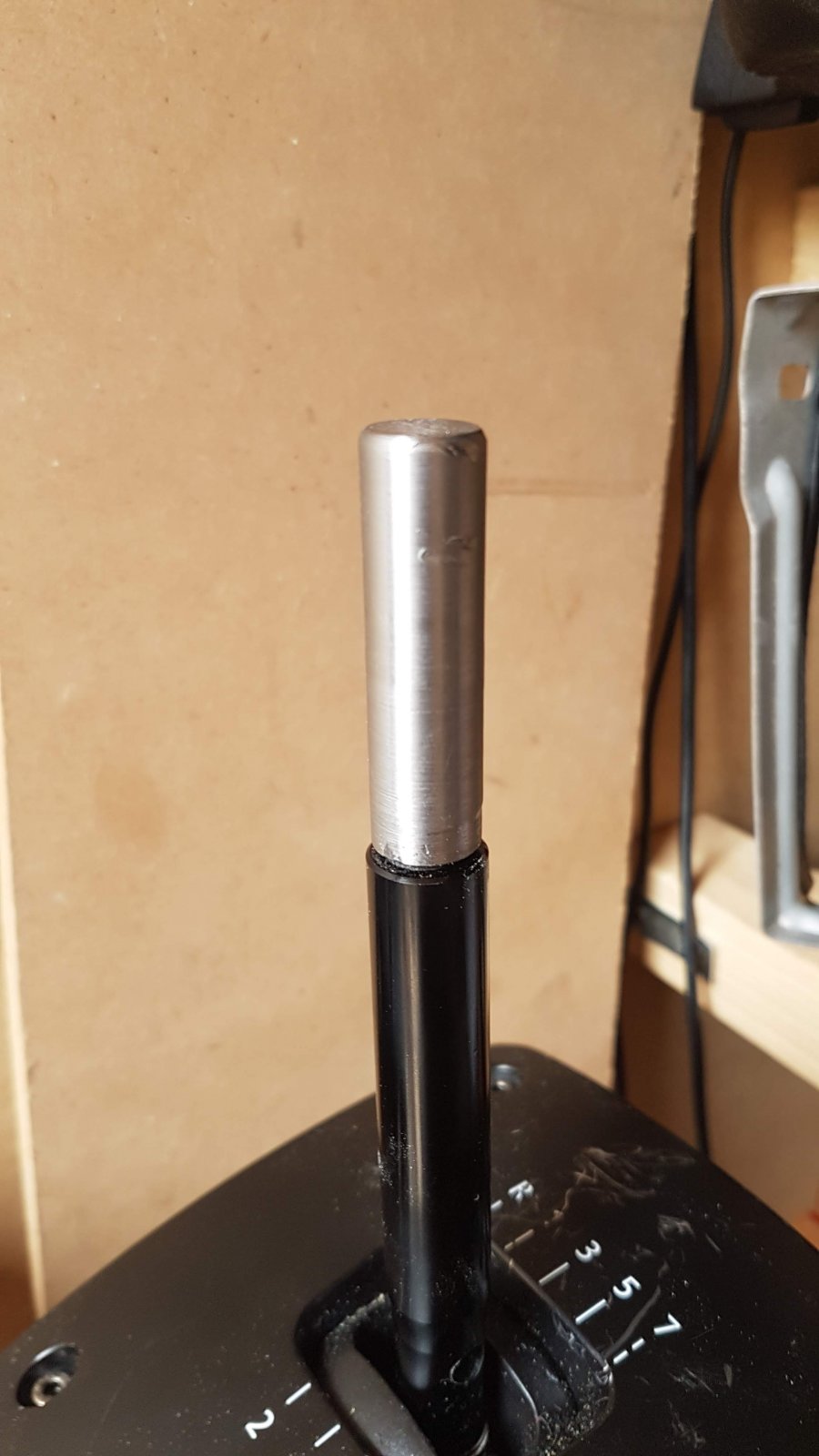

    then I went about making an adaptor to fit a push fit gear knob to the fanatec shifter
    and here it is fitted, these were taken a while back but i thought id give you all something to look at
    very happy with how it turned out

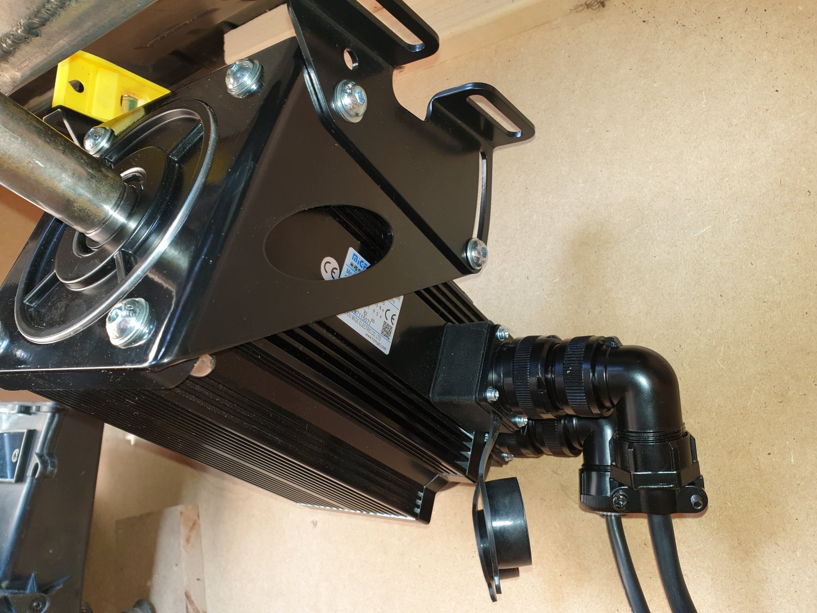

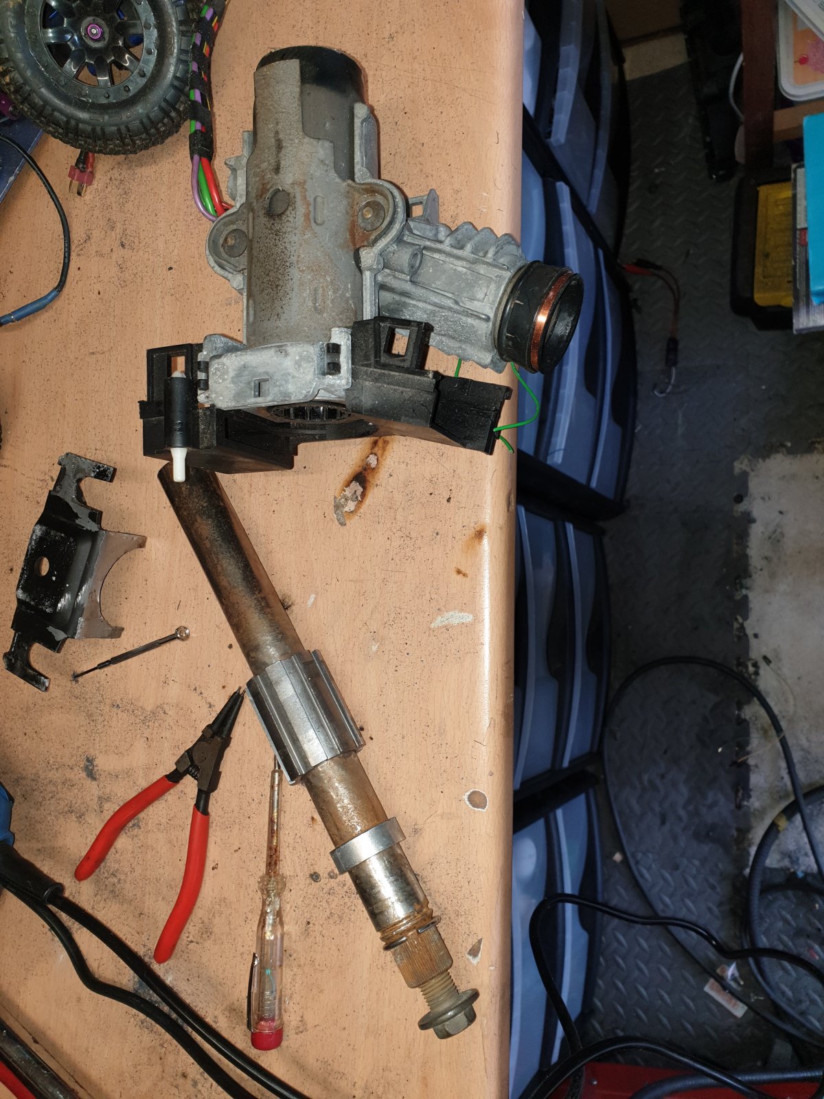

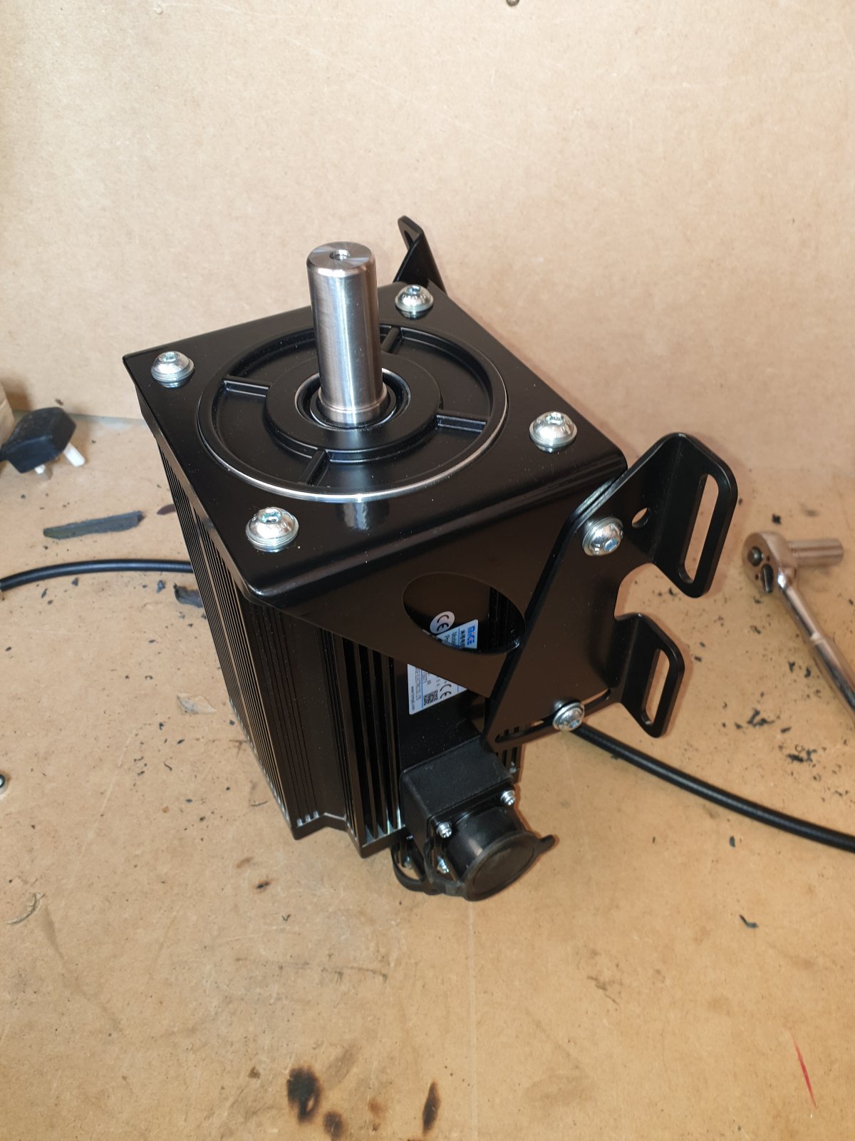

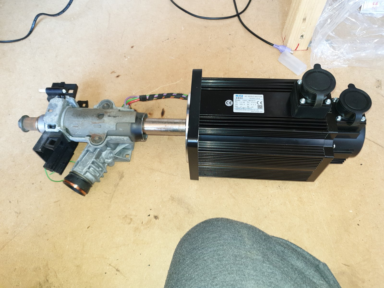

    hey guys so I've had an operation today and I'm in a lot of pain but it went well and hopefully be back to full strength soon, been told to rest my arm no heavy lifting so had to get my bro to help me open my package that came today

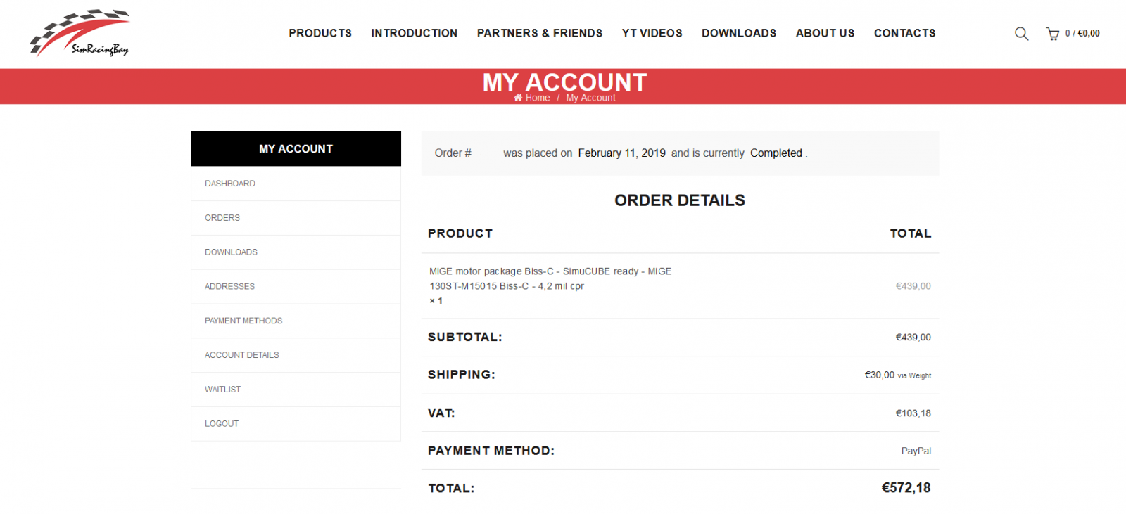

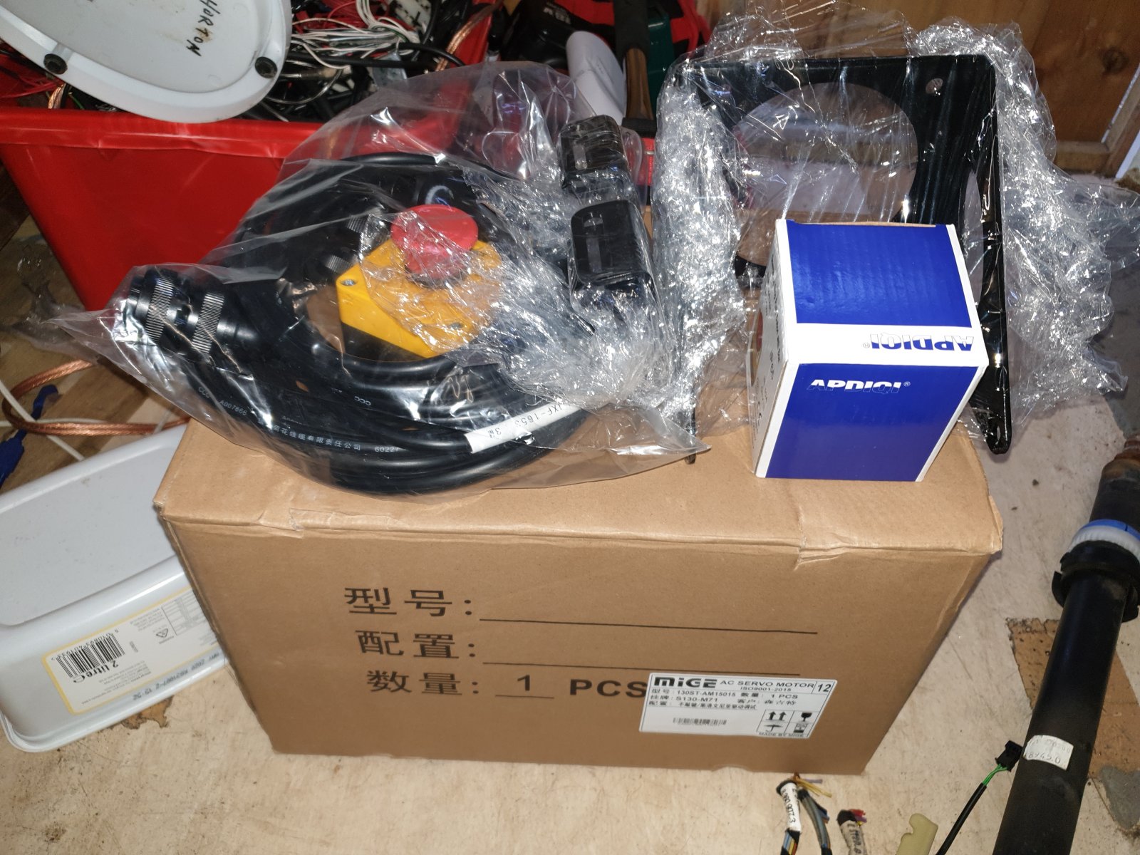

    yes after some time I've finally made the order, still need to get the simucube but didn't order it now as won't be able to use to till its welded in,

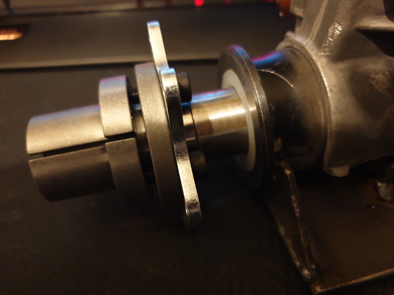

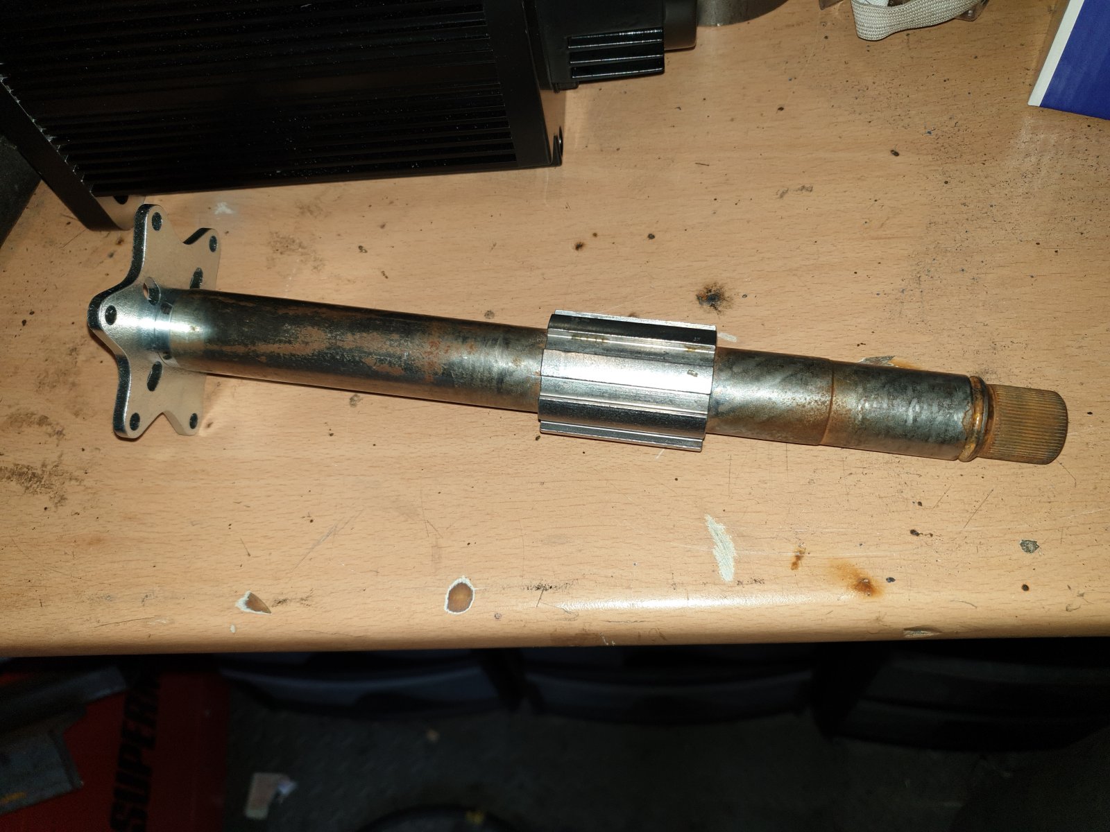

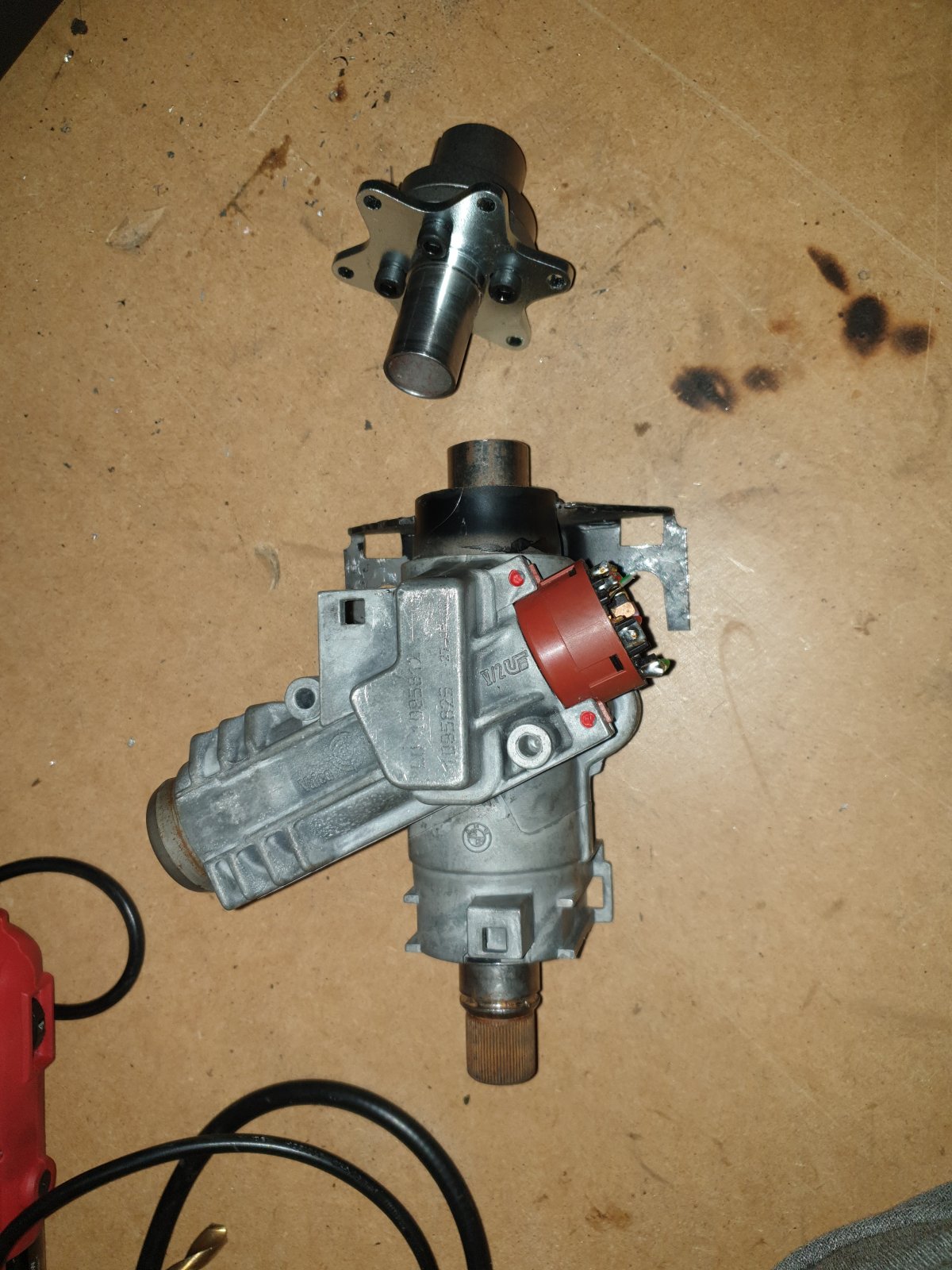

    if this next picture gives you an idea of what I'm planning.....

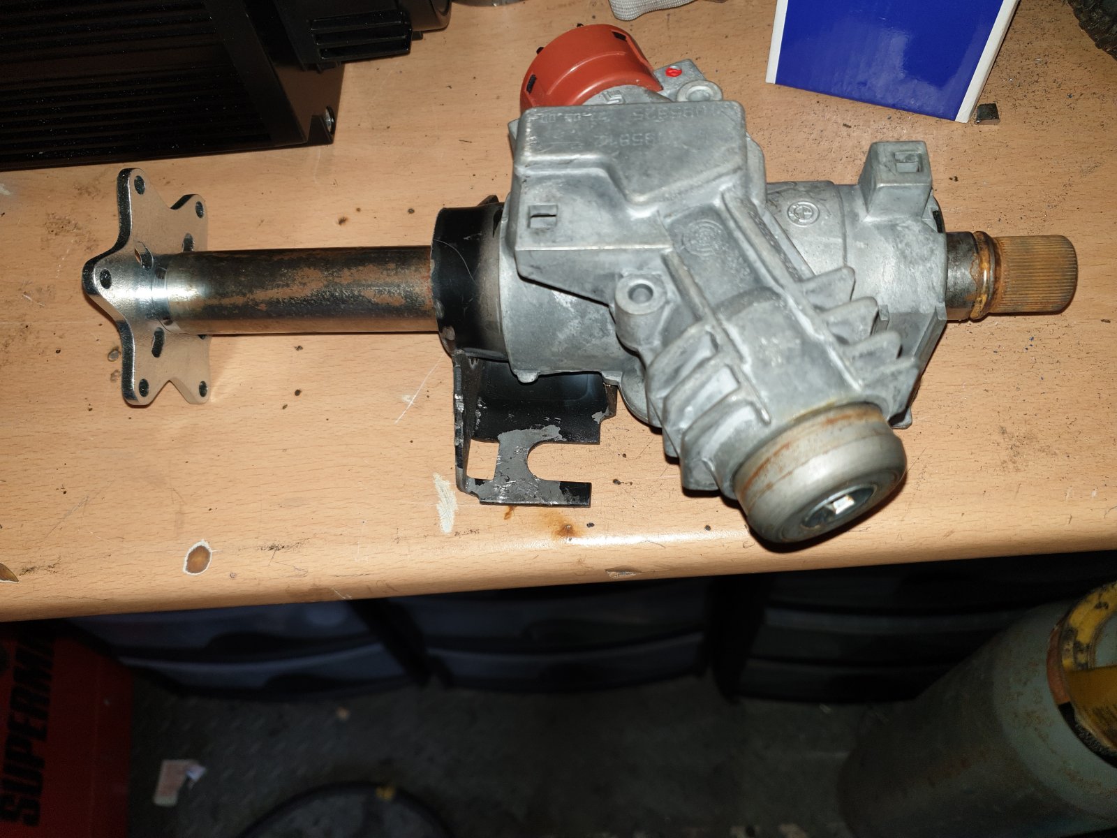

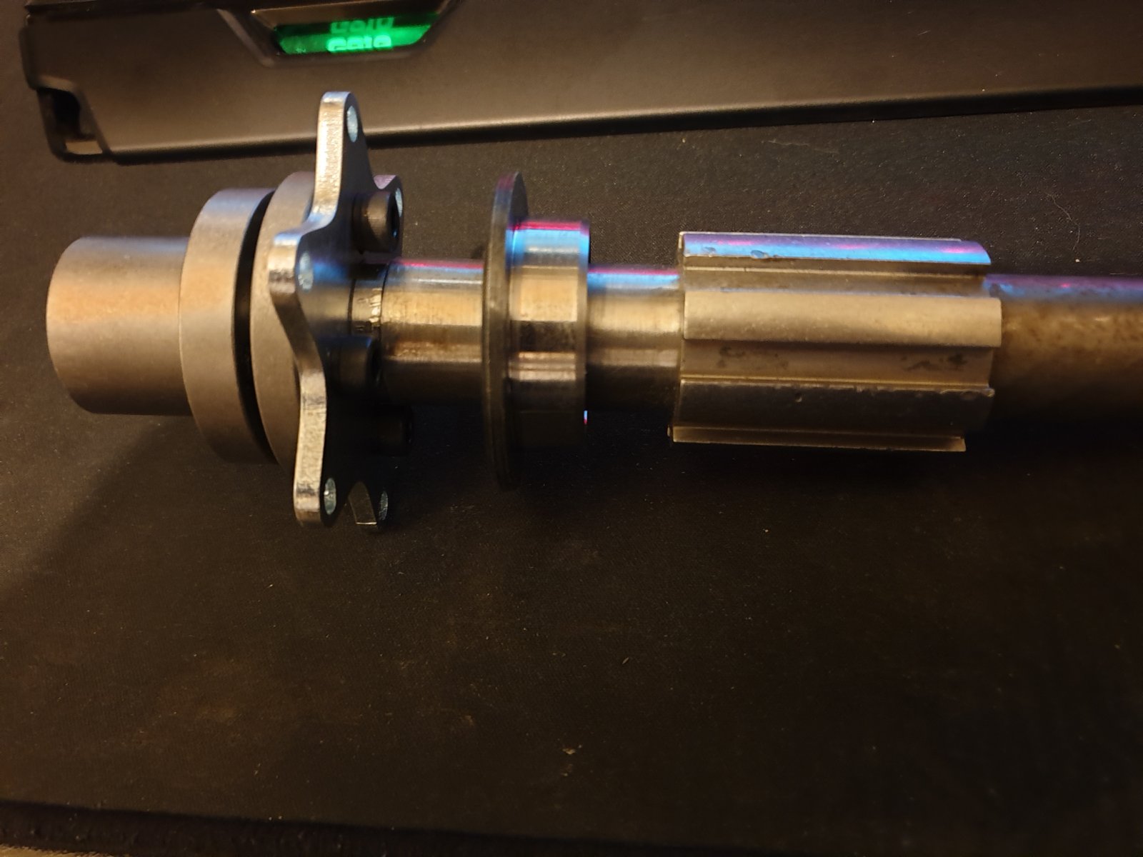

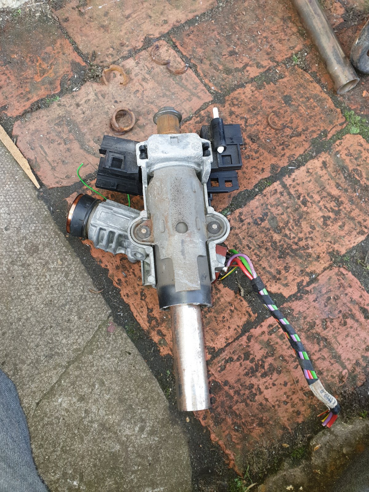

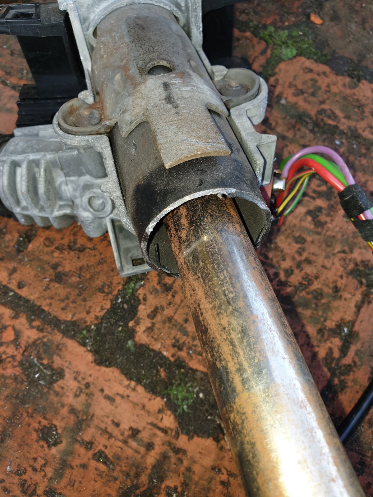

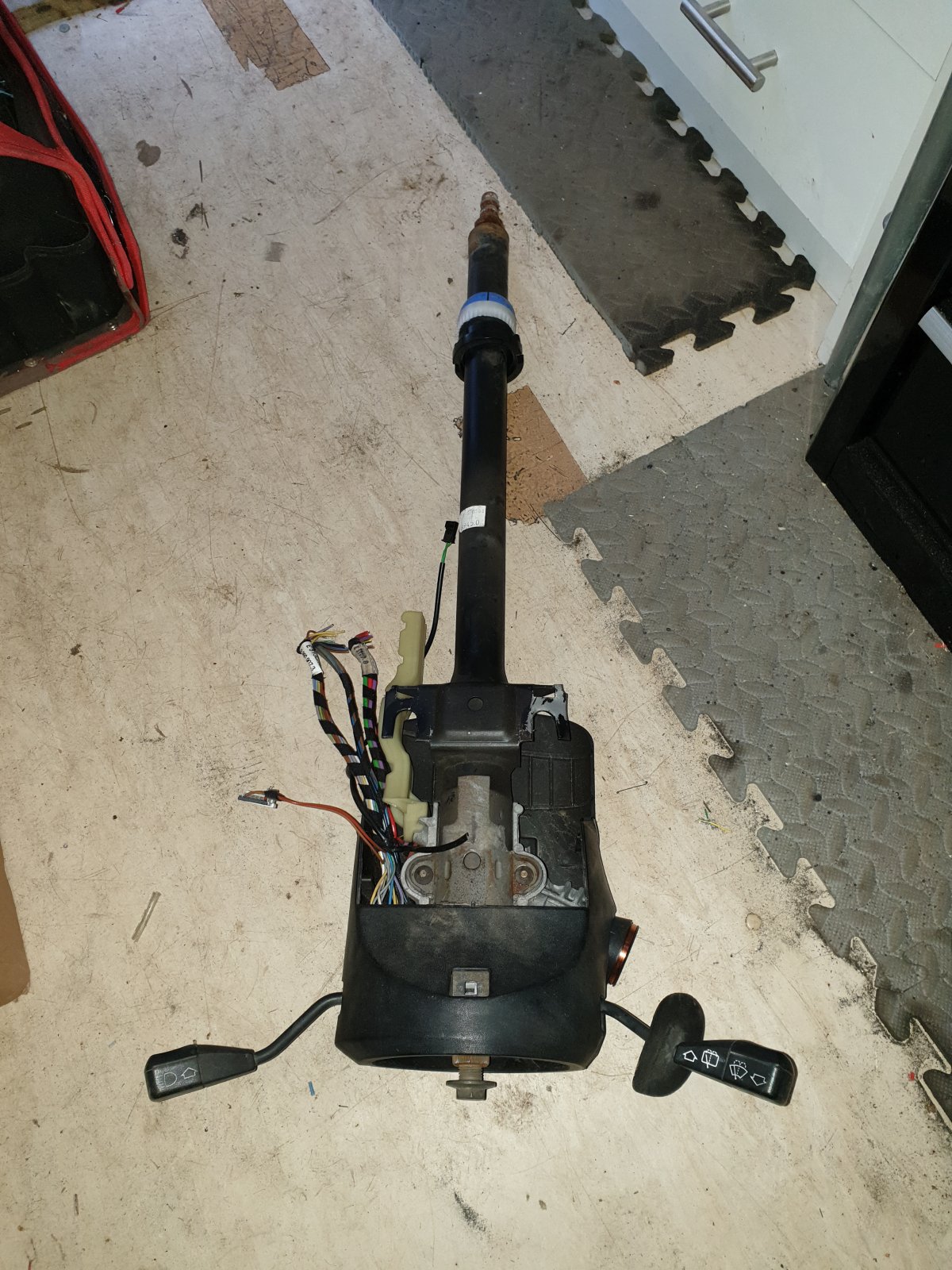

    yes, a steering column, got it before I had the op and am planning of cutting it down and fitting the motor on the end somehow might have to have a play with the lathe and see what I can come up with,
    but got to go down to the metal yard and get som 20mm steel box and some plate for this to work, I'm also thinking of getting doing some cad drawing made up tonight and see if I can get the laser cut as I don't think ill use the mount that came with the MIGE but ill see,
    I kept the surround to the column as I want it to look stock is like the BMW E36 was, and I'm going to try to get the indicators and light and washer to work too, going to have a play with the ignition but as I got it from a scrap yard I didn't get a key so I'm thinking of getting a new barrel and key made and see if I can use the ignition to turn most of the rig on, don't know how I'm going to do that but I think I can do something with arudino and relays,
    ass you can see I kept the steering wheel bolt so I can get a boss to go from original to the fanatec aadaptor
    when a couple weeks have passed I may have pics of inside the rig depending on what the doc says about my arm,
    maybe before if he gives me the go ahead,
    also, the MIGE motor is the 30NM so I've got a lot of room to play with,
    well that's all I've got for now
    hope your all well and like this project and not getting bored about how long it's taking but you know stuff gets in the way sometimes
    peace

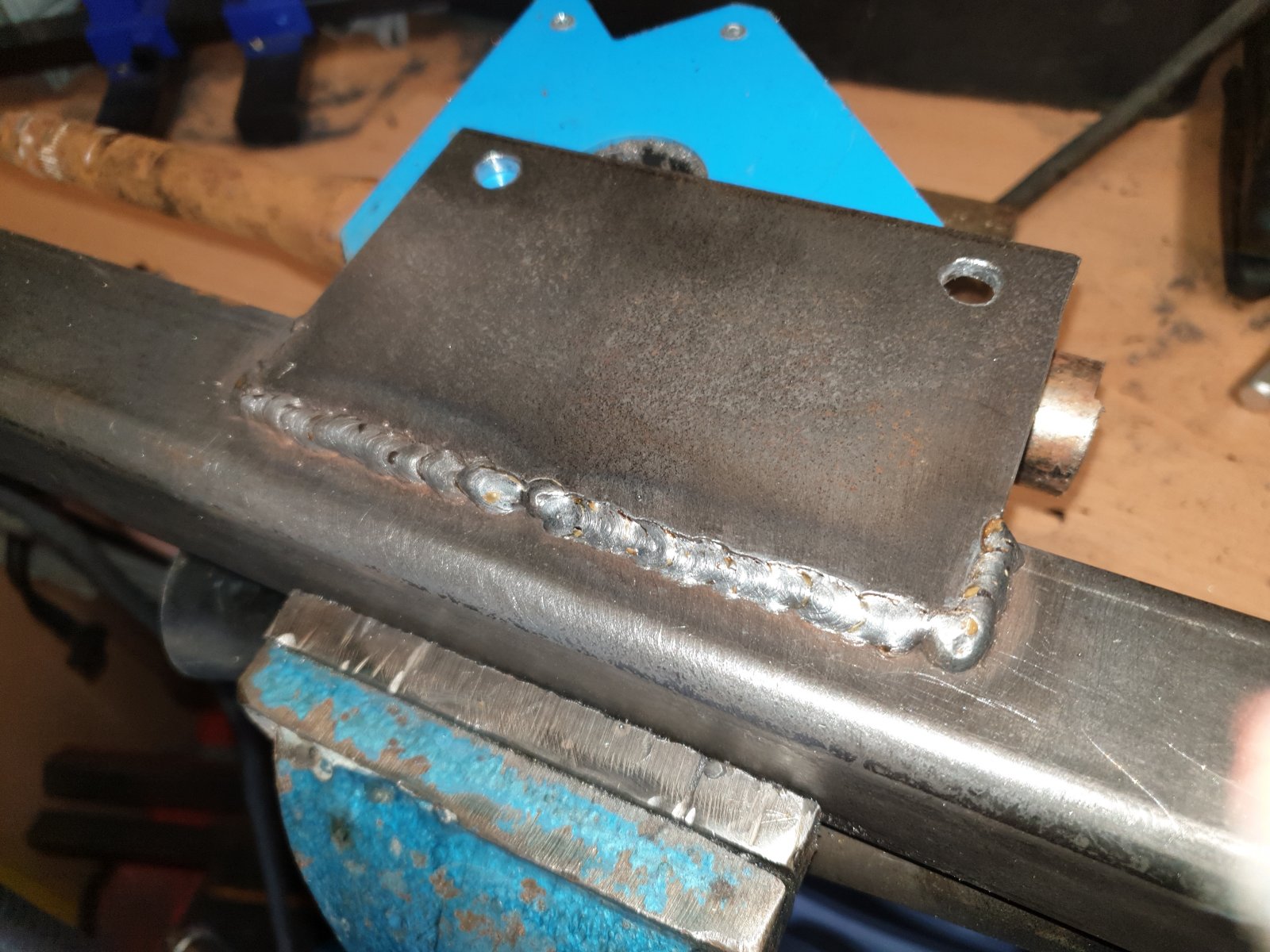

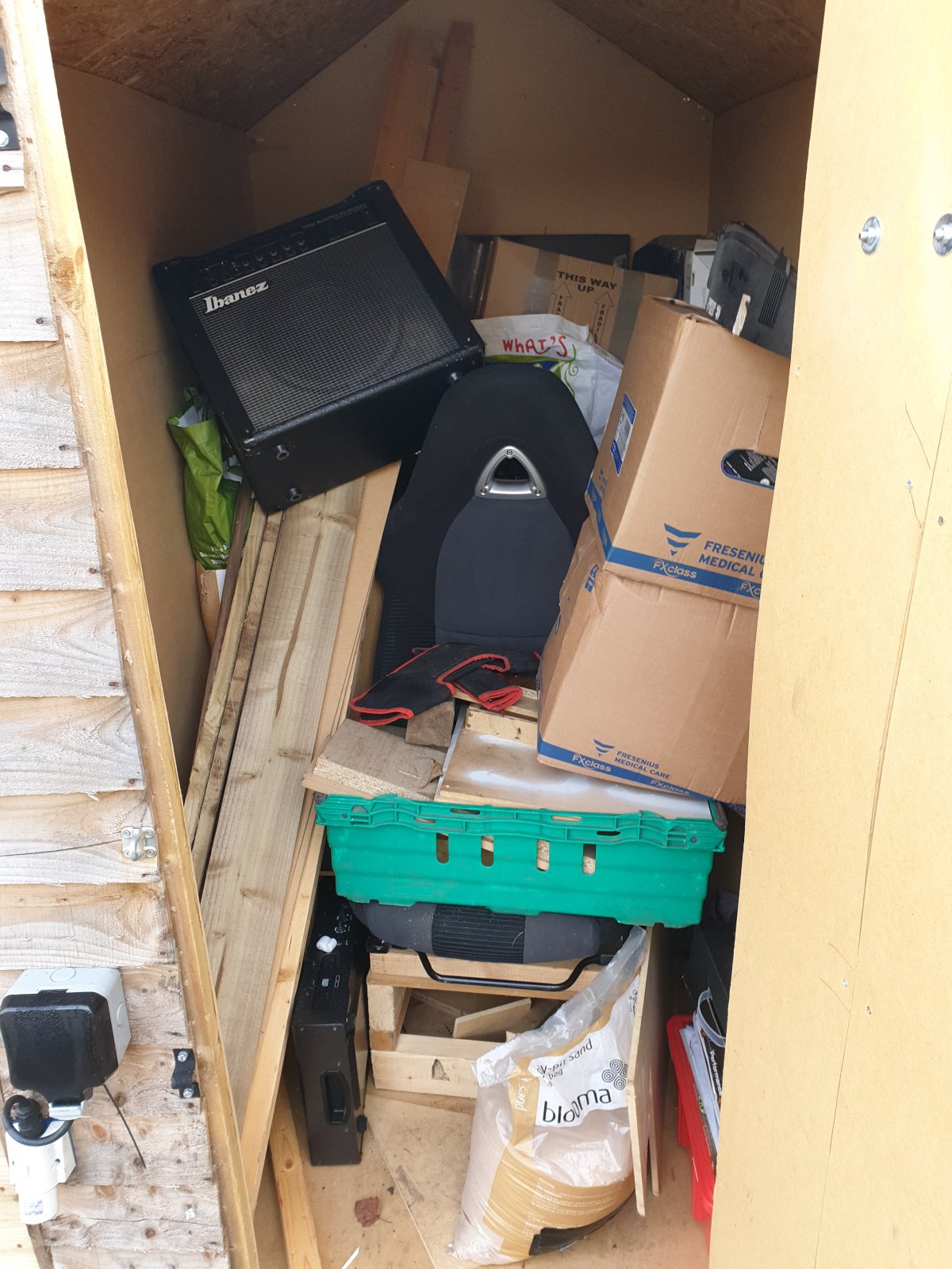

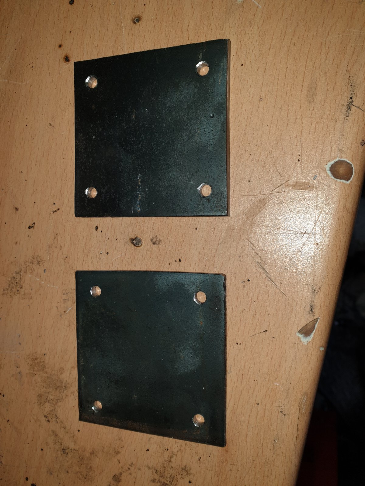

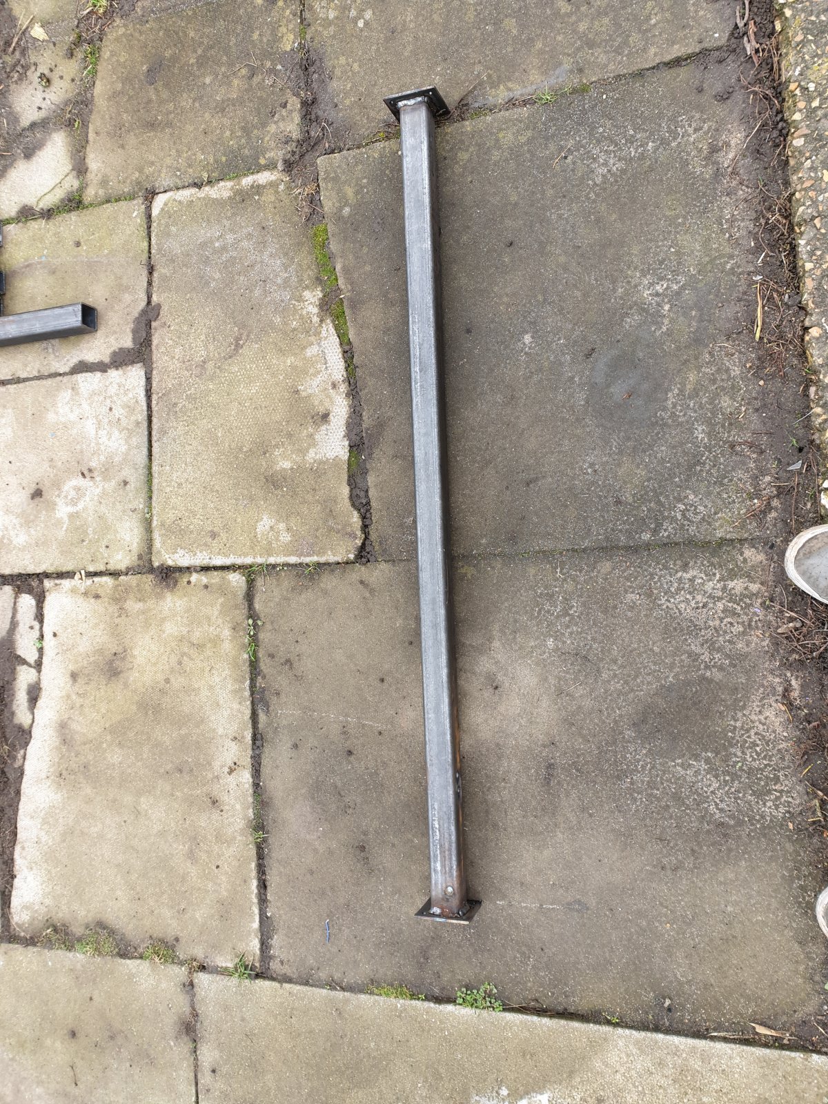

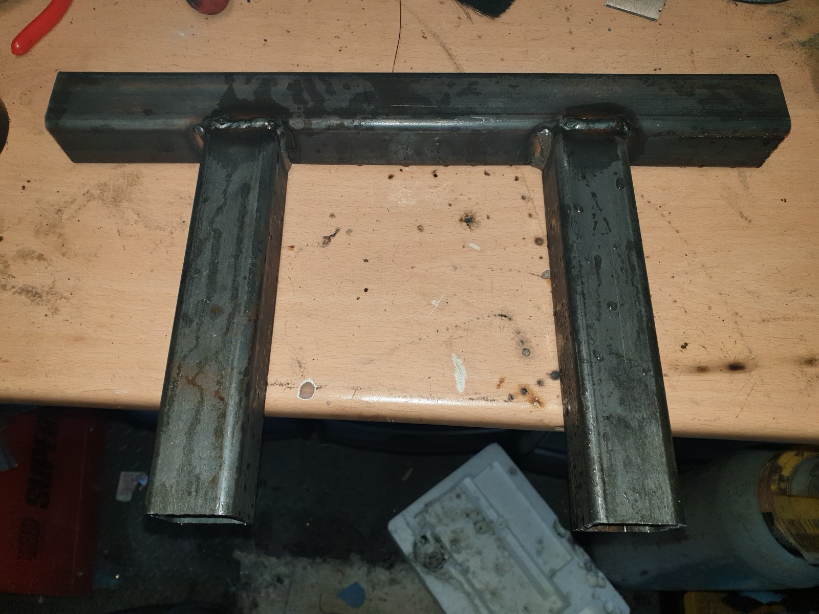

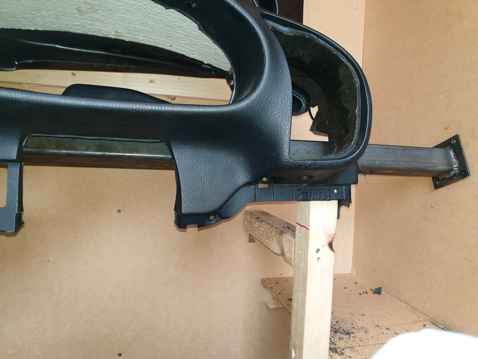

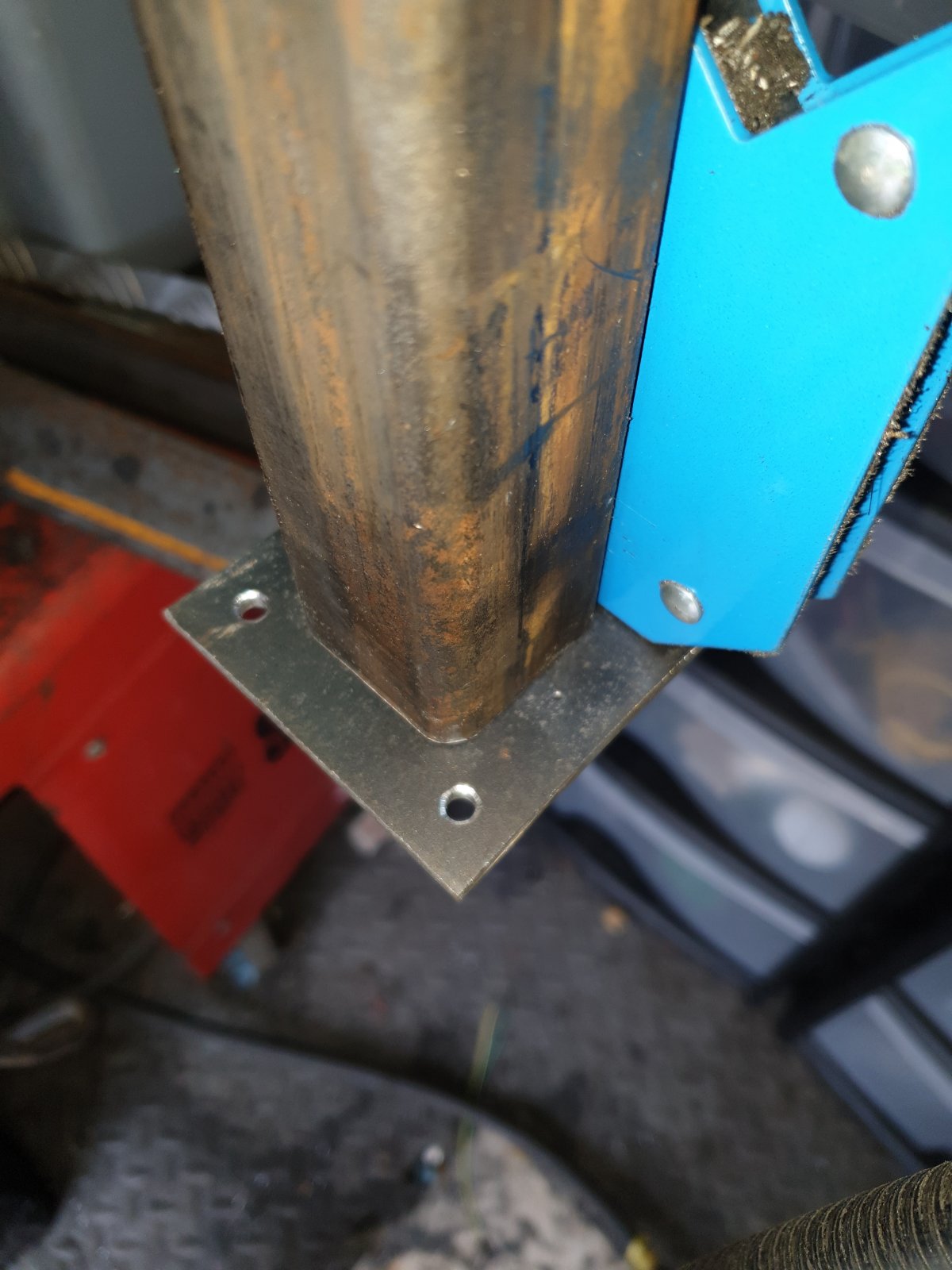

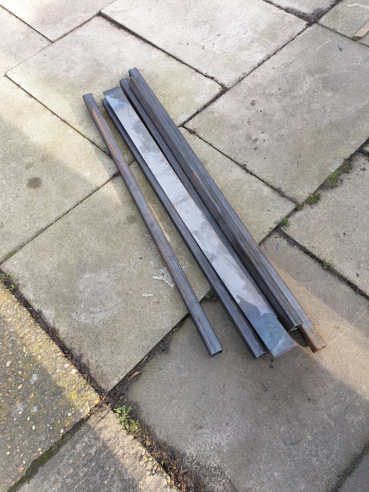

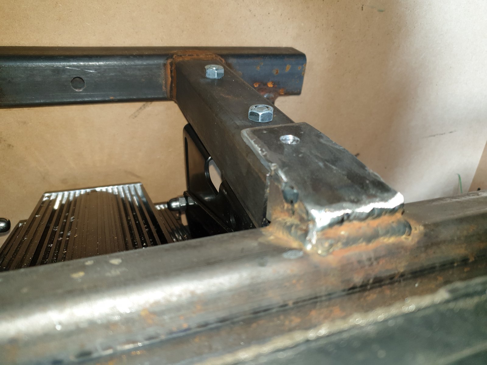

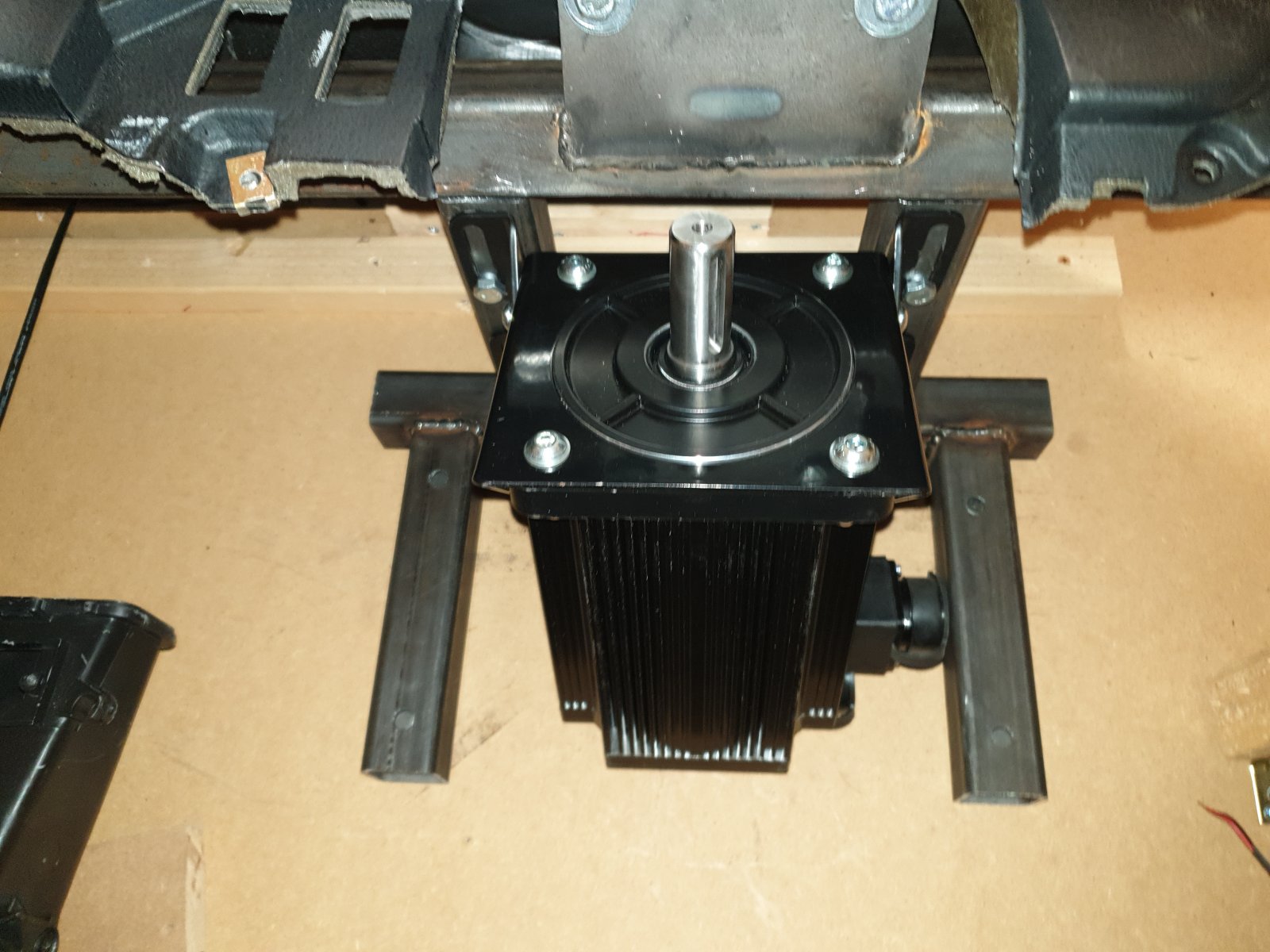

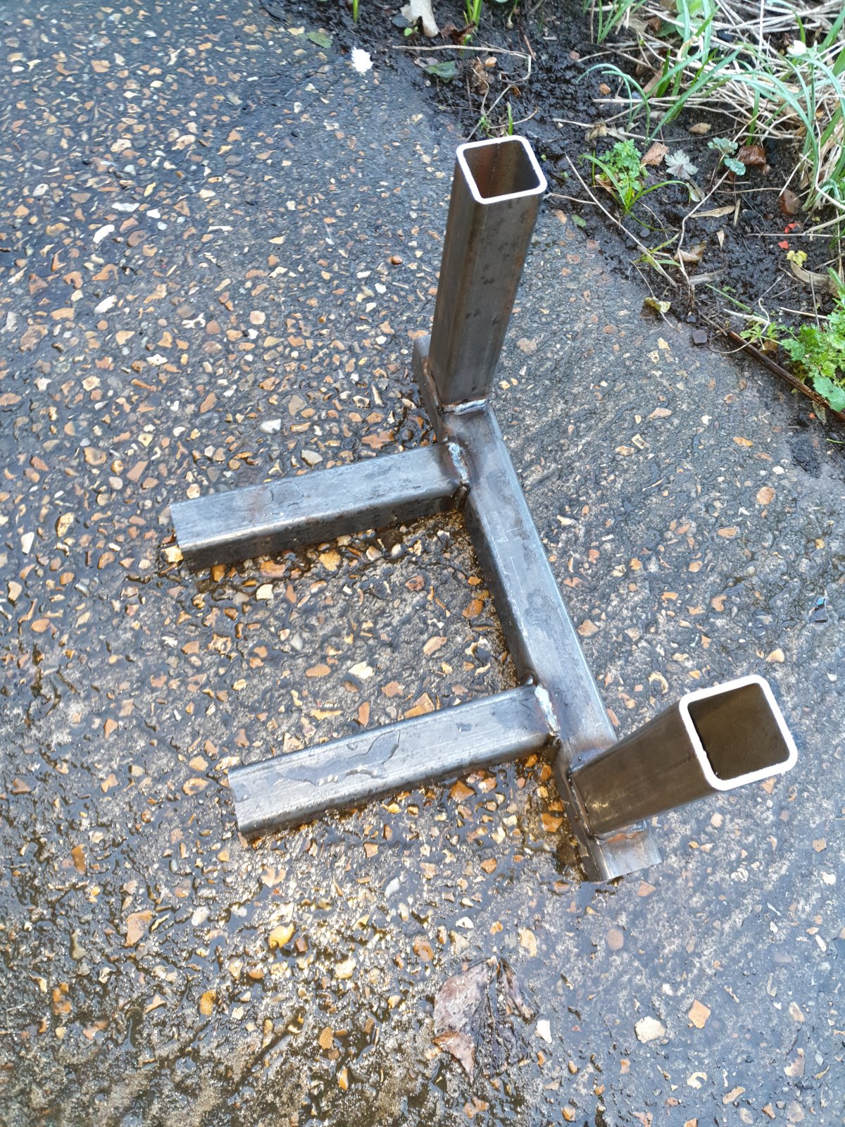

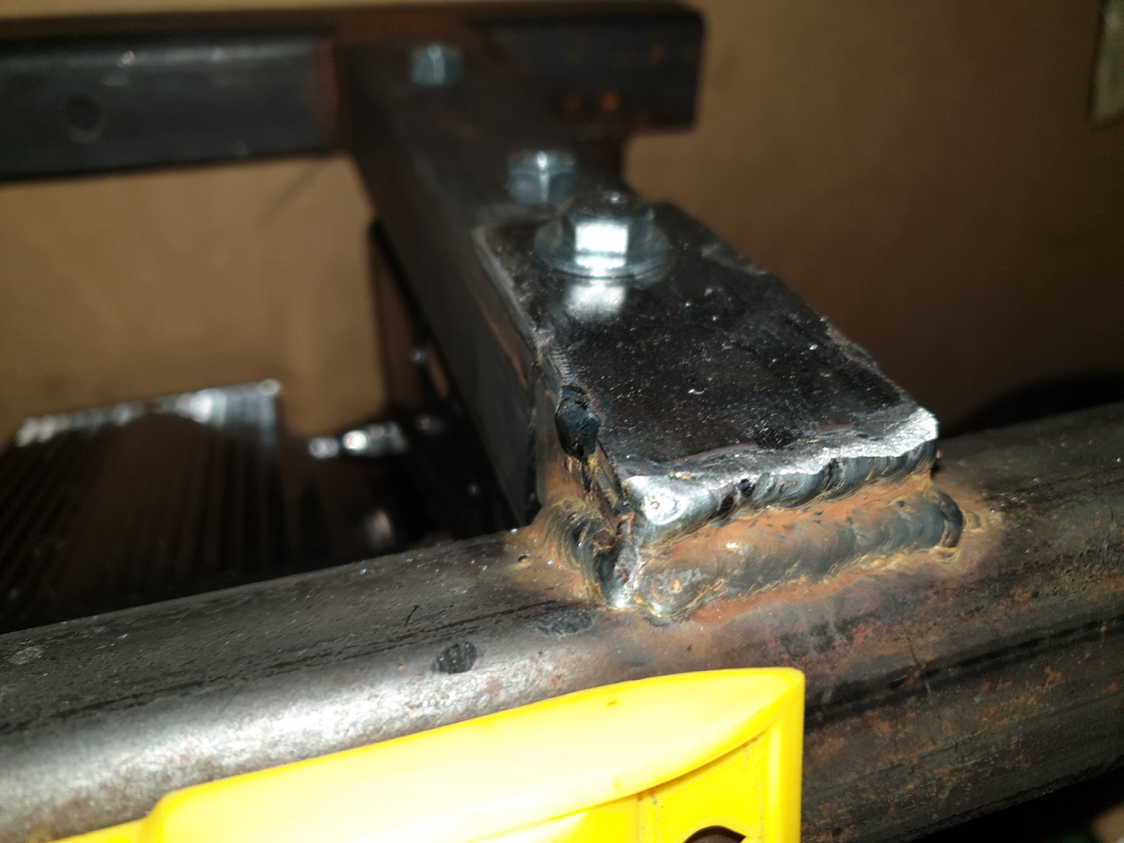

    right so its 10.18 am and it's a little later then id want, but I had to go to the metal yard and get supplies for today's task,
    I've been cleared to start working again,
    so here are some pictures of what I've got

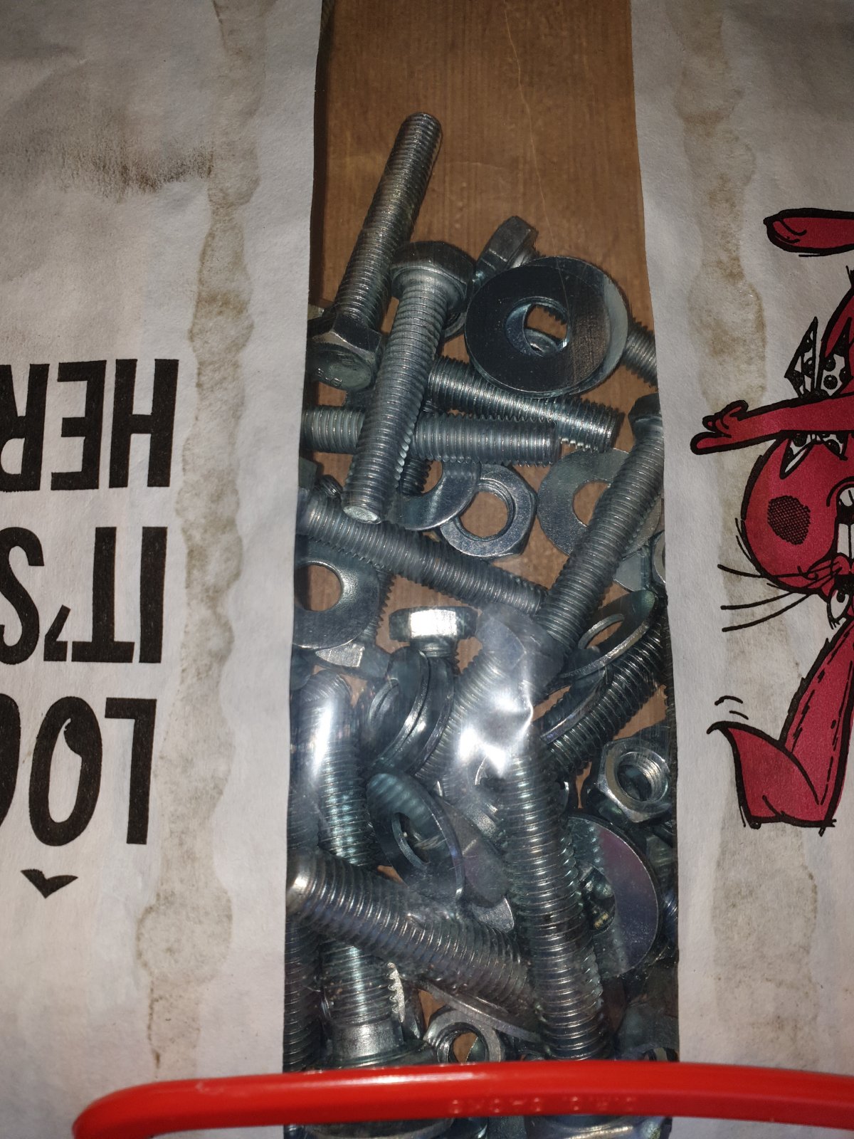

    some 2.5m 40x40mm box section should be strong enough for the motor and with 3mm plate so I can screw it to the shed walls

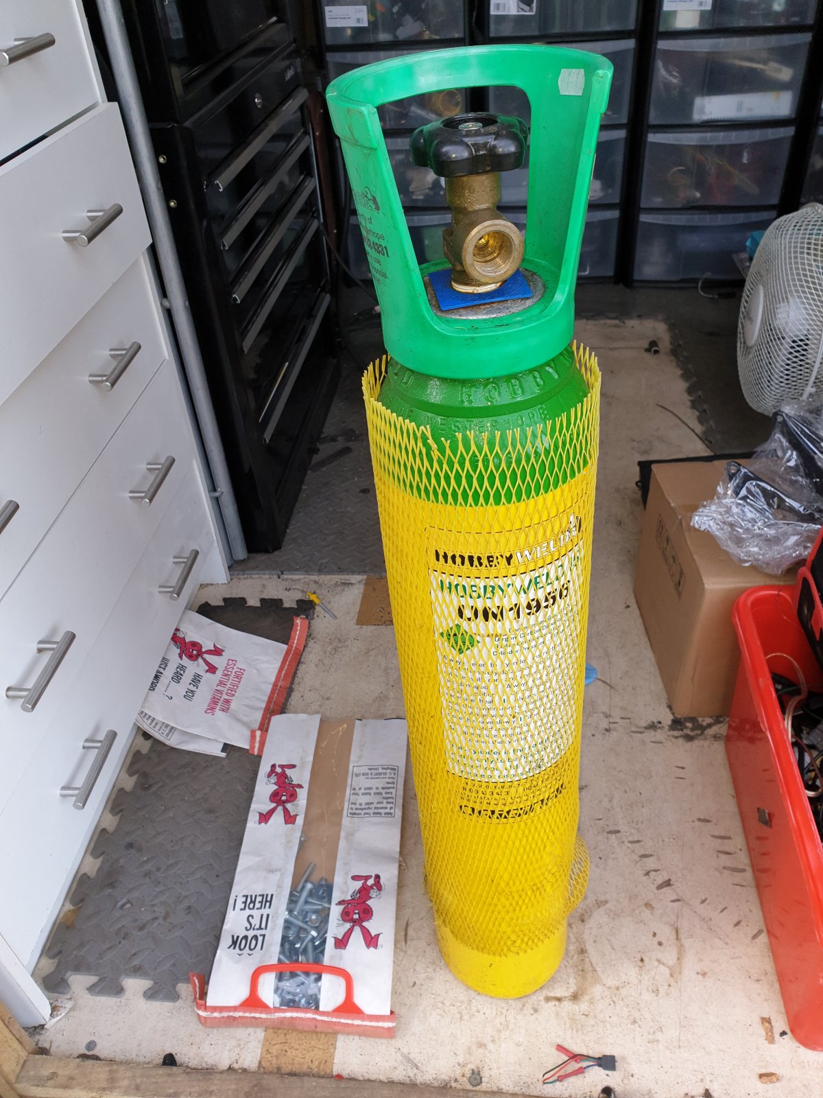

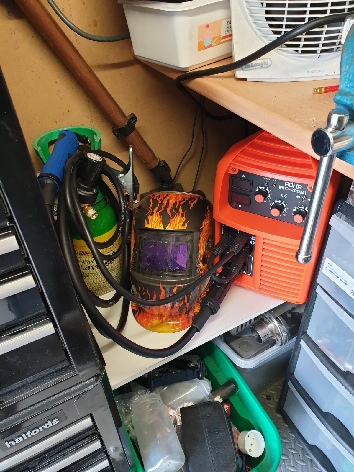

    also, I've run out of gas for my weld so I picked up a bottle for today
    also some m8 and m10 nuts bolts and washers
    final a big mess where I left it all a while ago,
    the first task is to move the motorbike from its stand and to the new parking space and then drag all the crap out and sort it out for the games to begin
    I haven't started work yet but you'll see some pictures most little at dinner time and some more by the end of the day
    wish me luck :)

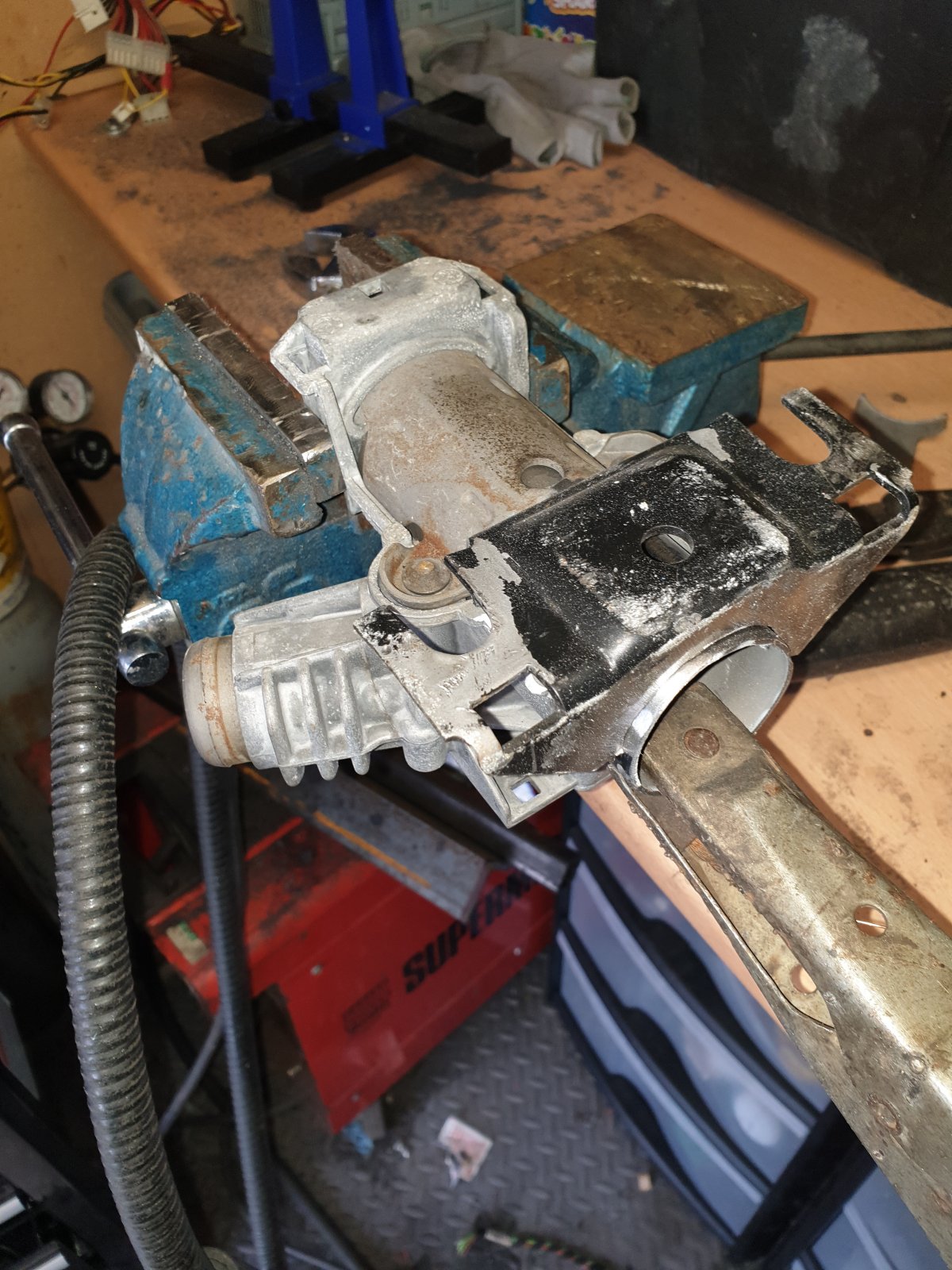

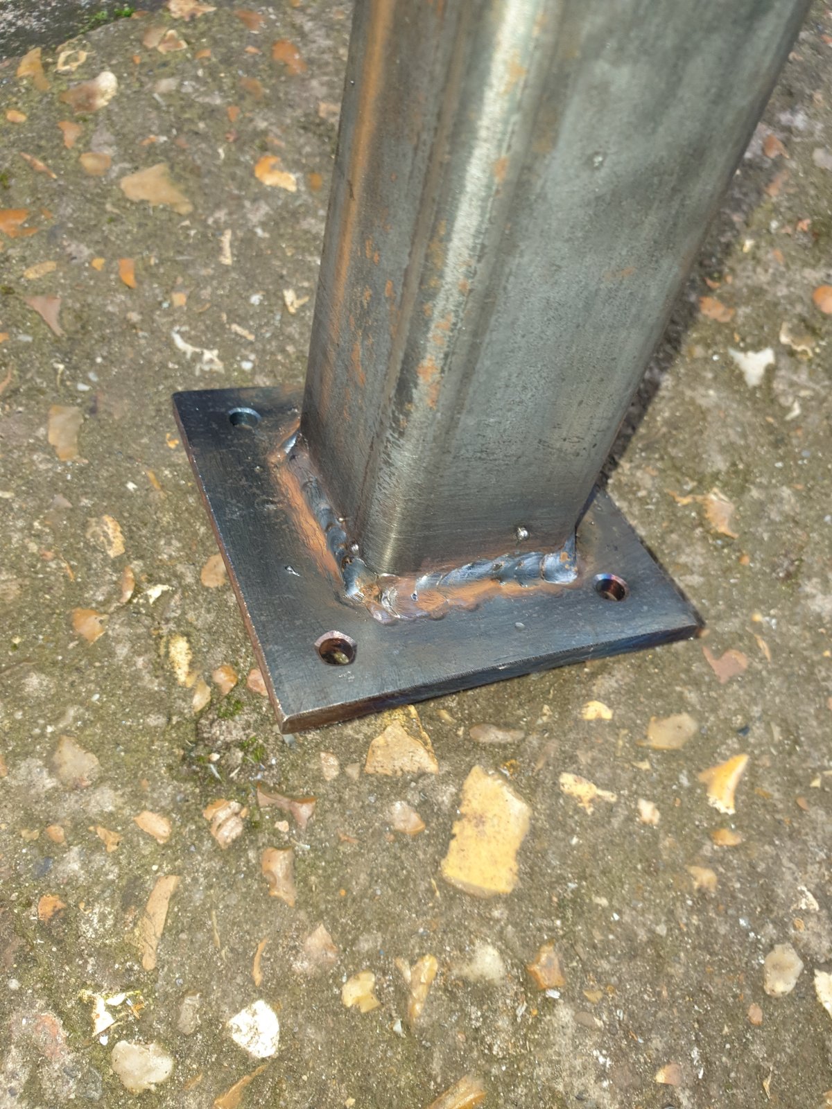

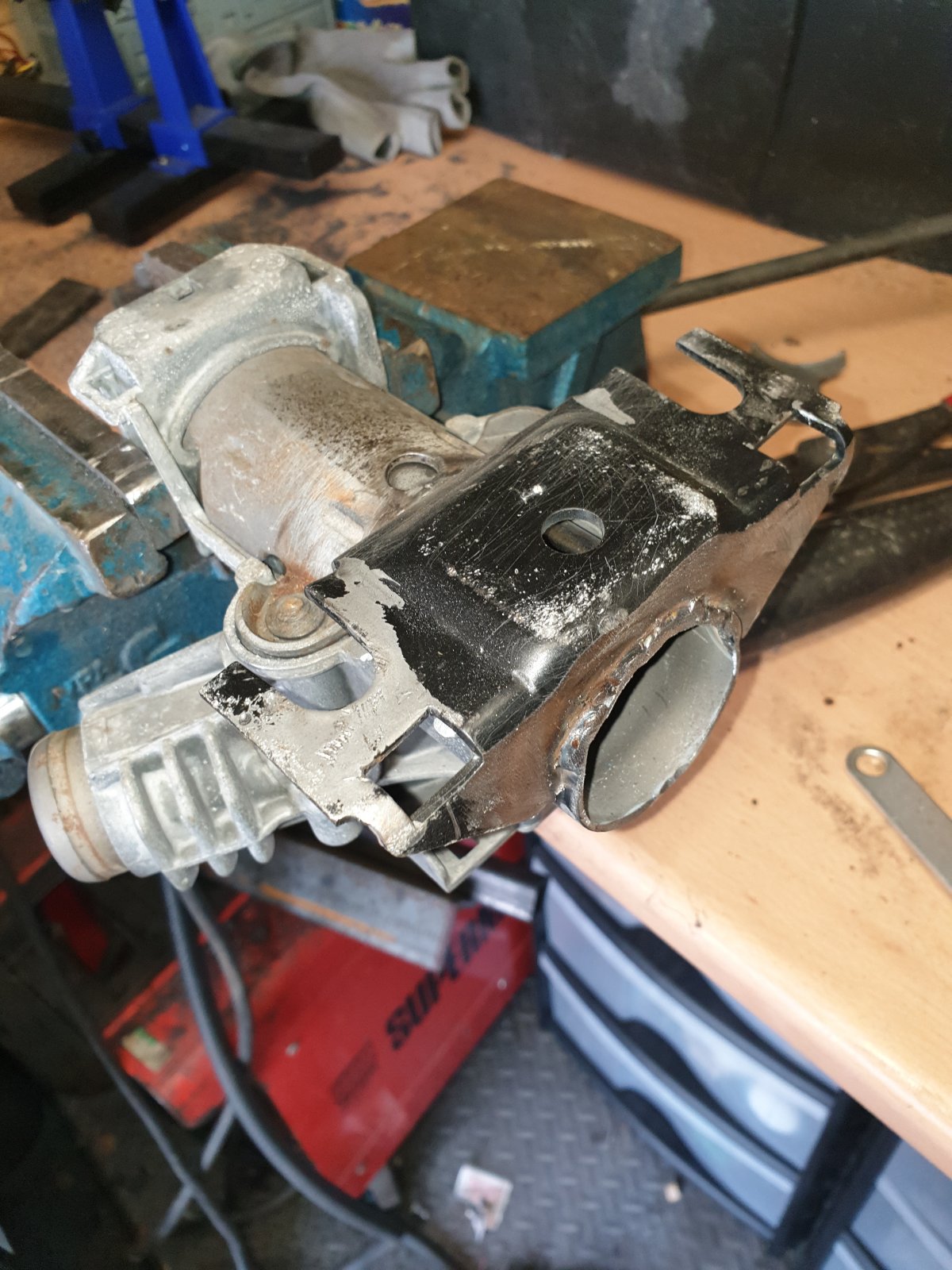

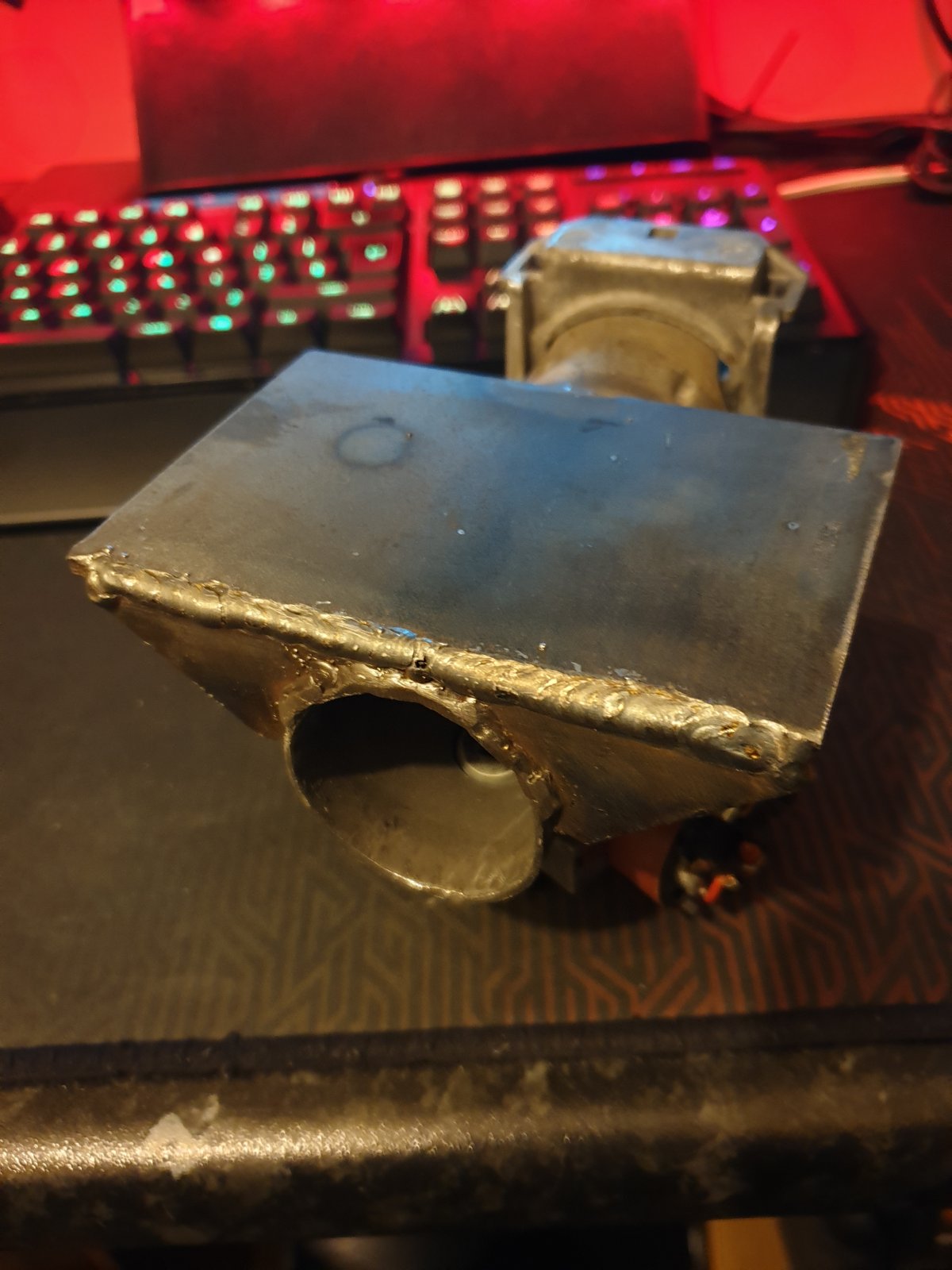

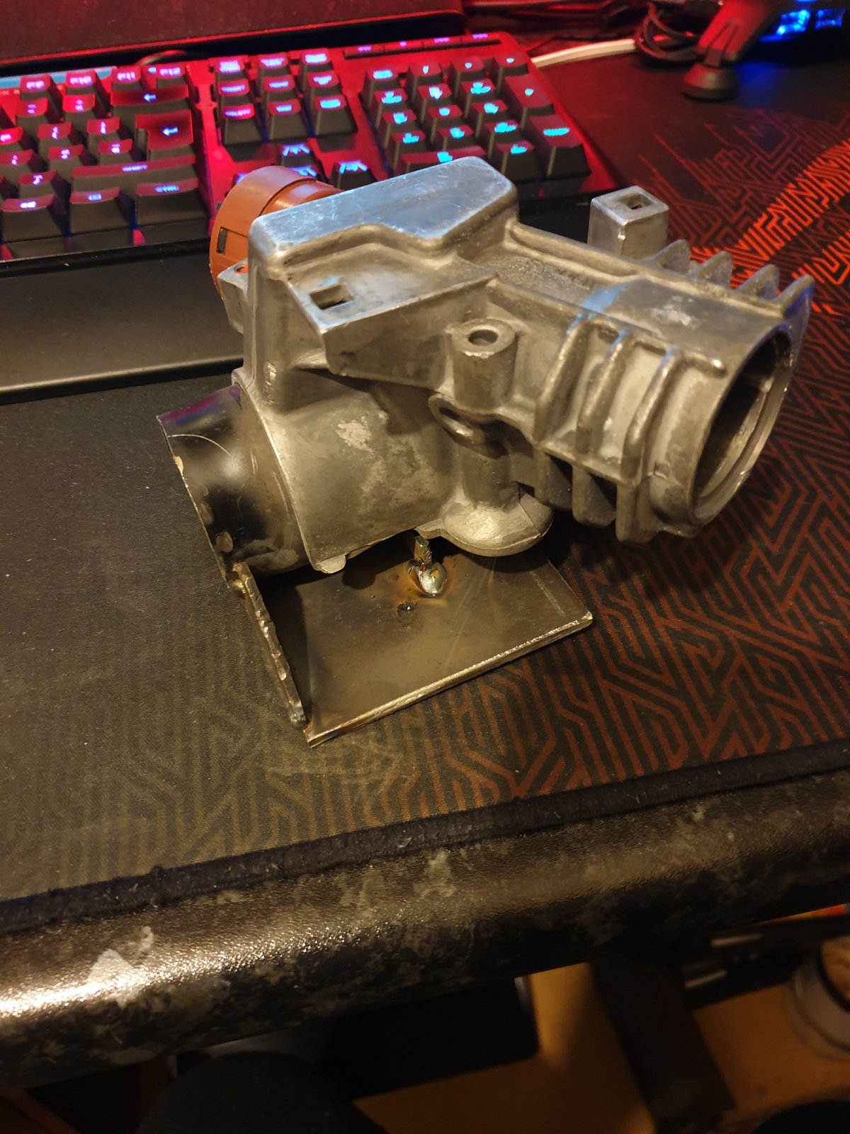

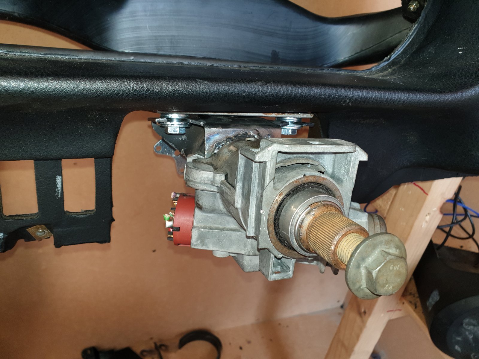

    so it been a crappy morning, I don't have an argon regulator for the weld so I've not got a lot done
    here is some progress on the steering column though
    I started by cutting down the steering column as there's not a lot of room behind the dash,
    and then i relocated the mounting bracket
    welded it up with CO2 but ive runnig on fumes so im going to make a trim in the next 10 minutes to get what i need,
    also made a phone cal for custom bearings as in pic below
    i need the inter shaft stable and atm it wobbles around alot so ive rang and waiting for a price for a bearing you can see where ill be fitting it
    and here is it sort of moked up
    im going to make a peice on the lathe to insert in the inner shaft of the steering colume to connect to the MIGE motor but ill have to go to my brother workshop to do that as trhe lathe is there
    thats all ive got im working on it more updates to come tonight but i thought id keep you updated,
    im off to the shops to get me a argon regulator and then i vcan get back and get on

    right, so I got my argon regulator,
    but betime I had mccys and got back it was dark so I could do anything
    anyway, I found a good way of connecting the MIGE motor to the column,
    welding and the lathe is required so I can get on with that tomorrow

    WOW, what a day,
    so I think I'll jump straight into the pictures as a lot has happened
    first, I got to the lathe and had this made for me,
    it's press-fitted into the 6 bolt to 4 bolt plate that came with the SIMRACINGBAY's MIGE motor
    It'll be TIG welded to ensure perfect alignment I've never TIG welded so ill get my brother to so that,
    here is it on the steering shaft
    this shaft needs to be shortened but you'll see that later
    this is a picture of it in the steering column housing it needs shortening and I have done that but needed to get the motor mounted to find out how much shorter it needed to be you'll see that later,

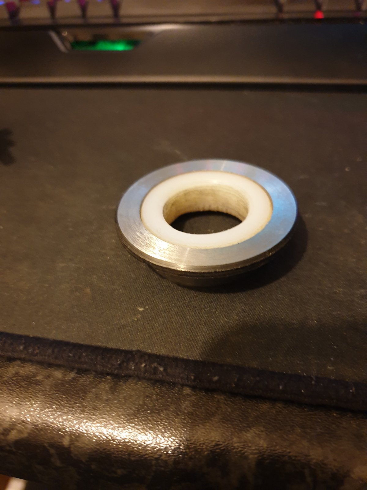

    I'm in the processing of having a bearing made to go between the smaller shaft to the black housing of the column as there isn't one there due to the way the column was made for the BMW E36
    so then I when on to making a support for the above column to fit behind the dashboard
    here are the end pieces that screw to the shed walls
    here is what it'll weld to
    so I got the Argon installed and this is the first time I've welded with argon in 5 years and I don't think I did too bad, soon picked it back up
    this is the complete support
    then I went on to fit it behind the dash
    as you can see there is nothing for the column to attach too
    so I measured and made a plate to weld on for the column to mount too
    here is the column in place
    I'm not happy with the bracket that came with the steering column that I moved so I'm thinking of making a plate and cutting the old what up to make it fit better
    so I then needed to make a MOTOR mount that is strong enough to bolt to the shed walls and support the weight and use of the motor
    here is a couple of photos of me making it
    as you can see I stupidly self the polystyrene on the floor and yes I had a small fire in my workshop that was fun
    here is the final piece without holes for bolts and screws and fresh from the welding bench
    so then I had to lift this heavy motor into place so first, I mounted the mounts that came with the motor
    and you can see the orientation the motor is going to be in
    here is the motor all mounted up..... not fun to lift it under the dashboard
    then I was worried about the cables up soon found I could turn the inside enough to clear the rear of the shed
    and finally I cut down the shaft for the steering column and here you can also see how it's going to come together

    Hey so I’m in hospital I’ve had my operation on my arm all went well, they say I’ll be 3 to 4 weeks before I can get back working outside and going to the gym,
    Tuesday when I was outside I did have a worry about the strength of the mount for the motor so I desired to make a bolt system so it also mounts to the cross brace that the steering column is going to mount to
    F3DD916B-08FF-4961-861E-EBFDA049AB65.jpeg 3CCDF32F-7664-4F6E-80D0-46DADF4E40C3.jpeg 1F64C4D5-C460-4600-9E44-A1EAB518A16D.jpeg
    So that’s It it feels stronger and looks it too
    I won’t be making an update for a while now so I’m sorry about that but I’ll be back in full spring soon enough

    so here's an unexpected update for you all
    I managed to get in the workshop and tweak a few things I wasn't happy with on the steering column I didn't do too much as I cant with my arm this soon after surgery
    so here is the new plate with beautiful welding from myself I'm very happy with it :)
    as you can see here I managed to remove the ignition lock without a key and ordered a new one from eBay and should come end of the month with ill be working in the Sim Shed again
    now the picture above you can see the round tube that the main column goes in and I did ring up to have a bearing made but turns out its an odd size (which I knew) but nothing could be turned down on the lathe they said to fit so my brother main this for me
    that fits on to the steering column shaft like so
    you can now see how it'll all go together
    and here's a picture of it all blown apart before it gets welded but it needs aligning first but can't do that for another 2 weeks so bare with me guys I will get back in there
    peace for now

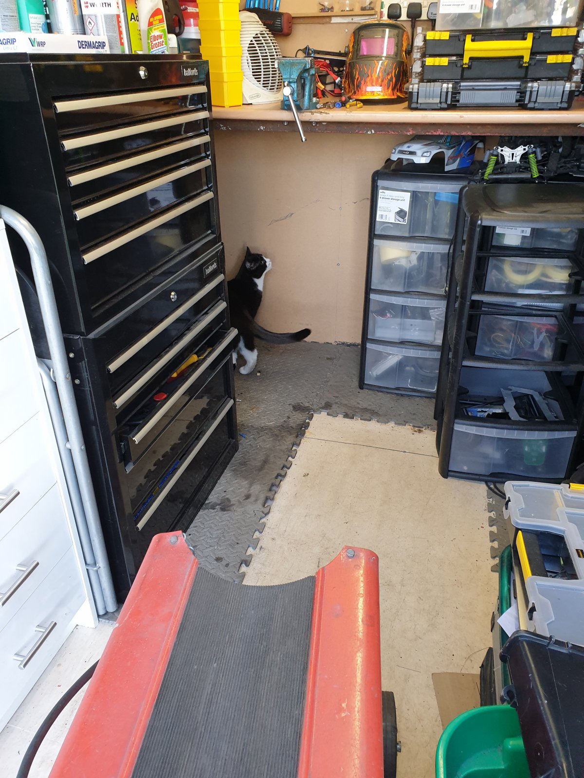

    so its been a while and my arm is recovered enough for me to start working on the sim rig again, I went out for the first time last week and remounted the might motor,
    the doctor told me not to do too much so I haven't, I've mainly been in the workshop tidying and organizing it all,
    ive sadly let go of a 23-Year-old friend yesterday
    my weld of 23 years was my dads before it was mine
    cat woundering where the welder is going
    but I got me a new toy in the post today and got it set up :)
    havntplayed with it yet as i need wire and the wire from the old machine went with it and forgot to order some more before this come,
    no i have hit a little problem with working for about a week i drilled a brand new sharp 11mm drive bit in to my hand and had to go to A and E to have it X-rayed and stitched up, silly bugger I was holding the piece i was drilling i should know better been doing this sort of work for years now, vise next time, and if anyone wants to know yes I did the hole drilled lol
    so ill be off for another week but still in the workshop playing with the bits and bob just not big stuff in the sim shed
    peace
