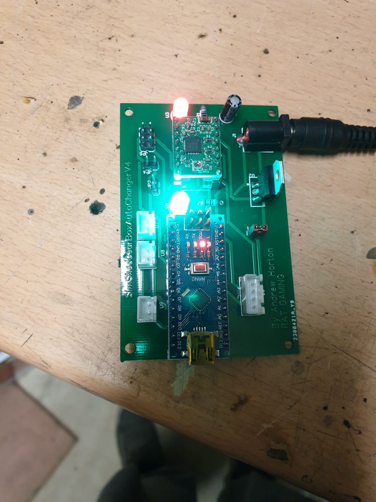

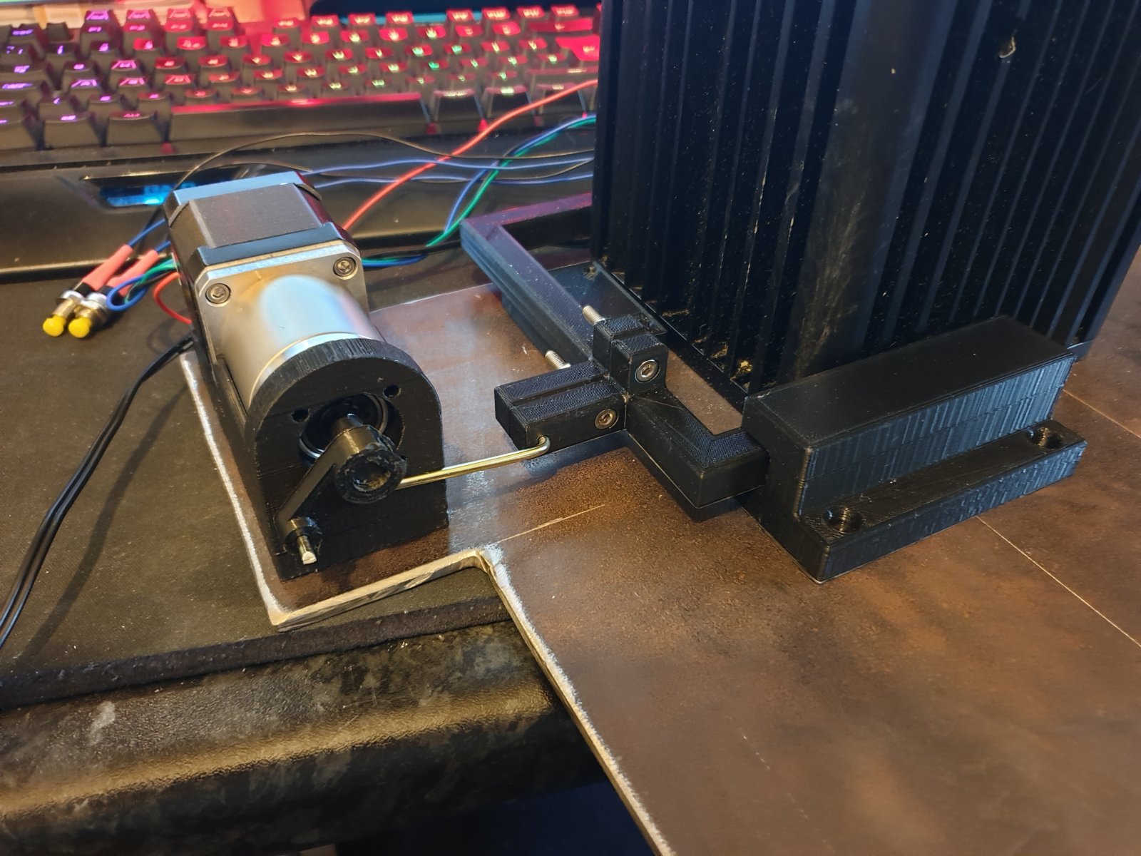

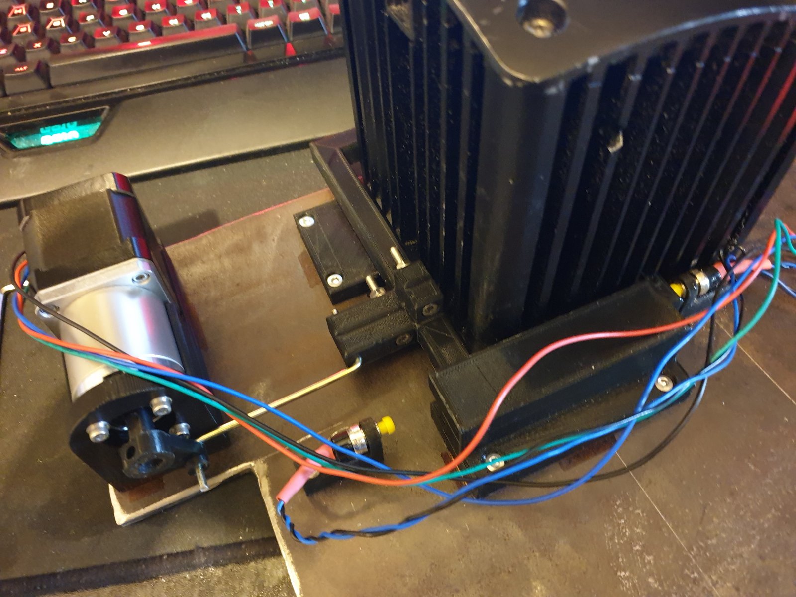

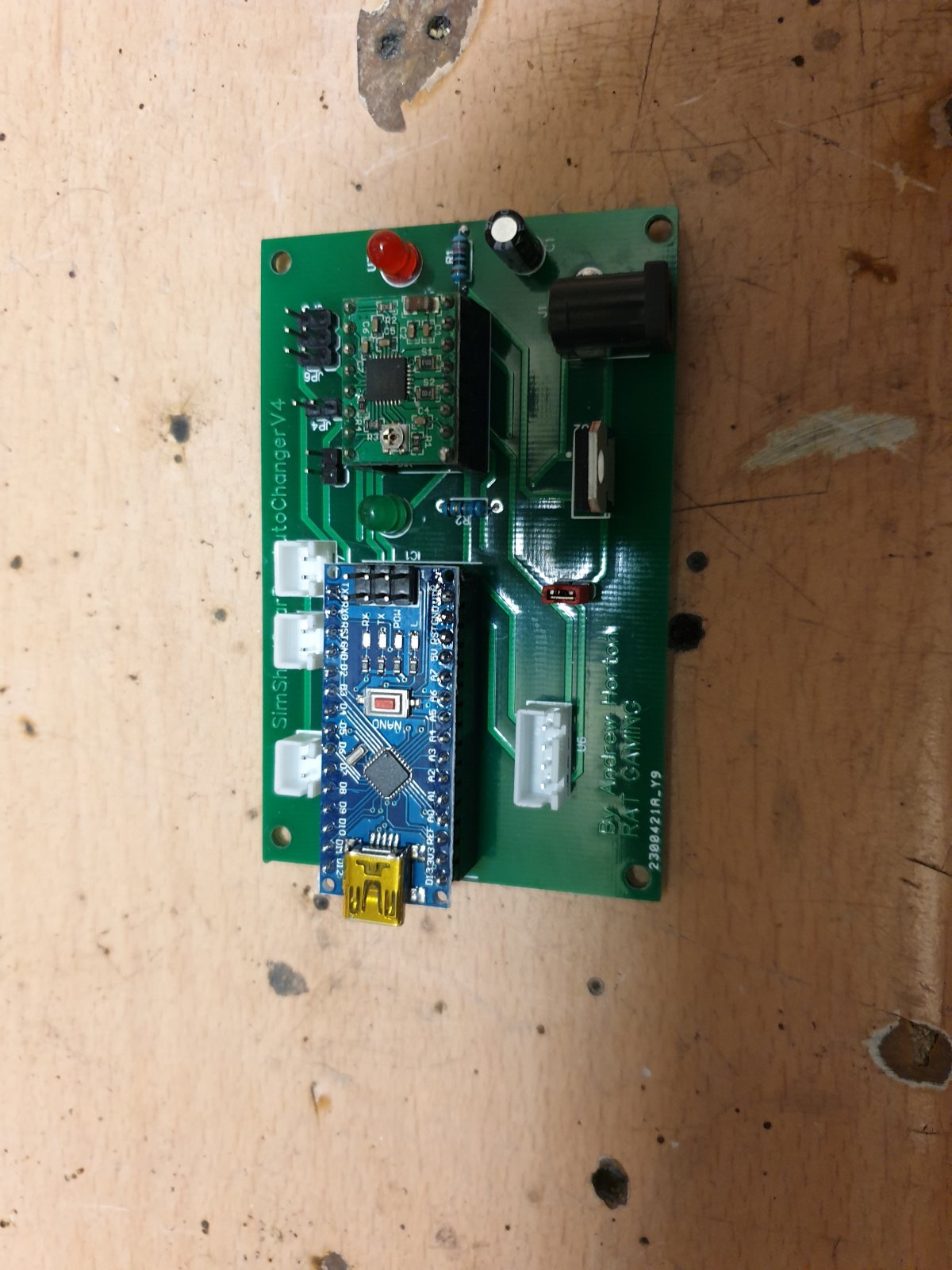

    hey all been a long time, not been too well with all my health and what not,
    but id like to show you a part of the sim that is pretty much complete apart from a printed circuit board I'm waiting for from China,
    been wanted to have the fanatec Clubsport shift be able to automatically change from h pattern to sequential from a flick of a switch
    and improved to show you what I've been working on the past 3 weeks,
    a lot of coding and problems with coding to solve and 3d printing to go wrong but I finally got it perfect

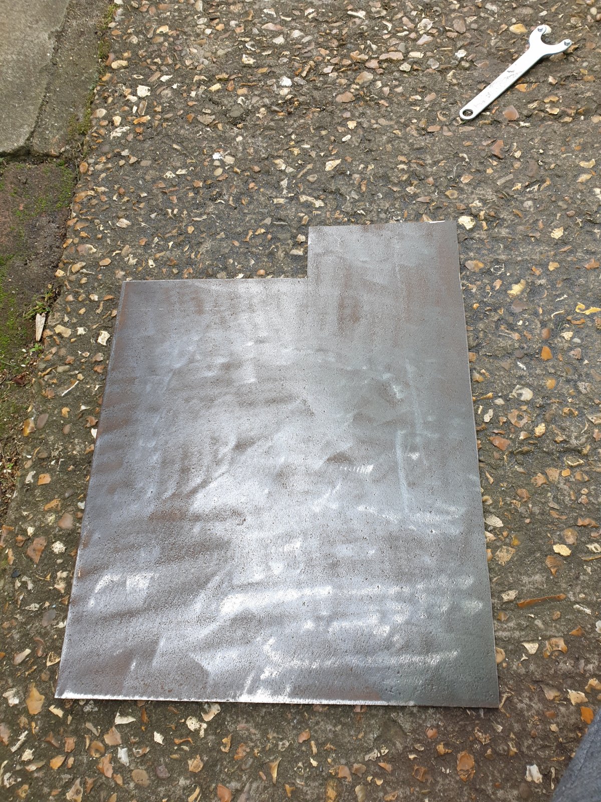

    here is the plate on which everything sits on it'll also reinforce the shift if I'm pulling and shift too hard,
    I then went about 3d printing things but haven't taken that many photos so here is the basic setup
    with the motor mounted it was time for the electronics

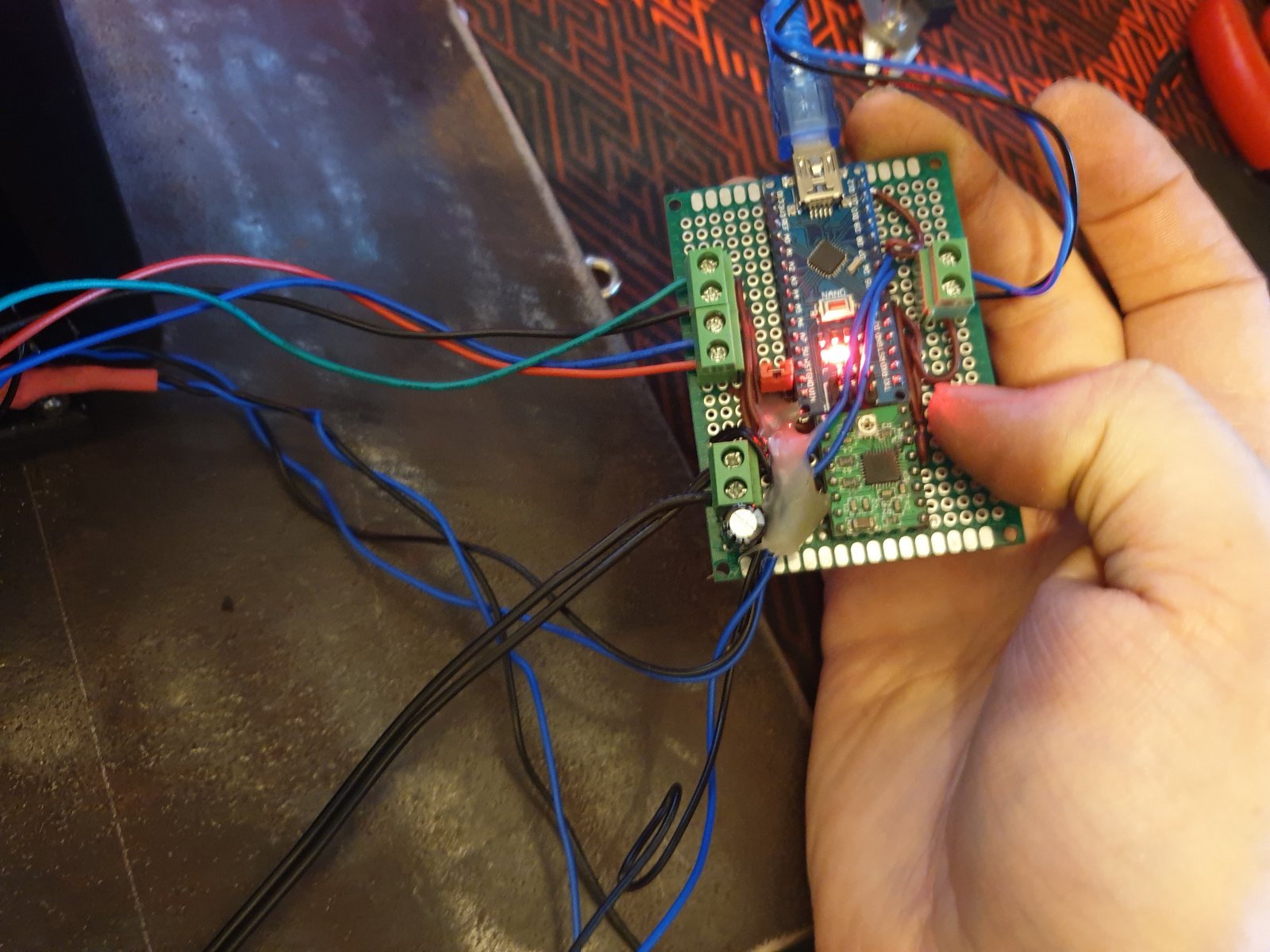

    I have made and ordered a custom PCB print professional from jlcpcb so ill post pics when it comes in about a week or 2
    and final here a video of it working ignore the vibrating sound that's interferants or something in the PCB and hopefully a PCB from jlcpcb with work a lot better
    regards
    andy

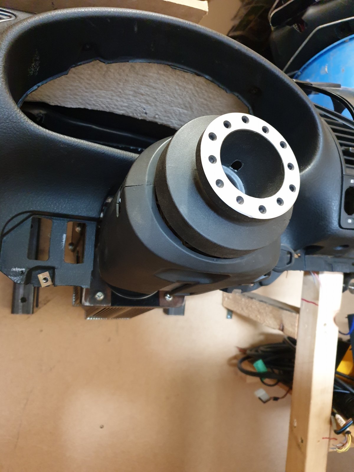

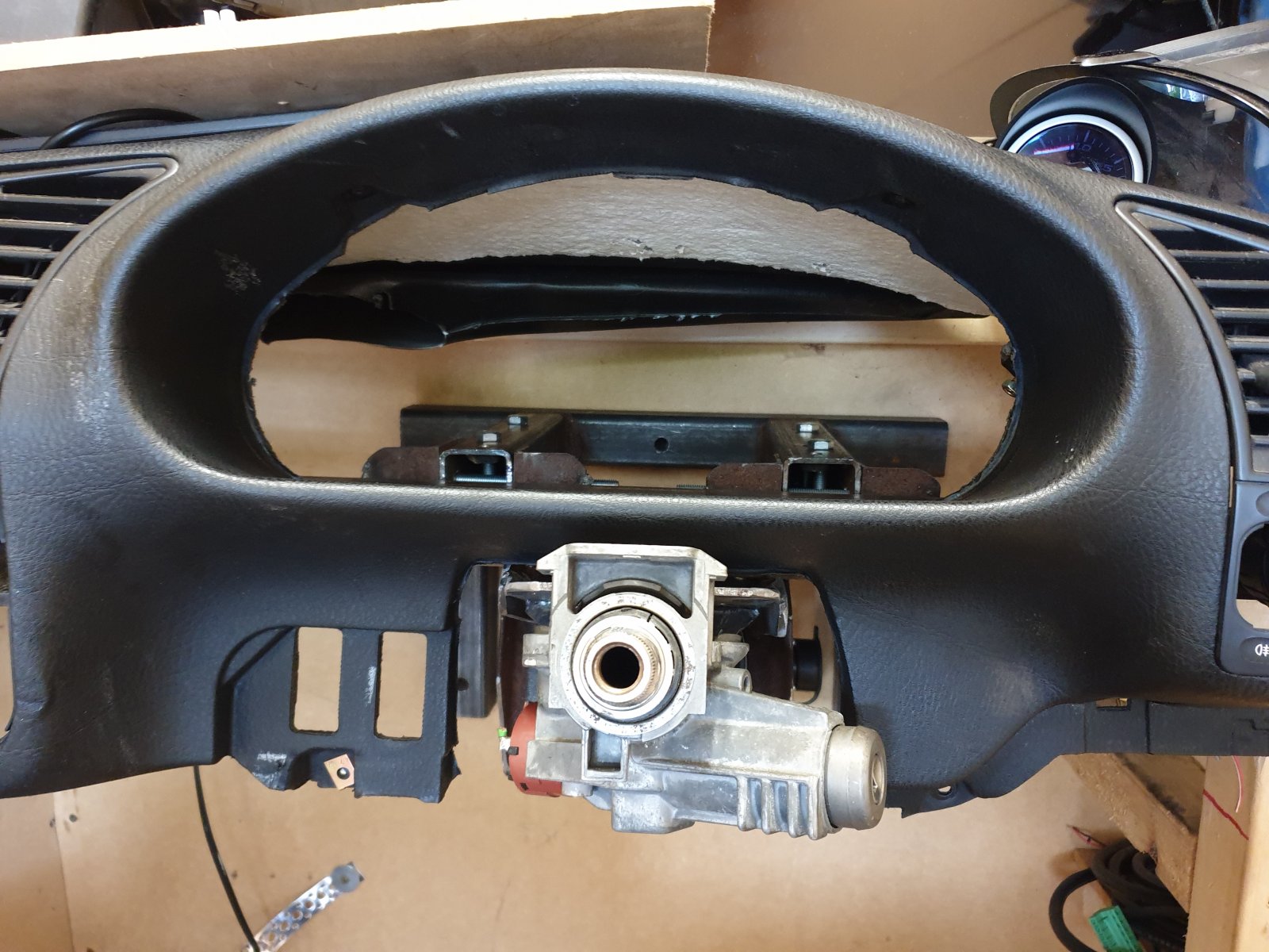

    Hey, all long time no see,
    my mental health hasn't been great for a while, been down in the dumps and not only that I nearly cut my finger off cutting some wood for a cupboard I was making :(
    but today I felt well for the first time it a while so I knuckled down and got in the sim shed

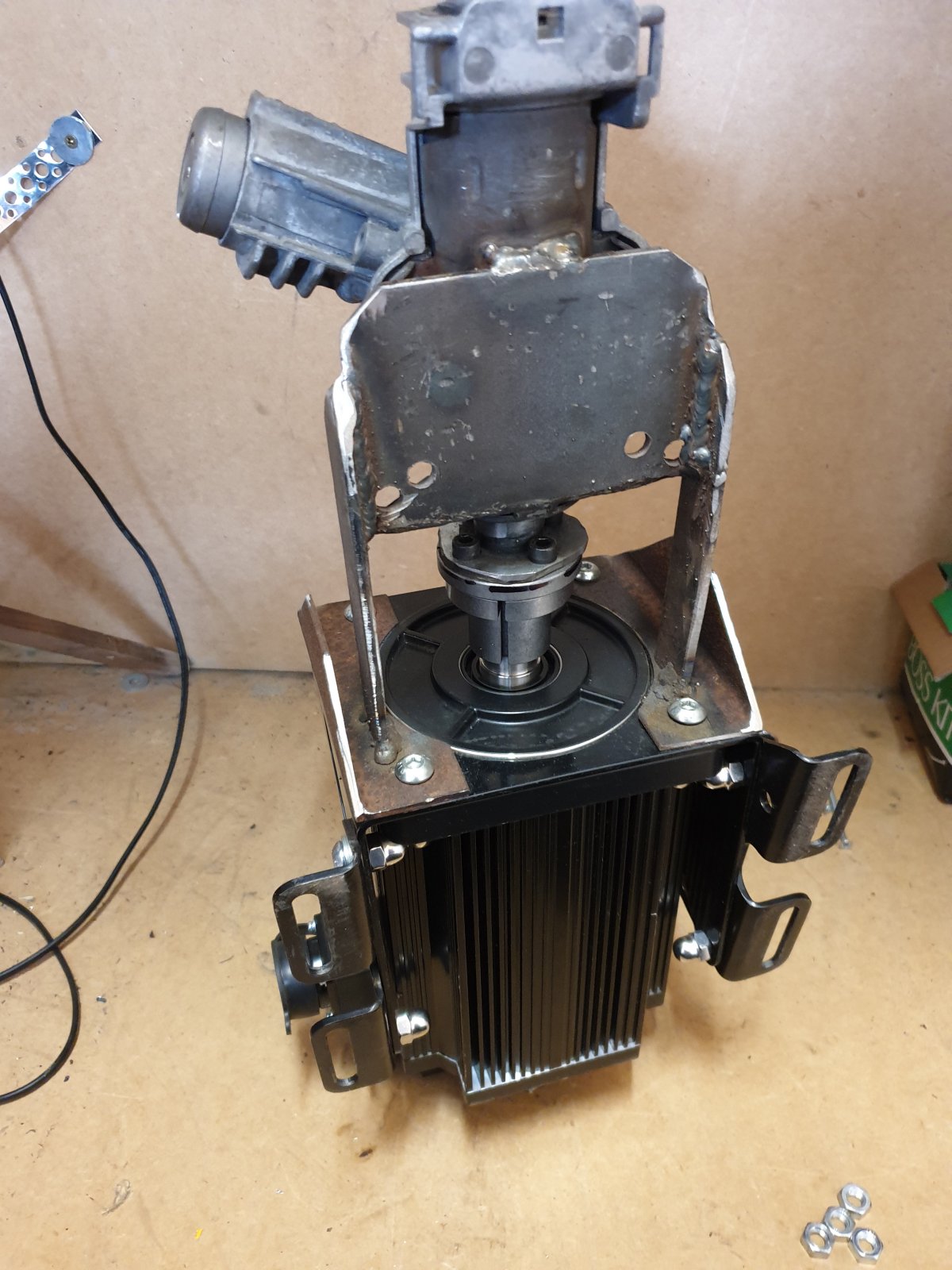

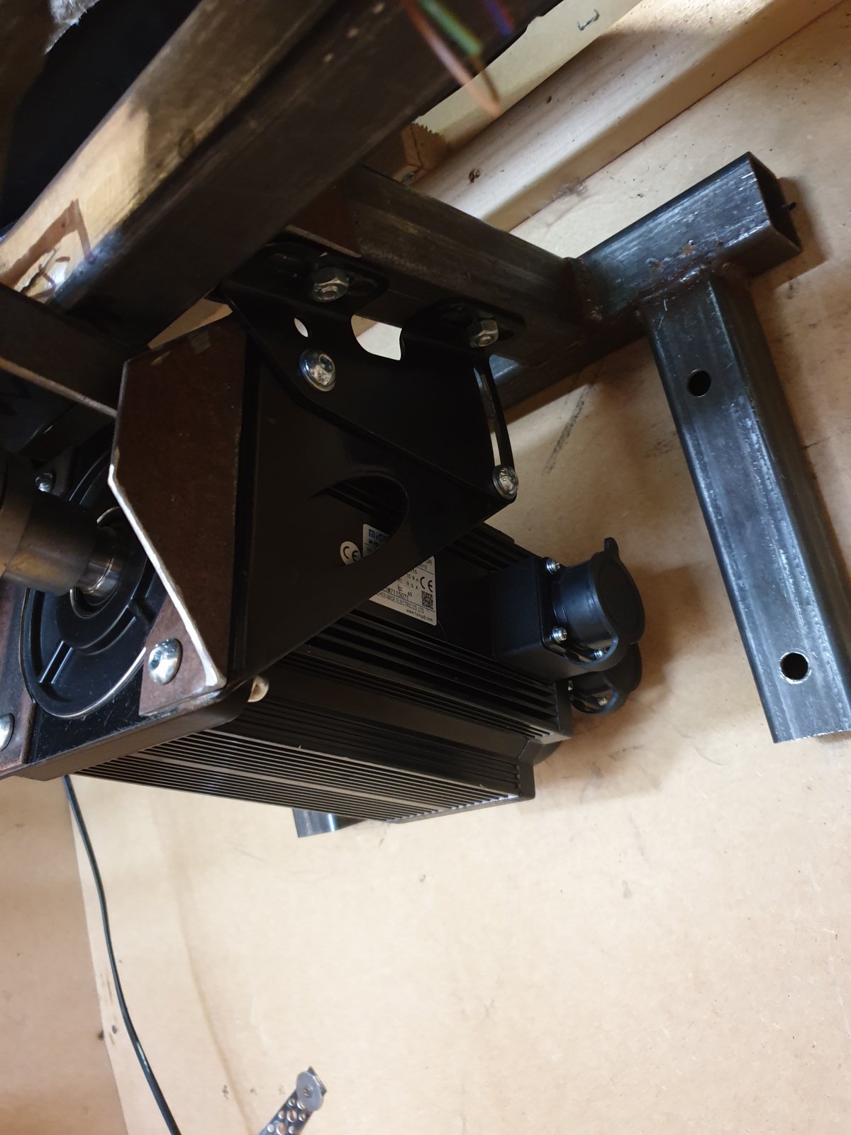

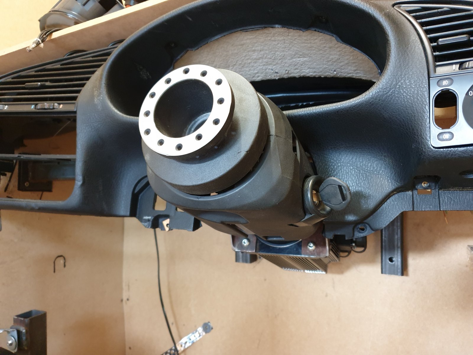

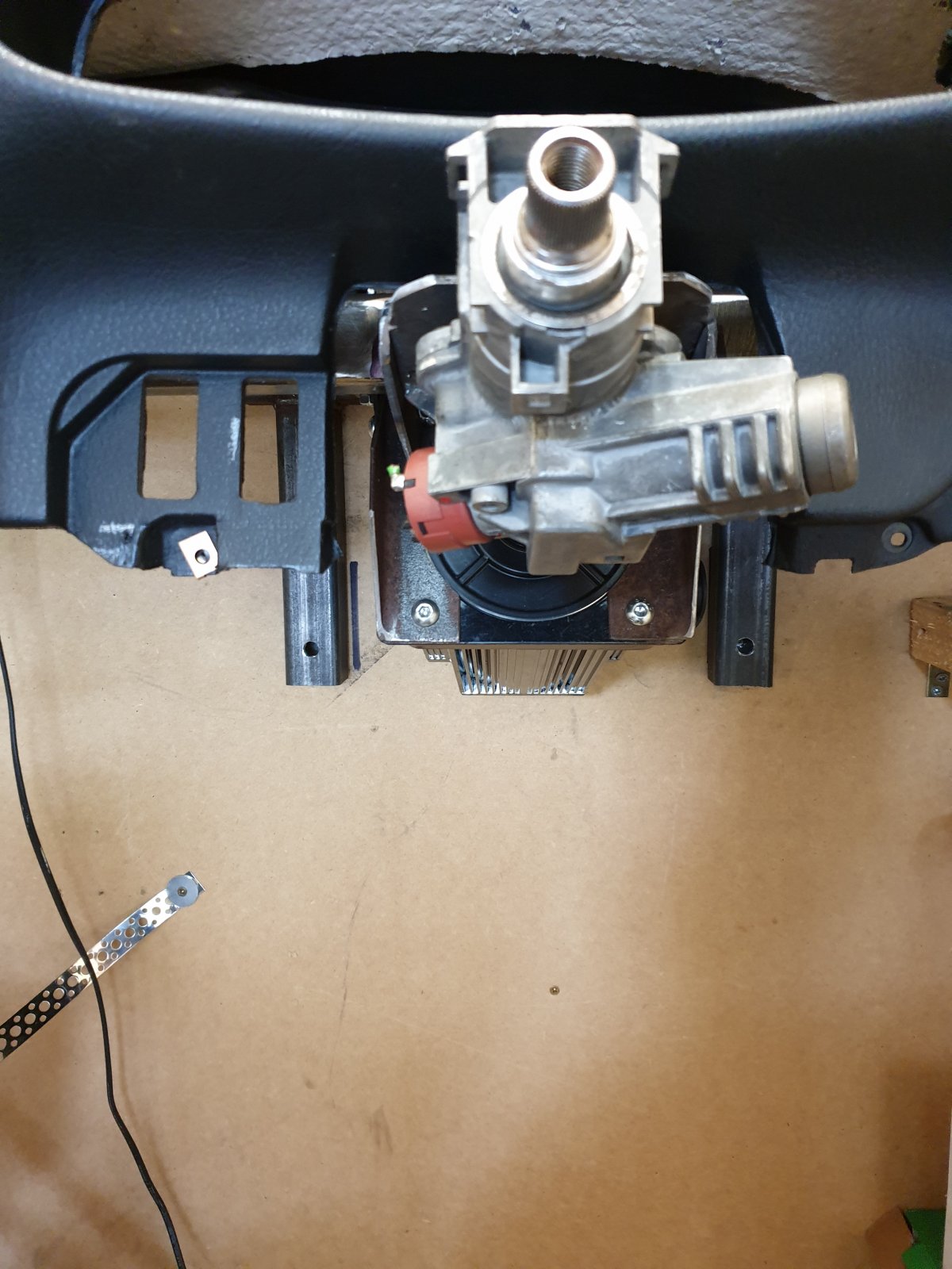

    if you go back and read page 2 about mounting the motor to the shed and the way I mounted the steering column too you'll see that the steering column and motor is mounted apart from each other well this didn't work too well as the motor was high enough and when it was all bolted down you couldn't turn the wheel as the steering column mounts locked the shaft the way it was mounted so not giving up I redesigned it all
    first, I welded the steering column directly to the motor ish, I fashion a bracket that bolts to the existing mount mounting bracket,
    its a bit shoddy and I could have done better but I had to start again 4 times on the bit because I kept getting it wrong, boy I was mad making this part

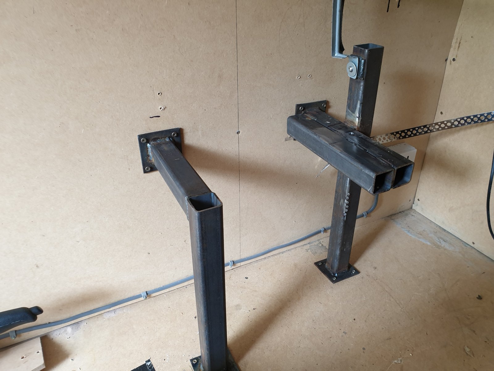

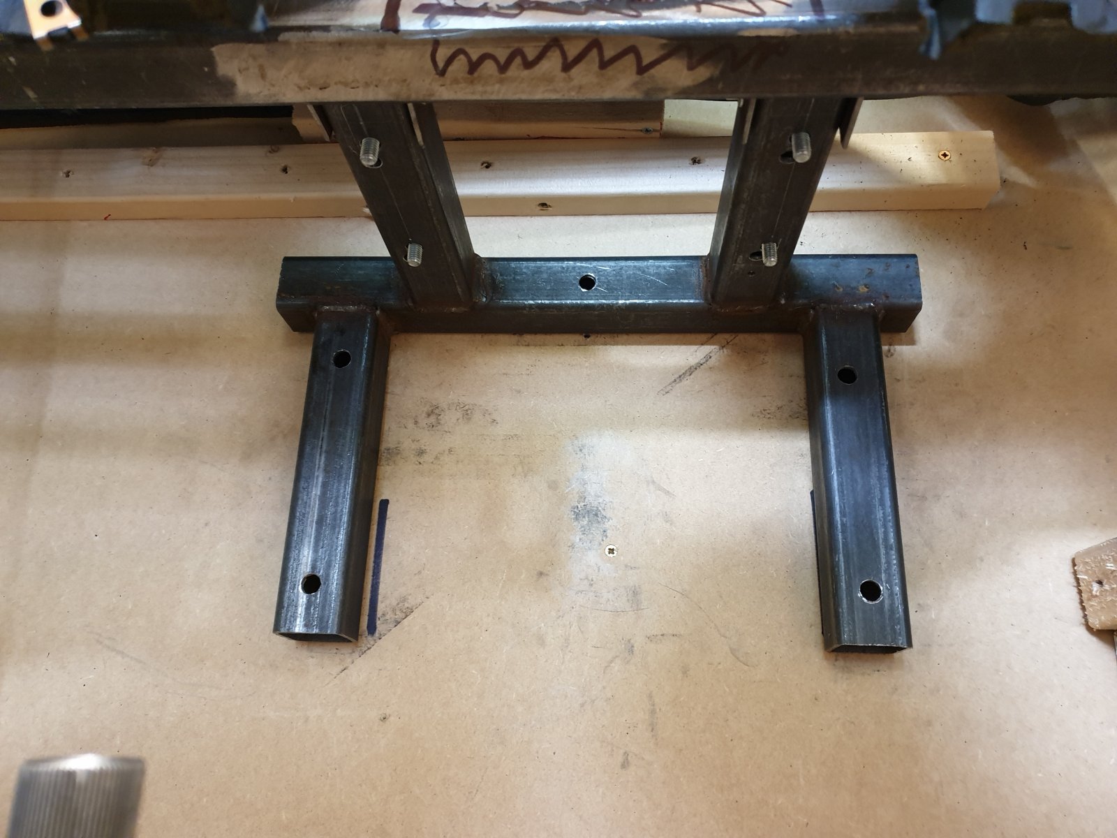

    anyway then I was time to fix the issue with the frame under the dash, the mounter needed to sit high under the dash without affecting the cluster that I will later be installing
    so here I came up with a different way of bolting the two half together
    much better, ignore the black marks the frame is level as.... well the spirit level I have lol

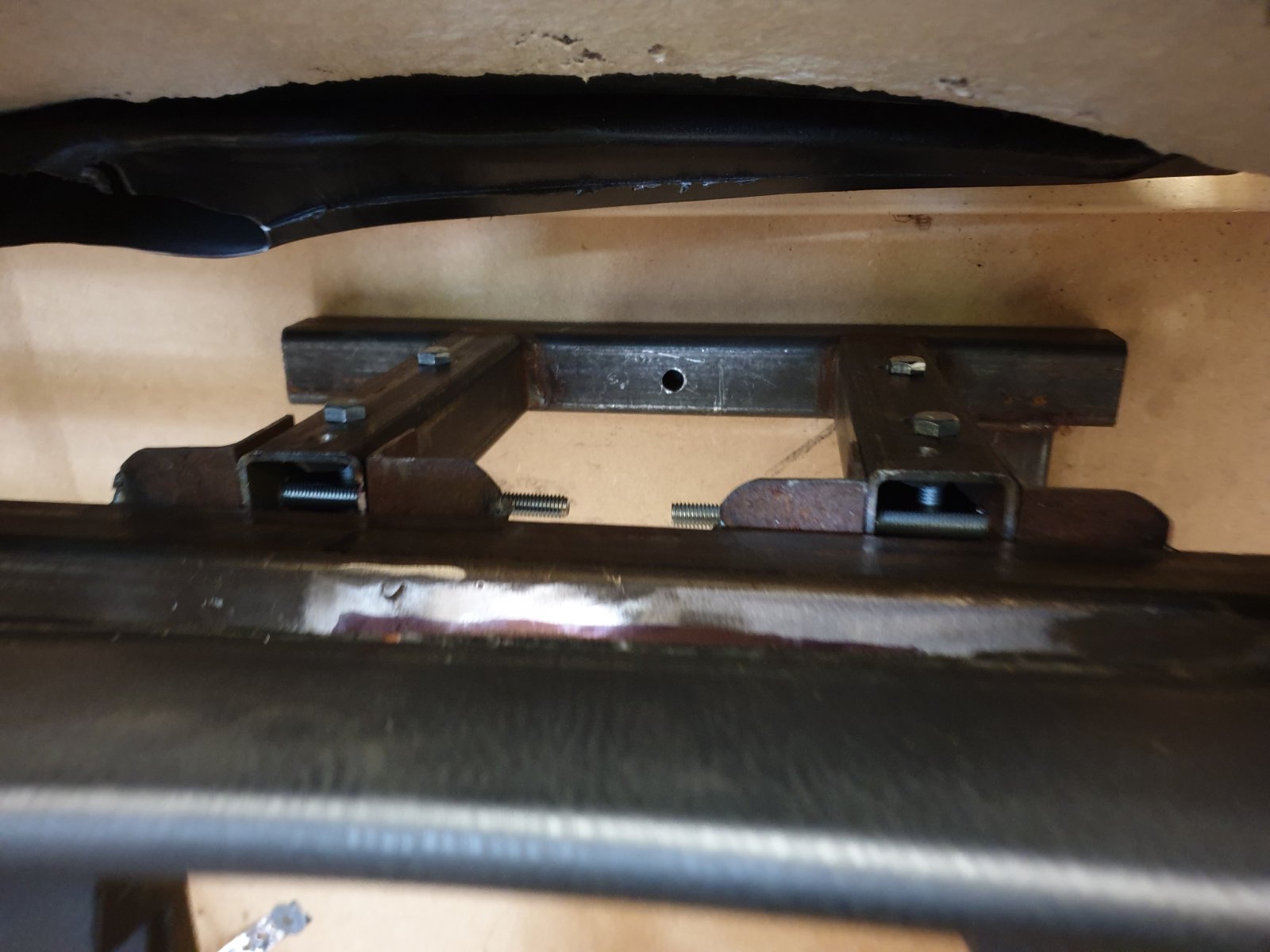

    then it was finally time to mount the mounter after test fits ( first fit was perfect so that when tack welds became the full welded thing)
    here is the motor in place

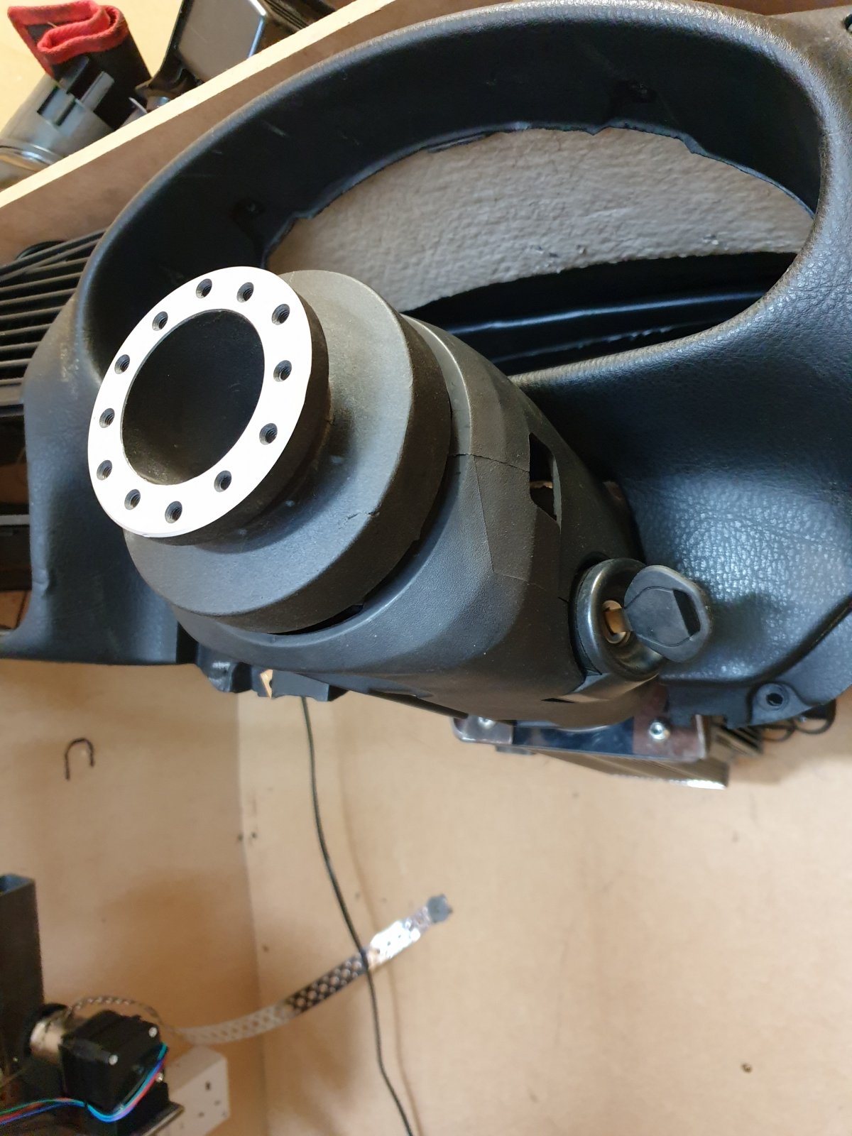

    now it was a case of installing the boss ready for the fanatec adaptor and steering wheels,
    I also installed the shroud to see what it would look like but I've still got to install and wire up the ignition switch and indicators and wiper levers to a control board to work with the game
    so that's it today its been a good day I feel good with what I've got done, it's been a long day and I'm knackered and dirty, so this bath and bed I think,

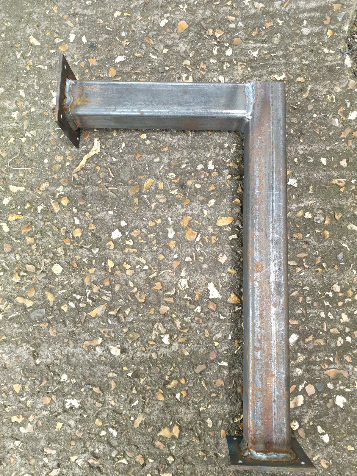

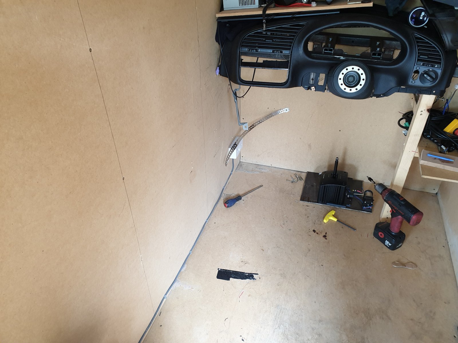

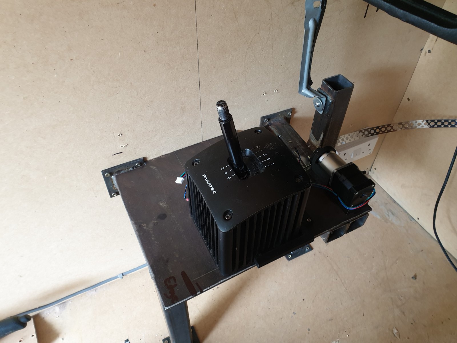

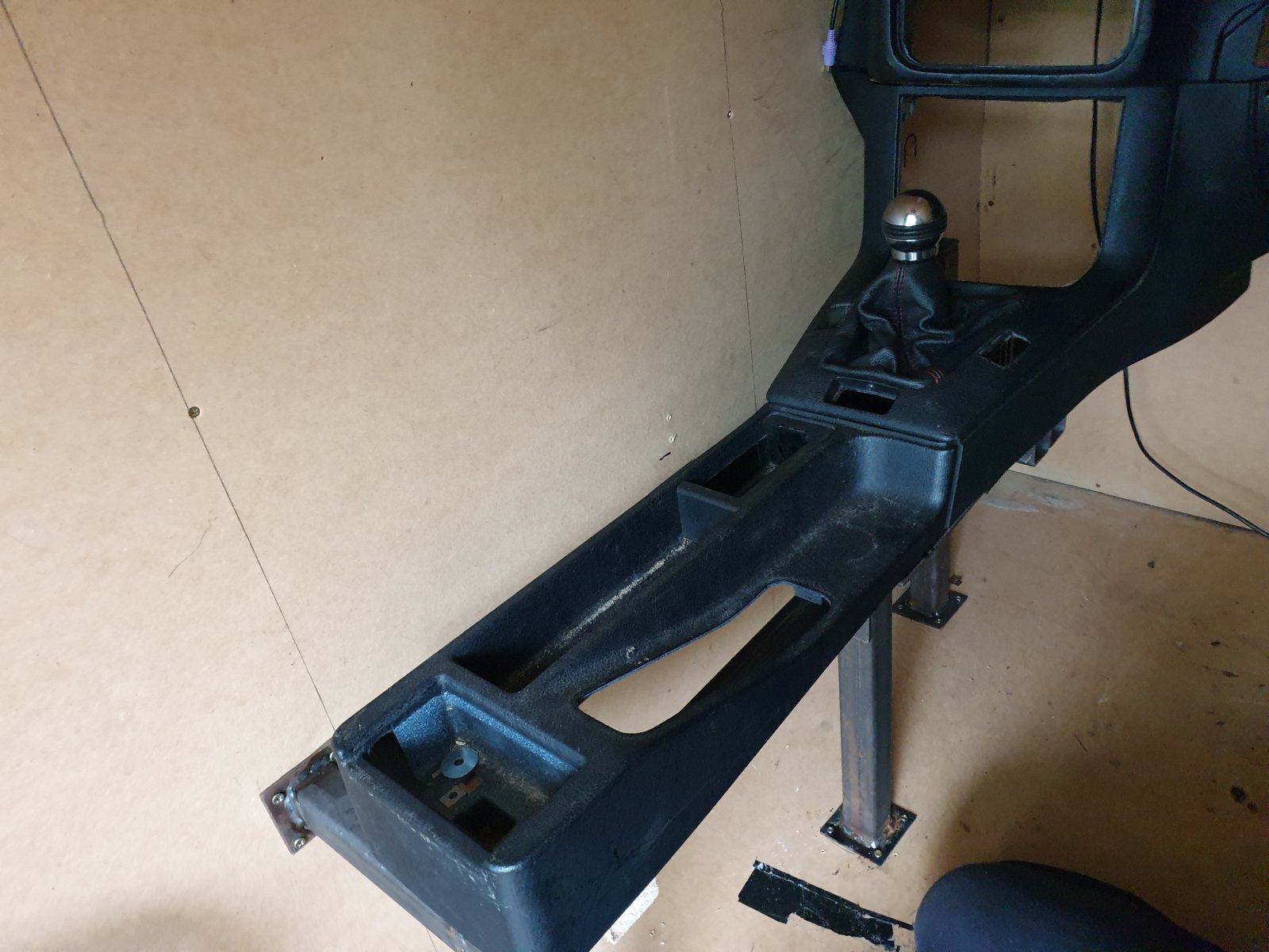

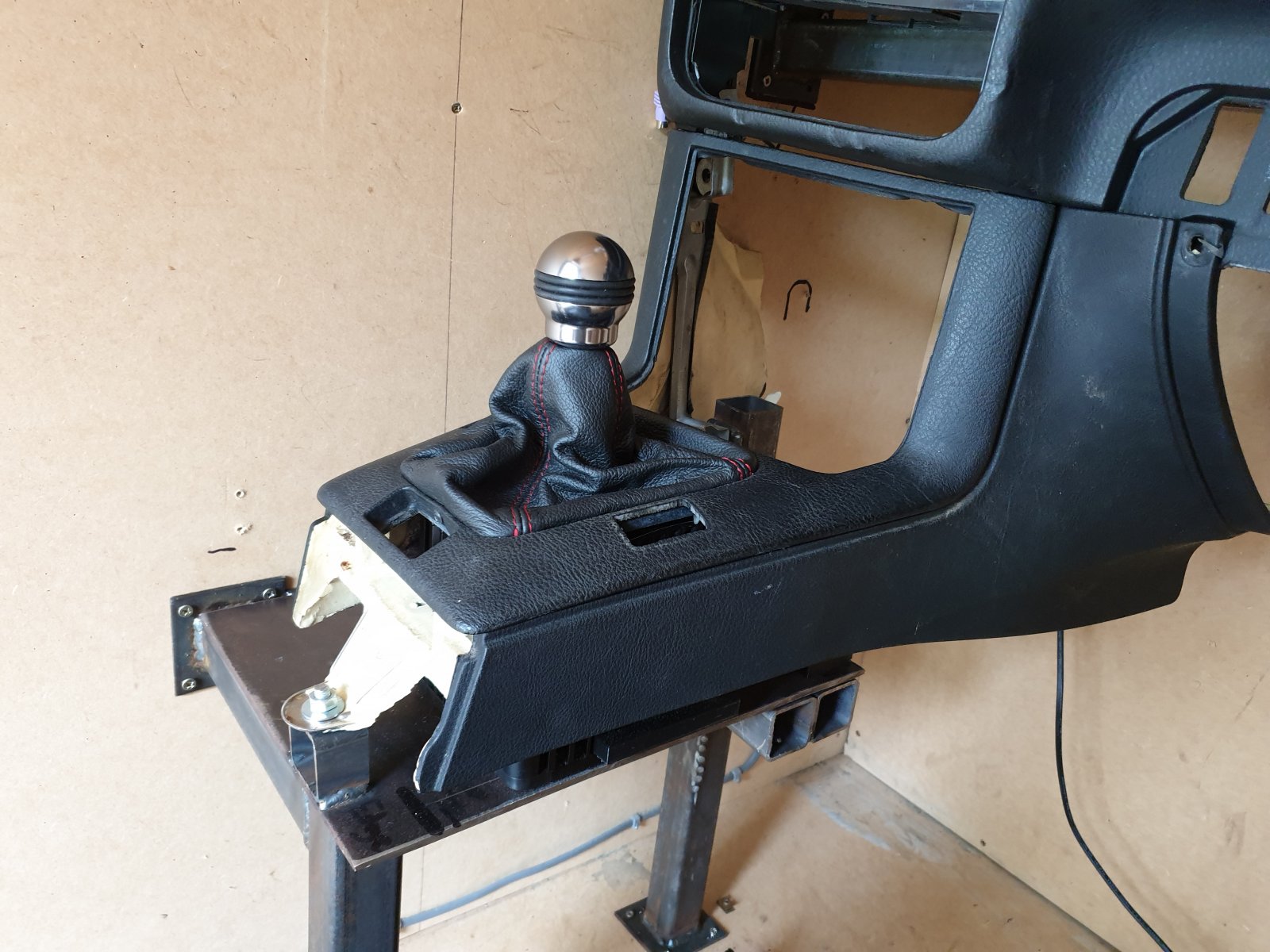

    right so another update for you guys, I'm getting on with it now, been a good day today,

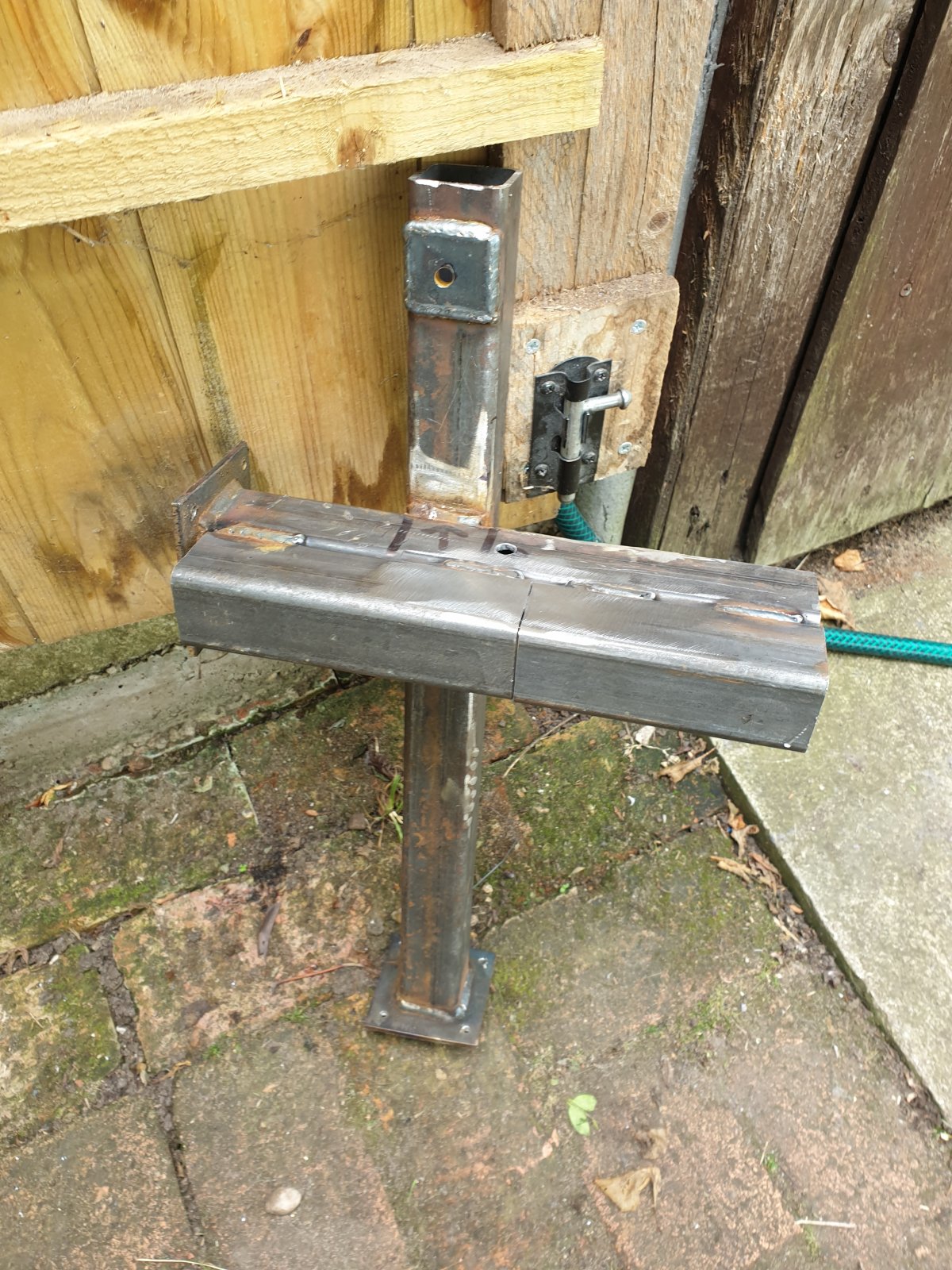

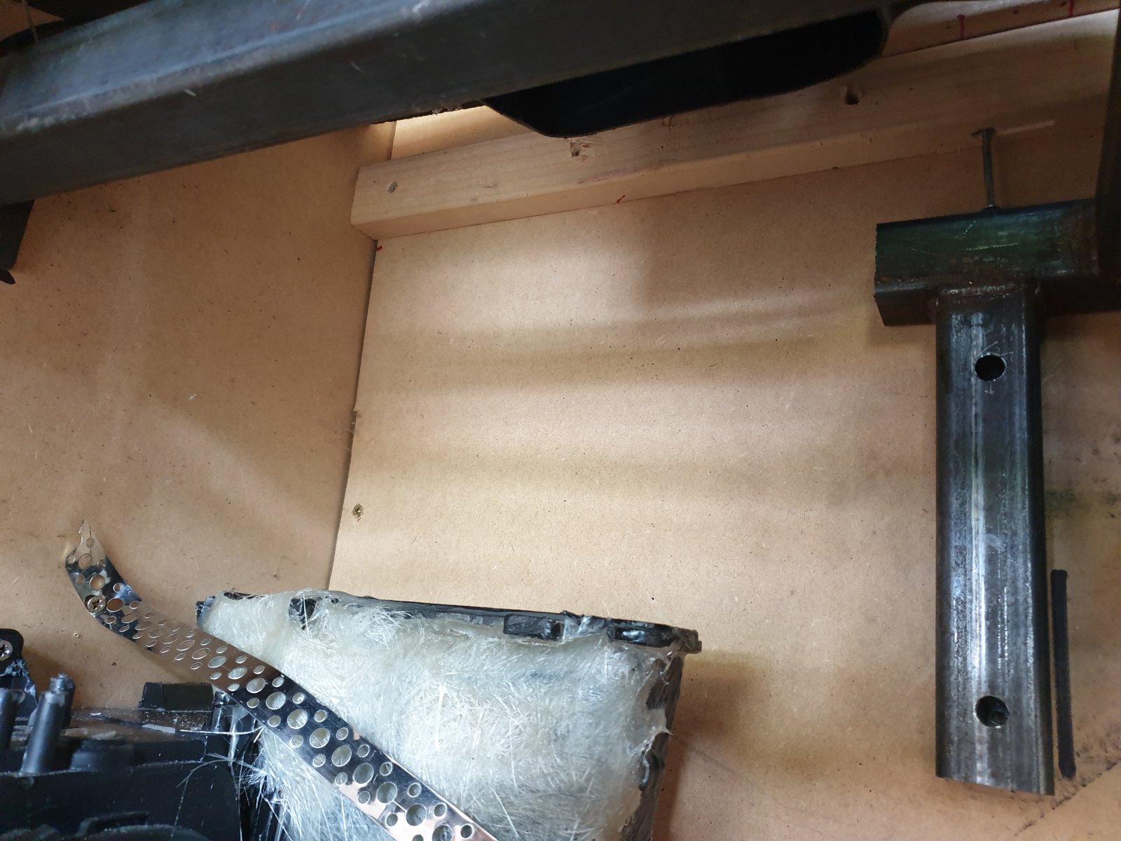

    started work on the gear changer mounting and handbrake mounting
    so first I removed all the temporary mounts made from wood as I now the sizes and places I need the steel mountings,
    then I had to make and fix the left-hand side dash support and front gear changer support, I had to add some extra 40mm box as when I did a test fit a few days ago I had the gear shifter forward 40mm and that was out of line to the boot for the gear shifter so I moved it back 40mm here's a picture on the extra 40 box added on
    then i made a second bracket for the gear changer
    and here it is mounted in the shed all level
    I then did a test fit to see what it was like
    then I put the center console in to then get the measurements for the handbrake surround, this is not the gear stick handle that ill use it's just what I had in the shed at the time the BMW one is in the office
    then I made up the handbrake mountings and here it is in place, got to order some new drill bits as some very hard stainless steel broke the bits I need to drill it with, and ill have to order some more mild steel as I've ran out of that and had to use the stainless steel and it wasn't ideal as it doesn't weld very well but it got the job done
    and here is the handbrake surround mocked up I still need to get some plate to mount the handbrake and the surround but it was getting late and I was very tired at that point
    so thats all I've done today I feel good with what I've got done, I'm home I can get out there on Wednesday after the gym

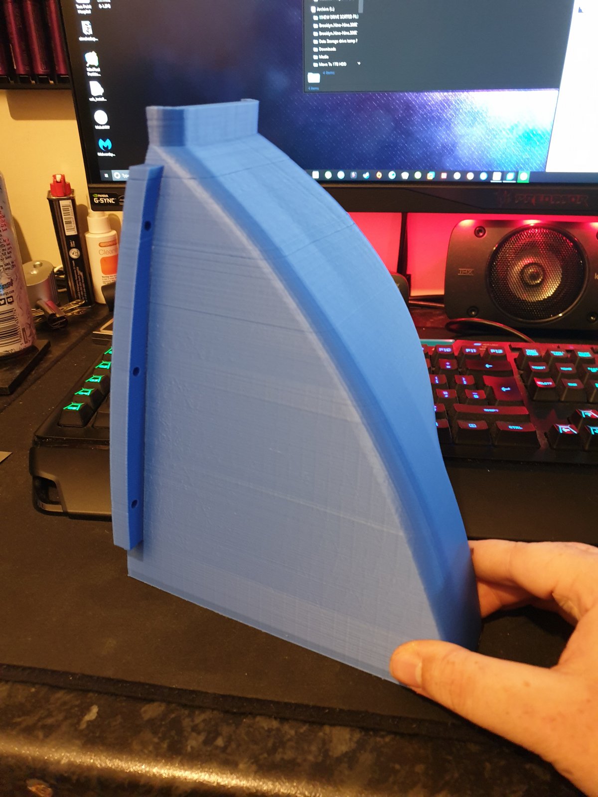

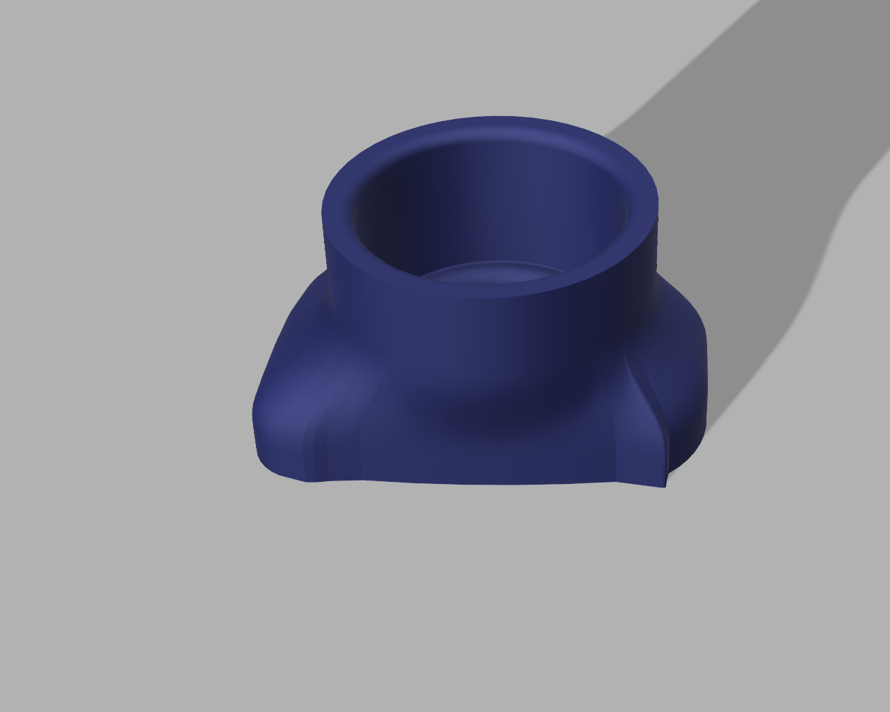

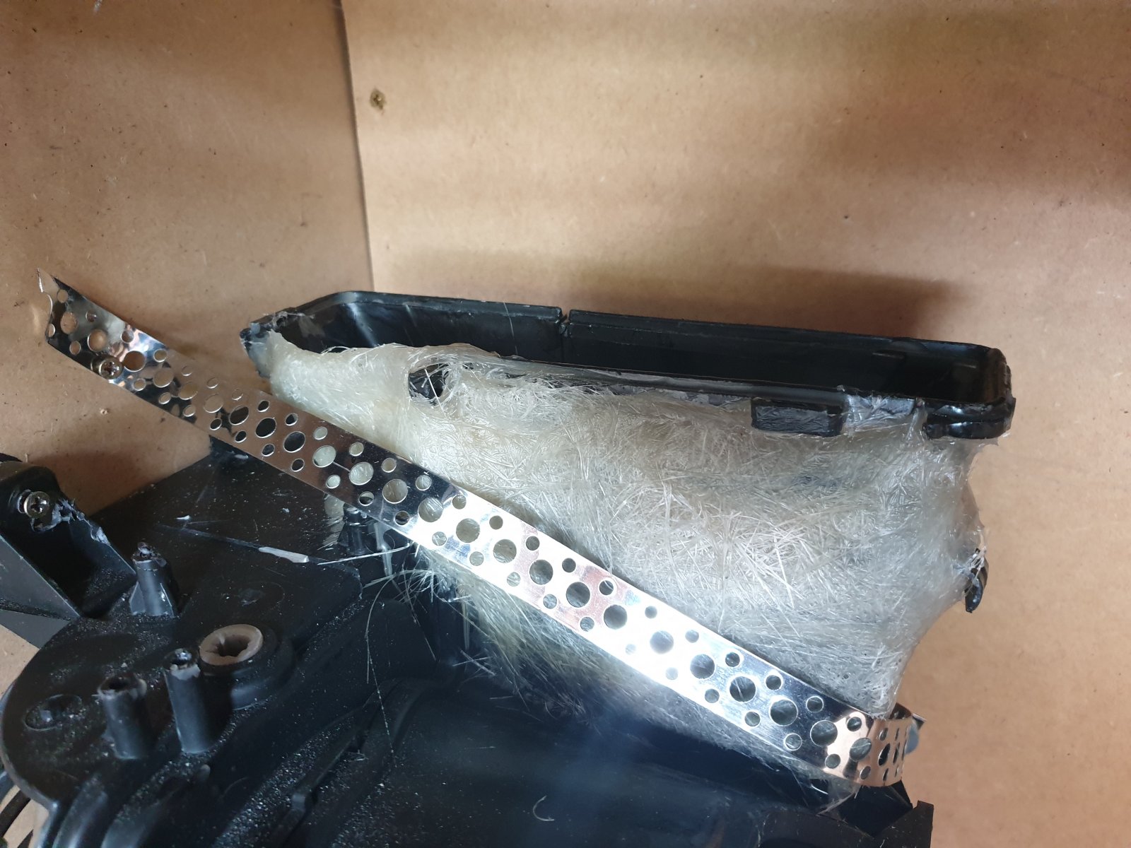

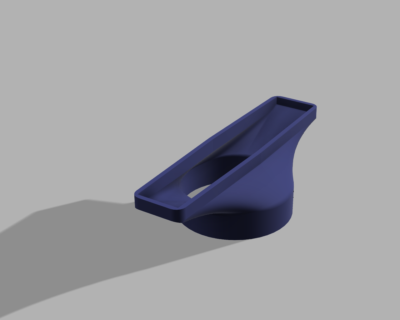

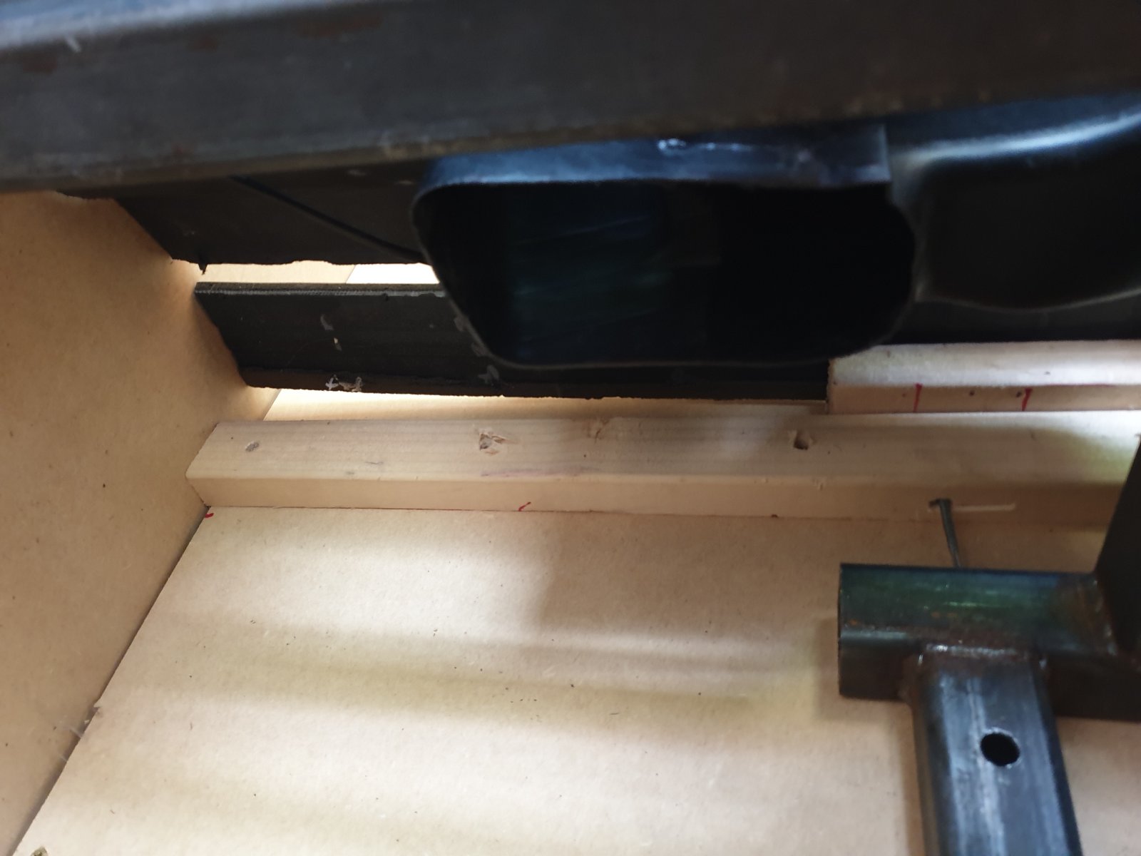

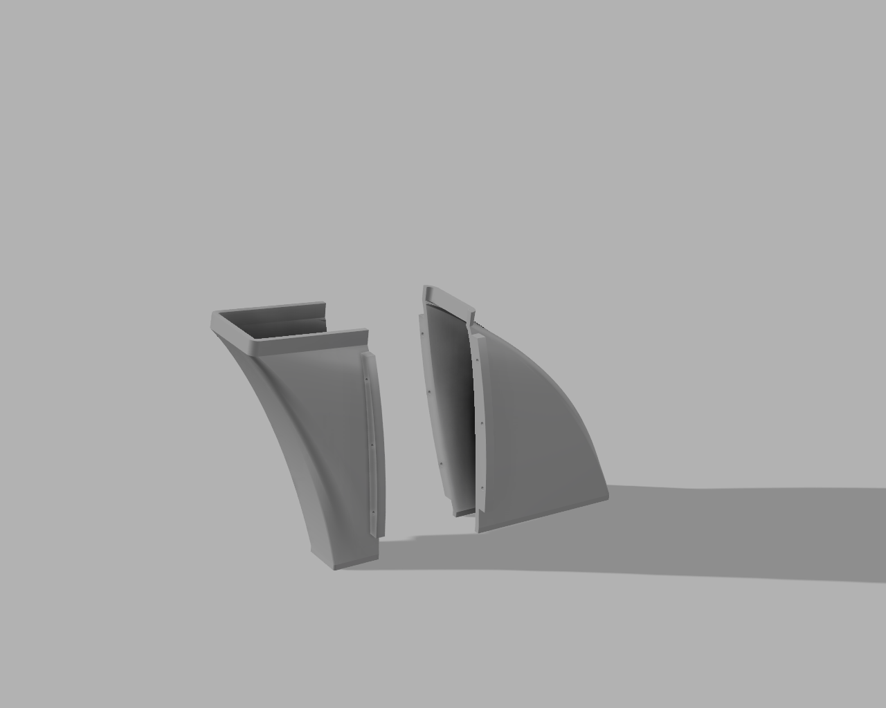

    right so Heres something for you, I originally had a fiberglass duct for the blower motor but it was fitting very with and it was scruffy so I've over-engineered the hell out of it and came up with this
    here is the current progress 1day 10 hours to print this half 2 and a half days for the other half
    here is where I'll be going its a ford blower motor as you may have seen in another post,
    this is the gap it has to bridge,
    not done a lot else as its been a bit of a birthday week I've been out and about eating out and seeing people
    hope you enjoy the pics and see you in the next update
    peace

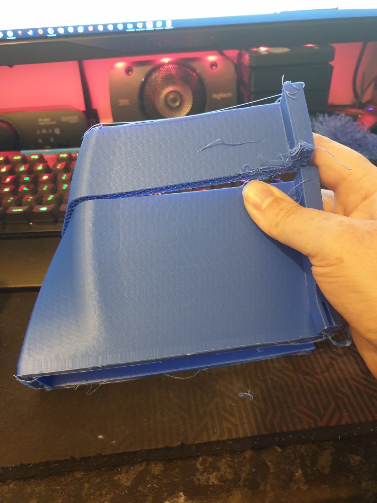

    well shite, it failed on me 23 hours in :(
    the supports broke 19 hours in so I thought id get away with carrying on but 4 hours later the extruder shifted of course and it buggered it
    I am beyond peed off,
    so adjusted the supports and hoping for the best
    this time it's a 19-hour print

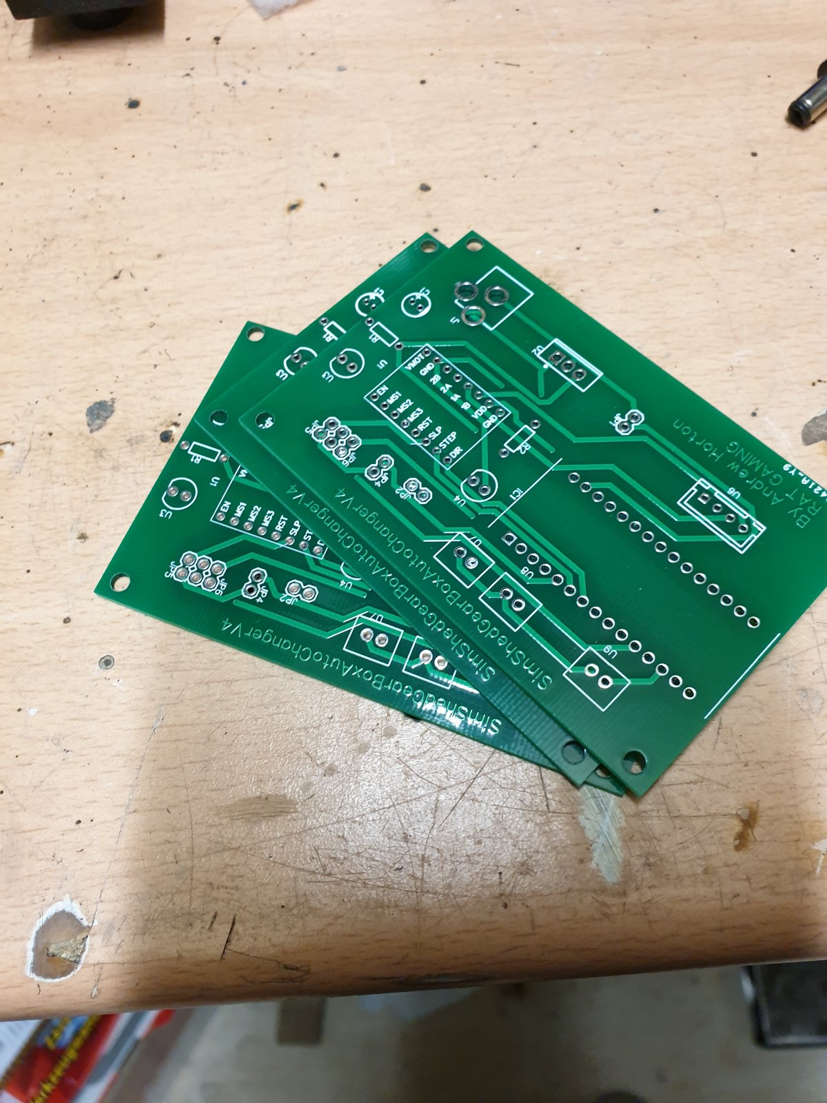

    right so got the first half and biggest print is done, its a bit rough near the end but I think it'll be fine
    also, I forgot to post an update on the gear changer,
    I had ordered a PCB from JCBPCB and here they are in all there glory
    then I had to populate the board
    if anyone wants one of these I'm sure I can sort something out maybe even a tutorial if anyone wants one, ill give the code and schematics and pics and STL files for the 3dprints

    ive 3d modeled some new ducts and ill be using some 100mm ducting you see on the tumble dryer
    you can tell basically how this is going to work

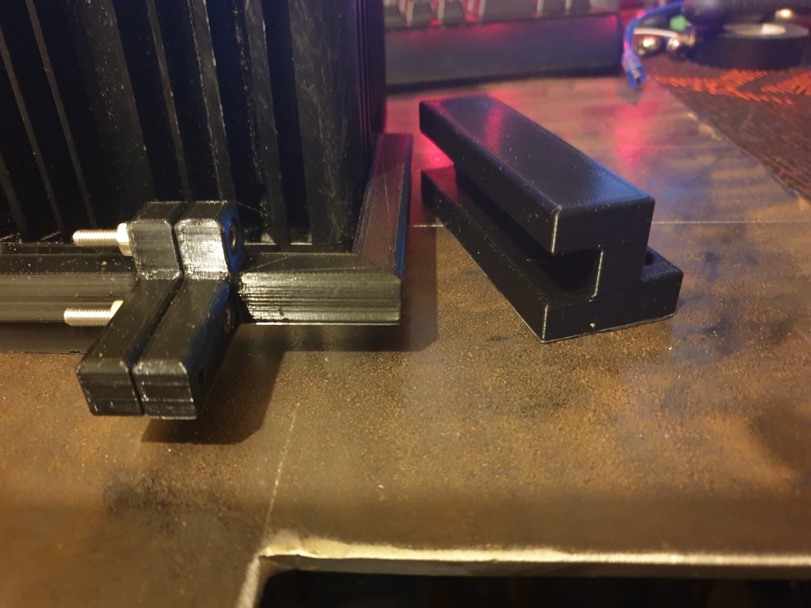

    I did, however, get the gear shifter part bolted down and the bolt put though on the handbrake frame,
