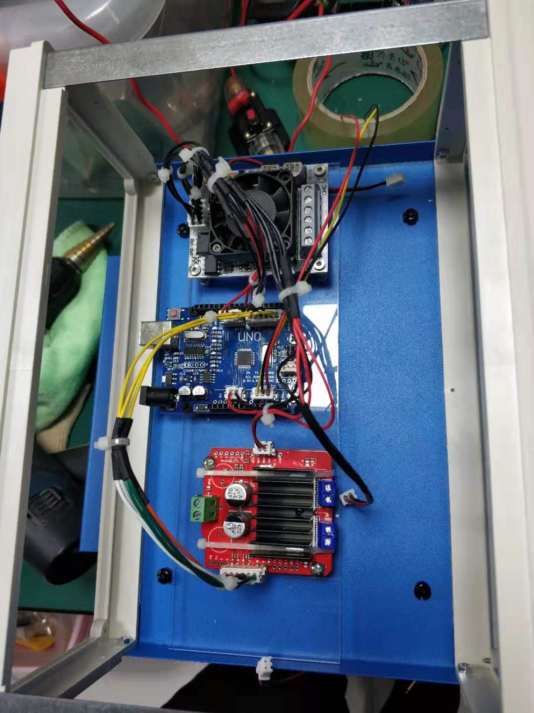

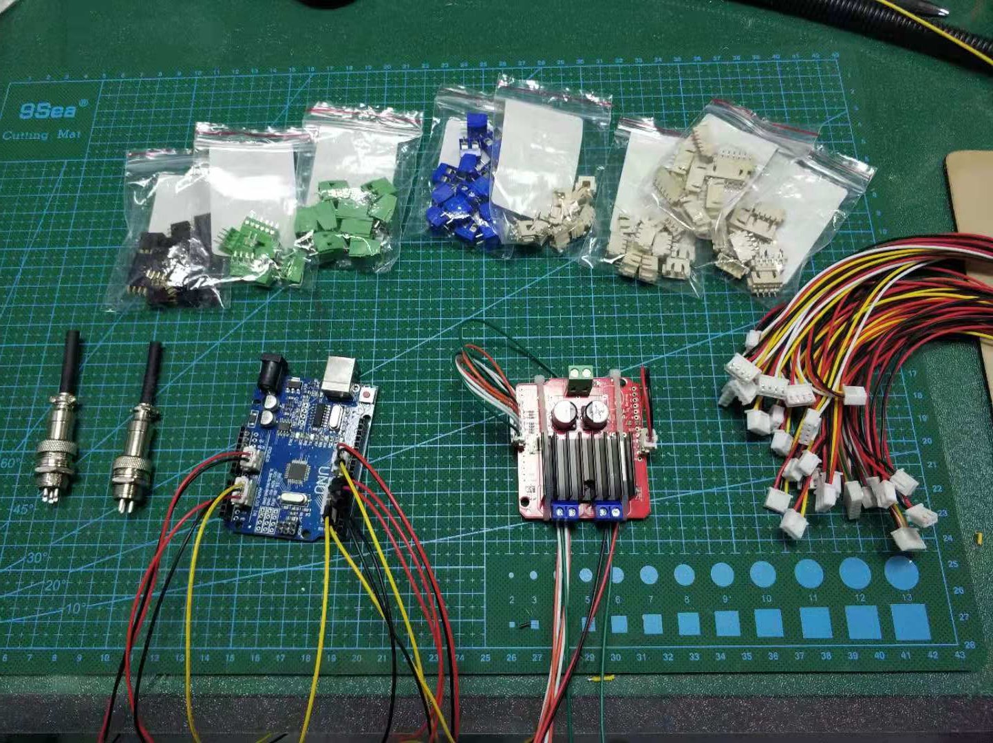

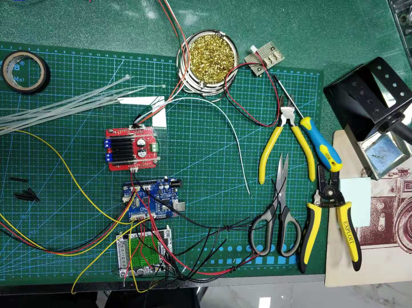

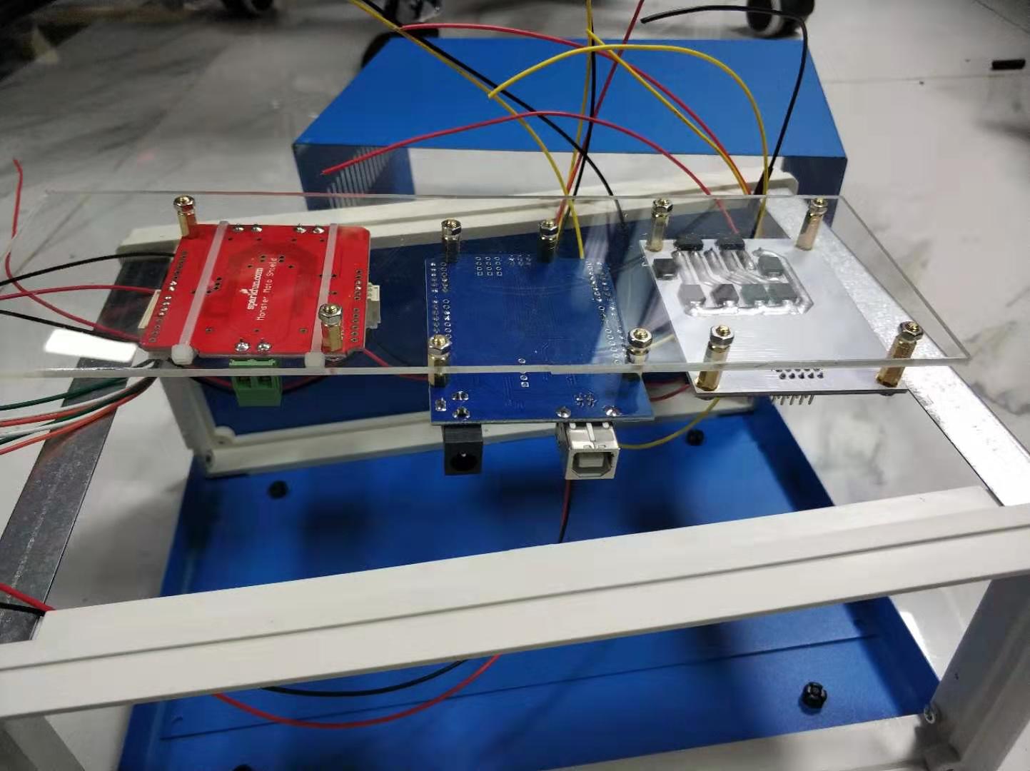

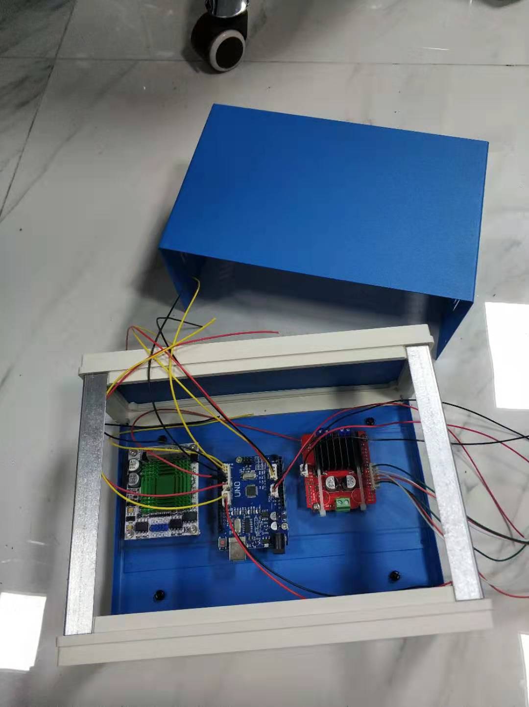

    Today I soldered connectors on the boards, to make rewiring and parts exchange easier.
    and bought a blue case for boards.
  4. SoftKitty
    SoftKitty Member
    Feb 8, 2019
    69
    Engine engineer
    Nantong, Jiangsu, China
    - 140Coins
    +61 / 1 / -0
    AC motor, 6DOF

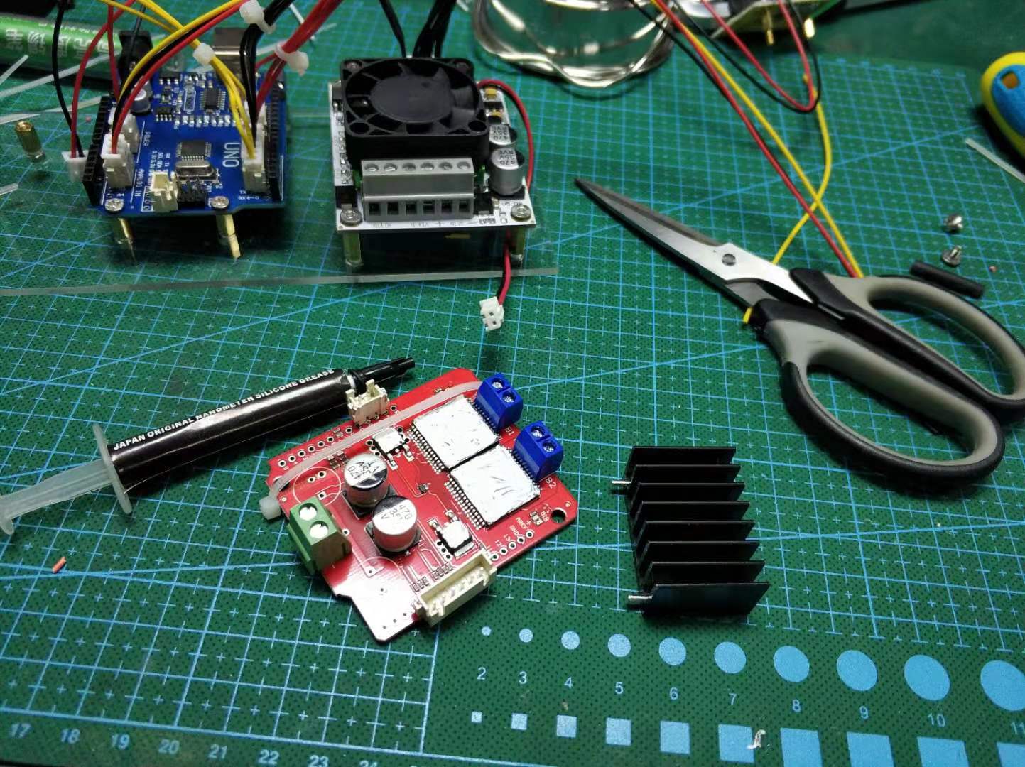

    Update: wiring and added cooling for driver boards.
    The green driver board can handle 2 motors
    but still I added a MM on the third channel, just in case.
    It also can be useful if I add traction loss some day.

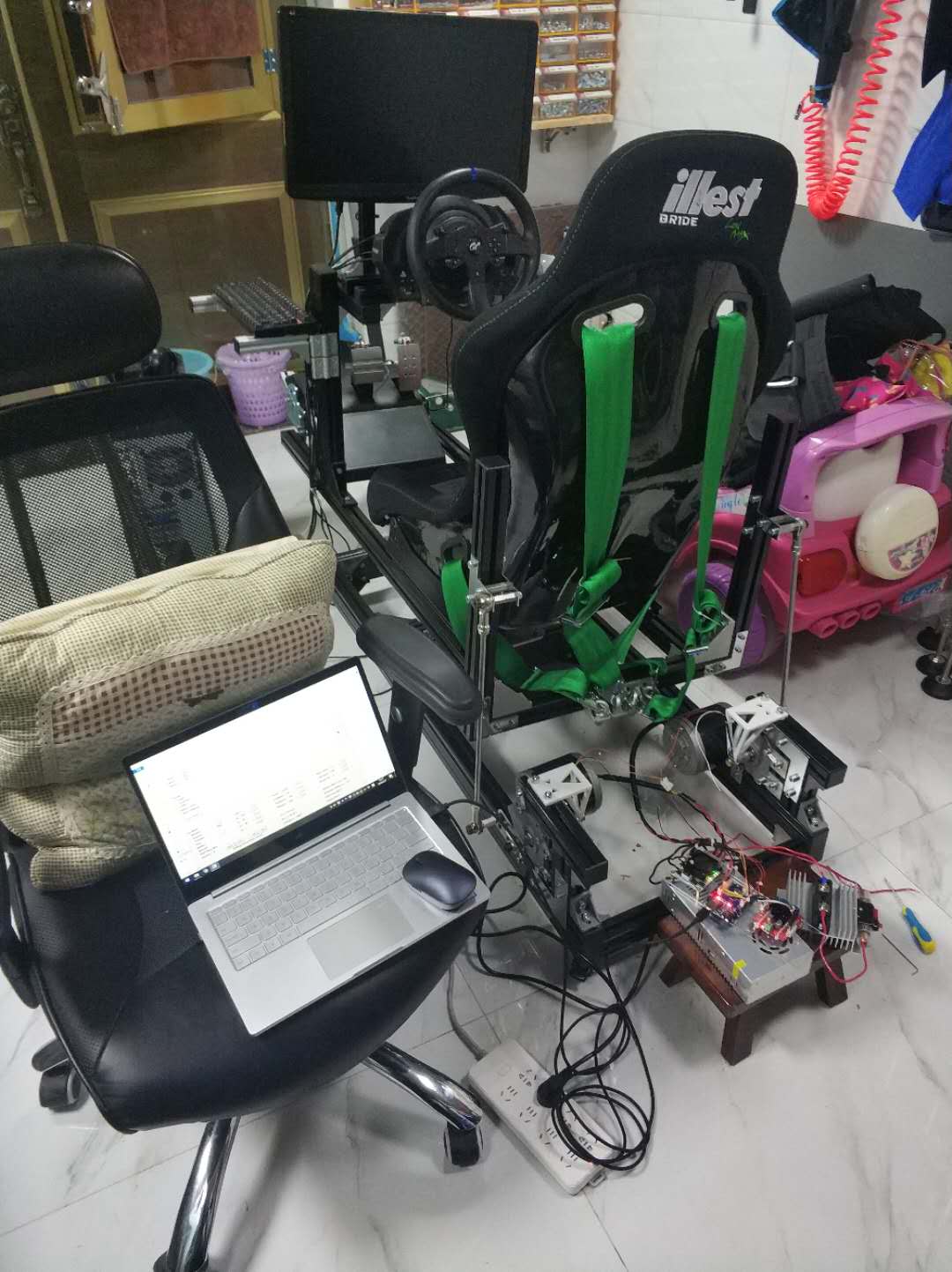

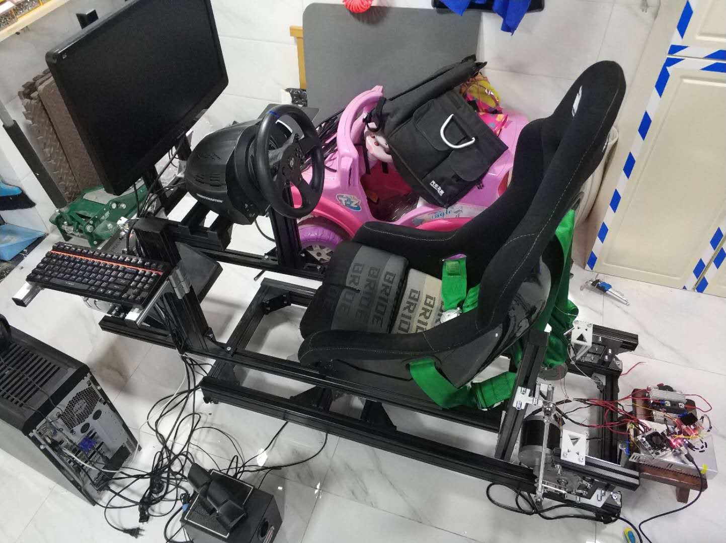

    ready to move, everything is pluged now it's time to test and tune.
  6. BrazilianGuy
    BrazilianGuy eternal apprentice
    May 19, 2018
    27
    44Coins
    +30 / 0 / -0
    Very nice and compact build. I have the same motors as you, but I never put real load on them. Looking foward to see how they perform in action!

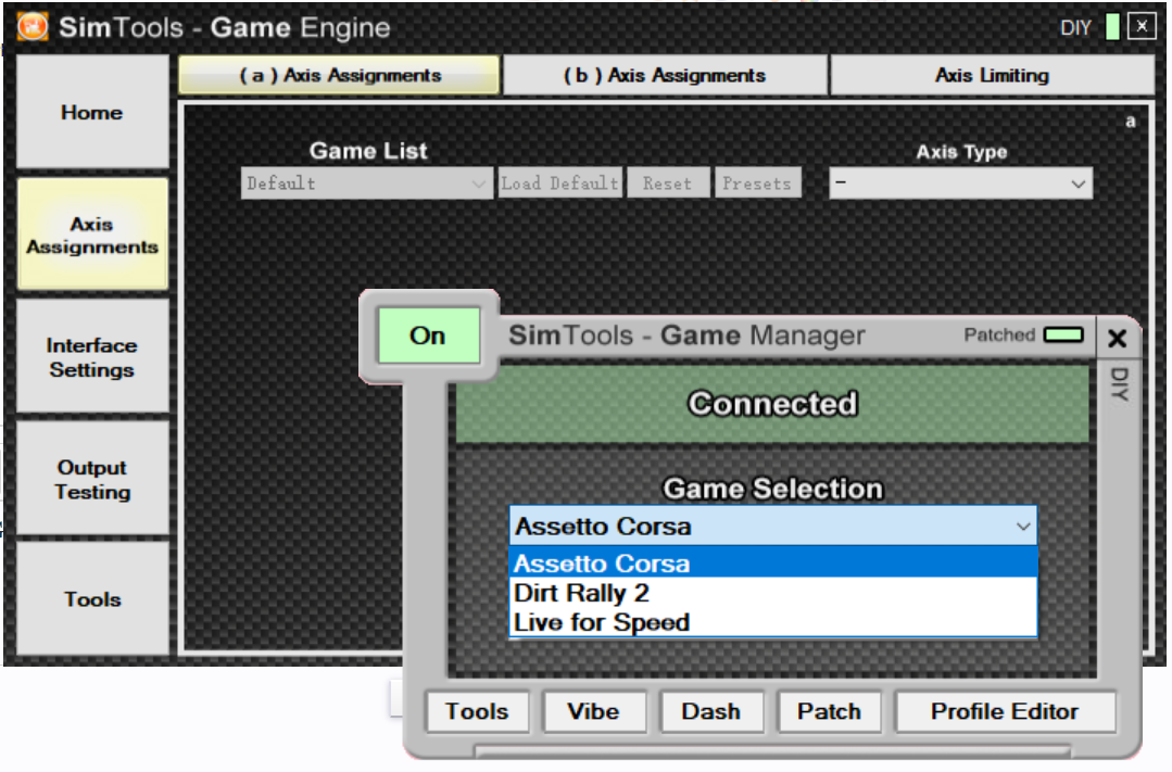

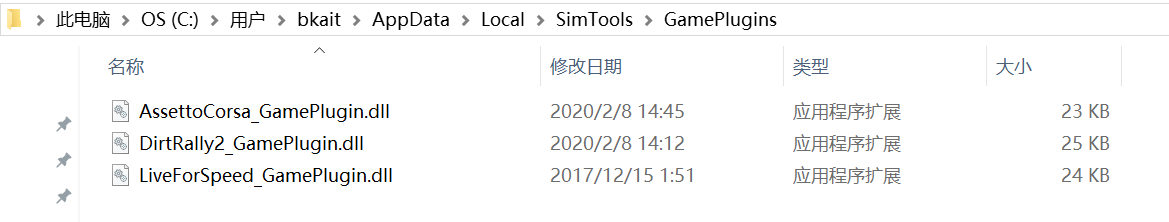

    I'm having trouble with GameEngine
    in "axis assignments"page ,"the gamelist" is grey so I can't choose any game.
    Some background information:
    ・the software version I installed was simtools v2.4 ;
    ・I installed as one PC option.
    ・Today, I registered with my free DIY licence got on Dec 25th,2019;
    ・Even before I install any plugin, the LFS is not available to choose on axis assignments page(grey)
    ・Then I installed two plugins by pluginUpdater(drag&drop, unzipped files) :
     ("AssettoCorsa_GamePlugin.2.0.7.1."&"DirtRally2_GamePlugin.2.0.3.0")
     and right after both can be seen on GameManager, and AssettoCorsa patched successfully.
    ・I tried restart my pc but nothing changed.
    here is a picture of current status, Game Engine and Game manager are connected but Game List is still grey.
    In this subdirectory we can see the plugins exist.
    wish to get help, thanks!

  10. prodigy
    prodigy Burning revs
    Oct 27, 2013
    459
    Croatia
    6,698Coins
    +399 / 4 / -0
    It looks like you need to choose the Axis Type first, from the dropdown menu near Game list.
    Also, have you created your Axis's in Interface Settings tab?
    You must first create Axis before you can make changes in Assigment Tab.
  11. SoftKitty
    SoftKitty Member
    Feb 8, 2019
    69
    Engine engineer
    - 140Coins
    +61 / 1 / -0
    AC motor, 6DOF
    Thank you very much!
    yes, the problem is I didn't choose a Axis type first
    Sorry everyone, I will read manual more carefully next.:roll

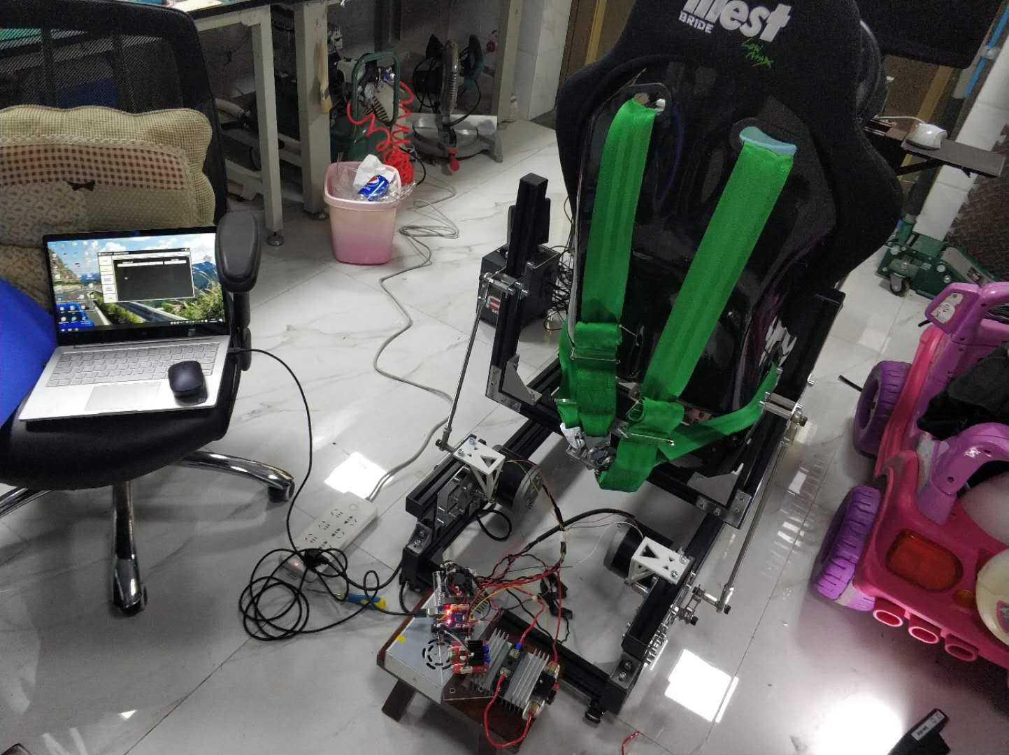

    I'm having a simtools center position problem:
    I have horizoned the rig lever to the mid point of POTs,
    so every time I plug the arduino USB cable in, it will return to flat.
    and I double checked the POTs with multimeter, both read 2.5v.
    but every time as soon as I "turn on" in Output Testing of GameEngine, the rig will incline sideways,
    to the point where both Pots voltage reading is 1.57V, but at that time all the drag bars are in 0%, what could be the cause of this problem?
    ※the two motors work well in SMC3 utils, sine/triangle or any movement is ok, so I think no wiring issues.
    Here is my game engine settings:
  13. SoftKitty
    SoftKitty Member
    Feb 8, 2019
    69
    Engine engineer
    - 140Coins
    +61 / 1 / -0
    AC motor, 6DOF

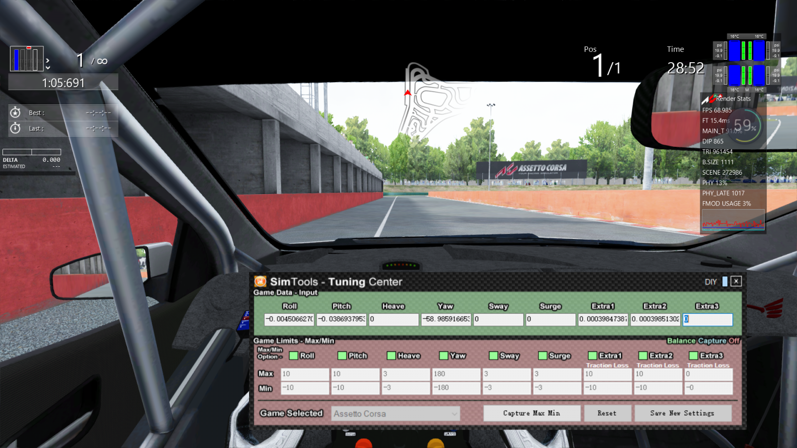

    I have done a test drive, with little adjustment on the axis assignments(add sway and surge), now the movement is logically correct.
    But still, the center position is wrong, as the game starts or the car stay still on a flat surface, the rig rolls to the right(where both POT voltage readings are about 1.57V~1.59V).
    all other movements are based on this wrong initial position.o_O
    why it would align on this POT reading(1.57V )...?
  14. prodigy
    Oct 27, 2013
    459
    Croatia
    6,698Coins
    +399 / 4 / -0
    Have you checked your Tuning Center tool, once you have start driving in the game?
    If the positive value and negative value for one force is different (for example for Surge), your starting position (center) could be changed.
  15. SoftKitty
    SoftKitty Member
    Feb 8, 2019
    69
    Engine engineer
    - 140Coins
    +61 / 1 / -0
    AC motor, 6DOF
    I checked as you mentioned, but they were all close to zero.
    I also checked in the virtual axis, Axis1a and 2a showed in their center position, but in real both axis is in position where POT voltage is about 1.6V.

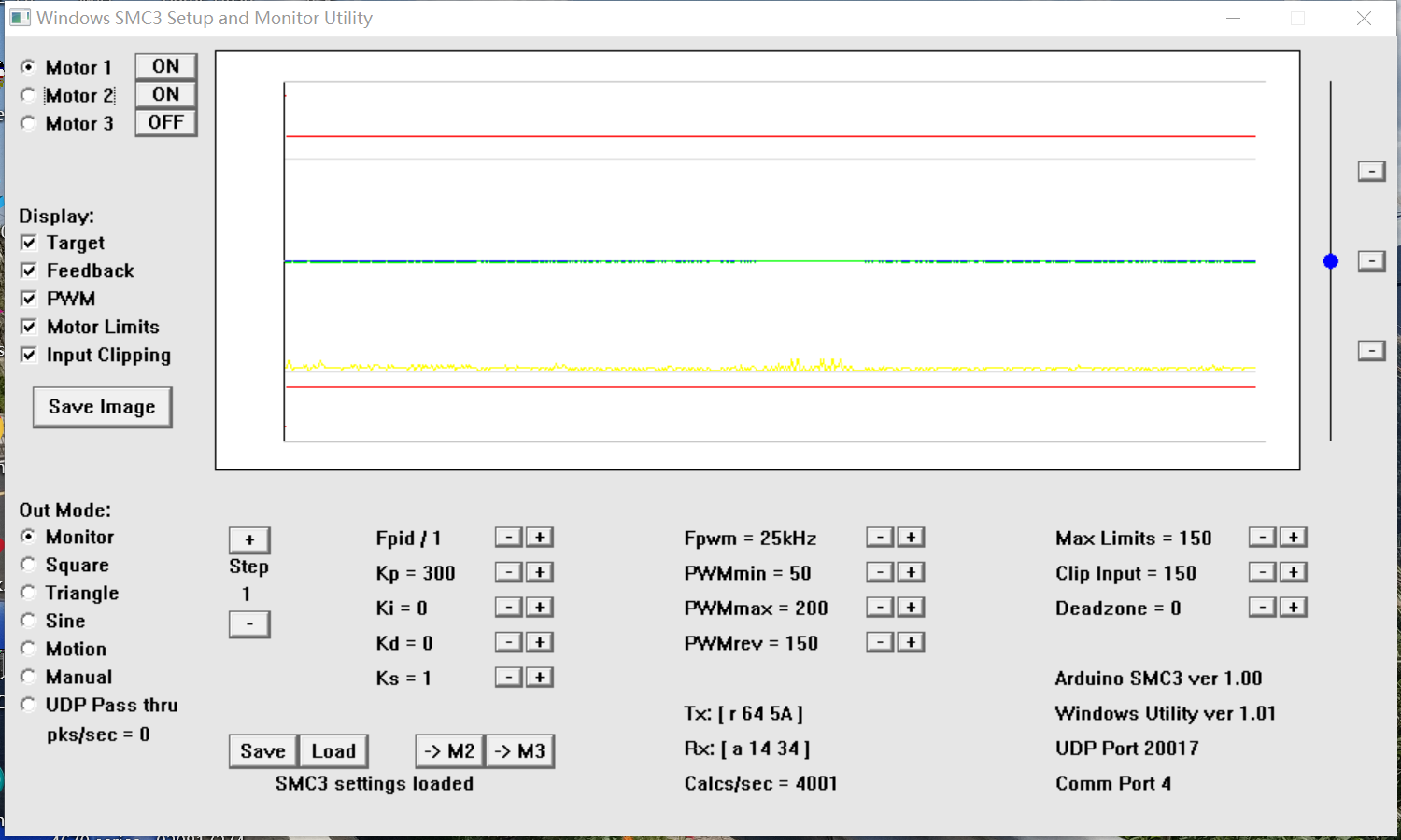

    I suspect the issue is on your hardware or SMC3 side.
    What are the CTC distance on the levers and can you please post pictures of your SMC3 settings. You may need to refine your SMC3 settings further, like PID. If it is hardware swapping things like pots or motors from one side to the other will identify what hardware it is.
  19. SoftKitty
    SoftKitty Member
    Feb 8, 2019
    69
    Engine engineer
    - 140Coins
    +61 / 1 / -0
    AC motor, 6DOF
    The CTC on levers is 10cm.
    and SMC3 settings are like this:
    I tried swapping the two motors and pots connection on the driver board, the result is the same: both side will go from 2.5V to 1.57V point when simtools take the command
