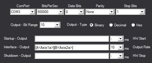

    Very impressive ! One of the best 6 dof I’ve ever seen! Only one question: checking your axis assignment I just want to understand if exemple you want more pitch, you just decrease the % of other axis and increase that one? How you calculate the total % ? It should not be less or equal to 100%? Thanks
  5. prophet.id
    prophet.id BOSeTAMPER's Rotary Servo 6dof Build
    Mar 11, 2024
    67
    308Coins
    +33 / 0 / -0
    Thank you!
    Yes you are correct, just increase the % number up to 100% max. You just adjust it to your liking. No specific reasoning, but more your own preference.
    Btw, I end up more focused on the 'Sensitivity', which gives me the most simulation feeling.

    Perfect! But 100% per axis or the sum of total axis? I see your configuration total axis is more than 100%. Thanks
  7. prophet.id
    Mar 11, 2024
    67
    308Coins
    +33 / 0 / -0
    Per axis.

    Hi I thing your surge axis needs to be reversed as the surge looks like it's going backwards when you accelerate
    Also worth checking sway (same direction steering) as I made the same mistake when first tuning mine
    I might be wrong it's hard to tell but just thought I'd mention it nice rig though

    I believe you are correct. I have been playing with the tuning, and the current video is mostly out of date.
