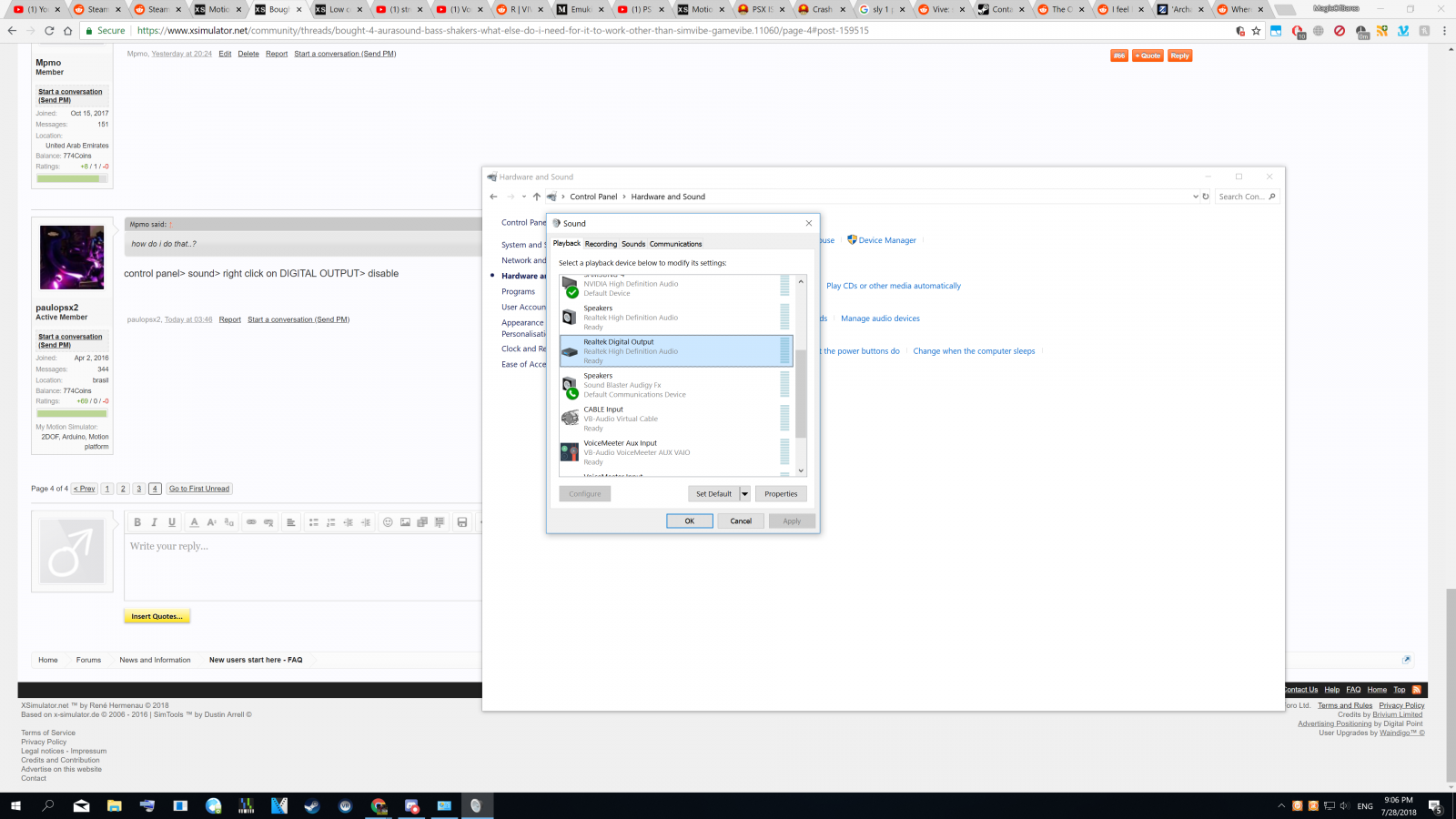

    control panel> sound> right click on DIGITAL OUTPUT> disable

    ohh i disable this one? (just makin sure)
  9. paulopsx2
    paulopsx2 Active Member
    Apr 2, 2016
    616
    brasil
    647Coins
    +165 / 2 / -0
    yes, right click disable.

    i installed new drivers from the website and i think that fixed it lol, now it's working! thank you and @yobuddy for the help
