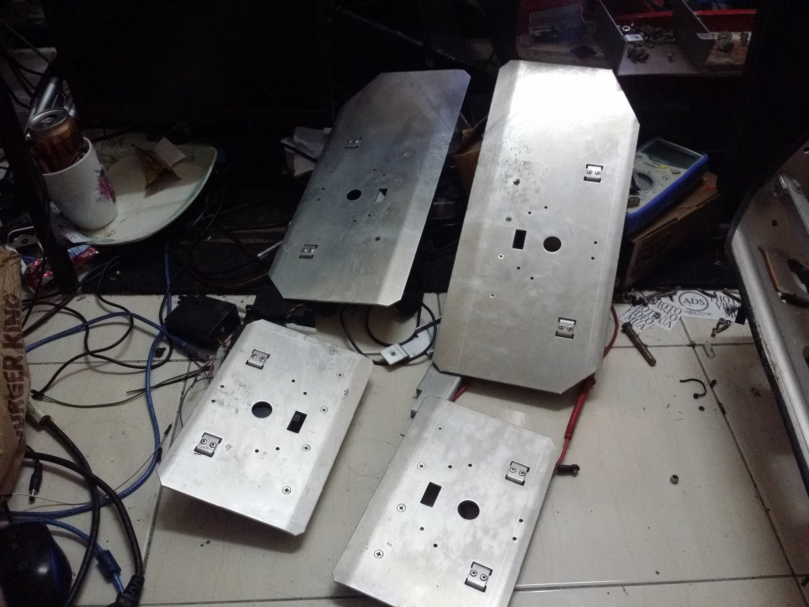

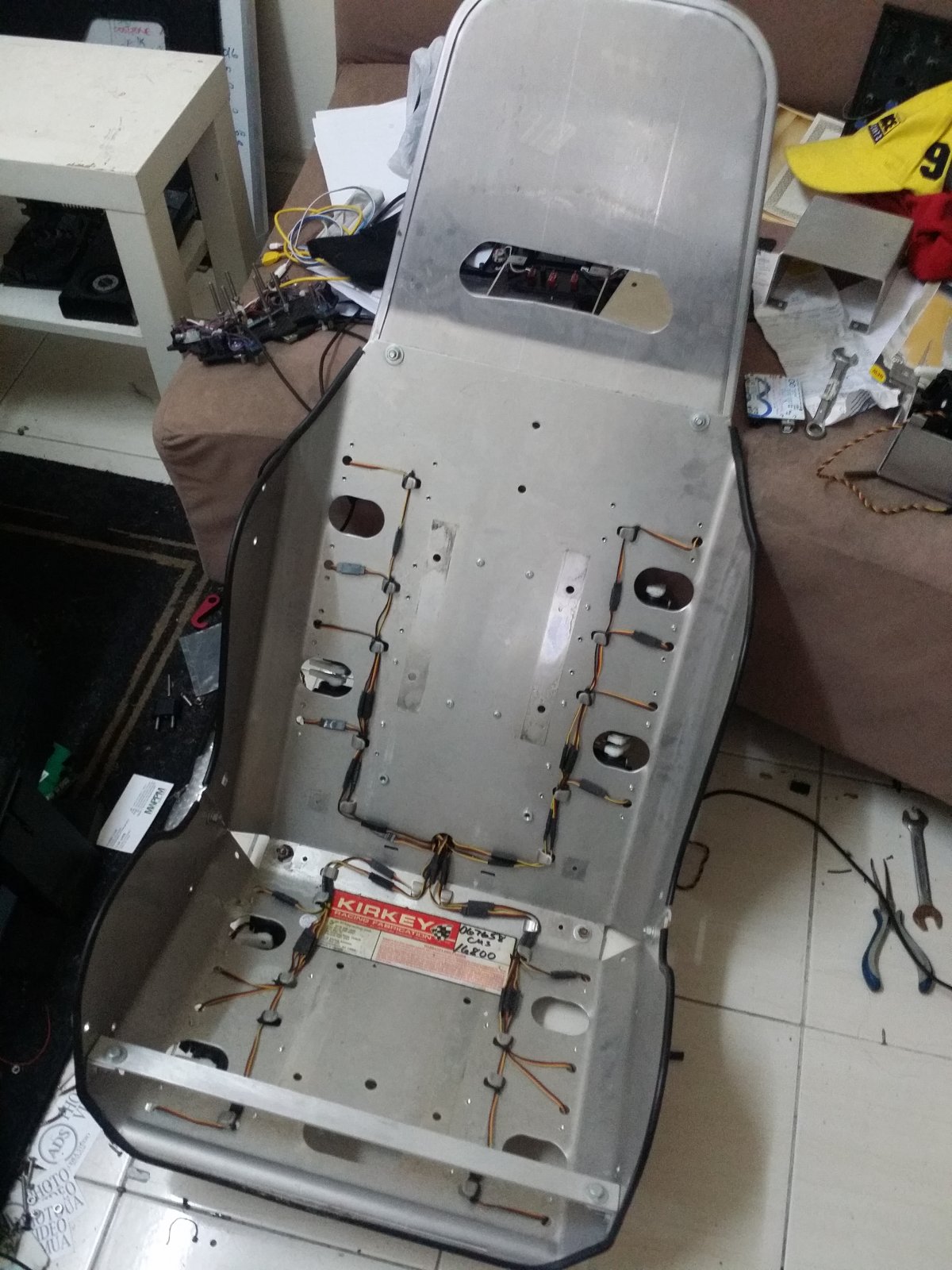

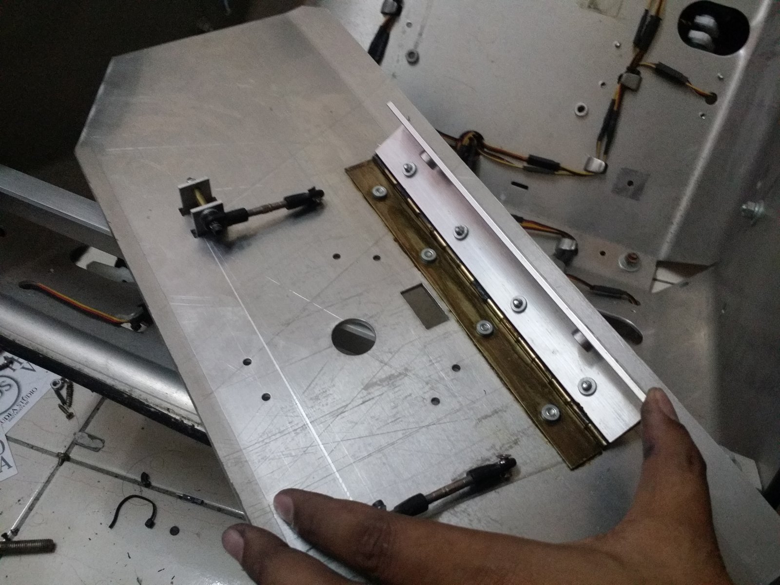

    I have made a video to you better understand my problem. When in parallel wiring the servo moving uncontrolable. But when i did individual it seems working good.
    Before that i have blew 1 of my servos by accidently swap over + and -..arghhhh
    Suprisingly the gs4 using this simple joint as pivot point.
