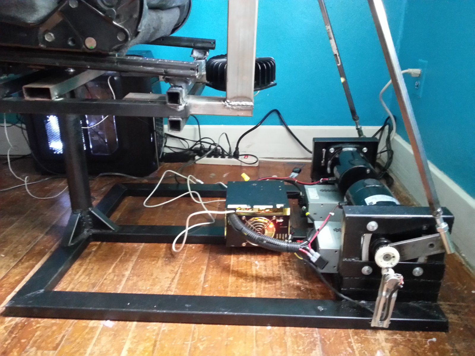

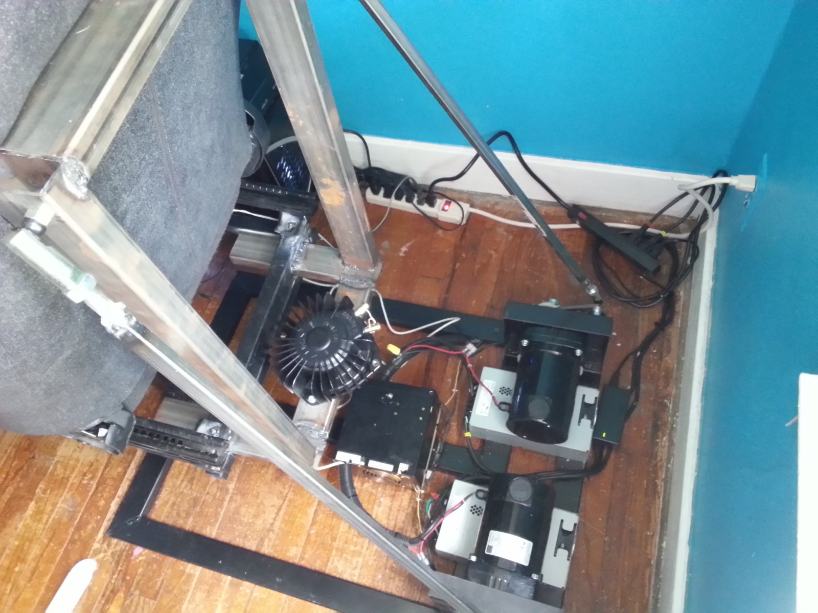

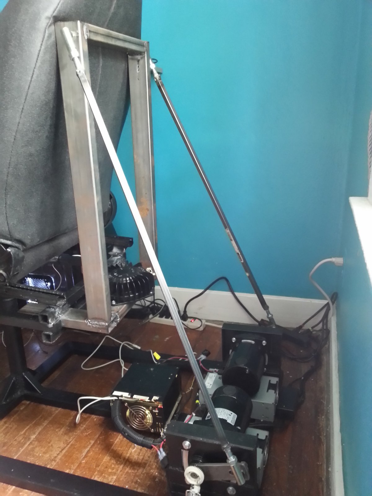

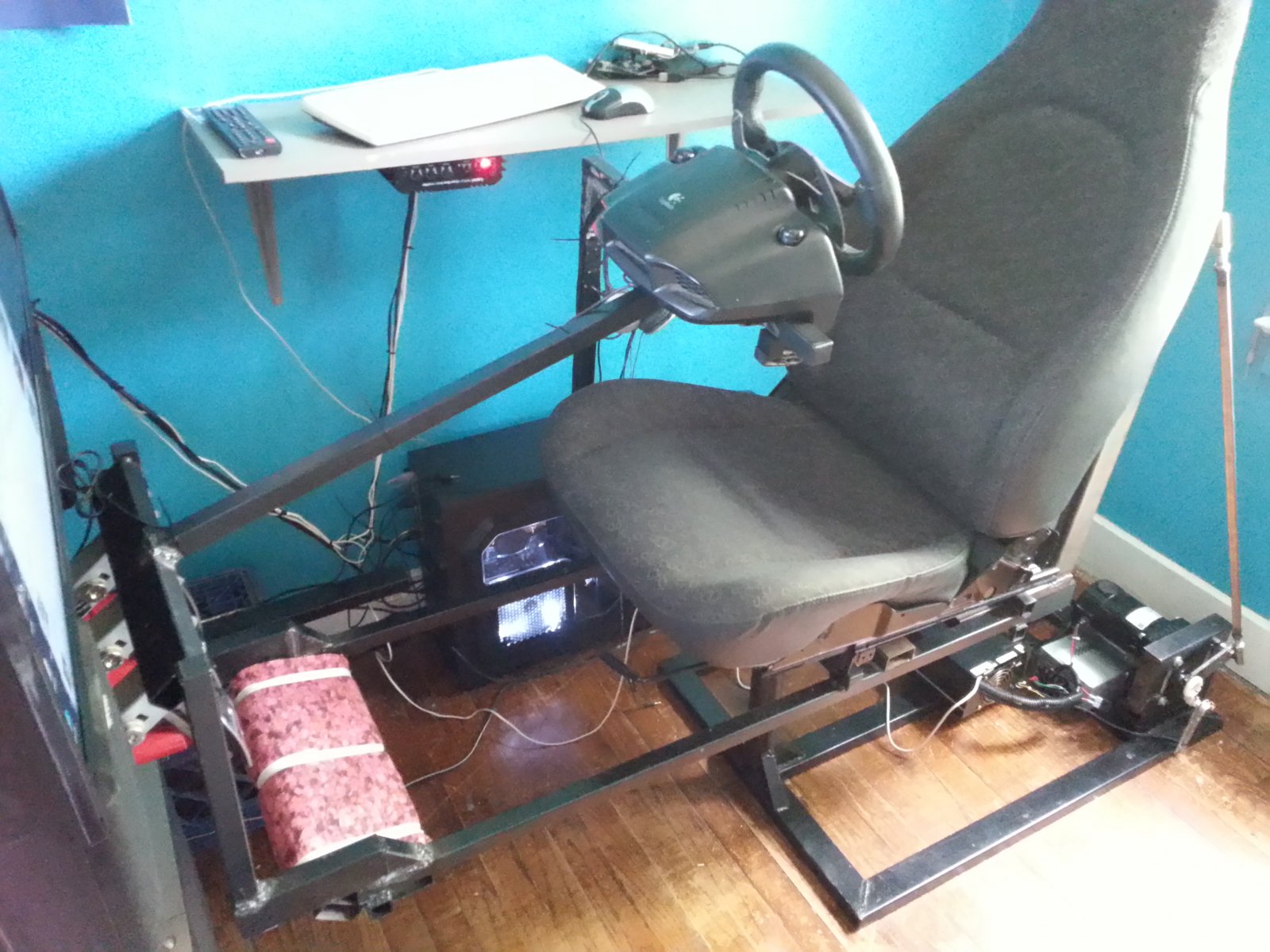

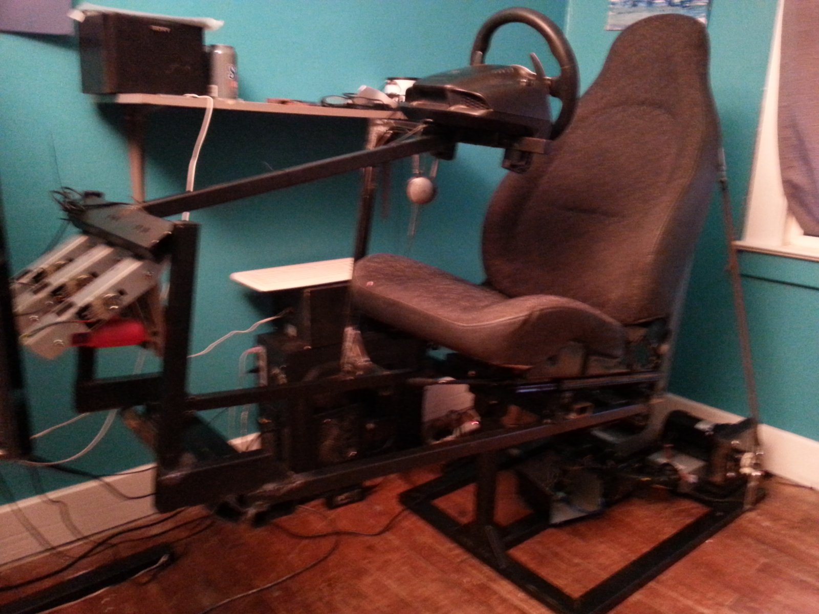

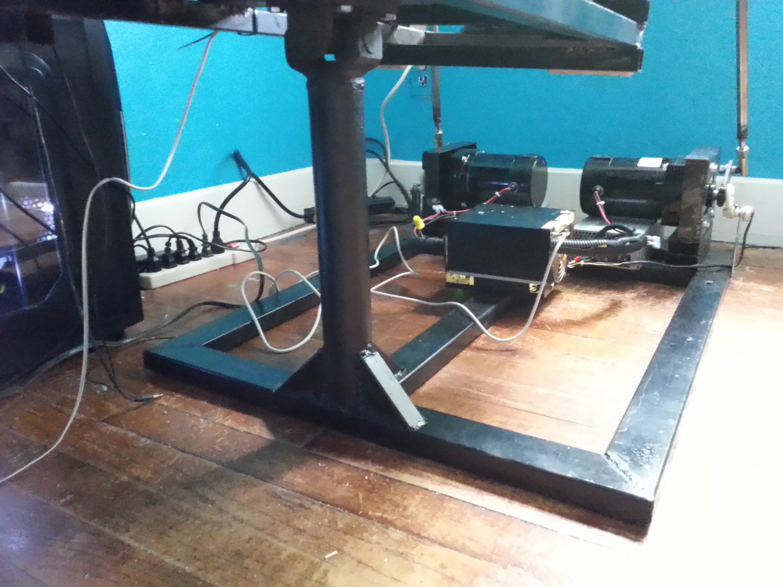

    phone7_15 907.jpg phone7_15 937.jpg phone7_15 938.jpg phone7_15 939.jpg phone7_15 940.jpg phone7_15 943.jpg
    so it works
    more details in a little while. work has me sooo busy.
