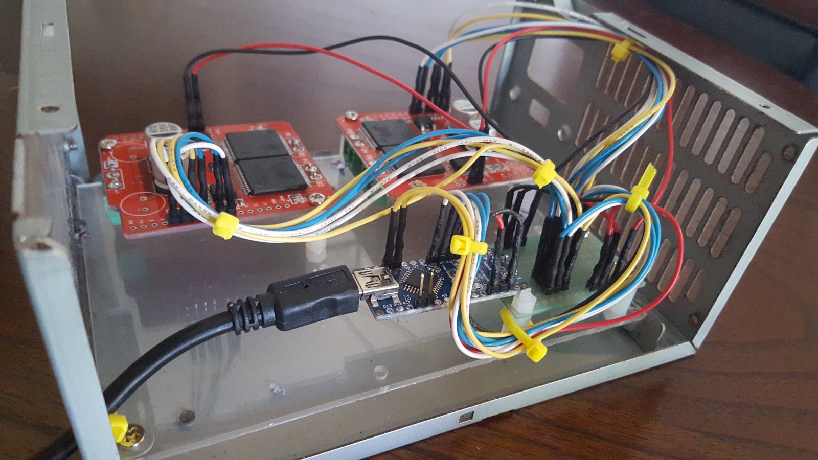

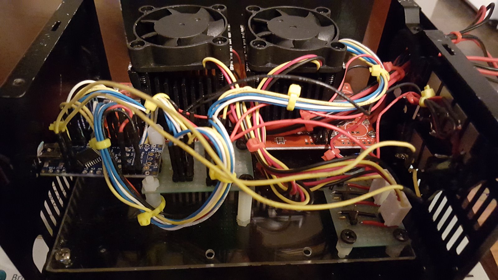

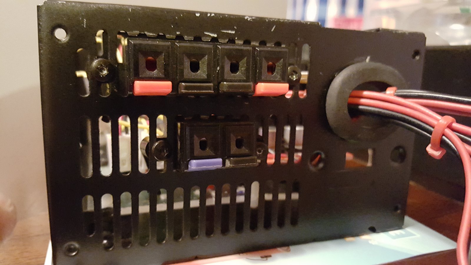

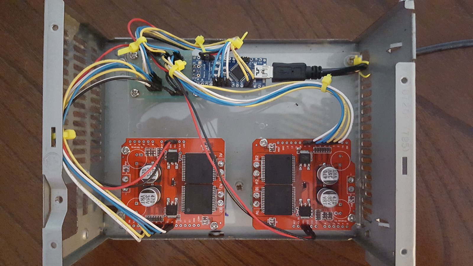

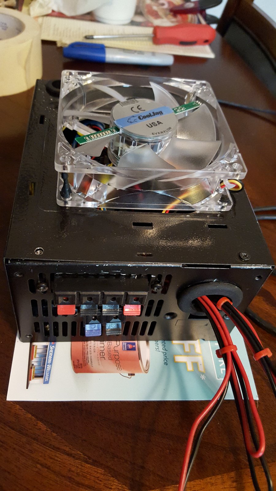

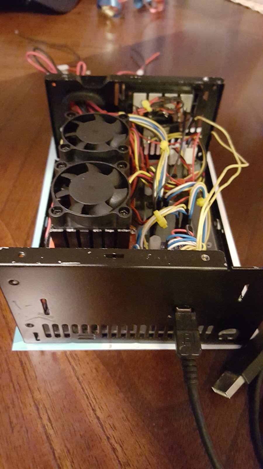

    added a 12 volt proto board for the fans, moved the nano to the side and drilled a hole for external usb access, added fan with led temp to case, added quick connectors to case for pot hookup with external access.
    this one is finally done now i can swap it out with the first one i built.

  10. Nick Moxley
    17,057Coins
    +2,506 / 30 / -2
    that Fan is BAD ASS!!!!!!
    • Agree Agree x 4
  11. bruce stephen
    Jun 7, 2015
    1,286
    general contractor
    michigan
    9,115Coins
    +1,243 / 9 / -0
  12. Nick Moxley
    17,057Coins
    +2,506 / 30 / -2
    Interesting, but i would be after a 120mm......Granted im sure they ARE out there. Thanks Bruce.
    quick google search, Oh ya there available in droves.

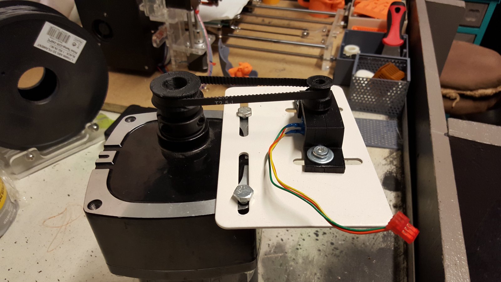

    New design for mounting my potentiometer. this will allow me more freedom with gear ratios. It also removes a pinch point where i had meshing gears before. The plate is repurposed from a bed frame.

  14. stevemontuno
    stevemontuno Active Member
    Apr 24, 2015
    316
    UK
    1,461Coins
    +335 / 0 / -0
    Thats a pretty cool design @bruce stephen ,,,i was toying with the same sort of idea but using an Oring as a pully with the pot right next to the motor shaft,,,
    I did have a look for a belt but couldn't find one small enough,,,did you find any shorter belts than the one your using or can you cut and glue it to any size?
    Cheers
  15. bruce stephen
    Jun 7, 2015
    1,286
    general contractor
    michigan
    9,115Coins
    +1,243 / 9 / -0
    Yes @stevemontuno cut and glue. I used a razor to slice off two teeth from the belt then glue the toothless part to the backside of the other end. I used CA glue, stuff gets brittle we'll see how it holds. its t2.5 left over from the 3dprinter build.
    first test went well. this is 2.22:1 ratio. can switch out pot gear to change ratio. Ive got a bourns 10k pot in there right now in case i destroy it. they are only a couple dollars. now to put it on repeat and see how the belt holds. I may have to purchase the proper adhesive.
    EDIT: the ca glue didnt last as suspected. headed to store. there are always zip ties as a last resort.
  16. stevemontuno
    Apr 24, 2015
    316
    UK
    1,461Coins
    +335 / 0 / -0
    @bruce stephen Cheers mate i never thought about 3d printer belt ,,,i'll see how the Oring does and then i might try your way as it's a very tidy setup
