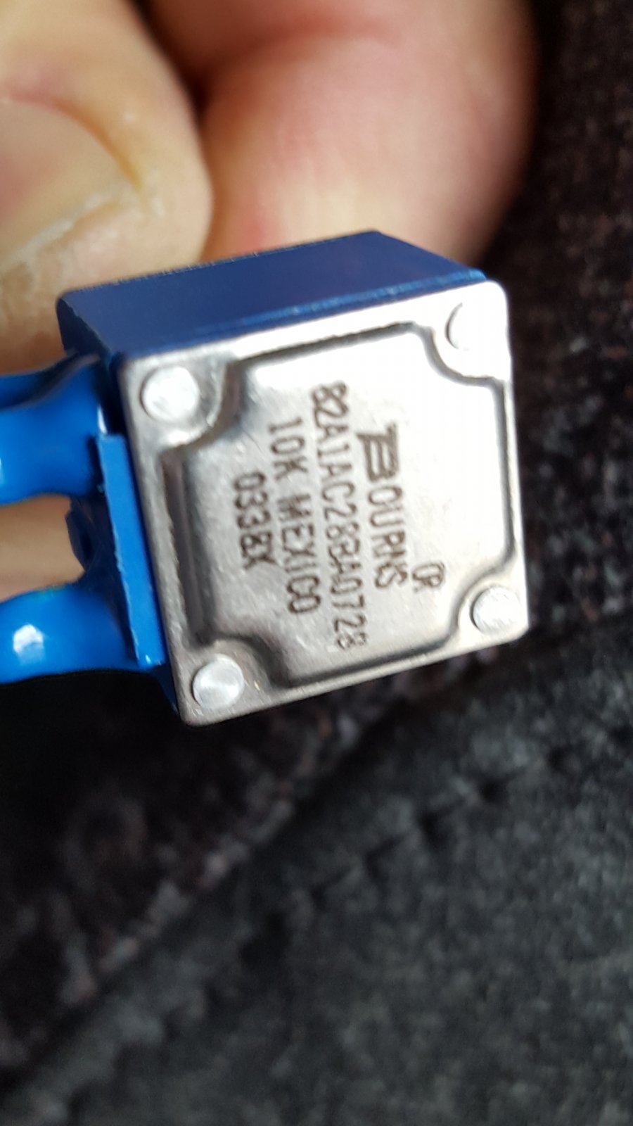

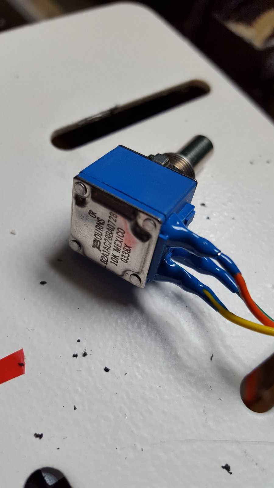

    we shall see @Nick Moxley . i have two in operation they are amazing........ but my new problem, at least testing with the bourns pots, is the lateral force on the pot shaft from the belt tension burned them both up in about two hours. even the bourns pots never broke on my rig. With the geared setup there is little force on the pot shaft. I have an idea though. two pulleys(motor and free) with the pot sprung into the belt in the middle. this will reduce the load on the shaft. I gotta build it then ill post pics. im just not good at drawing it out, better in my head.

    Why not Flex Couplers ?

    Possibly.....
    I want the freedom to quickly change feedback to motor ratio for different style tracks.

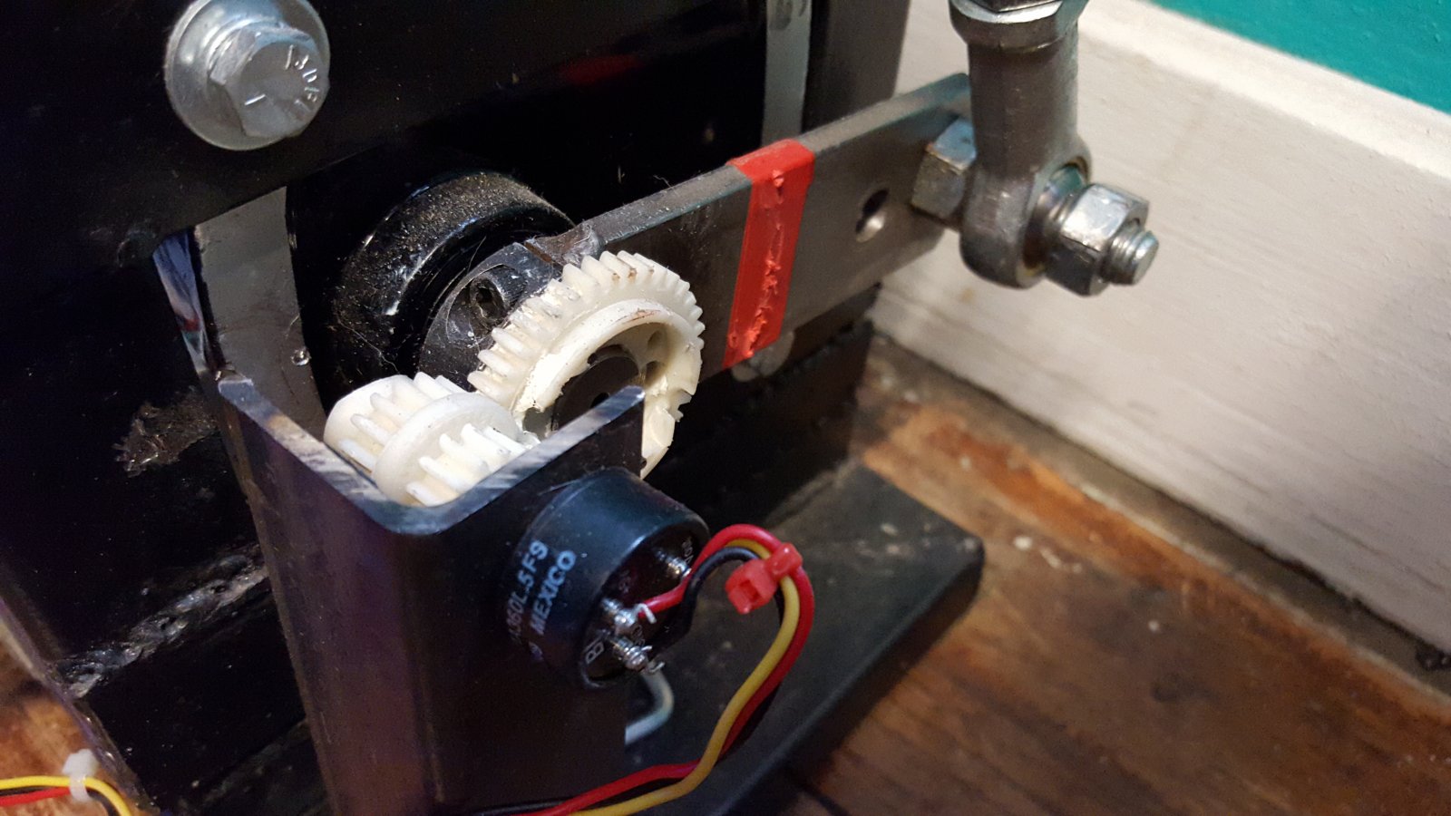

    superspeedway (daytona or talladega) larger and a little slower movements. short track high bank (bristol or dover) short and slightly violent movements. i dont really do roadcourses. I do race a little watkins glen or sonoma but only out of necessity. At the very least this should help me dial in the overall movement even if I decide on 1 ratio. So far I've printed up 2.22:1, 2:1 and 1.6:1. The 1.6 is pretty extreme and may be too much. I'll know more when the new pots arrive. I'm not stealing the ones off my rig lol.
    Crude but it doesn't oscillate.

    Interesting way to go about that Bruce, How exactly do you move the pot over or flip the gear i should say ?

    Different size gear on the motor it's a pain to switch out. So I don't. I did a couple times when I first built it. But not in months. Flip one swap the other. Takes a half hour by the time it's done and set up.
