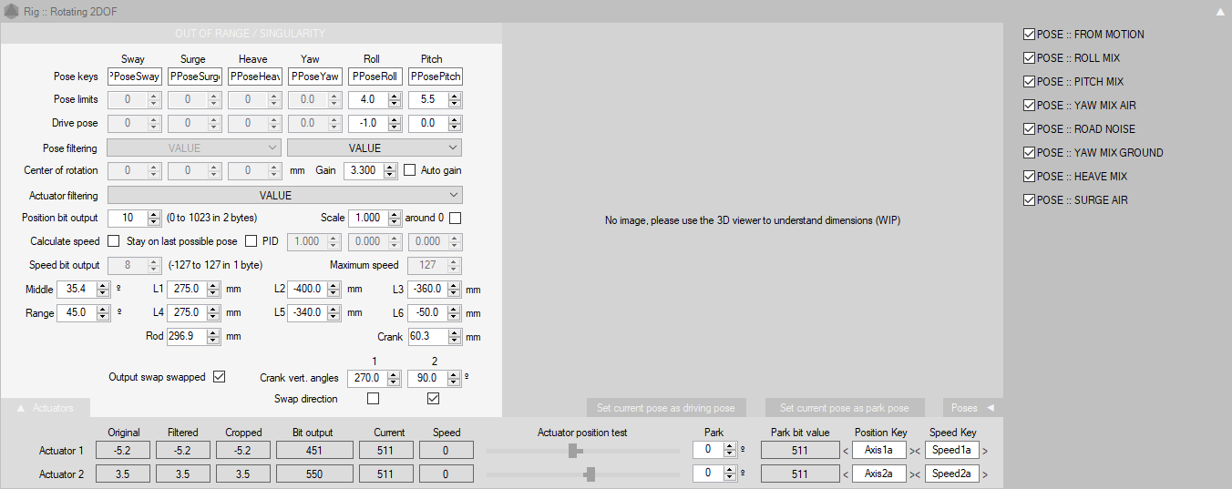

    What SMC3 settings are responsible for smoothing out the response?
    I'm getting there. The rig is mostly working, there is enough torque, but I'm having a bit "grainy" or glanular movement. Let's say I should be having a smooth movement, of 10 degrees. It moves, but I can feel 100 tiny "steps" when moving. That's when testing with FlyPT Mover and MSFS. I know when I was testing before I had a filly smooth movements, so my motors are capable of that.
    I dialed Kp to 300 and PWMmax to 130 and tried Kd 10 and 50, but that didn't seem to help.

    OK, it looks like I'm almost there. Operation is smooth (CTC still at 60mm), although motors whine when on full rolled back position. At that position most of me are back of COG. They are able to maintain the position and smoothly go back, despite the whining, so I guess it's OK.
    I mixed in a few things in FlyPT Mover for MSFS:
    • Roll Position and Pitch Position (with high-pass filter) are taking about 70% of the range to get the gravity feel right with seat inclined the correct way.
    • Roll Speed and Pith Speed (+HPF washout, +Crop) are added to that, to get the motion cues.
    • Sway and Surge are mixed in with Roll and Pitch, to get the cues for take-off roll acceleration and breaking.
    I adjusted it with MSFS running on 43" 4K monitor first, to get thinged dialed in. After a couple of hours of that I got totally car-sick. Really queasy...
    When I got reasobly close to what I wanted, and got some rest, I got in VR.
    OH MY GOD!!!
    This is what I wanted, the project is so worth a few days' work invested in it and more. I can never go back from VR+motion for flight simulation now, that's official. It's just 2DOF, but this is another level of immersion. And I haven't even connected my DYI transducers to thenew rig yet. This is amazing, I was grinning and laughing during my first test flight. In the end i had to stop (guests coming), so I did a quick engine-off emergency landing in a field. It was a success, but the land is uneven of course and I was thrown around HARD, but it felt so real and so fun, that when I stopped, I just started laughing for a minute like an idiot, and couldn't stop.

    Thanks for your feedback and tips! In the end I based the motion on acceleration mostly, but it didn't feel entirely right, so I mixed in a bit of roll and pitch position too, maybe up to 20% or 30% of the movement. Now it feels great - I feel all accelerations, and remain very slightly inclined in a turn, for example, just a bit to help the feeling of a turn. Will compare to real aircraft soon, and adjust as needed.

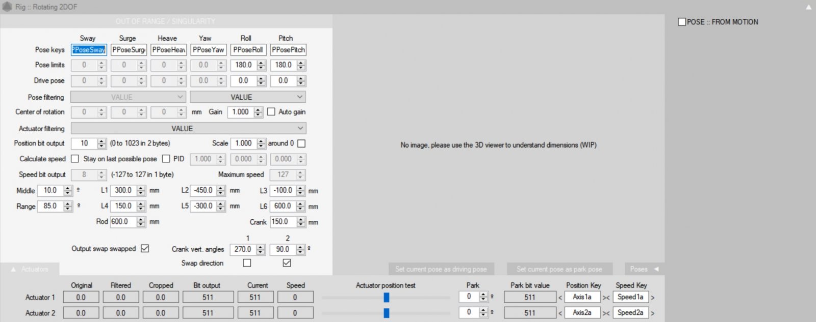

    Hi ,
    Hope you can help me out with flypt.
    I got the source and pose module working but not much more.
    How did you make your rig module for your 2dof rig.
    I can't figure out what the input is for middle , range L1 to L6 ?
    could you show my your configuration .
    Also any info on your output settings , might help me get in de right direction
  16. Ronan Design
    Jun 4, 2021
    270
    Toronto, Canada
    1,716Coins
    +143 / 2 / -0
    Sorry, I didn't see your post. Came here to update and saw it now. If you still struggling, here it is: upload_2022-9-6_20-34-58.png
