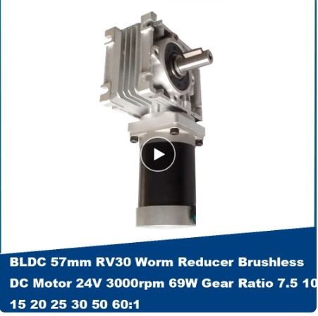

  12. floridianer
    floridianer New Member
    Jul 16, 2023
    13
    47Coins
    Man, i am so impressed by your nice work that i want to copy it because in the next couple of weeks i'll go for a new system with a 4090 in and MSFS ind VR. Originally i wanted to buy a complete DOF REALITY H2/H3 Rig but then i saw your solution and it was so easy to understand. I know that you spend many days and weeks to complete it but i think, i can handle it as well.
    When choosing the engines, a high ratio is necessary, I assume so . ( 50:1 / 60:1 )
    How would you rate the following motor for your rig.
    I'm very unsure about the choice of motors because I haven't yet understood the effects of the specs.
  13. Ronan Design
    Jun 4, 2021
    270
    Toronto, Canada
    1,716Coins
    +143 / 2 / -0
    All I can say is that mine work well. Here's the new listing for them I think: https://www.ebay.ca/itm/354052076387
    They are 12V 75-80RPM 50:1 180W 50-60NM, so something comparable should work. Your specs are 24V, so you would need 24V power supply. I went with a cheap server PSU I could get free from a friend.
    22,185
    154,750Coins
    +11,196 / 57 / -2
    Design choices and hardware requirements are intimately linked, you can use SimCalc to help get your head around the tradeoffs in design Vs physics, and what sort of motor specs are required to drive a reg at a desired performance level: https://www.xsimulator.net/communit...e-linear-speed-and-forces-of-your-design.270/
    It is not just gear ratio, though that is important in terms of available torque, but also the Nm of the motors that drive the gearboxes.
  15. Ronan Design
    Jun 4, 2021
    270
    Toronto, Canada
    1,716Coins
    +143 / 2 / -0
    What worries me is that my motors list "50-60NM" torque, while yours are 0.2Nm. I'm not sure if it's a typo or a mistake in one of those two. I don't think yours are 300 times weaker, they don't look it. But I'd get to the bottom of this before ordering. Also, make sure you can get 24V PSU within your budget. 12V PSUs are cheap and readily available, like my HP 700W PSU which can be bought for $30 if I recall correctly.
