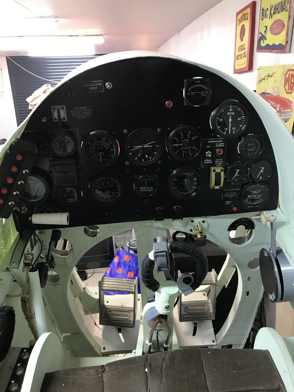

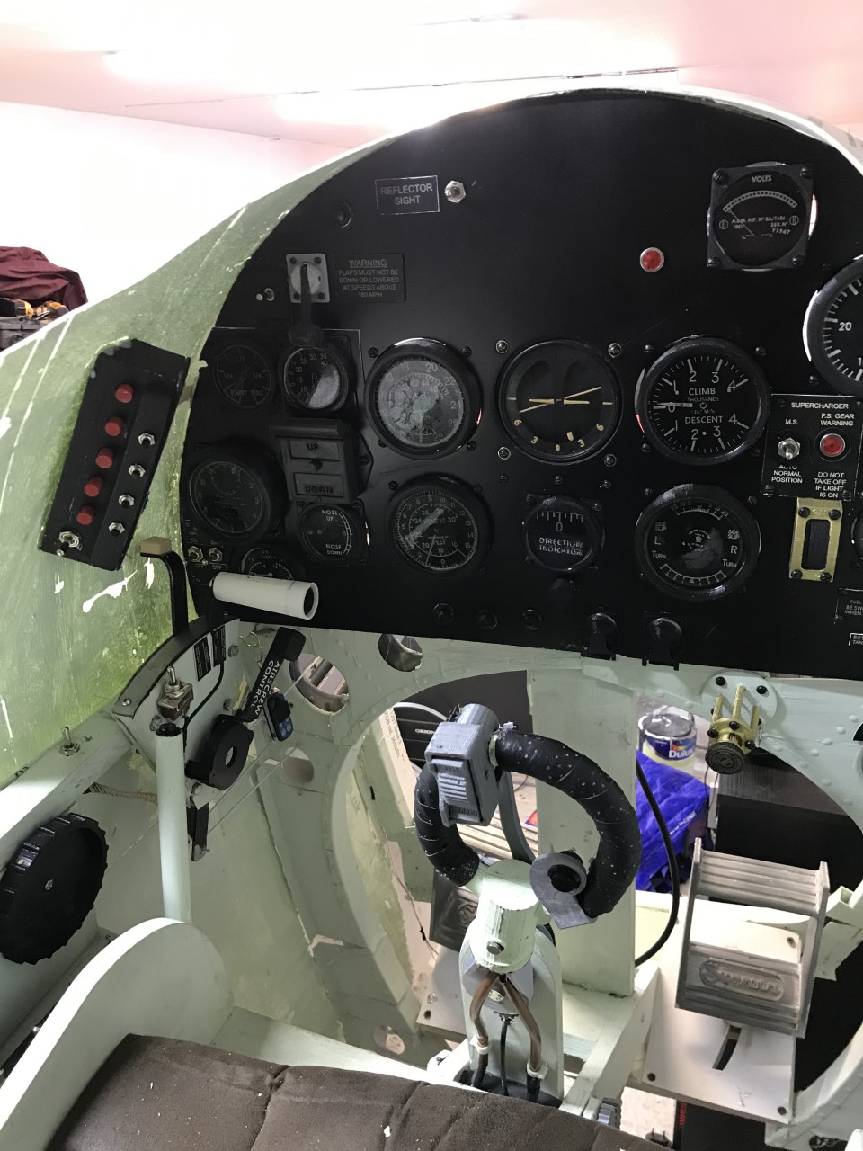

    So finally.. She moves!
    I've got a fair bit done with the cockpit and controls. Still loads of tidying up to do yet.
    But the new smaller motors are working great! Just need to figure out how to get her working in game now.
    Added some pictures, will try and get a video posted.

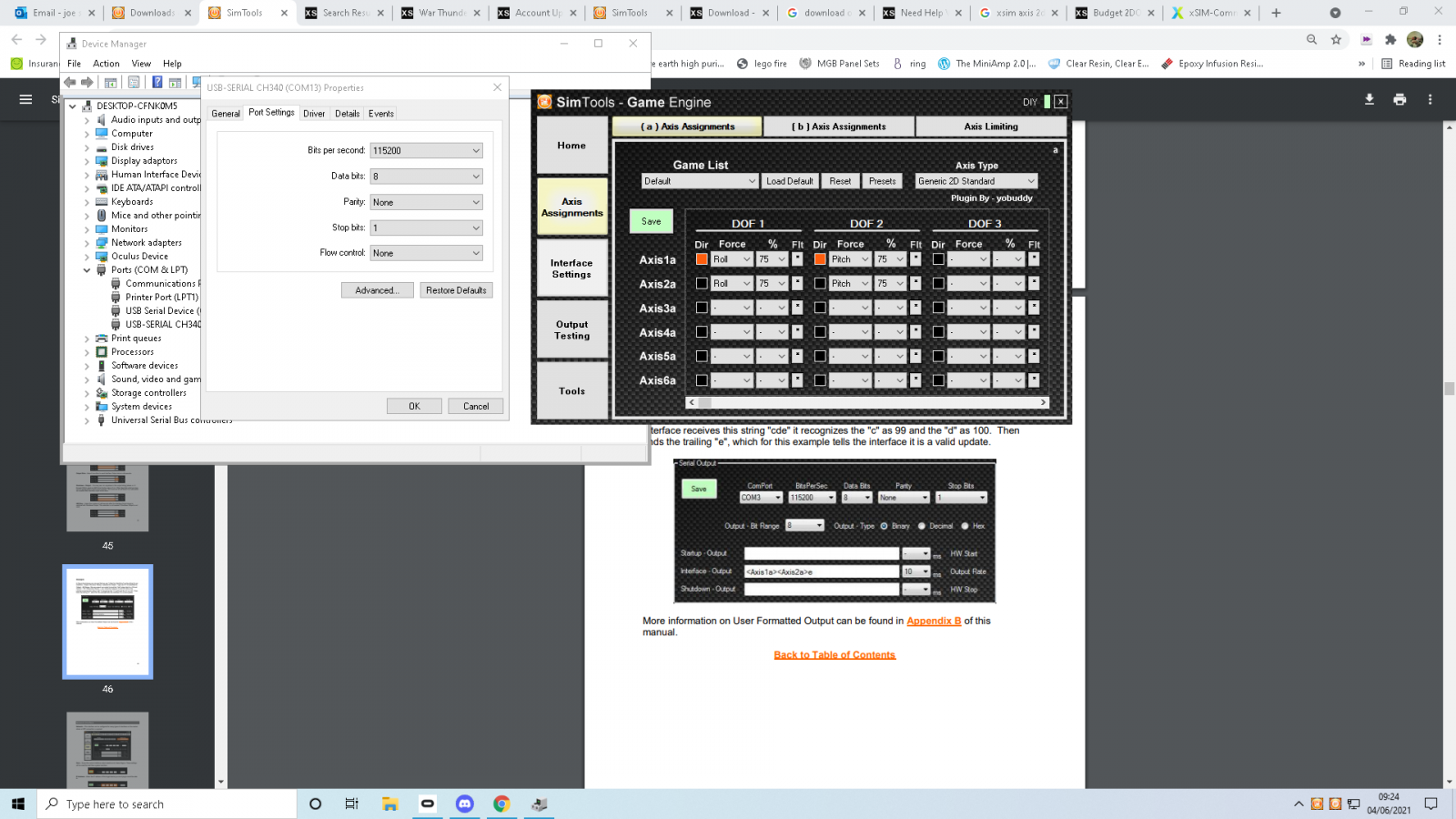

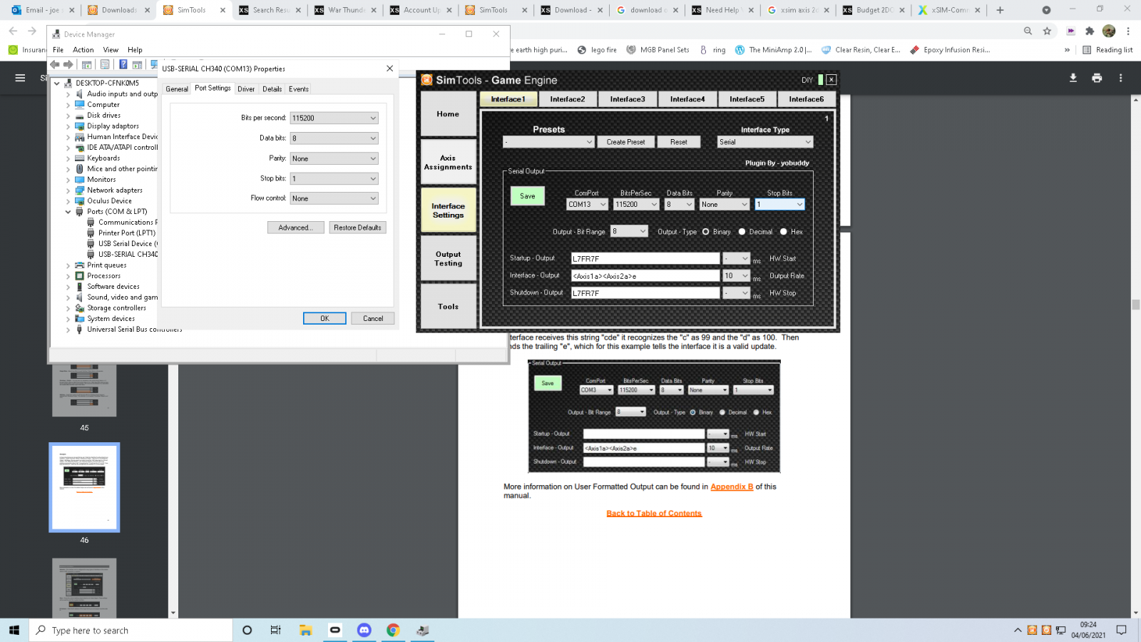

    Back to the trouble.
    The rig is moving perfectly in SMC3
    But does not move on the sliders in the game engine.
    Any advice would be greatly appreciated.
    I thought today would be the day!
    I have the game patch loaded.
    pulling my hair out again
    22,160
    154,576Coins
    +11,190 / 57 / -2
    If you are using SMC3 then your SimTools Interface Settings should be like this, as per the SMC3 guide:
    BitsPerSec - 500000
    Data Bits - 8
    Parity - None
    Stop Bit -1
    Output Bit Range - 10
    Output Type - Binary
    Interface Output - [A<Axis1a>][B<Axis2a>]

    Thankyou so much for the quick reply! she moves!
    Time to fly now

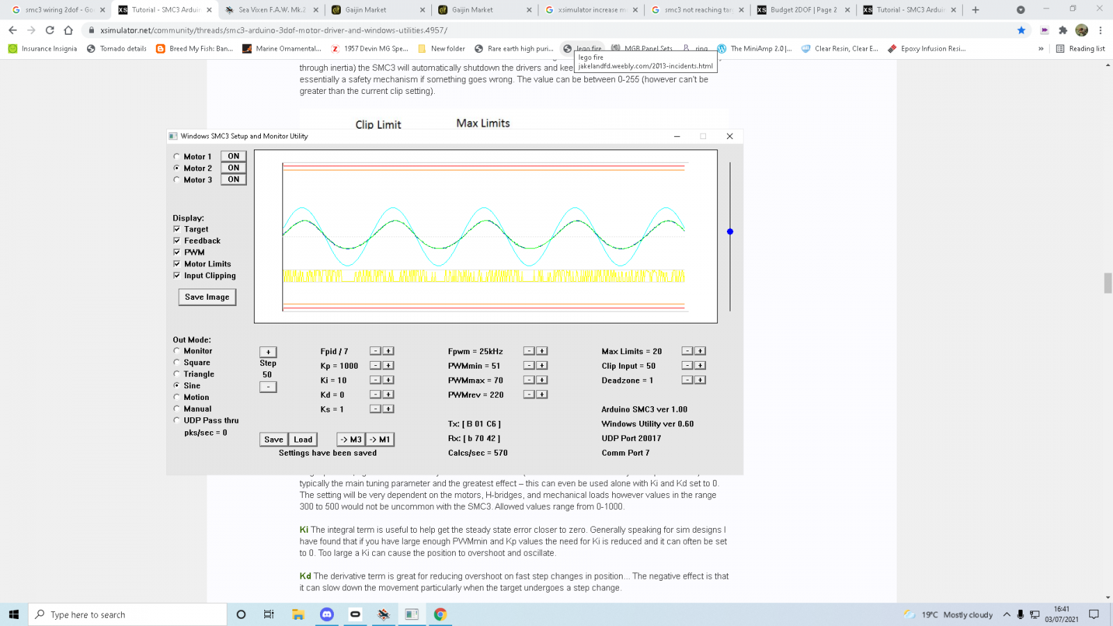

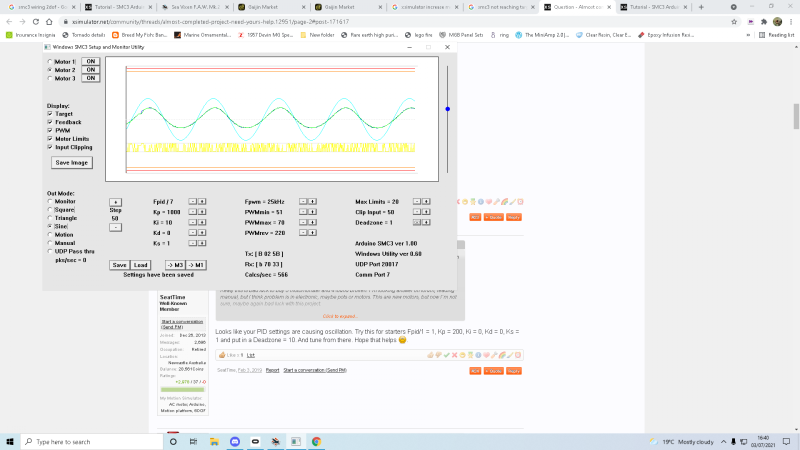

    Fine tuning now, having a ball playing war thunder!
    Could anyone explain why my rig isn't following the command line? upload_2021-7-3_16-45-1.png
