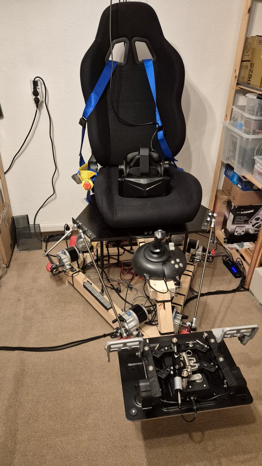

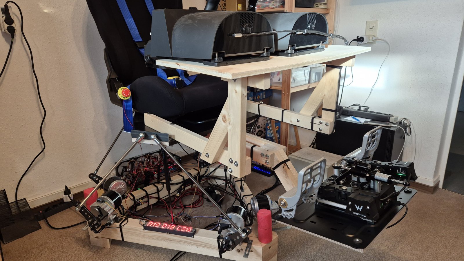

    Hi all,
    here are two pictures of the working rig. One at a development stage without Yoke and the other is a picture from yesterday's with Honeycomb Alpha and Bravo on a little self built desk.
    Let me know, it there are any questions. I flew my home airstrip yesterday in VR and reducing GAIN to 0.3 (Ground Nois) feels so much better. OVRMC is working now as well.
