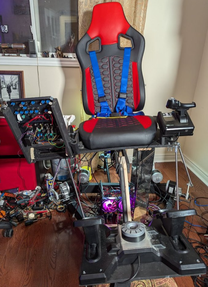

    I've completed and wired up the power/emergency stop/switchbox and assembler the top platform for testing the geometry and motion. So far so good. I think I need to move motors closer together because the platform ended up too low. My original calculation was for closer distance but I was trying to get them as wide as I can to maximize motion. The result may not have enough clearance for the pedals to pitch forward, and also the motor arm angles are not 90 degrees. Otherwise it seems to be moving right!

    with the motors closer together you need less power to lift becauce of less angle from youre pushrods

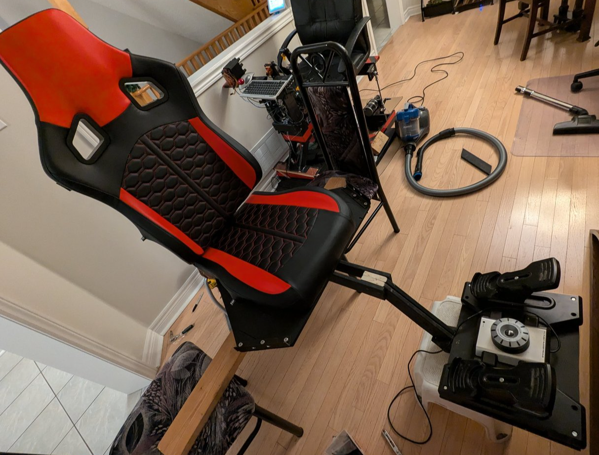

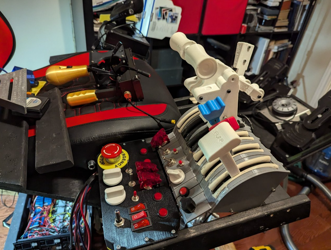

  11. Ronan Design
    Jun 4, 2021
    270
    Toronto, Canada
    1,721Coins
    +139 / 2 / -0

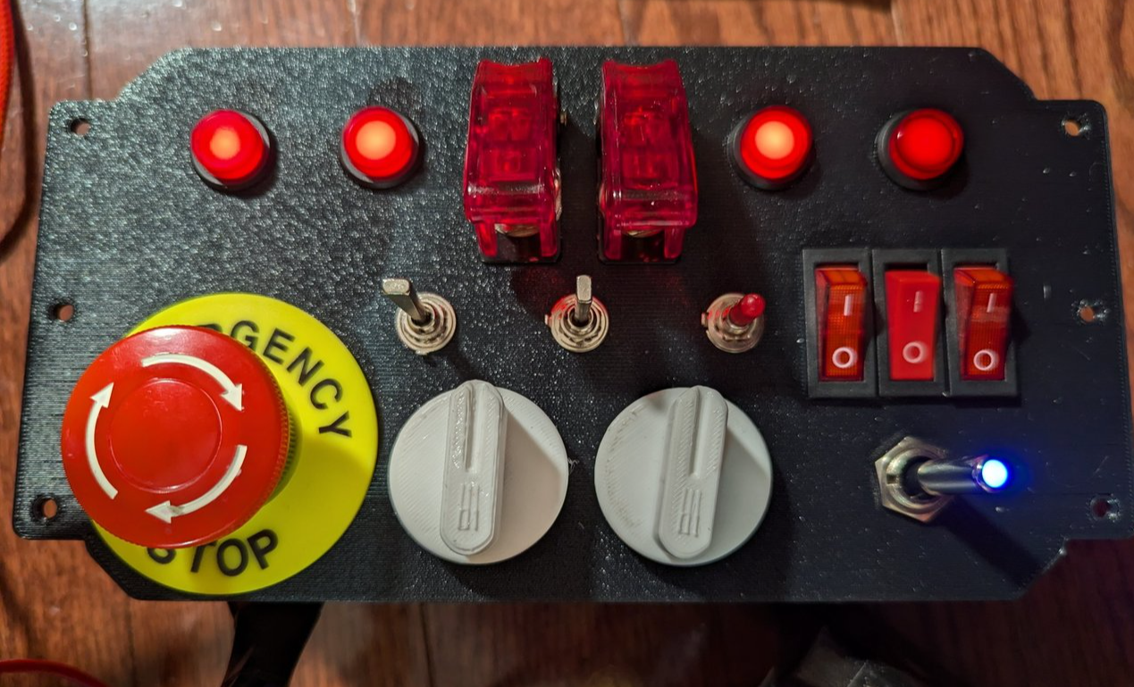

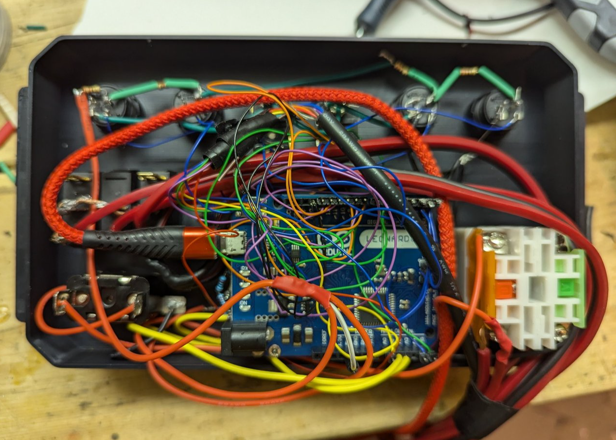

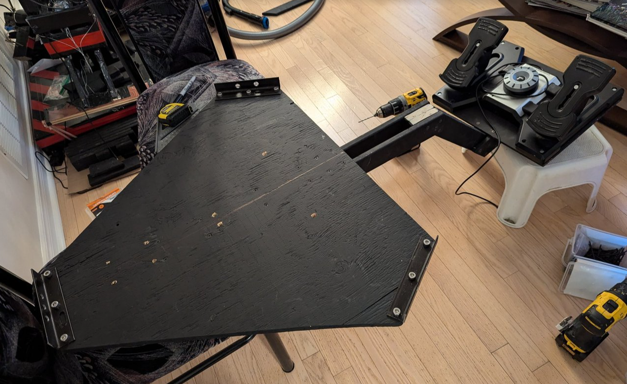

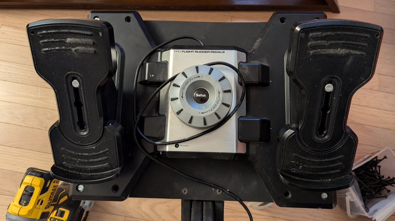

    More progress.
    Power / Emergency Stop / Button box:
    Seat, spine and pedal shelf assembly:

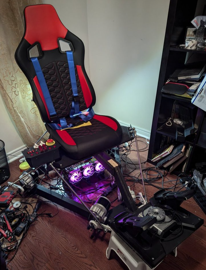

    Hi, a question, are you sure the wood will be strong enough to bear a huge positive heave movement? be careful with that
  13. Ronan Design
    Jun 4, 2021
    270
    Toronto, Canada
    1,721Coins
    +139 / 2 / -0
    No, I'm not sure, but I intend to limit the heave range to a more reasonable amount anyway, so it won't limit the roll/pitch/yaw too much. At the extremes, there isn't any room for other DOFs.

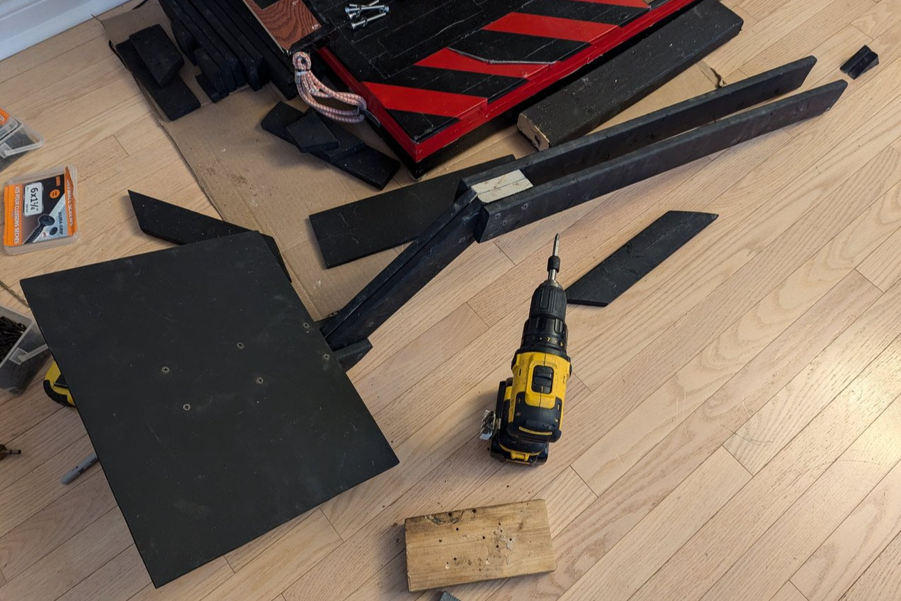

    Some (careful) testing of the seat, spine and pedal assembly on plastic motor arms. Eventually one of the arms snapped at some later point, but I got the data I needed so I could proceed with other work until I could fabricate the metal motor arms, which was pushed to next week unfortunately. The pedal shelf can hit the front motor arms in some positions, so I will flip the top platform brackets to get a few more cm of height. I also now have measured my maximum top position, so I can install the gas strut, or both struts. I think I'll start with one, placed at the center, then see if I want both.

    Well done! Although it's an important feature for a motion rig an emergency stop button looks somehow disturbing in an aircraft. An ejection seat handle would be more apropriate.
    :grin
  16. Ronan Design
    Jun 4, 2021
    270
    Toronto, Canada
    1,721Coins
    +139 / 2 / -0
    An ejection handle in, say, Boeing 737, would look equally disturbing :) Actually, the lack of an Emergency Stop button may serve as an ejection handle, as 1500W of power would eject the pilot during a violent maneuver or a rig crash :) That's why I got harness too.

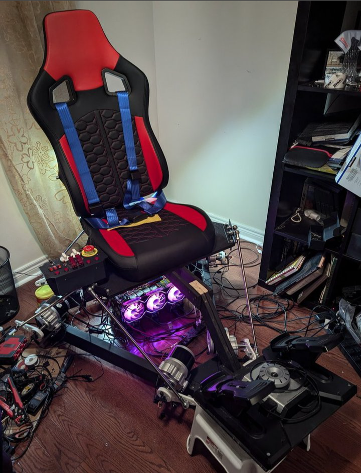

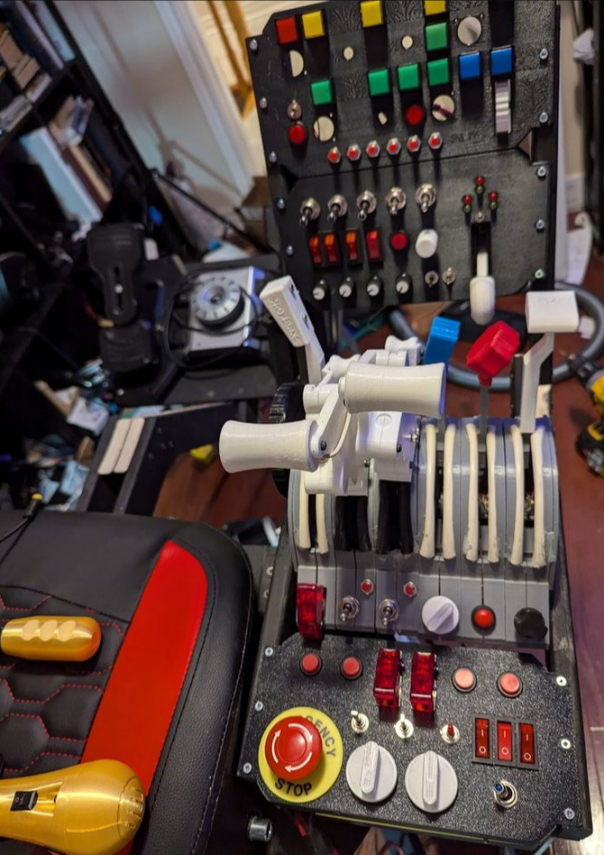

  17. Ronan Design
    Jun 4, 2021
    270
    Toronto, Canada
    1,721Coins
    +139 / 2 / -0

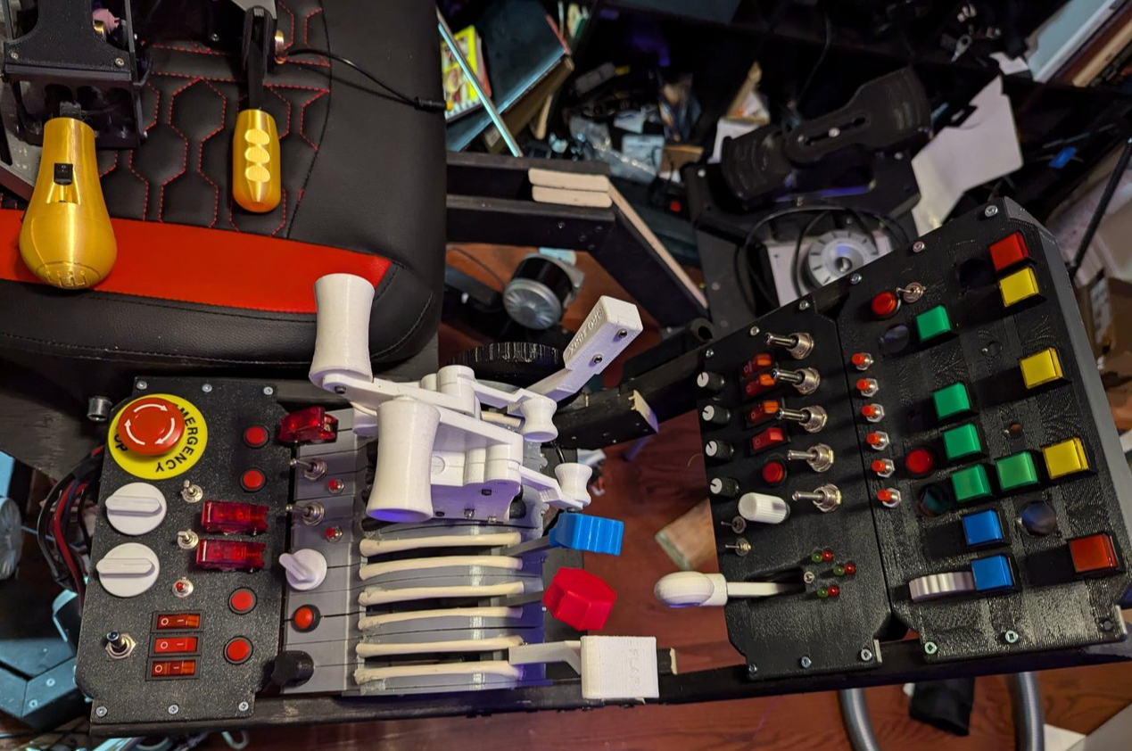

    Top platform assembled and attached:
    Building left and right panel racks. The left side has the HOTAS and will have a 3D-printed buttonbox, and the right side has the On/Off + Emergency Stop + button box combo, and my 3D printed custom Throttle Quadrant from the 2DOF rig, along with 2 other modules.
    Assembling Gear Button Box and MCP/GPS box (work in progress)

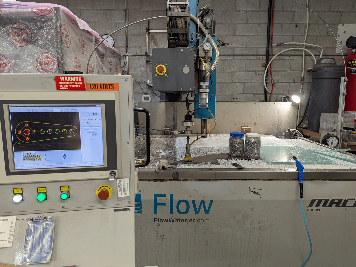

  18. Ronan Design
    Jun 4, 2021
    270
    Toronto, Canada
    1,721Coins
    +139 / 2 / -0
    Fabricating the Motor arms from 1/4" steel on the Waterjet machine at Victoria Balva Glass Studio. She does amazing things with glass and metal in Mississauga (Toronto, Ontario, Canada). I'm blessed with such a great and talented friend!
    Here's a video:

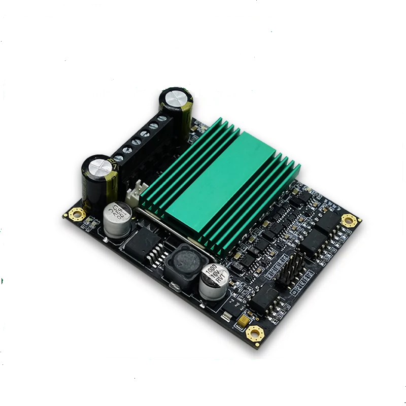

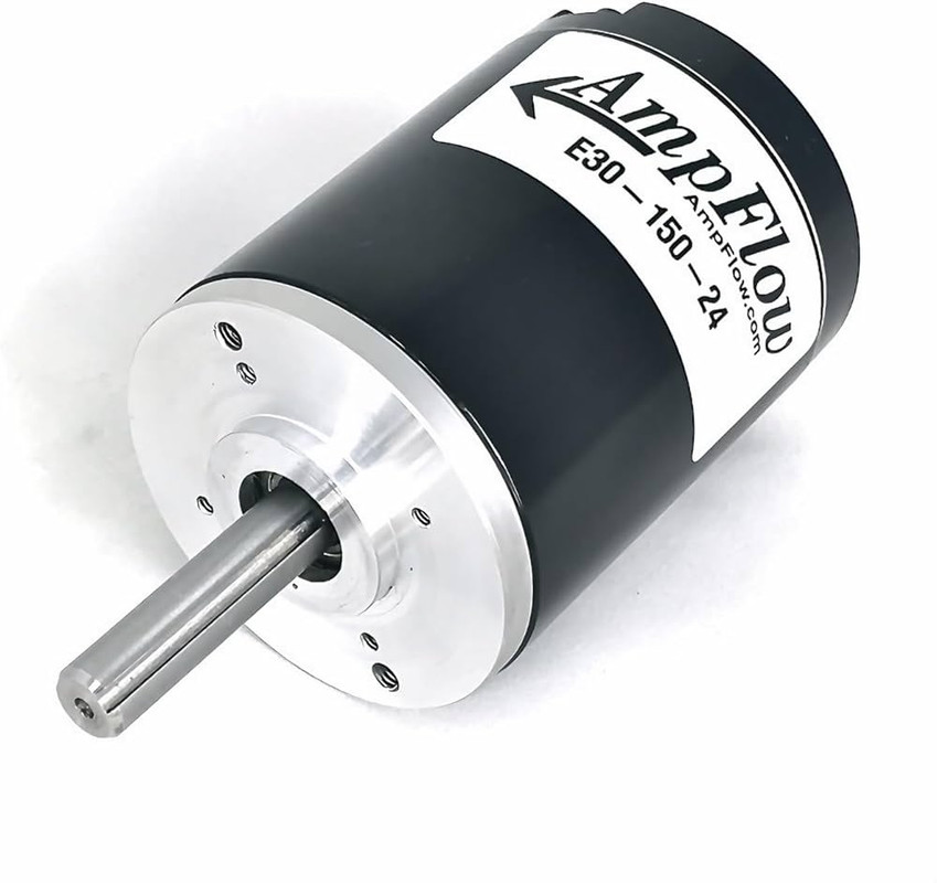

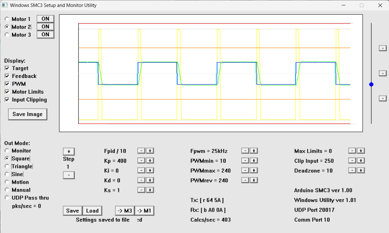

    I am currently evaluating (testing) the motor AmpFlow E30-150-24 (24V) Brushed Electric Motor with a harmonic drive gearhead 1:50 ratio.
    Driving it with DC 12V~48V 100A High Power Dual Channel DC Motor Drive Module Board.
    Power supply 24V 41A:
    Here is my control panel setting:
    I am happy with the performance, feels very solid and very stable!
    The motor seems rather warm toward hot after a 'Square mode' without any load for about 30 minutes. I measured the motor body with IR thermosensor and get 65'C.
    My questions are:
    • is this normal for a 75% efficiency motor?
    • is there any setting I can try to reduce the temperature?
    • Do you have any other suggestions? (put a fan, maybe help?)
    Thanks!

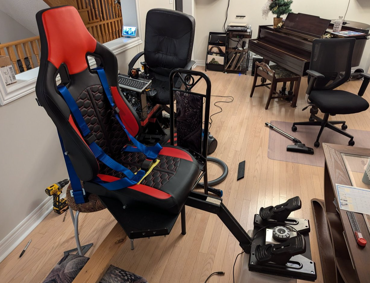

    FInally, I assembled the new motor arms - had to resolder some sensors and had some other issues, but it's all there now. I could test if the system can bear my weight, and it does! It moves me effortlessly, though the motion is not totally smooth - there is a kind of a small shudder that is constant and appear with every movement. I think maybe some CMS3 parameters need to be adjusted. Here's what I have at the moment:
    Cutoff is closer now, but otherwise this is it. Maybe something is too aggressive, maybe Kp, Ki, Kd or Ks need to be changed?
