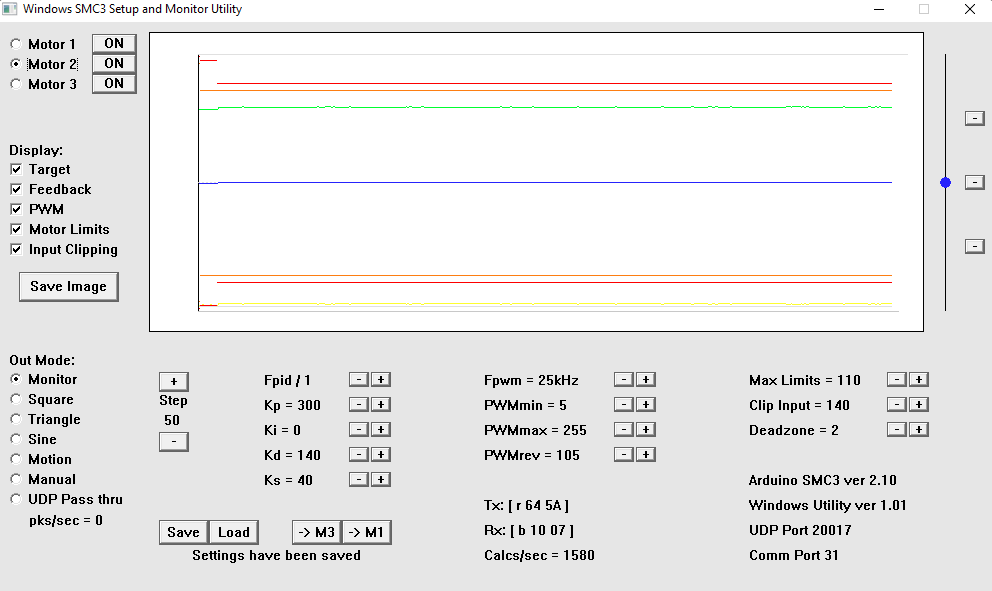

    There are 3 Arduino boards running modified SMC3 firmware, which takes care of the PID/control loops. The parameters for the PID are set in SMC3Tools software and written to the Arduino EPROM. Each board controls 2 motors.
    I do have a gas strut installed in the middle of the rig, rated at 54kg. When I'm not sitting on the rig the frame can barely hold the force of the strut and starts buckling a bit, so I can't add more gas struts. I haven't tried without a strut because I was planning to use it from the beginning to take part of the weight from the motors and smooth out the movement.
    SMC3 Tools is set for 50000 comm speed for communication between PC and Arduino, and 25kHz for PWM motor control, which are the default settings as far as I understand, and what worked for me in my 2DOF. I've seen one person use 20kHz and i tried it in one of my experiments but didn't notice any difference in cogging.

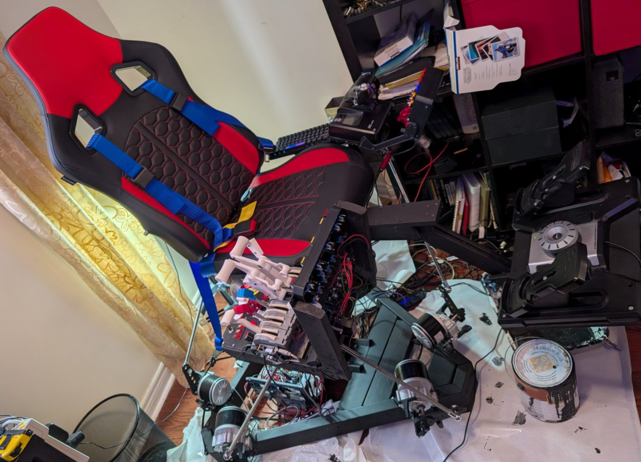

    I had to swap one of the Arduino boards because it seems to be defective - it often loses connection with the PC, even when flashing it from Arduino IDE it often flashed then timed out not getting a response from the board. After some resoldering, I tested the rig without the strut. It does work - and by "work" I mean there is enough power in the motors to carry my weight and move the rig around, but the cogging sensation was much worse. I could feel the stepping much more and I could even hear it very distinctly now! Yes, I could actually hear the gears in the motors going "tick-tick-tick" quickly. So I can say that a strut actually helps with cogging in a significant manner. We'll see if cogging remains noticeable in an actual sim, once I get vibration transducers installed, with everything that's going on on the rig.
    - I have constructed an attachment platform and mated my DIY pendulum yoke to it, and it will also mount a joystick and a steering wheel on demand.
    - Painted whatever needed to be painted or touched up.
    - Mounted left HOTAS button box, wired the USB hub etc.
    - Mounted keyboard
    - Mounted power amp for the vibration transducers
    - I'm working on the right console now - the Arduino Leonardo based switch box with gear lever and encoder, and Arduino Mega based MCP/GPS/Autopilot panel powered by MobiFlight software.

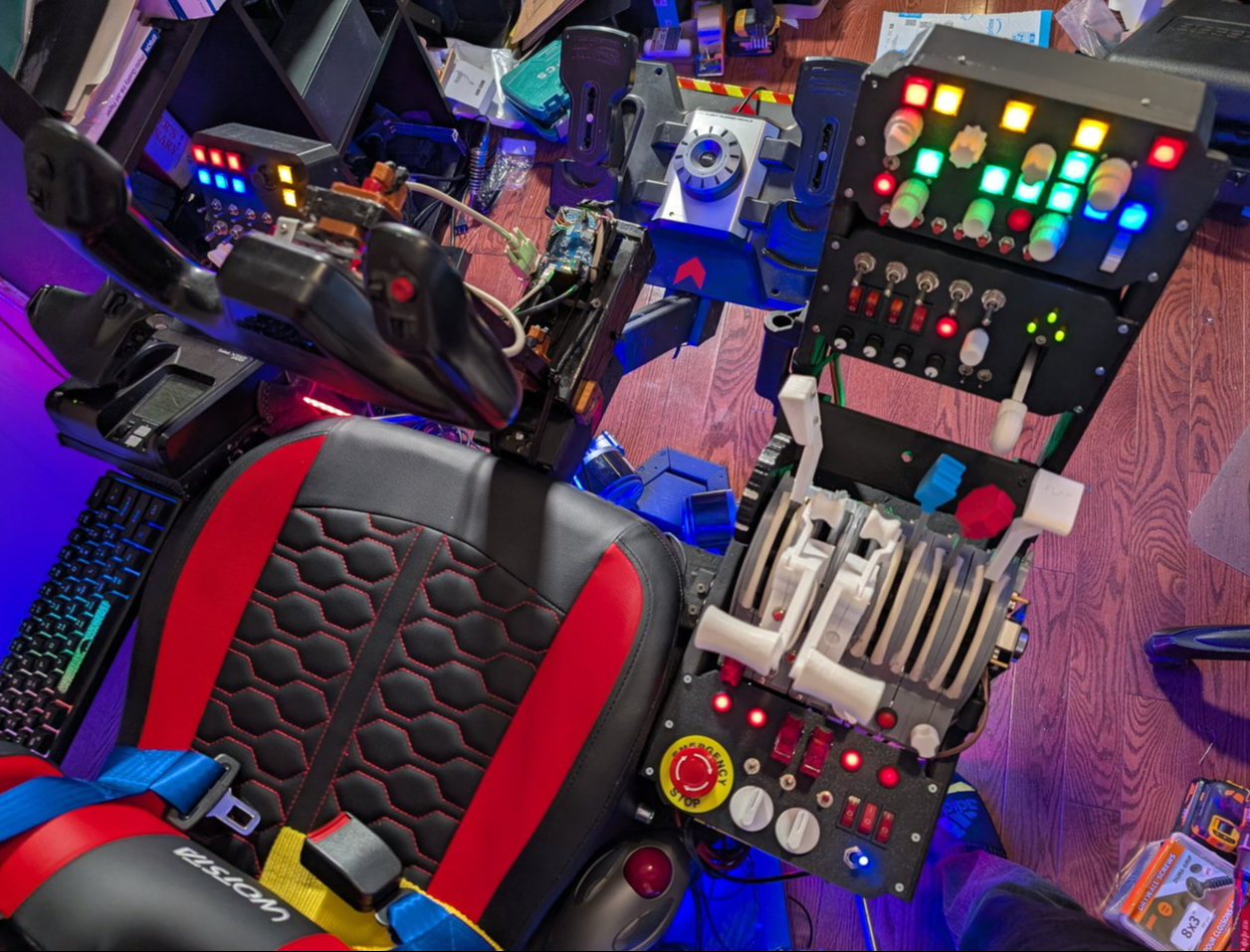

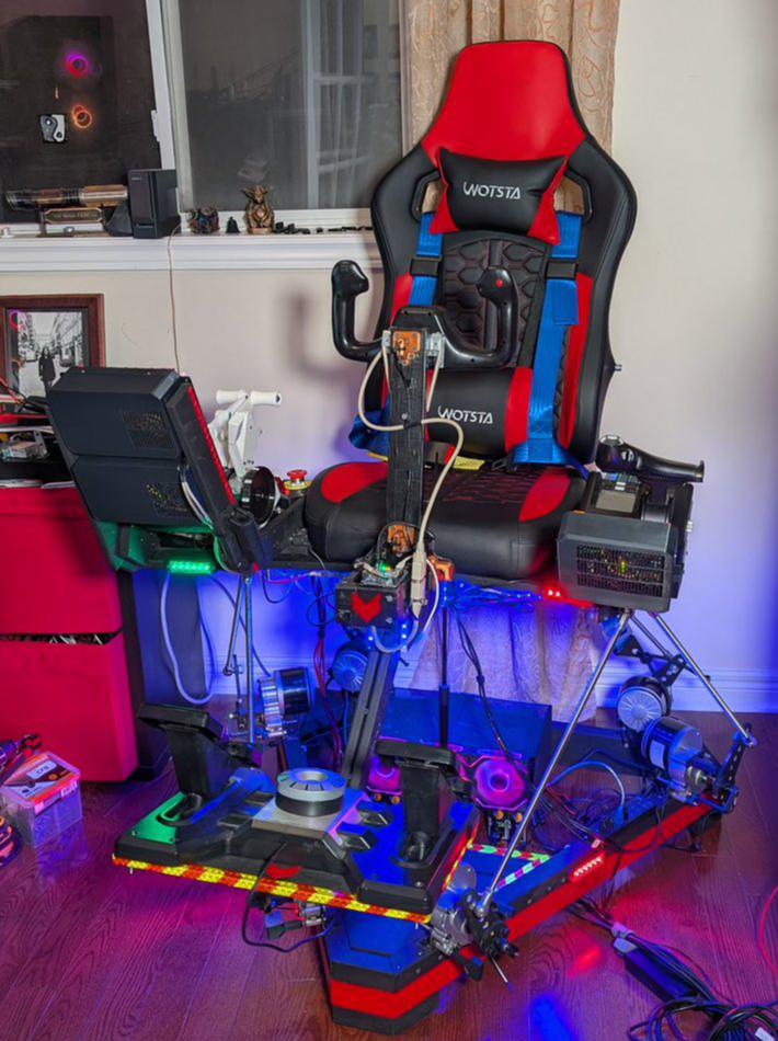

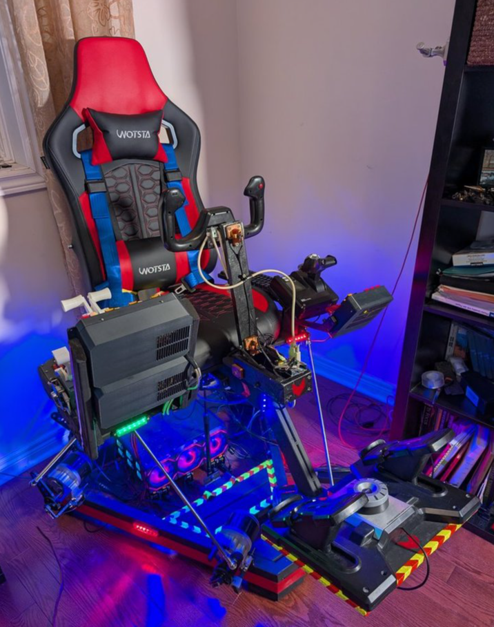

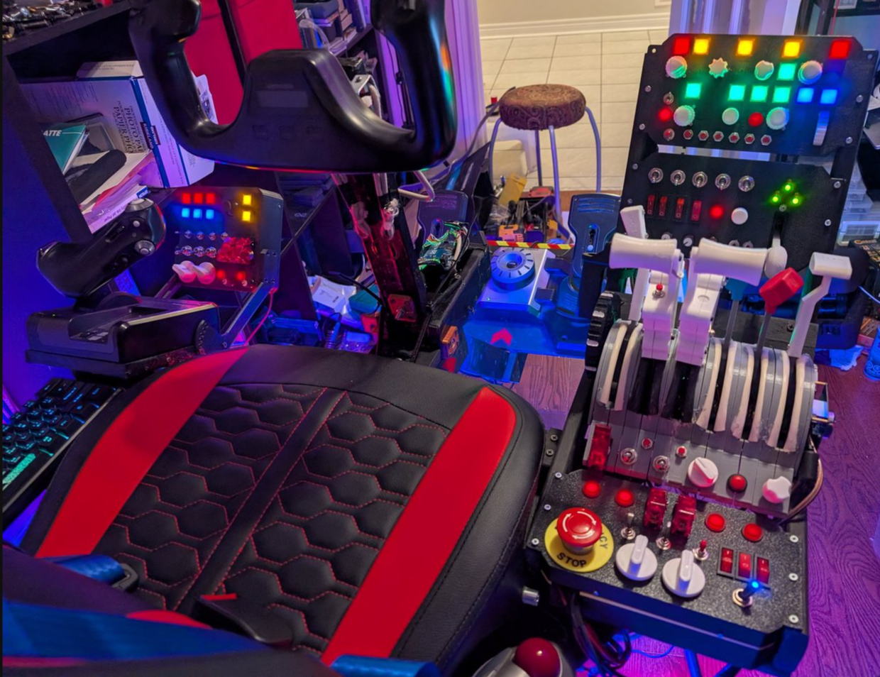

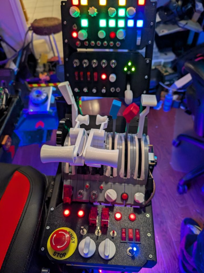

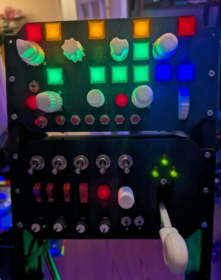

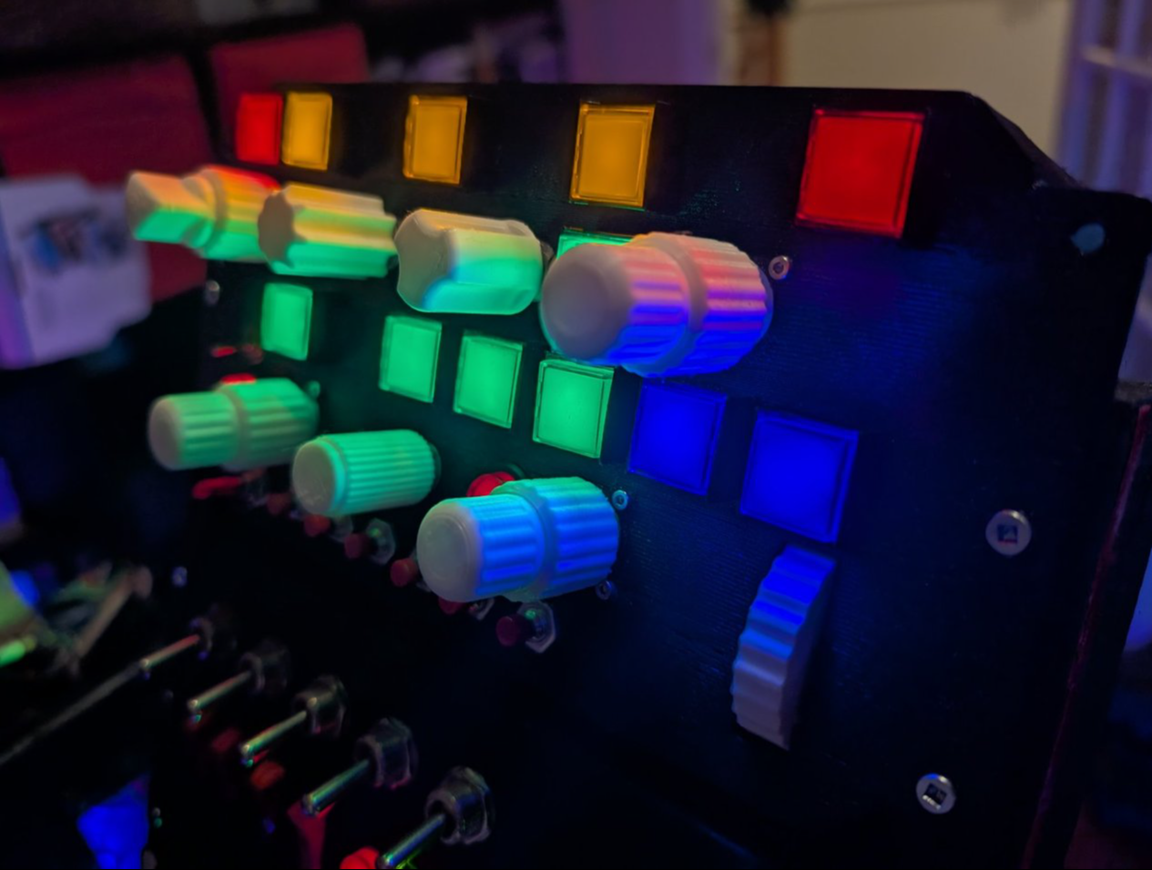

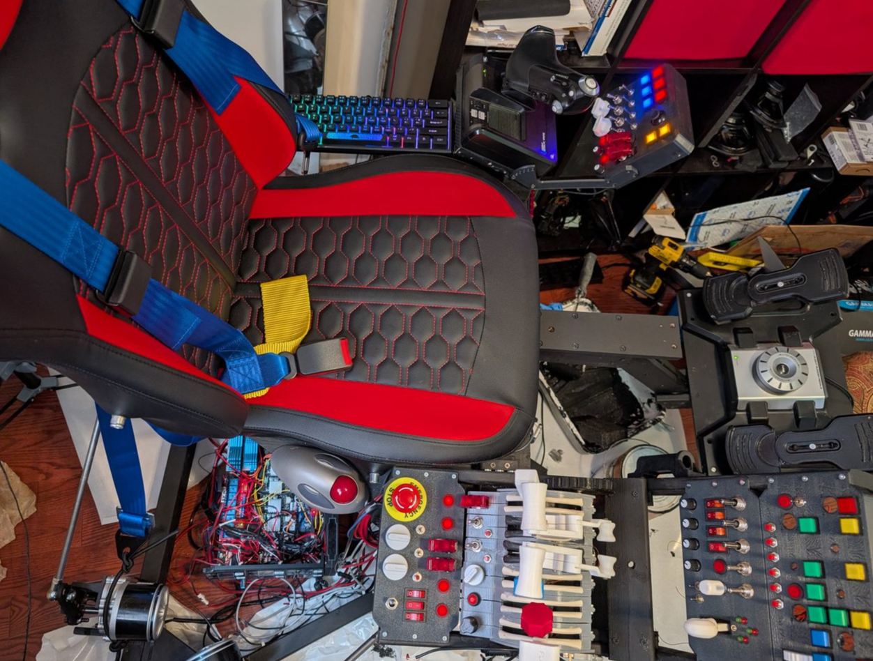

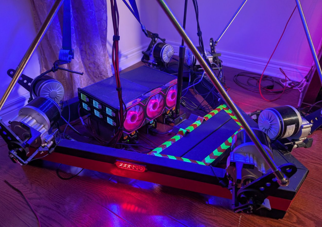

    I can't believe it, but my motion simulator is finally complete, in a yoke/rudder pedals form. The joystick/HOTAS combo and Steering wheel/shifter/pedals combo will come a bit later.
    Now, I need to configure everything to work correctly in MSFS2024, which was a bit of a nightmare on the first attempt — but not because of the rig's fault. MSFS2024 just kept crashing the moment I activated VR. I finally solved it, and although I still need to tweak and configure a bit more, I was finally able to have a 10-minute flight without crashing (in both literal and figurative sense). It's working!
    As soon as I approach an acceptable motion profile, I will do a video.
    The few minutes I could have an actual honest flight it felt great! I took off in a C152 from Toronto Island and after completing a few turns landed, then repeated the flight a couple of times. With all the constant motion that was happening in the air in a small plane such as micro-turbulences, control feedback, and engine vibrations induced through 2 vibration transducers the cogging was not noticeable at all, and I was expecting to feel it. Maybe in a calmer larger plane, but not in C152.
    The motors seem to be always busy, even when the rig is motionless and not receiving any data. They are silent, but when I touch them I can feel a bit of a "buzzing" of the micro-movements. I think they heat up from that and I measured the temperature of up to 40C after maybe 30 minutes of motors powered up, including test flights. It doesn't seem excessive, but I wonder if I can calm the motors a bit with SMC3 settings tweak.
    Here are a few photos of the finished rig, complete with strobes, nav lights and a blue aura: I wanted to make sure everyone around knows it could be moving and stand back (because I'd be in a VR HMD so couldn't keep my eyes on bystanders), so I needed some bright lights - why not do it in style?
    • Winner Winner x 3

    It's 3 Arduino Uno boards for the motion, each handling 2 motors. FlyPT Mover controls them just fine. On top of that, there is an Arduino Mega for the MCP/GPS/AP panel (controlled via MobiFlight software), and for the other panels and peripherals, there are 3 Arduino Leonardo boards and 1 Arduino Pro Mini. Windows sees them as normal joysticks.
    The goal was a compact rig, turning the axles inwards would mean a much larger frame and footprint. As far as I can see, most rigs have shafts outwards like mine.
    6 x 250W = 1500W of total motor power. I run modified server PSUs, making a 2 x 750W 24V PSUs = 1500W again. Plus an additional 12V 460W PSU to run the lights and accessories.

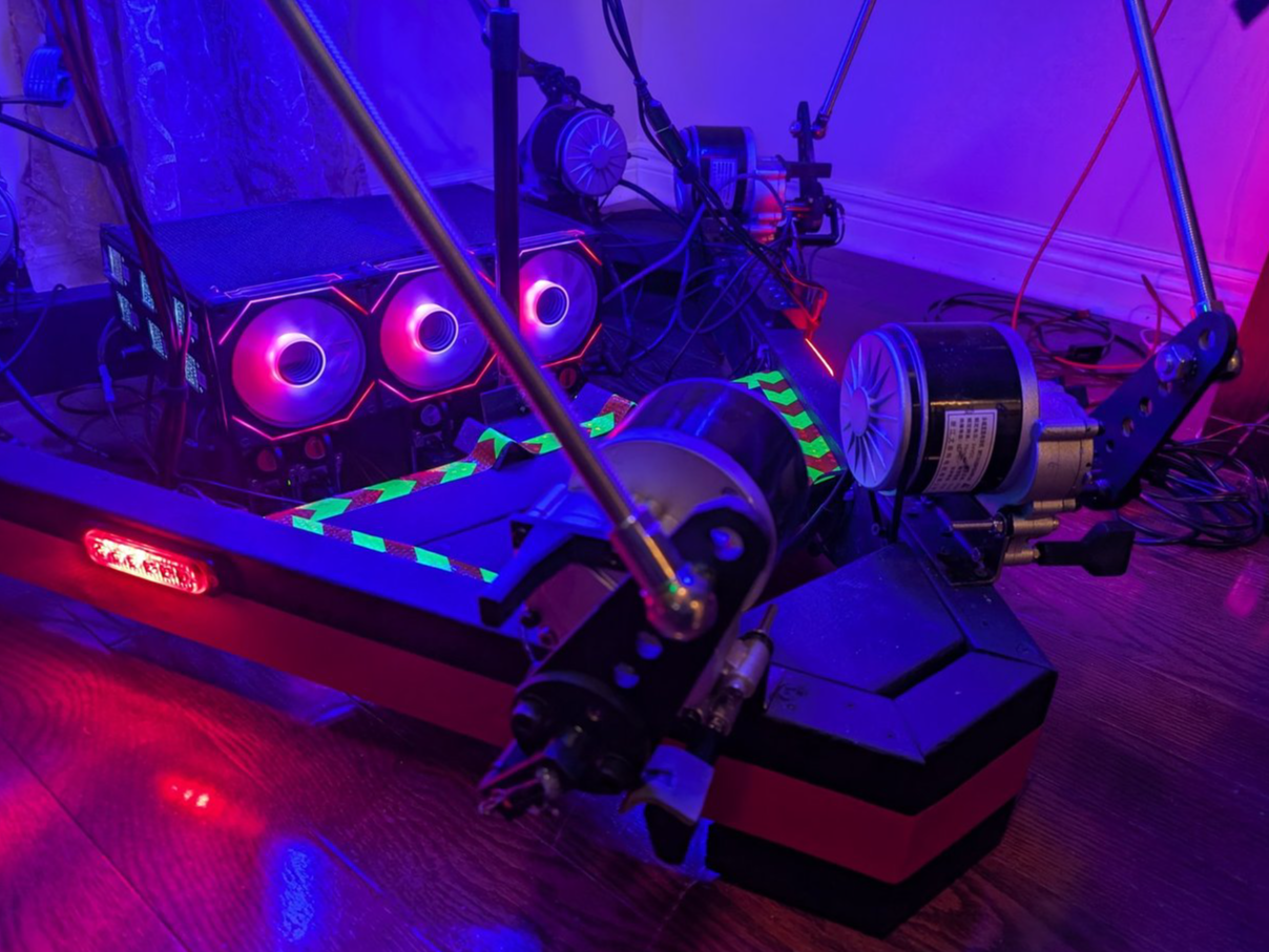

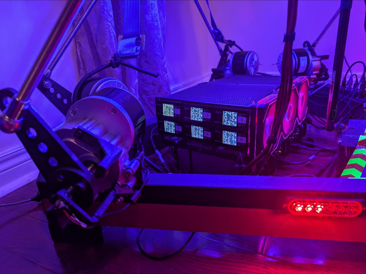

    OK, I have sorted out MSFS2024 problems and it seems to be stable now. After some testing and tweaking I got the motion dialed in acceptably well. I'm ready for the video.
    But I hit a problem I need to take care of first:
    After an hour or so, the motors really overheated. I started smelling a "warm motor" smell - not a burning smell, thankfully, but still not something that should be happening. I measured the temperature a couple of times during testing and it was hovering around 45C, but after some robust motion testing, when I sensed the smell, I measured 66C on the side surface of the hottest motor. I need to get this under control...

    There are 3 possibilities
    1. It's the static current that causes most of the heating (the motors have to fight gravity)
    2. Backlash or imperfect tuning of the control loop parameters causes "dithering", the motors are moving forth and back a little bit all the time
    3. The actual mechanical work of moving the rig consumes the most energy
    Testing if 3 is the case is easy. Just let it stand still while powered up and look if the motors also get hot after a while. To distinguish between 1 and 2 I'd measure the average DC currents and voltages at the motors. The static power of each motor is voltage times current. The total power is the current at the supply times the voltage. The total power is always higher than the sum of the static power of the motors. This is caused by eddy current losses in the motor iron and heat produced by the power electronics. But if those losses are higher than, say, 1/3 of the total power I'd suspect that there are unnecessary losses due to dithering.
    So if 2 consumes the most energy, try to optimise the tuning. If it's 1 than you could consider adding gas springs. Only as last resort I would add fans. DC motors produce most of the heat in the rotor so blowing air around the stator doesn't help much when the motor is not turning at high speed.

    It's definitely #2, or at least it's the root of the problem. The motors heat up even when the rig is sitting idle and empty but under power. Naturally, they heat up more under load, but they heat up to 40C-ish even on idle. It's not audible, but when I touch the motors I can feel the "buzzing" or dithering as you called it going on constantly, even though there is no visible movement. So my guess is that the tuning needs to be adjusted, but I'm not sure how exactly. Here are my current settings:
    Should I increase the Kp and reduce PWMmax? Increase the deadzone? Reduce Fpwm to 20kHz (I say it at 25 on a similar rig, but most use 20 and it should be less pulses I guess, while still enough for precision)?

    Pwmax on 240 for security for me (the motor max 250w ?)... pwmrev at 40.
